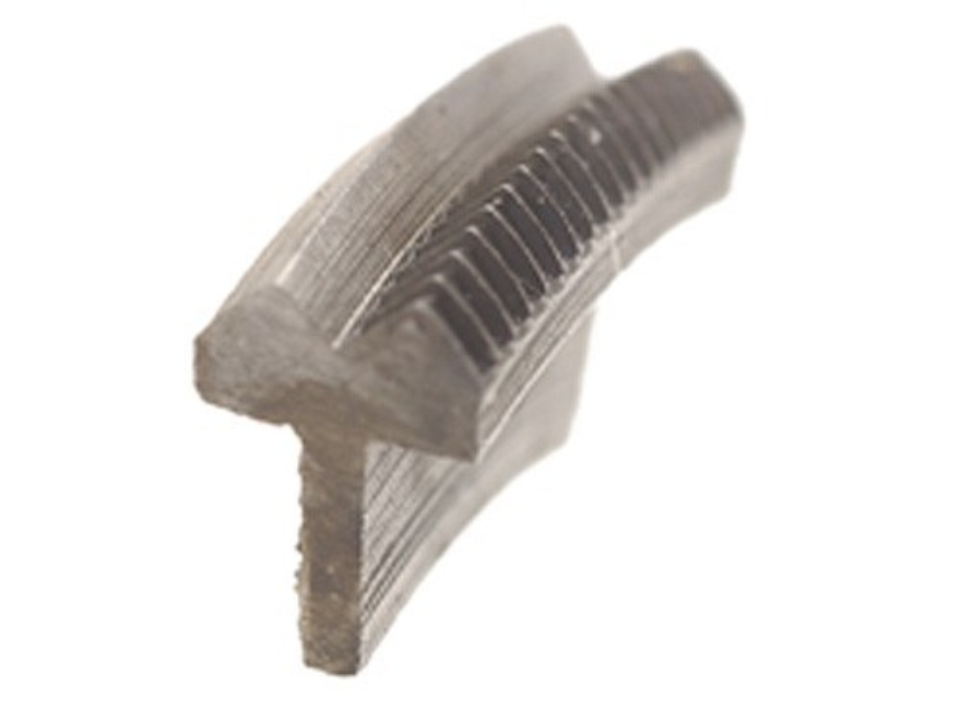

    Hotz's Tools
    Hi Kim welcome HT.Net ...
    **Checkering Cutter Right Hand**
    I need explanation for serving this tool had never seen and did not understand the announcement ....

    The V to your left is a guide, the serrated side (right) is the cutter, first line or cut is done as straight as you can with a single line cutter, then use the tool shown. When you finish all lines you start again with other set of lines crossing to form diamonds.
