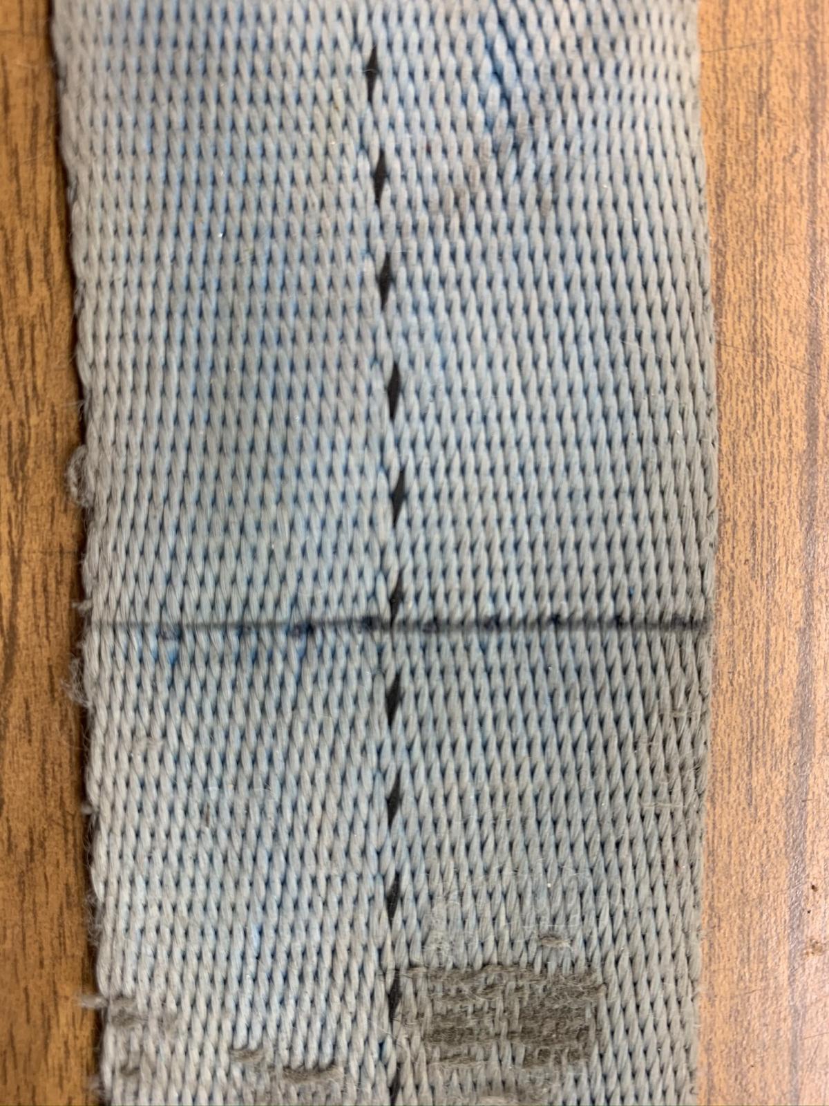

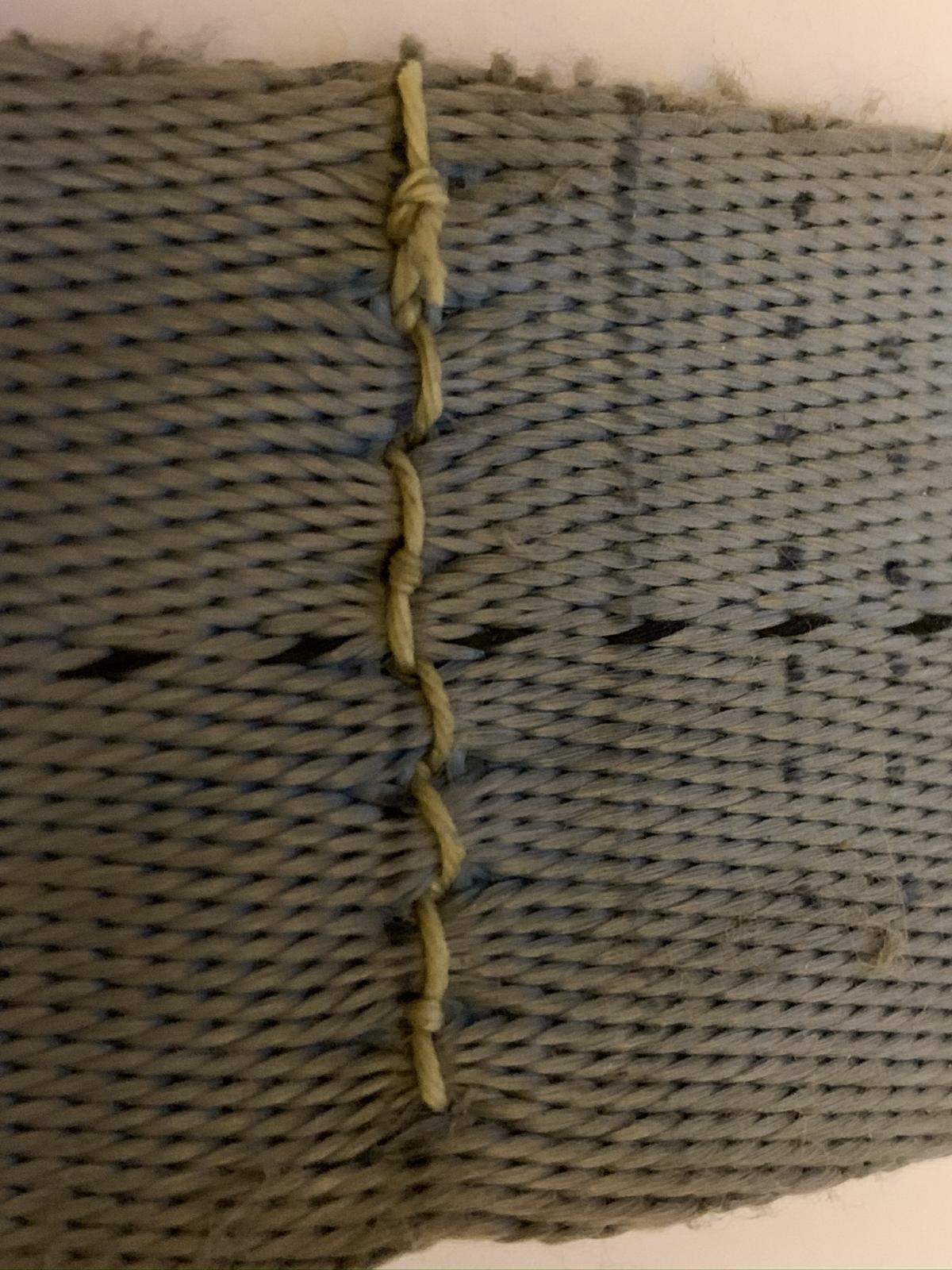

    The next day:
    I don't need to make holes, just get the stitch straight and even. I first marked a straight line with a sharp pencil. Then I took a disposable plastic fork and dipped the tines in an ink pad. Push the tines onto the pencil line and it is all marked out. To mark more points, just align the last dot of ink with the first tine of the fork.
    You can see that my spacing is good but I'm not staying on the line. I think I'm jumping above and below a cross-thread. I should be using my Optovisor plus need to develop more skill.
    Thanks,

    Just tension adjustment to get stitch in middle of fabric ,bit harder the thinner the material but the more you do the better the results.Its not so hard in sole leather but harder to push thru
