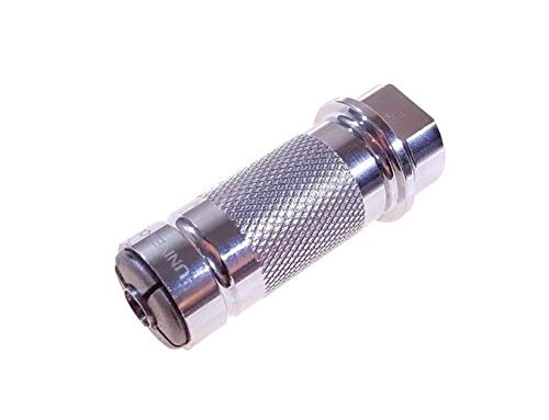

    Has anyone here used any of these type of couplers and if so which style works the best...

    I have the LockNlube, have had it for 6 years now, best grease gun attachmant I ever bought!
    It clamps easy, makes a good fit, releases easy, doesn't make a mess.
    I got the XL model as I need to reach into holes to get to fittings on loaders, but the extra length makes it easier to lube drive joints with boots/covers.

    I just have a regular LockNLube. I have never had it fail, but I have found a couple of places I cannot get it into.
    BUT, that being said, for those places I cannot get it into, I got a short grease gun hose. Put my old regular grease head on one end and a fitting on the other. LOCK the adapter into the LockNLube. Good to go. It really does LOCK onto the fittings.

    I too have the LockNlube . I agree completely. I works great!.

    I will also throw in my vote for the locknlube

    just bought the one at the bottom, and haven't tried it yet, but it locks onto the nipples I tested it on quickly against hand pressure. Will test with grease this coming weekend. Mine is a no-name brand from temu and cost less than $20 AUD

    Ditto to all of that. Live the LockNLube.

    I ended up getting the LockNLube units, the short and the long and the swivels. I also got the Univer-Co fittings which work great with no leakage...Grease Gun Coupler-31m5y5ivmhl.jpg
