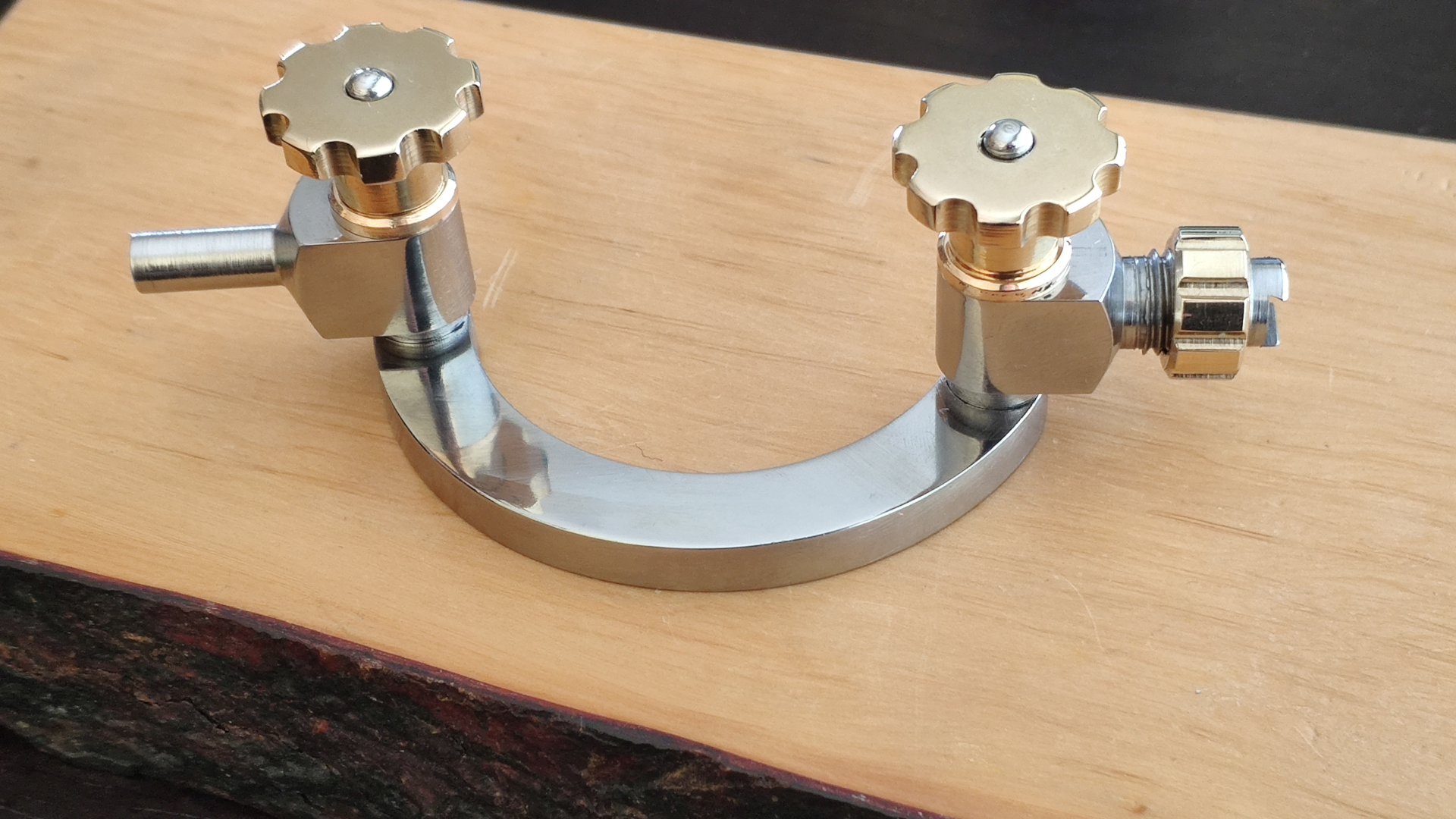

    Hi folks. I have not posted in a while because I have been busy making this. It's a six part (!) video. Apologies to people that like them short and sweet. You can look at just the end of the last video if you want to skip most of the "making-of" stuff.
    It's made from chromoly (square bits), brass (knobs), bronze (washers), cold rolled steel (arm) and some D2 tool steel (threaded pins, not heat-treated).
    Picture here:
    And the making-of videos are shown here on this playlist:
    https://www.youtube.com/playlist?lis...zYfM9aa84pjyfl
