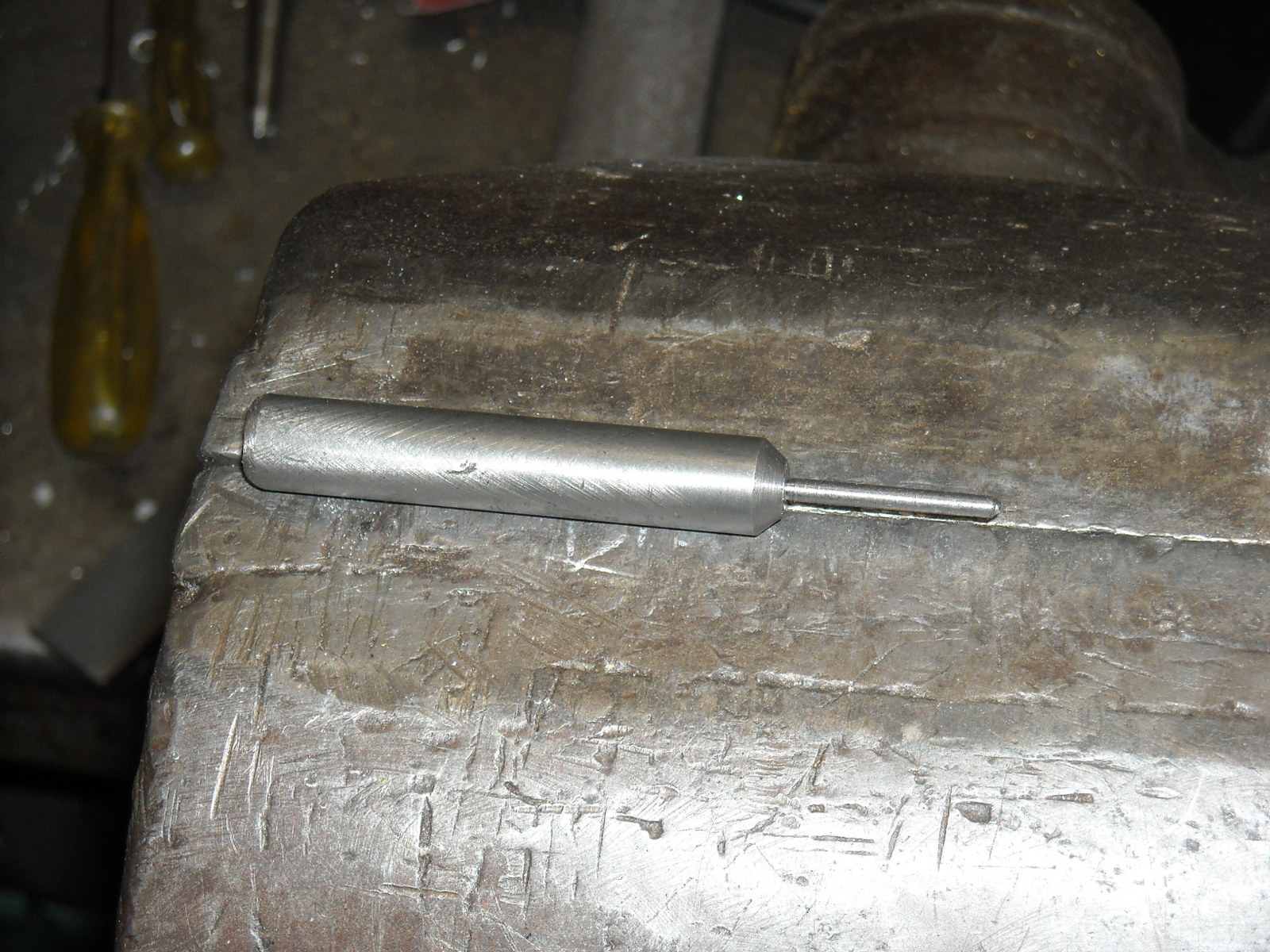

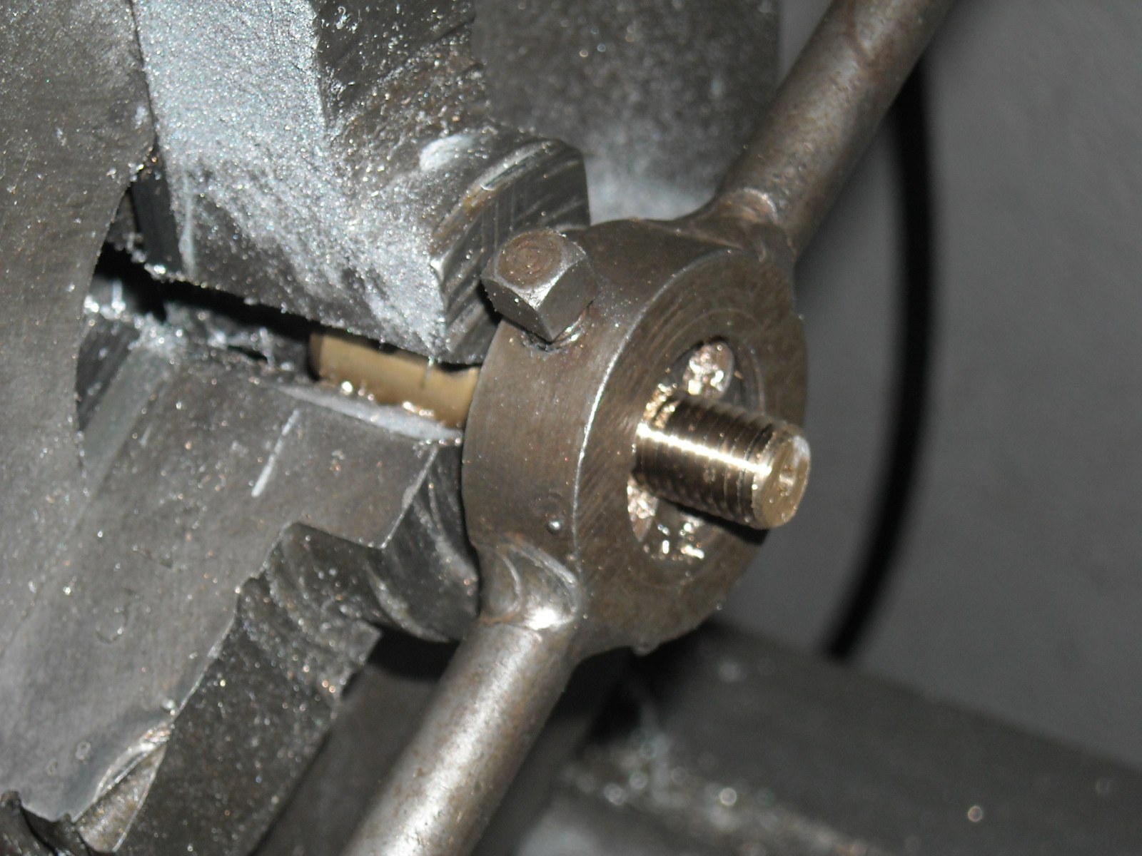

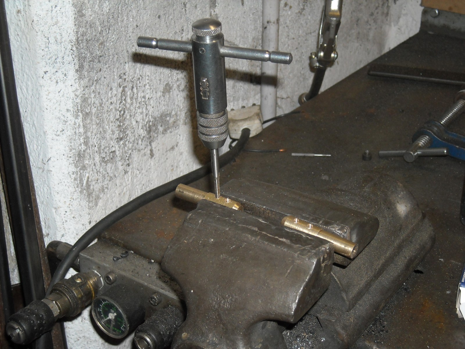

    small update

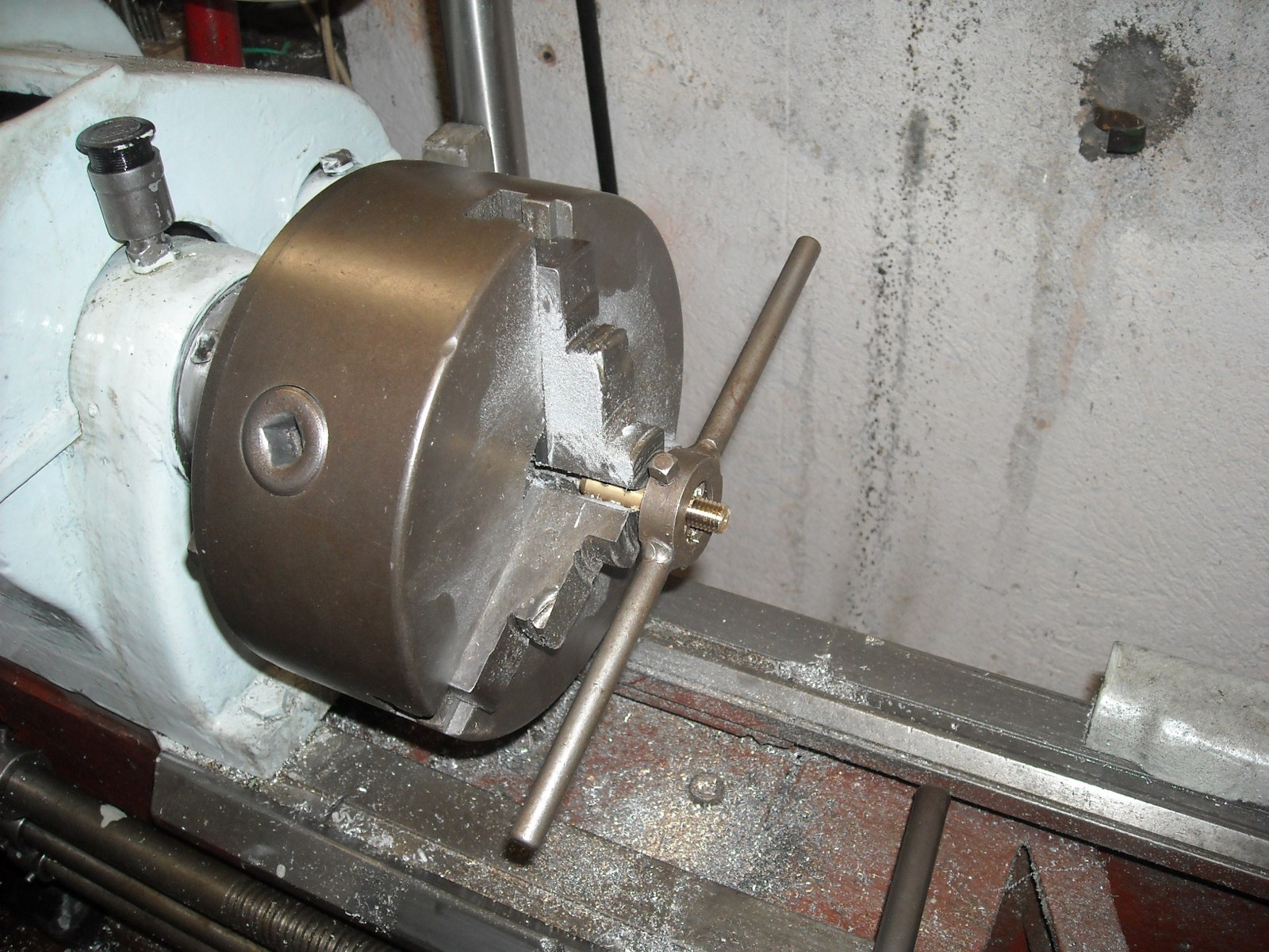

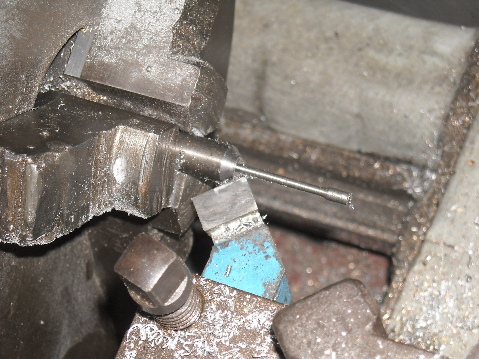

    as usually i havn't found dremel diamond cutting disk, i will try with a diamond mill for dentist, maybe blocked on lathe.
    I made a sort of pattern from steel on lathe, work is not so nice to see, but size is good, I really don't know if this template will be good for modelling the chamber or not, but for sure i'll try! I think I will try your advice of modified plyers, and then melt glass on glass to reach some thickness
    The others parts are new clamps for tungsten and the small one is the central point of earth (GND, don't know if it's the right name) in brass, drilled and threaded , i need some inox grains. hope tomorrow with polished tube plate i will start welding circuit and power supply... i'm curious to see the flame

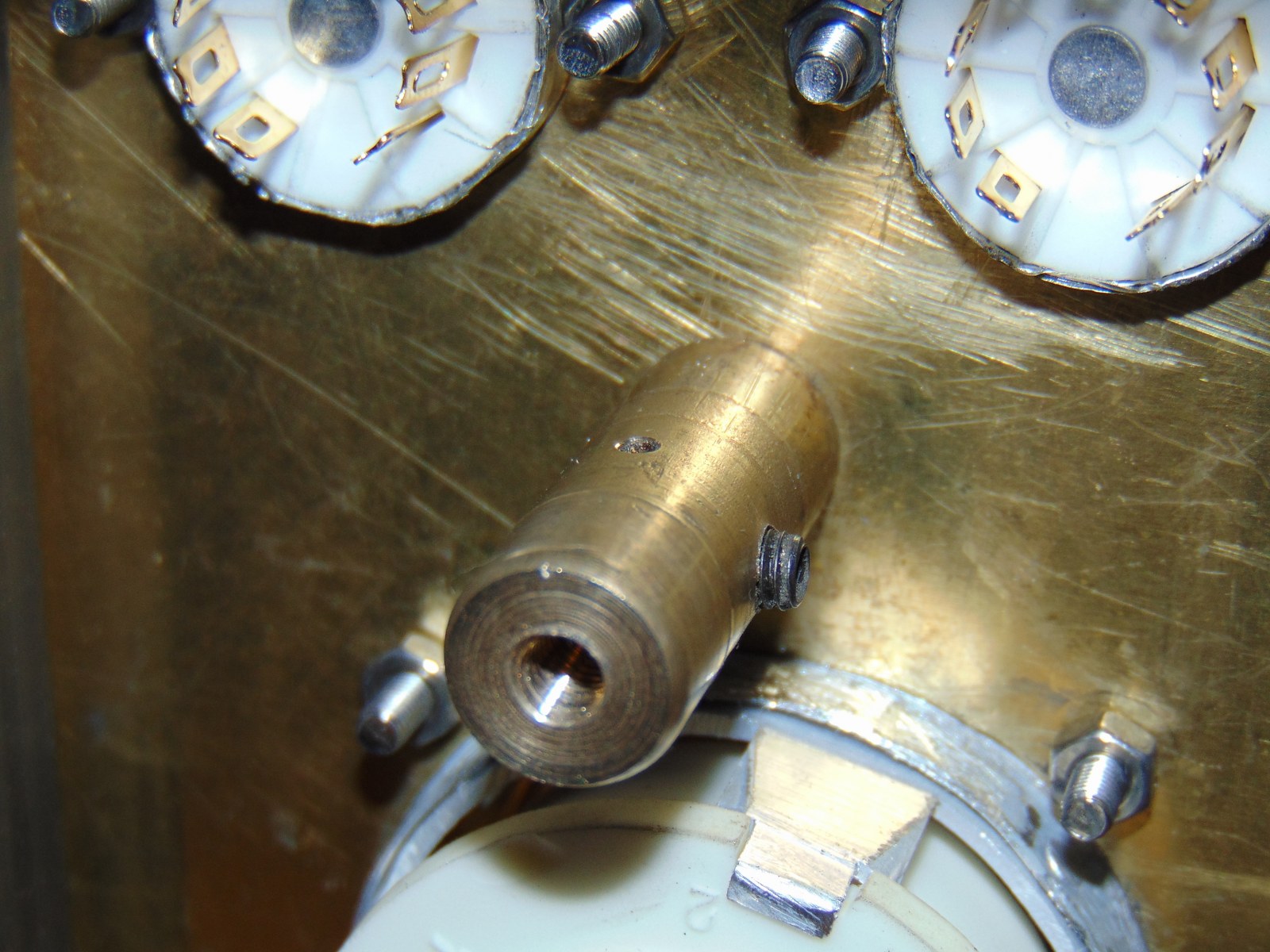

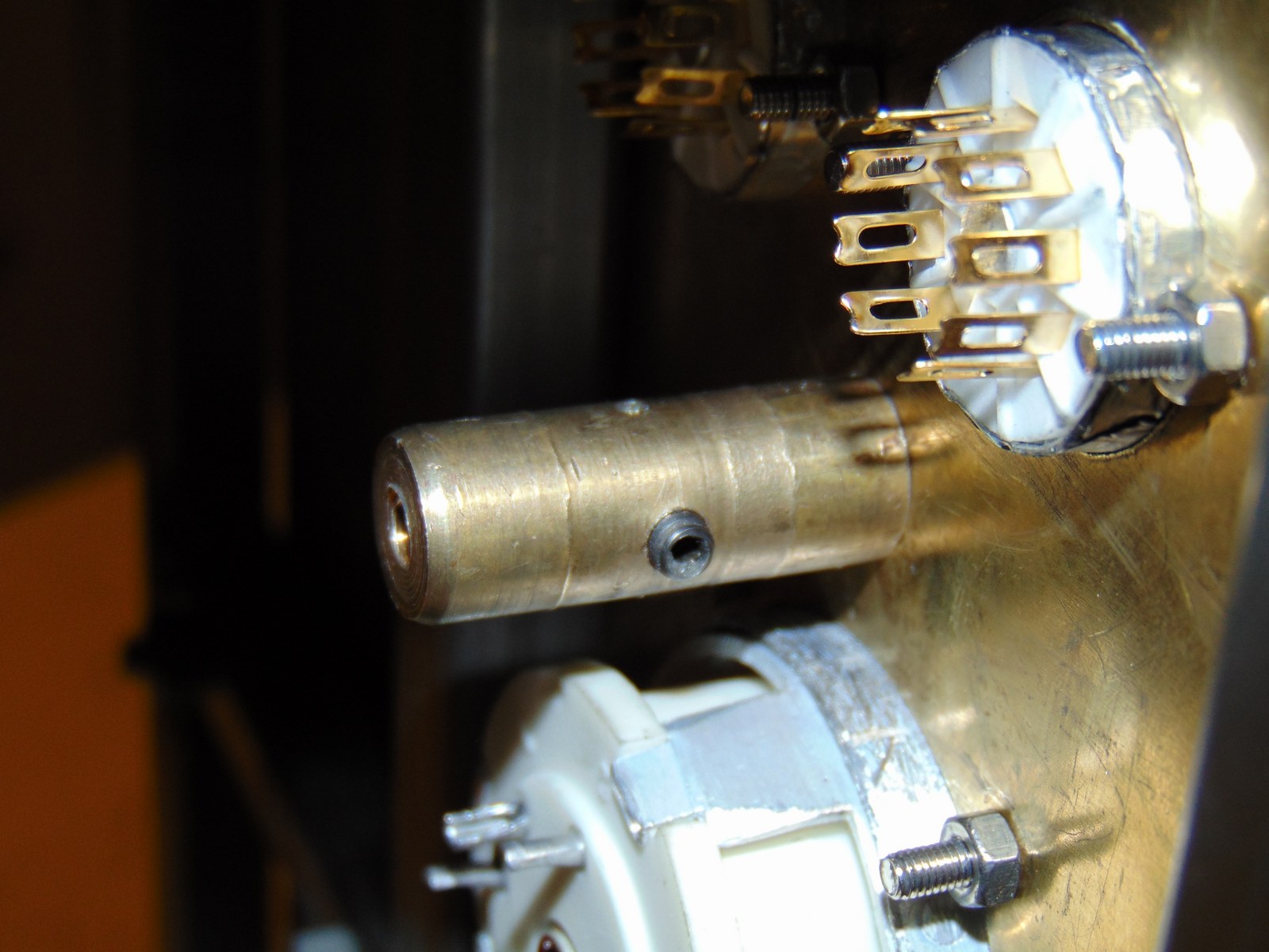

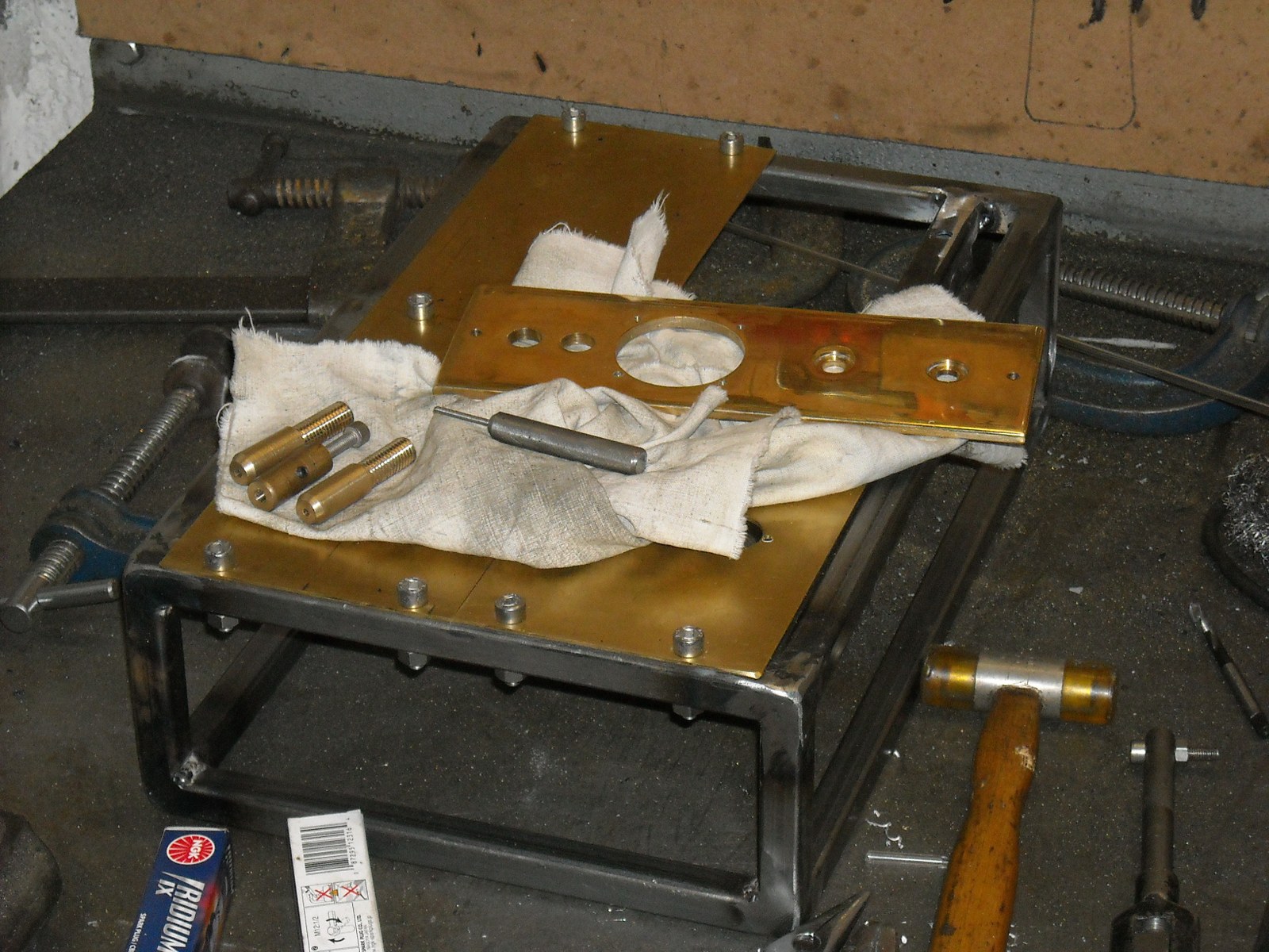

    Nov 2015
    Italy
    435
    451
    Thanked 496 Times in 241 Posts
    rendoman's Tools

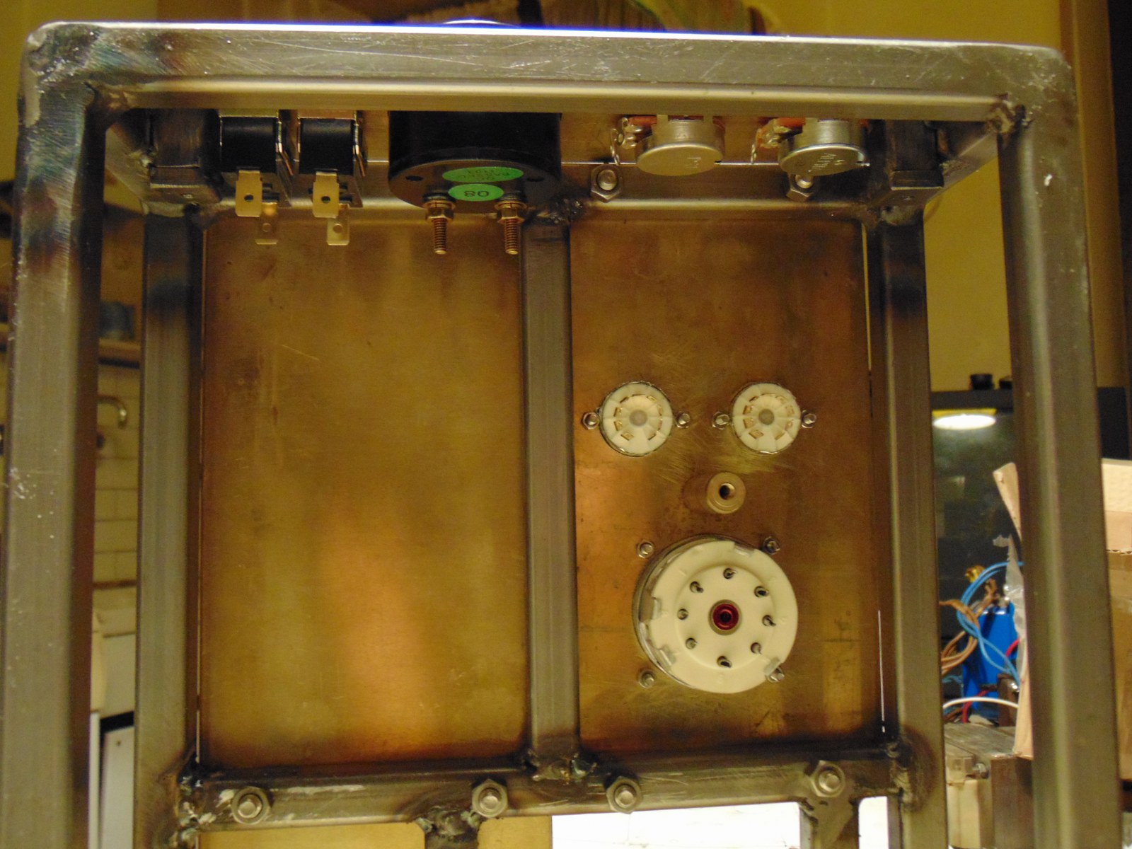

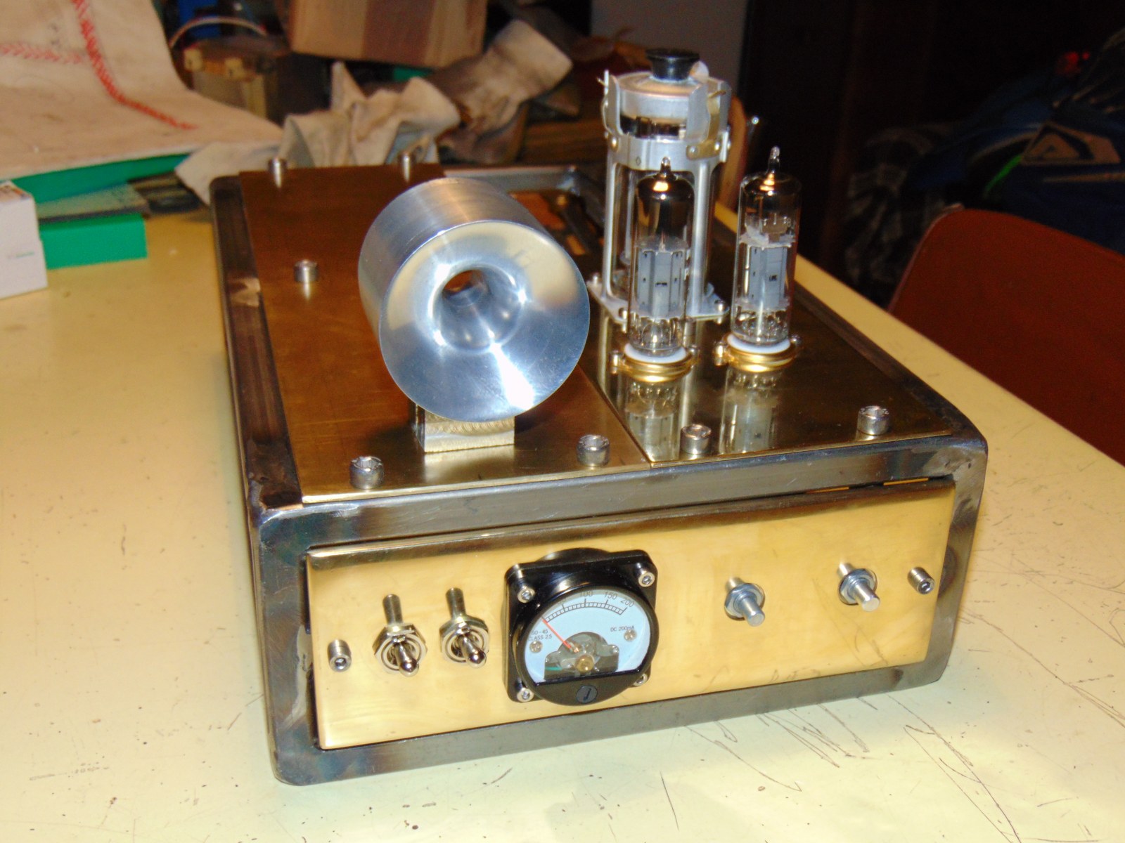

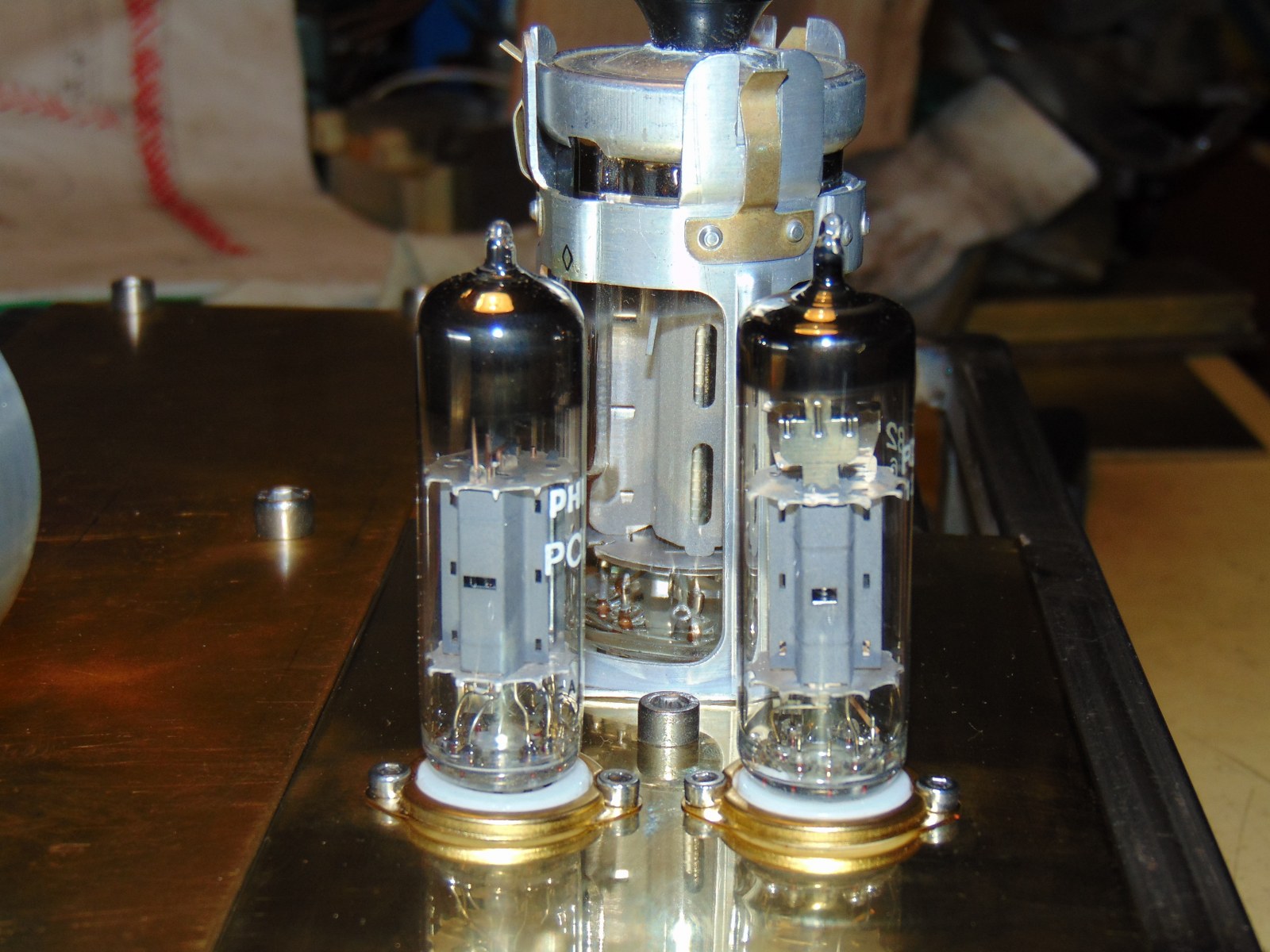

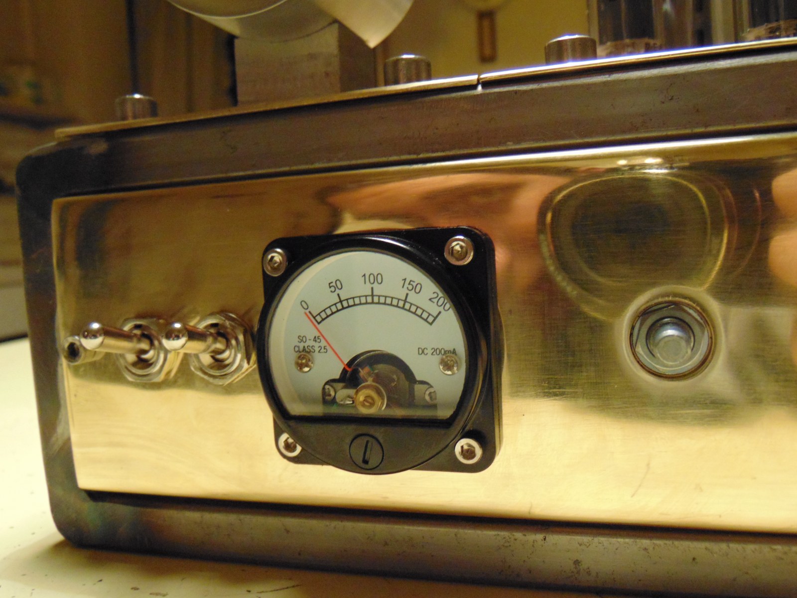

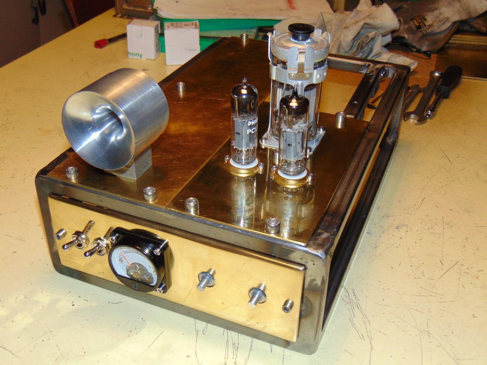

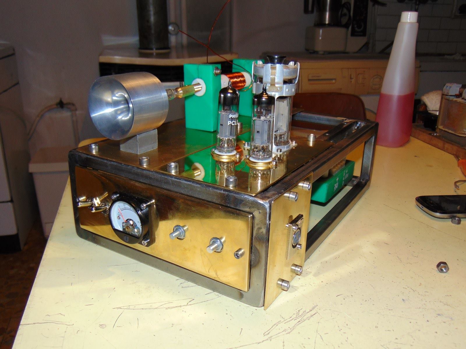

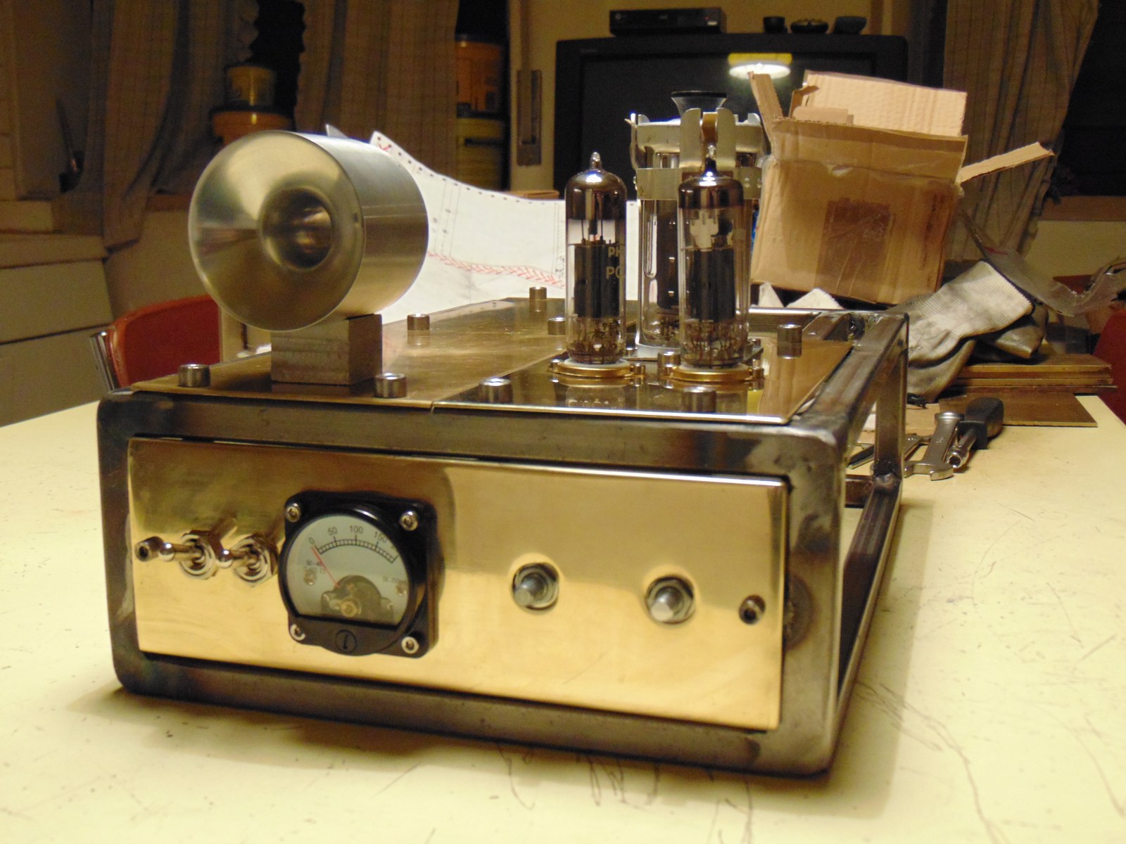

    Main parts done, not a perfect job, too many bad things linked to the thin 1,5mm frame, too thin for my welder. the tip for Gnd is solid and make good connection, i changed the front black screw m3 with inox type, same for tube sockets.
    I left the left panel unpolished because I have to drill holes for horn, coils, faraday and other minor parts.
    I'm thinking about some fairlead or guides for cables, for sure main 230ac have to run from behind to front panel switch, , 6 cables for low voltage 6,3 and 12,6v filaments, and 2 different B+.
    I decided to put an xlr connector to the right side, near the lateral potentiometer, close to the pcl82 triode grid. Hope I'll not need for shielded cables!
    and now I think I can start welding circuit and making big boooooom!

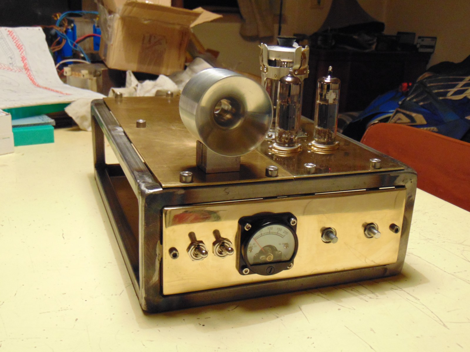

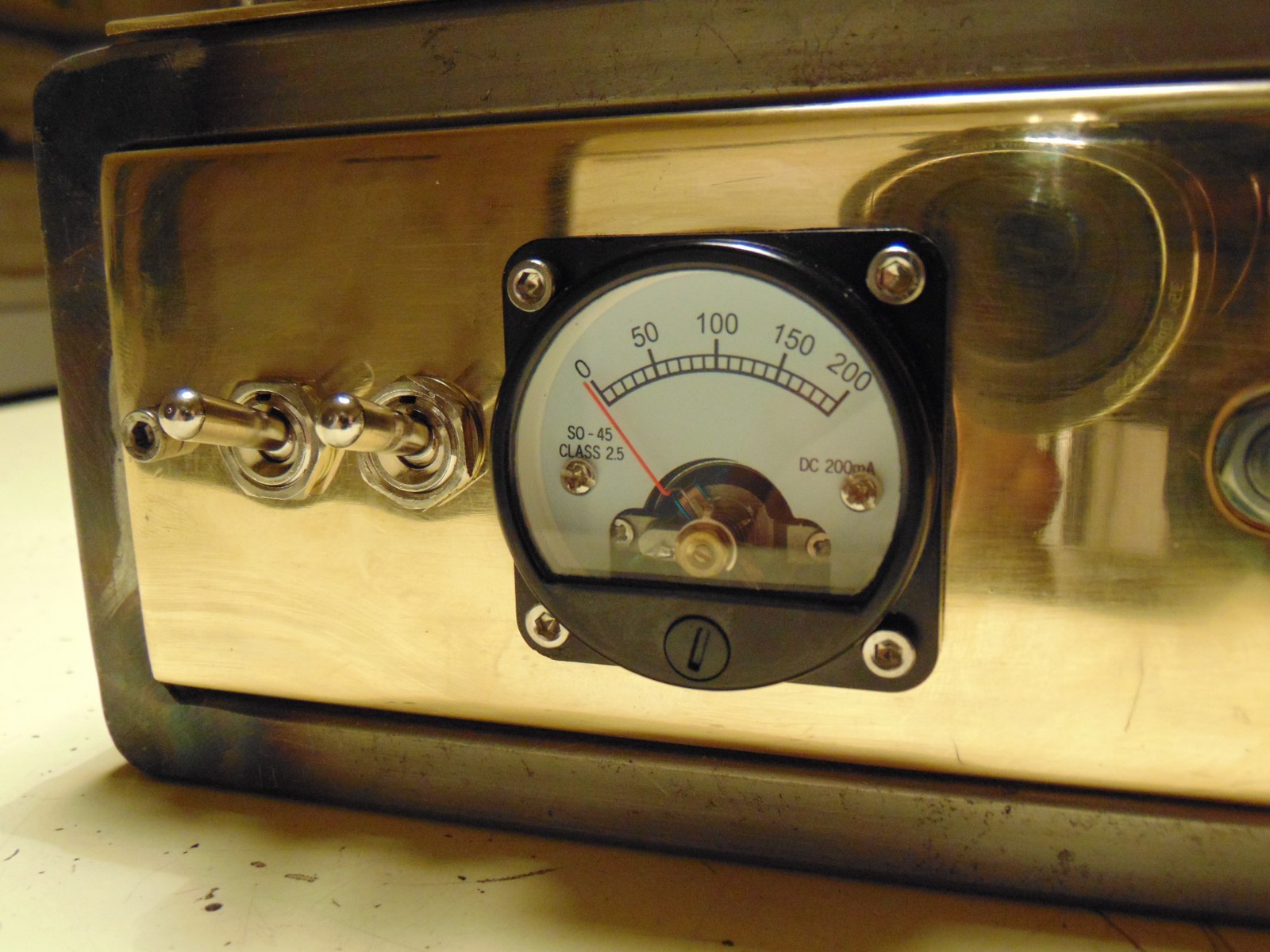

  12. #77
    Nov 2015
    Italy
    435
    451
    rendoman's Tools
    hi!

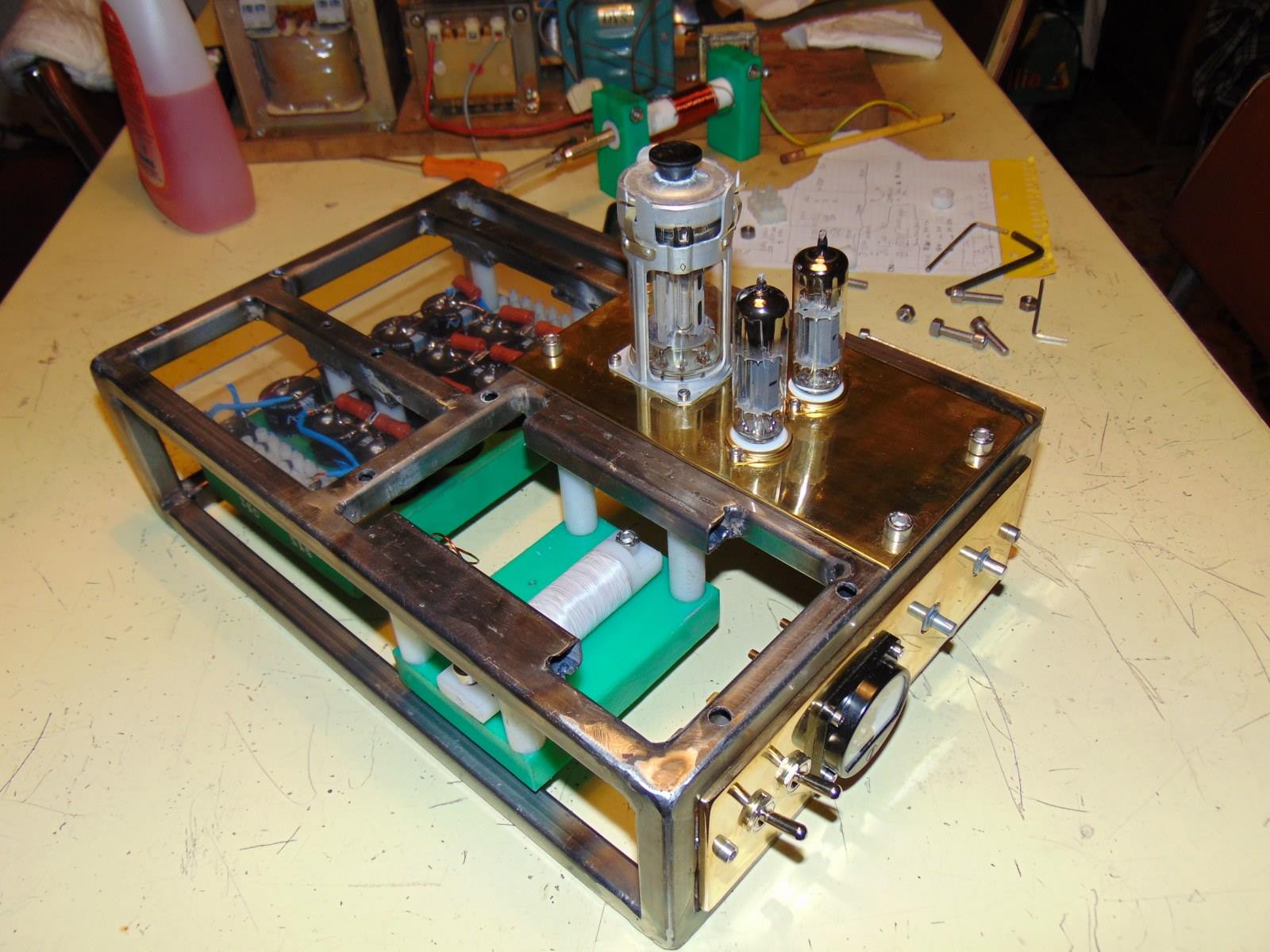

    small update again! I was a little busy, i only made a frame part helpful for keeping coil and last capacitor in position. I started to weld circuit, maybe a pcb can be more practical, i chose point to point. Hope Tomorrow I finish! Lot of time spent putting insulator and welding wire around, I have to think a better layout for the next plasma!
    In this days I'm better in kitchen! I made the queen of cakes: crostata peer and chocolate! imho the best cake ever made
    hope the next update i will show you some spark!
    In the plasma pics, the ensemble horn-chamber-primary coil and clamps is only for scene, I will drill the panel when i will sure that everything will be ok
    Good advices for a newbie (threading tools lathe)-12747465_10208546928973421_2529429518623668585_o.jpgGood advices for a newbie (threading tools lathe)-12747862_10208546928093399_3283671431692444416_o.jpgGood advices for a newbie (threading tools lathe)-12764466_10208552276747112_6750020651328125774_o.jpgGood advices for a newbie (threading tools lathe)-12771578_10208546928893419_2085507161477079480_o.jpgGood advices for a newbie (threading tools lathe)-12792087_10208562270316945_5444544371514090080_o.jpgGood advices for a newbie (threading tools lathe)-12792285_10208562270956961_2578374321460328034_o.jpg
  13. The Following 3 Users Say Thank You to rendoman For This Useful Post:
    C-Bag (Feb 29, 2016), Paul Jones (Mar 31, 2016), PJs (Mar 1, 2016)
