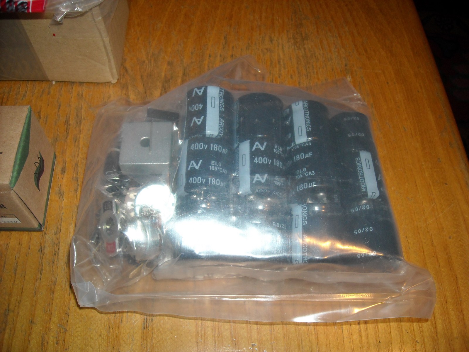

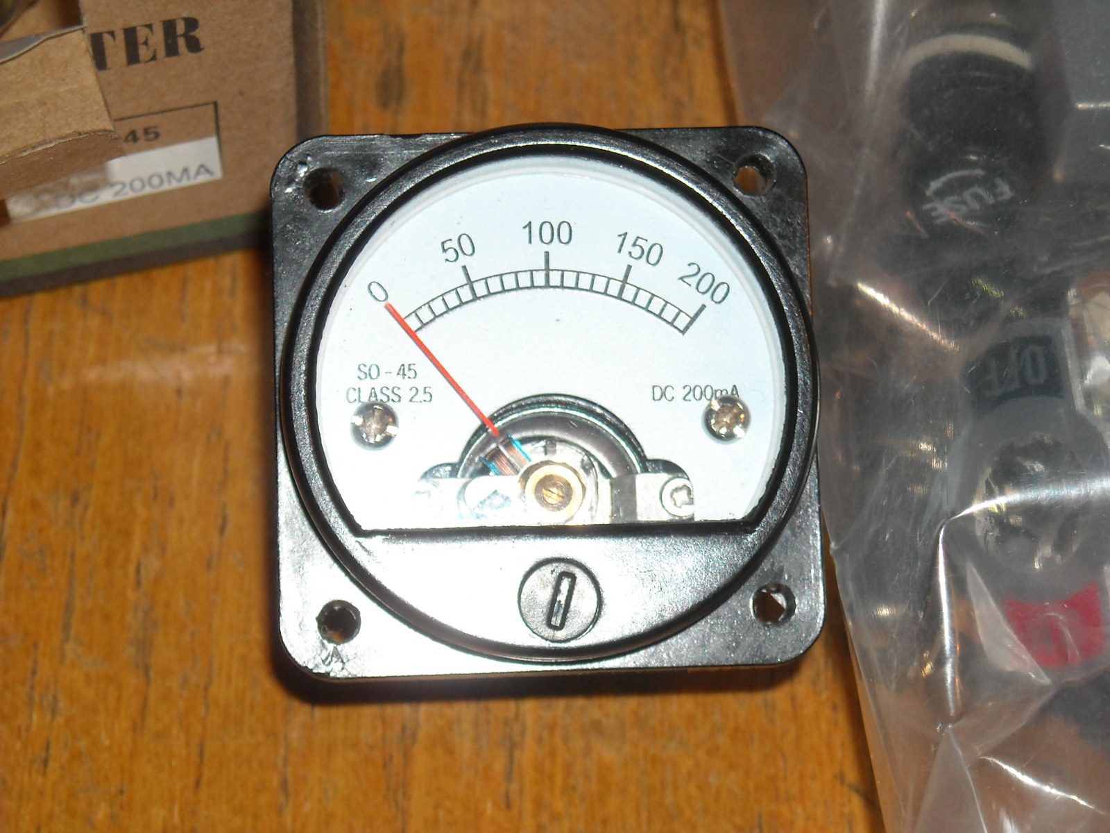

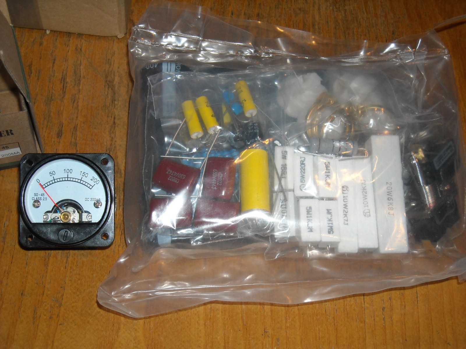

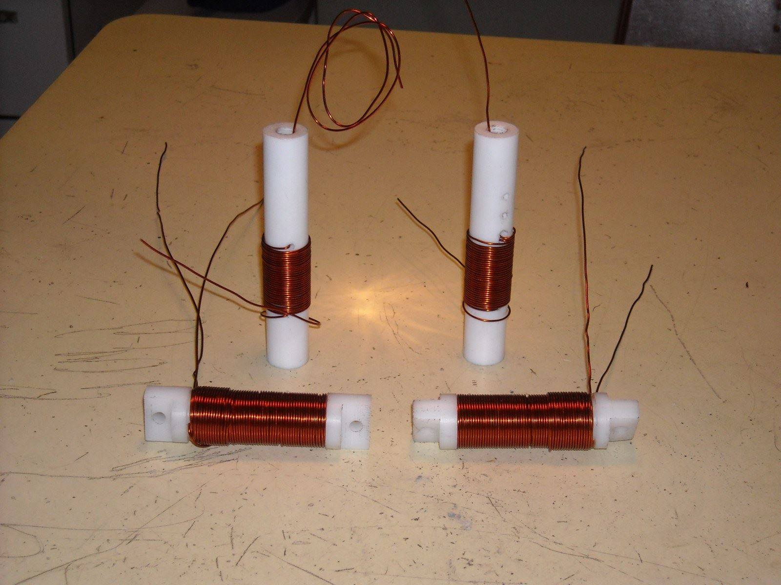

    today arrived all the basic parts, capacitors, resistors, sockets. i made coil in teflon - delrin

    Interesting design and nice work on the Delrin cores. Thanks! ~PJ

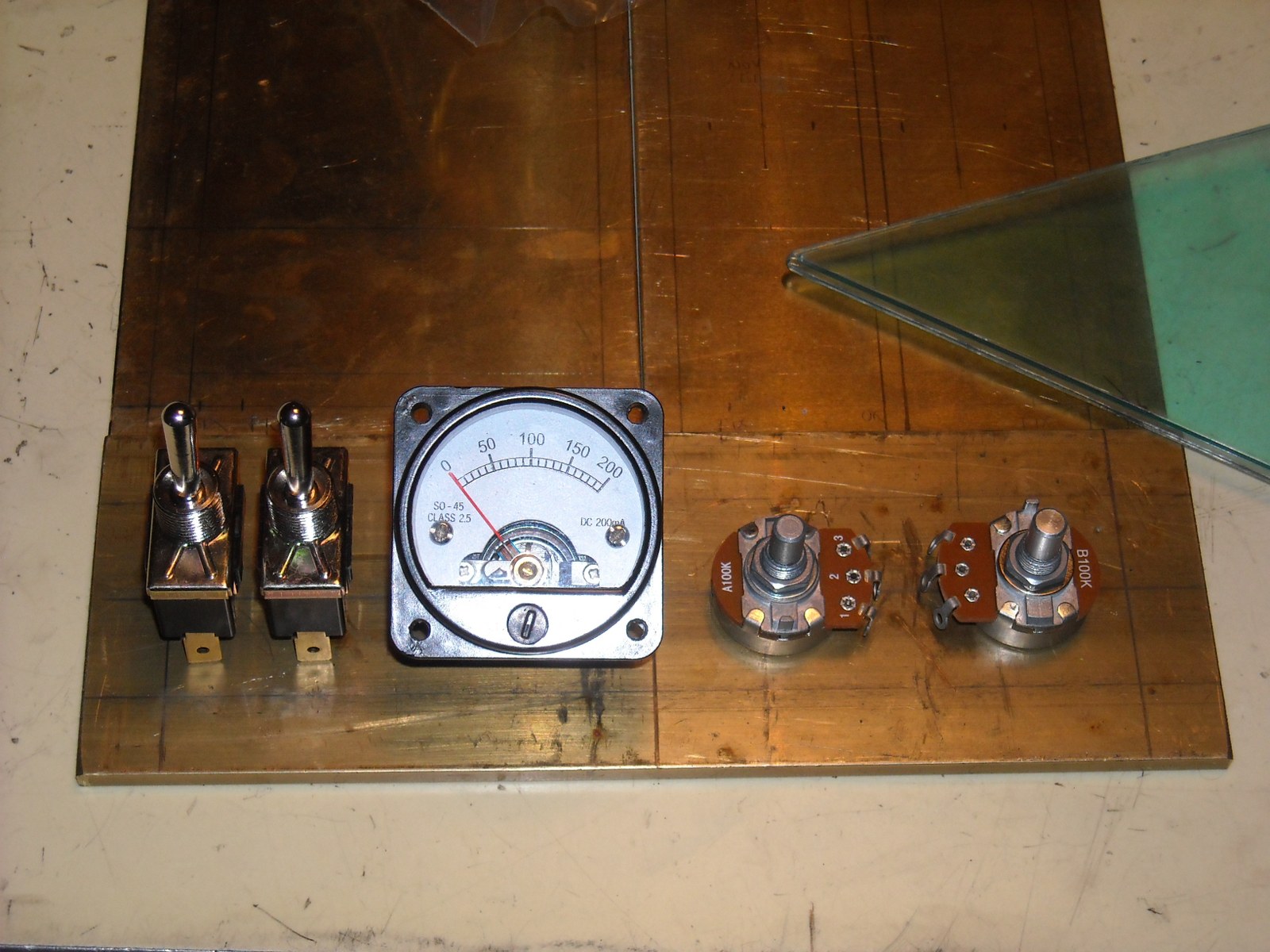

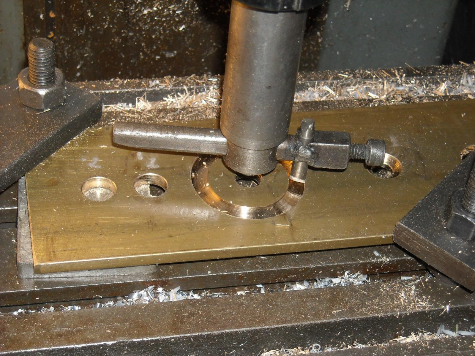

    after this lengthy discussion, i got some problem:

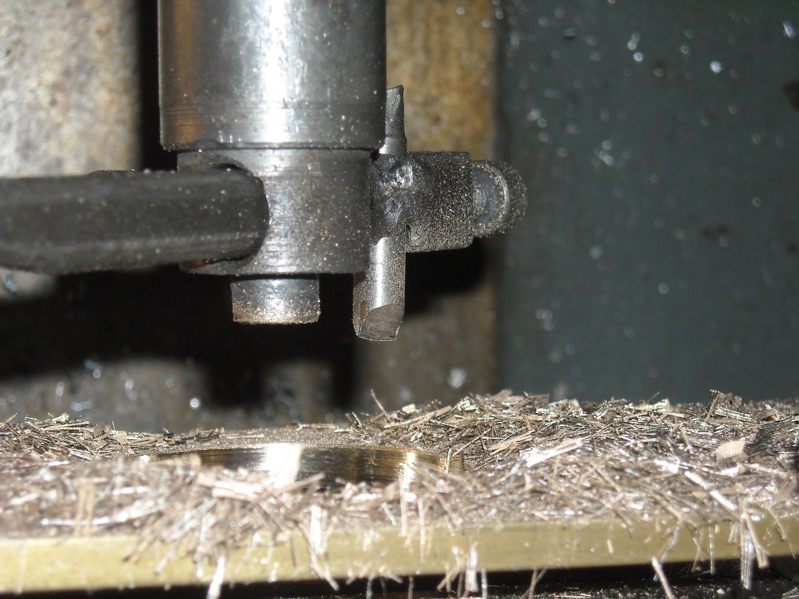

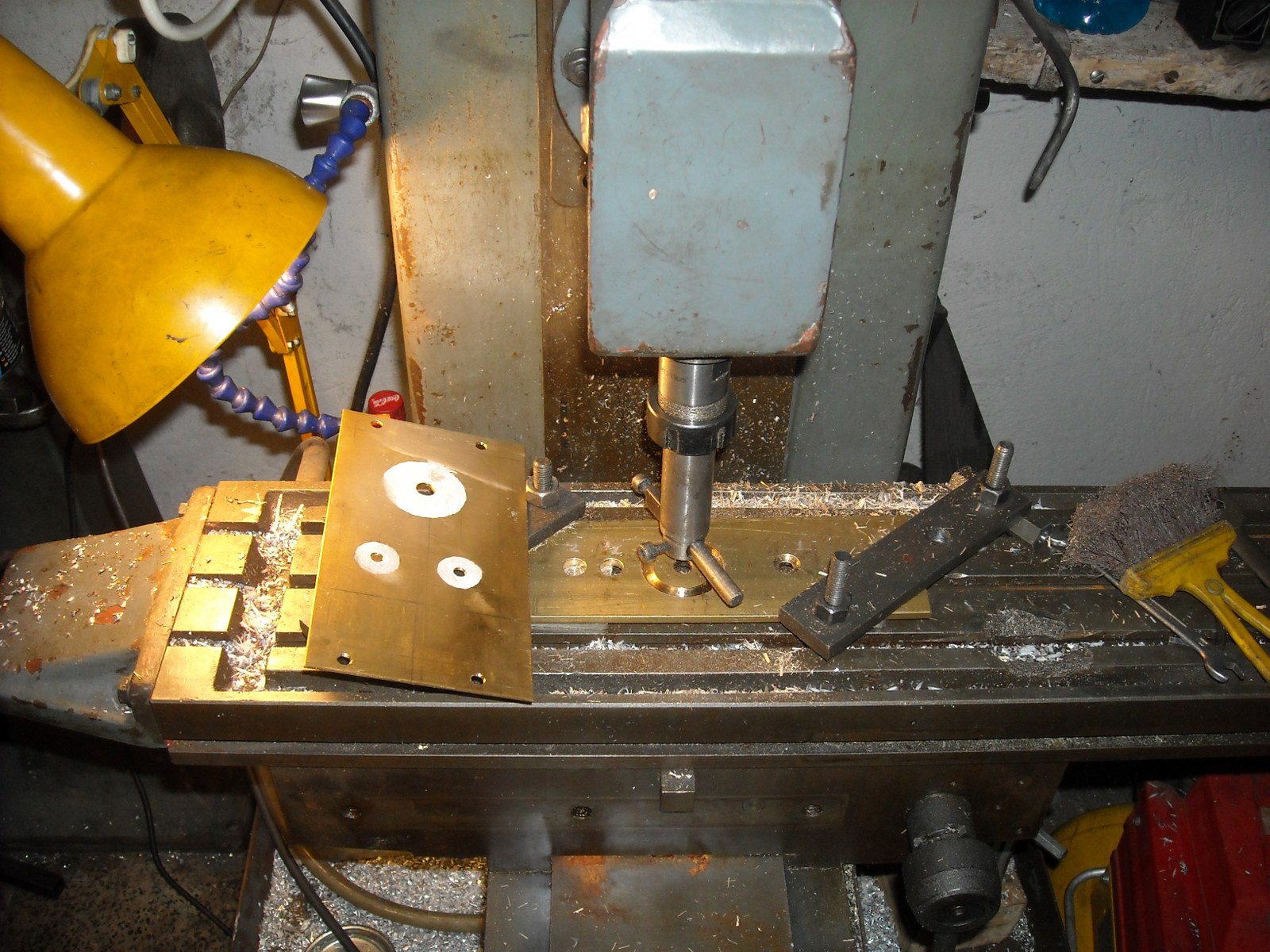

    I tried some hours ago to drill some 6mm brass plate, ugly as hell! I don't know why but with good drill, near to exit the hole, the plate tried to lift wildly. I found an old broken and bad repaired flycut (it's flycut the name?), i tried to grind a broken threading tools, it cuts "good", but make bad sound.
    I also have the impression that i should learn how to block parts on milling ...
    ok beat me, I deserve it I make bad works sometimes

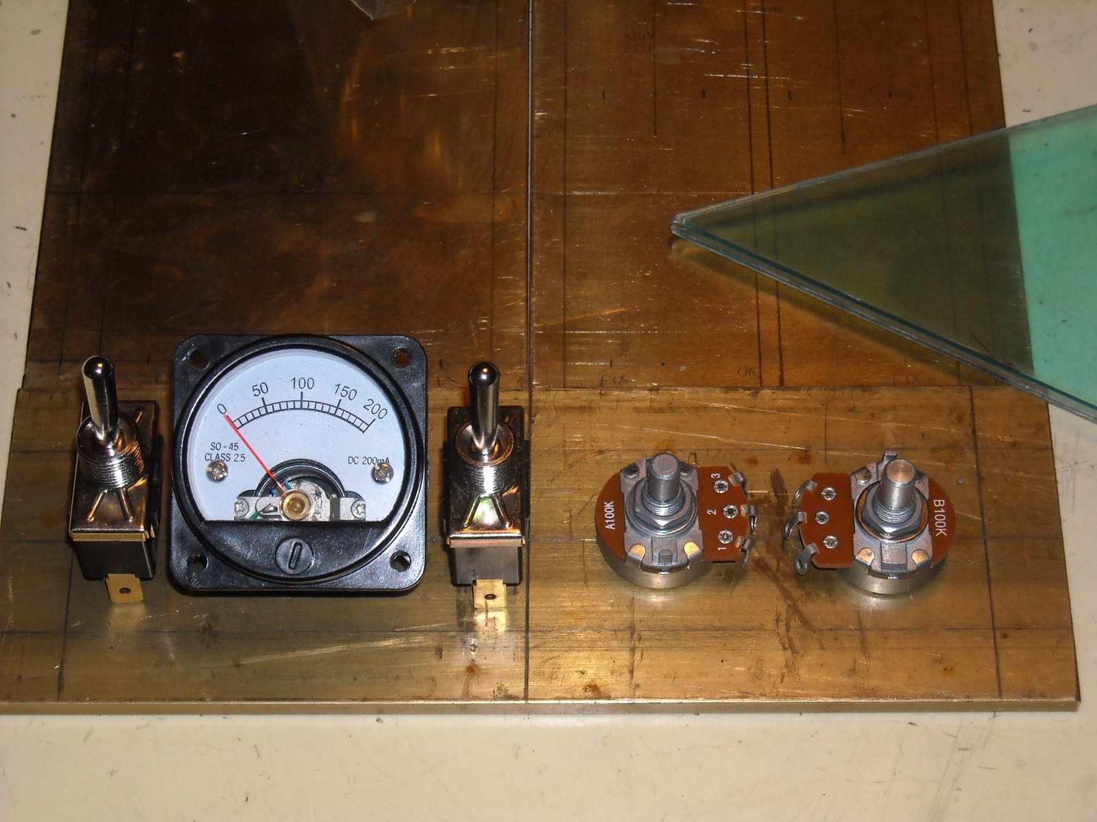

    a couple of new pic, i decided to put the 2 switch, one for filament and "low" 350v anode for modulator, and the second for the main B+ grouped to the left of ammeter. The big hole should be 45mm, in pic is 43mm.
    I think next days i will complete the stands for the finished horn, then i will make some more test

    As far as I know a flycutter is more for milling flat surfaces, not for cutting holes like what you are doing. Your hole saw is a good way to do brass/copper. I would grind the cutter itself to cut narrower and have a pretty flat rake to it. That's why drill bits don't work to well because they have too aggressive a rake to the cut. It's fine until like you said, the very end it takes too big of a bite and try's to destroy itself.

    Stefano: curious why you would us 6mm (1/4") brass plate for a panel mount? Although "Pretty", AL rack panels are my favorite and easy to work, and you could have a small piece like that gold anodized pretty cheap I would think. I agree with C-Bag about using a fly cutter for boring a big hole. Probably the other reason you got chatter is because of the air gap under the middle...would recommend a sacrificial piece of AL or even wood if you don't have that. Probably a better way would be to drill a large hole and use a boring bar to take it out to size. Don't know if you have one though and get using what you have on hand.

    Thanks for advices! I never seen in music or electronic shop front rack panel, but i see on some sites that they are cheap! a bit professional look, but practical! I used brass because i found some good plates from scrap shop. here it's difficult to find metals, hard to find metal in the size you want, and pretty impossible to find them at good price I really like sturdy frame, massive and good looking. For sure 99% of my projects are oversized!
    It's work for next days, the frame will be composed of:
    - steel 15x15mm thick 2mm for the real frame
    - top plate frame (base for the 3 tube socket, for transformer, horn and primary coil) in 1,5mm brass, 2 parts wide 10cm each and 35 cm long
    - 316 perforated steel as faraday cell for coil ( have to think how to bend and create a nice looking one )
    - bottom and lateral, for cover and shield, steel or alu 8\10
    I think it's a bit difficult to imagine the frame, i got all in my mind, i will show you soon! ( i hope! )

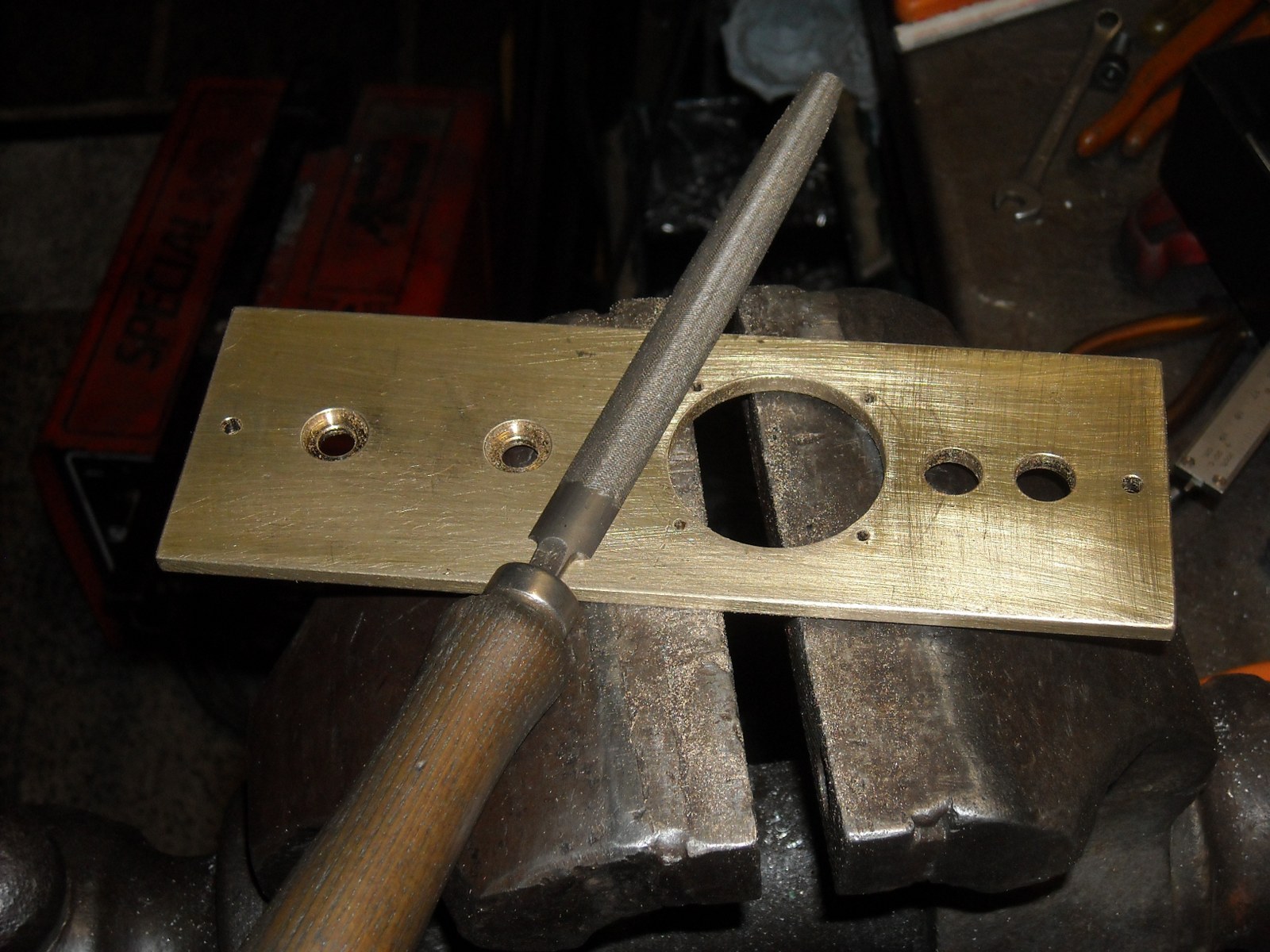

    to be honest, i only have two broken and repaired old tools, one is in the last pic (and it's the only one that make big holes), the second is a boring bar in fact, with a small square blade, i think it drill till 22\23mm, but the body of the tool require a large hole to fit... for sure my method is wrong, but i think i need to make some other tools.... but we here in the right place for making tools right?
    I took a macro of the blade after work... maybe because my fault, i let the tool gets blocked 3 times, i missed the outer part of the blade... but it's still working!
    For the next holes i'll follow your advice to grind better the tool, and to put some wood under the plate, you're right i leaved too much air... i didn't want to hurt the milling machine, basically i'm noob
    and in second pic... ready for polishing again!!

    Watching this thread evolve it's funny how you say it's hard to find the metal you want at the price you want, but you always come up with some good looking stuff. I would recommend an import clamp kit and probably a 4" knock off Kurta style vice both for the mill. They are basic tooling for the mill and make work easier and safer.
    Making an enclosure for a custom piece of electronics is a real challenge. I've only done one and that was enough. I bought a strip unit of 4 mic pre's out of an old Quad 8 mixing board. It supposedly came out of a board that was in a famous recording studio in LA. I had a really hard time finding a case and then fabricated a front panel for it. Came out looking very vintage I put the power supply in its own box, out board for isolation and because it was too big for the case.
    When I was working as a mechanic/ fabricator/welder in fruit packing here in the Central Valley of California, I was always up to my neck in metal. And I could take home scrap out of the recycle bin(within reason) for free. The last company I worked for had a HUGE what we called "the bone yard" that was full of out dated equipment. There was probably 10 huge rack cabinets complete with rack rails, mounts, and screws. But even though I was not that great of a wood worker, I ended up making my racks out of wood. Because I didn't want to have to isolate each unit from the rack because of ground loops. I've made several racks for my PA and recording equipment and all the rack units were wood rack rails. Never had any problems with ground loops, hums and buzzes.
