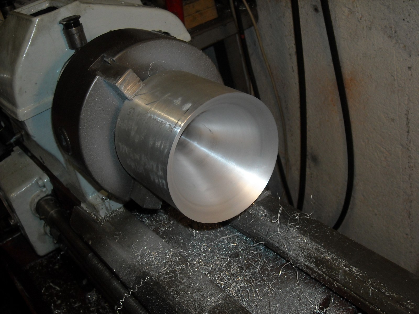

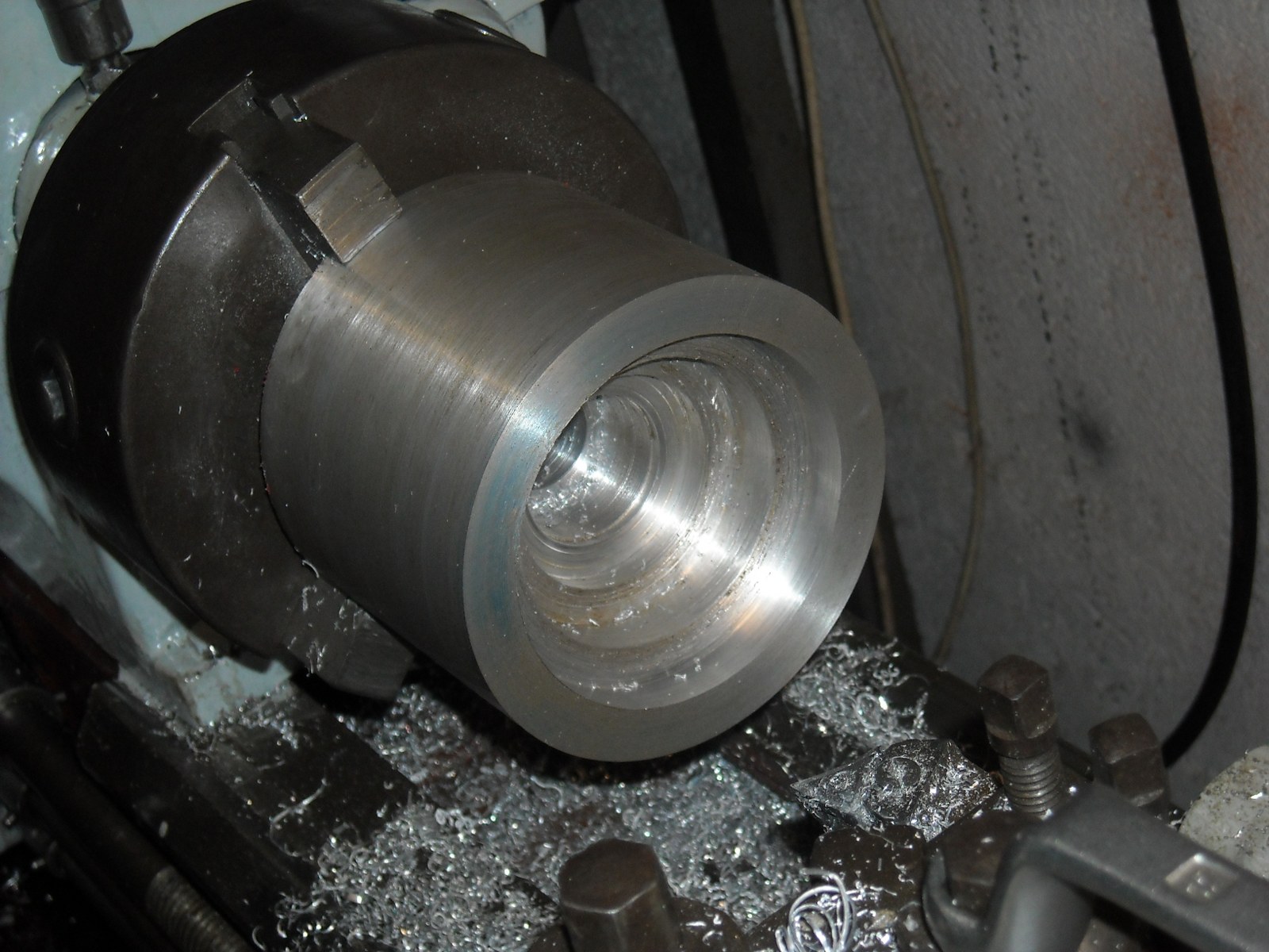

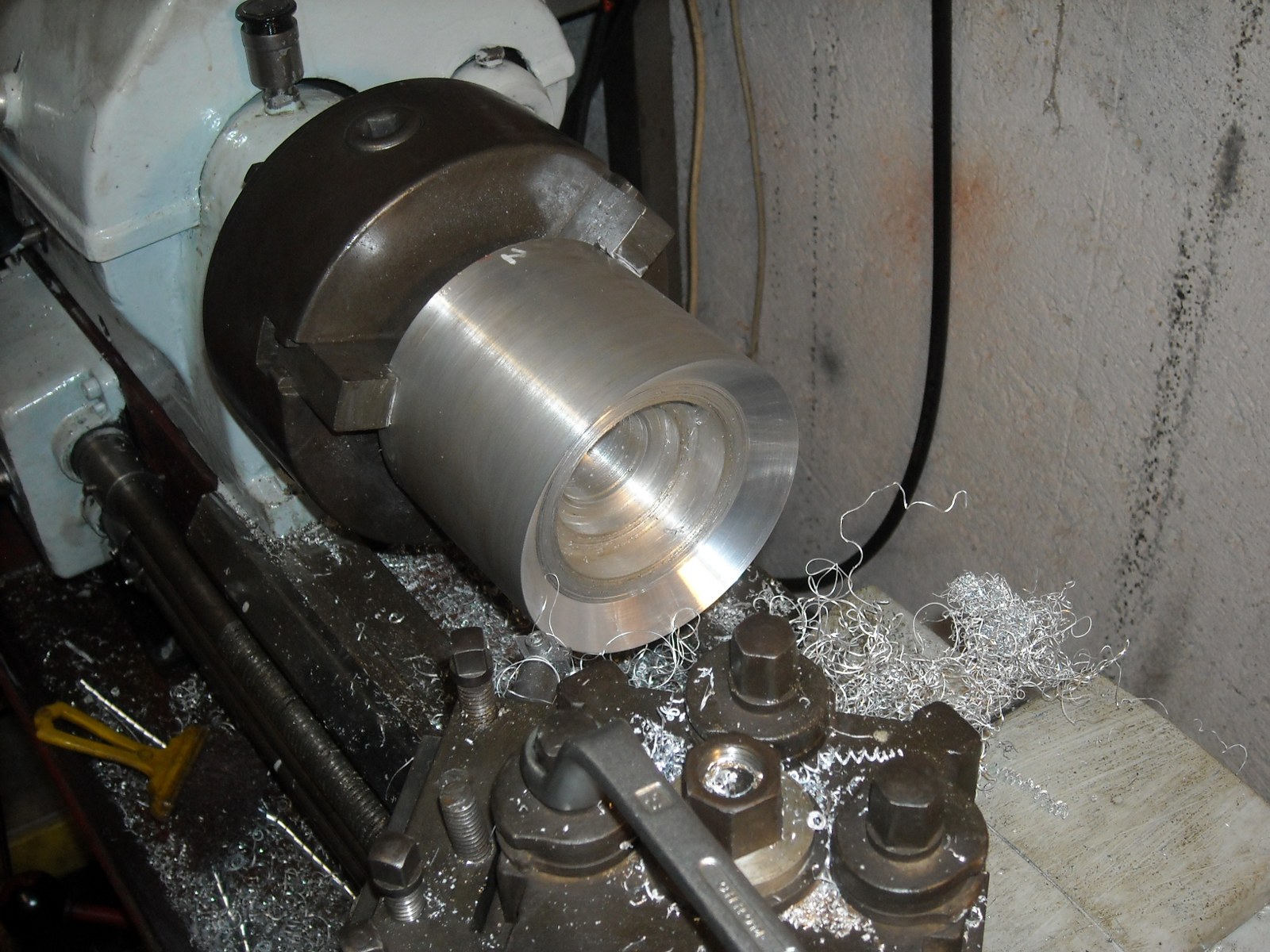

    I tired the boring bar... not to excellent, the perpendicular insert cut better, but there is something wrong in angles. with long arm (12cm) it vibrates like a dildo of sasha grey , very poor finishing, but good for cutting lot of alu. with short arm (6cm) no great vibrations, better cut, poor finishing. i tried to cut 2mm each time at dia, maybe too much.

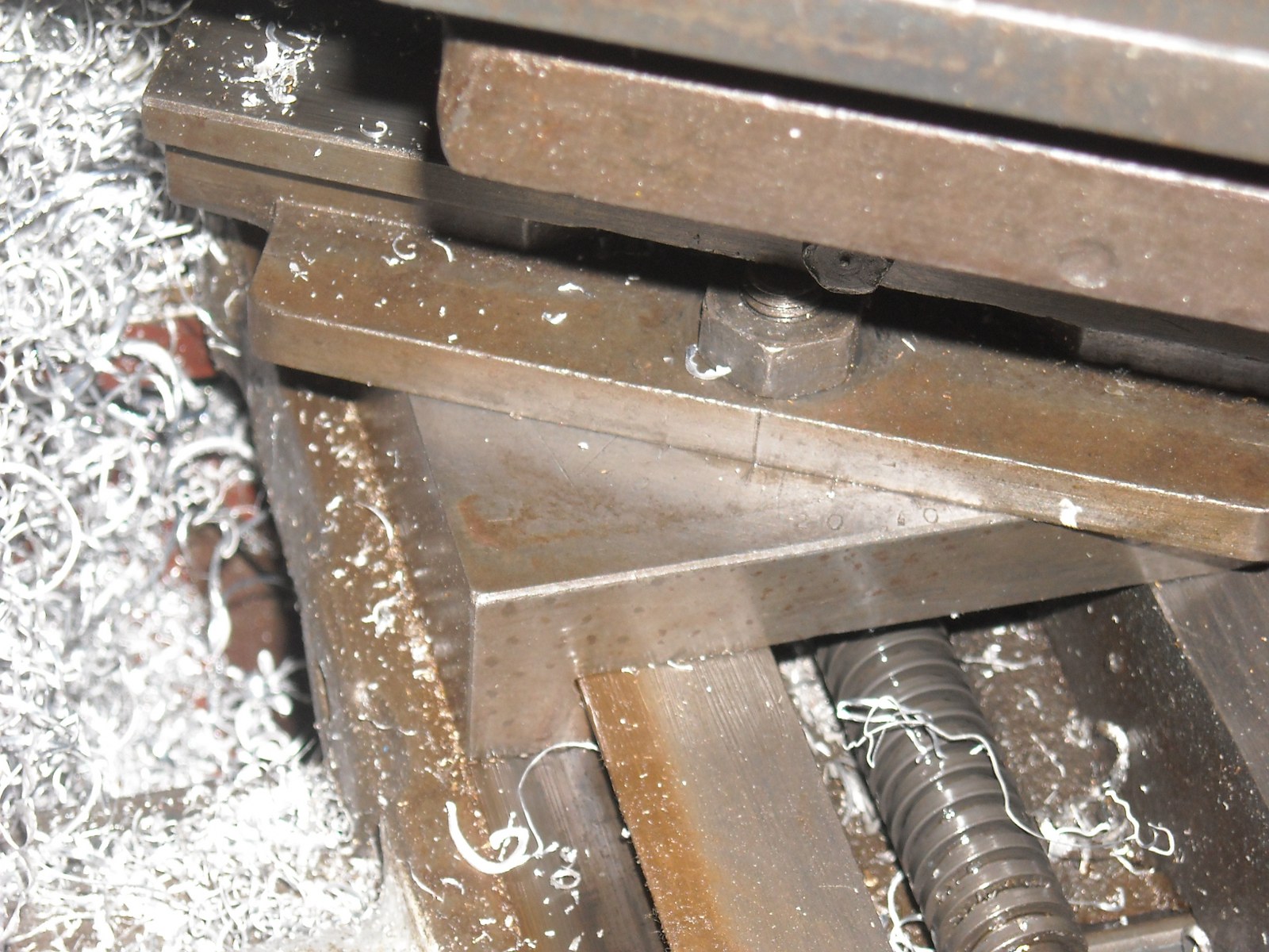

    Strange thing, i used a Seco boring with triangular insert (Tomorrow i'll take a pic), got some problem with finishing with angled turret, maybe something to setup (gib?).
    I got another little problem, protractor engraved under turret is semi-erased as you can see, some good and easy way for engraving a new one? yes, this lathe is pretty old and used.
    You're right, when i studied for the tweeter horn i read that the final edge should be sharp. i left the first pair of horns with cm more than designed for trying the "round" final edge. if something didn't go well i might change the final edge easily. At listening even with round edge are not bad. now i got microphone , for sure i can make
    measures and then try the correct profile.
    with this new horns i followed different path, i got alu in right diameter for the profile, no more cm to use, i can only cut some thents for finishing, as you can see the exit angle is sharp.

    The other thing I prefer is to use hi-speed steel on aluminum and a fairly generous radius will give a much better finish. Aluminum can be a bit gummy and the radius makes the contact minimal so chips are easily discarded. A sharp tip angle will give problems if you have run out or slop in gibs or rigidity of the holders, compound or cross slide.
    I think you've hit the issue! Tomorrow i'll take some pics of the inserts, maybe the angle is too narrow, combined with vibration and other things the finishing is not good. I tried a (brazed?) tool 20x20, but the result is similar... maybe something wrong in setup of lathe

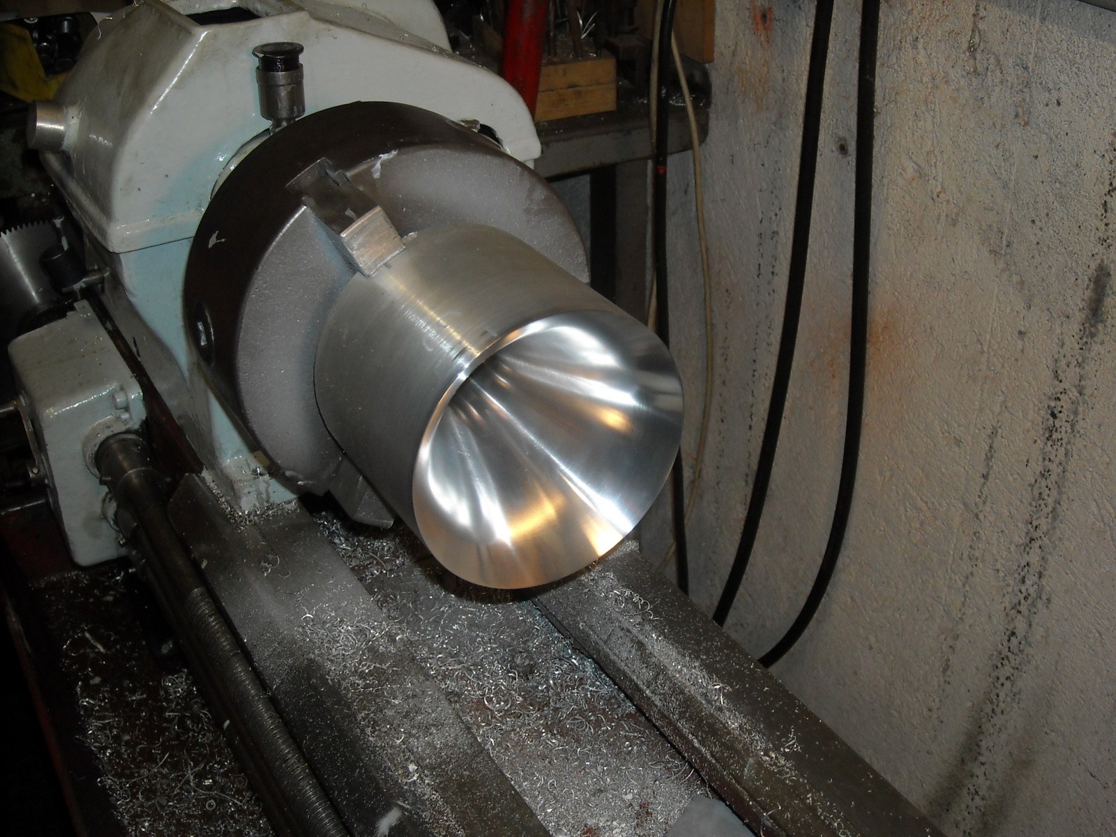

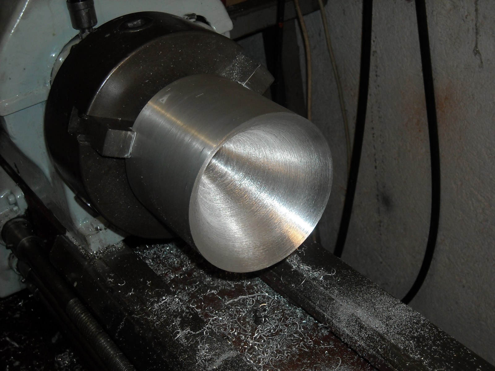

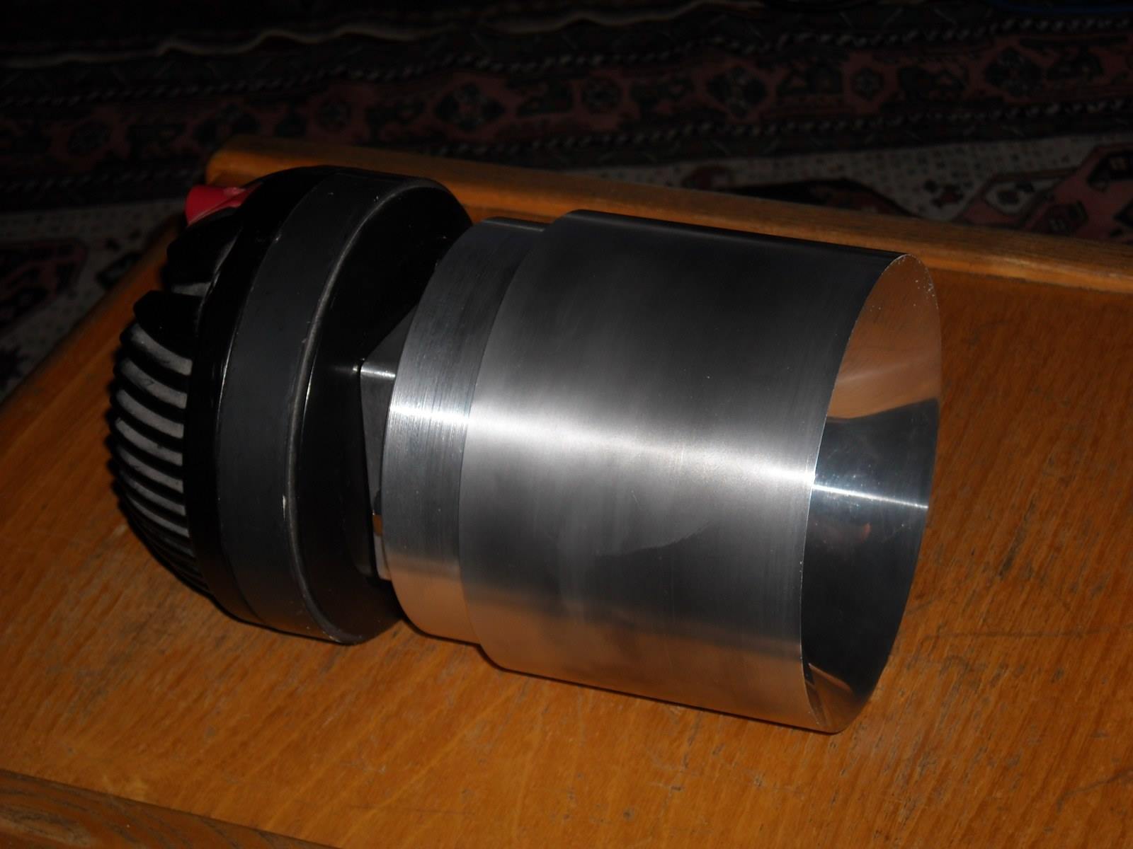

    et voila!
    Past few days i had some problems, above all the breaking of cesso (wc)

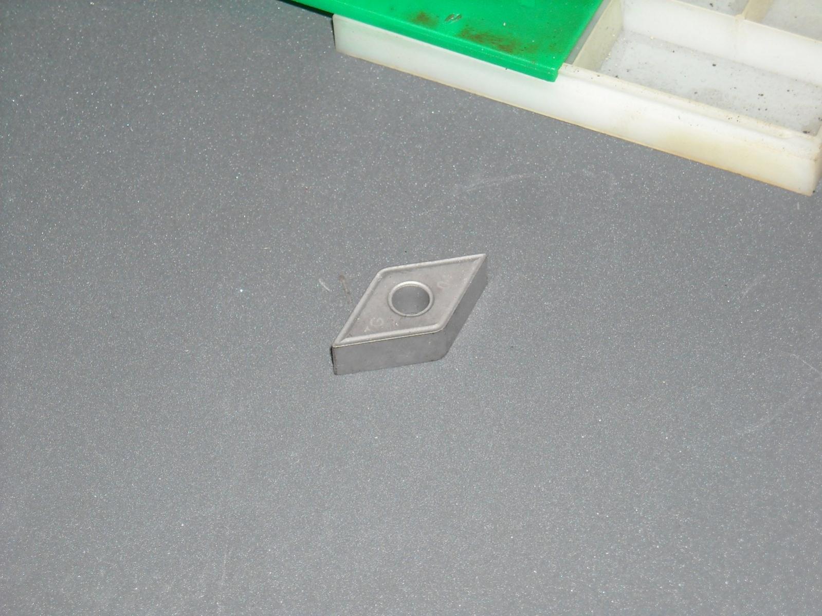

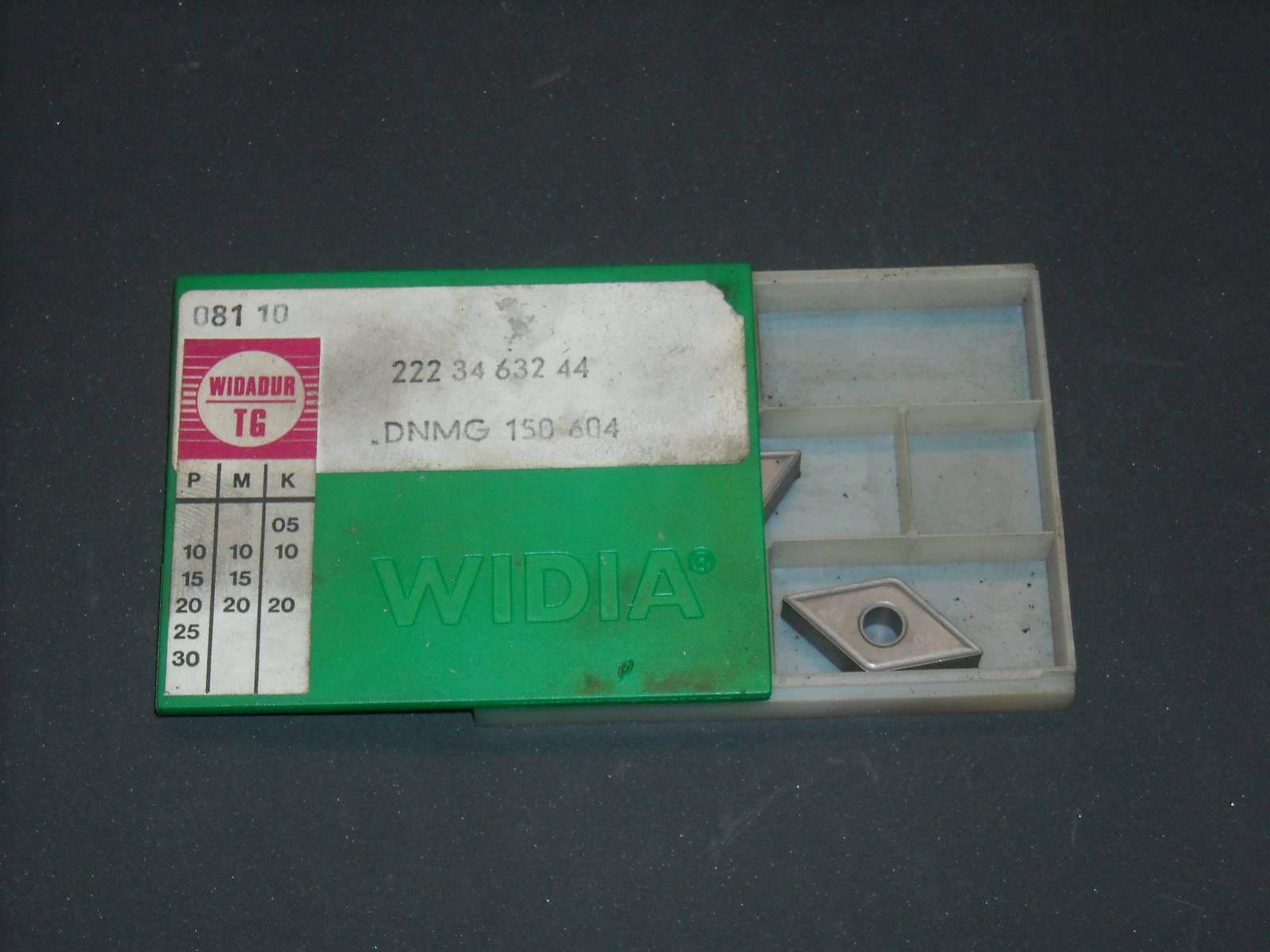

    I take some pic of the inserts, i don't know what's the best use for them.

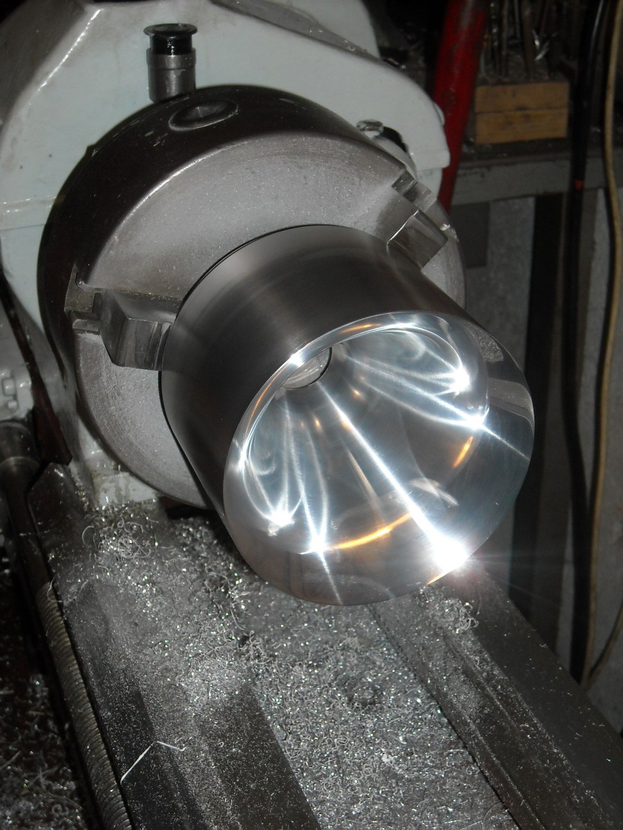

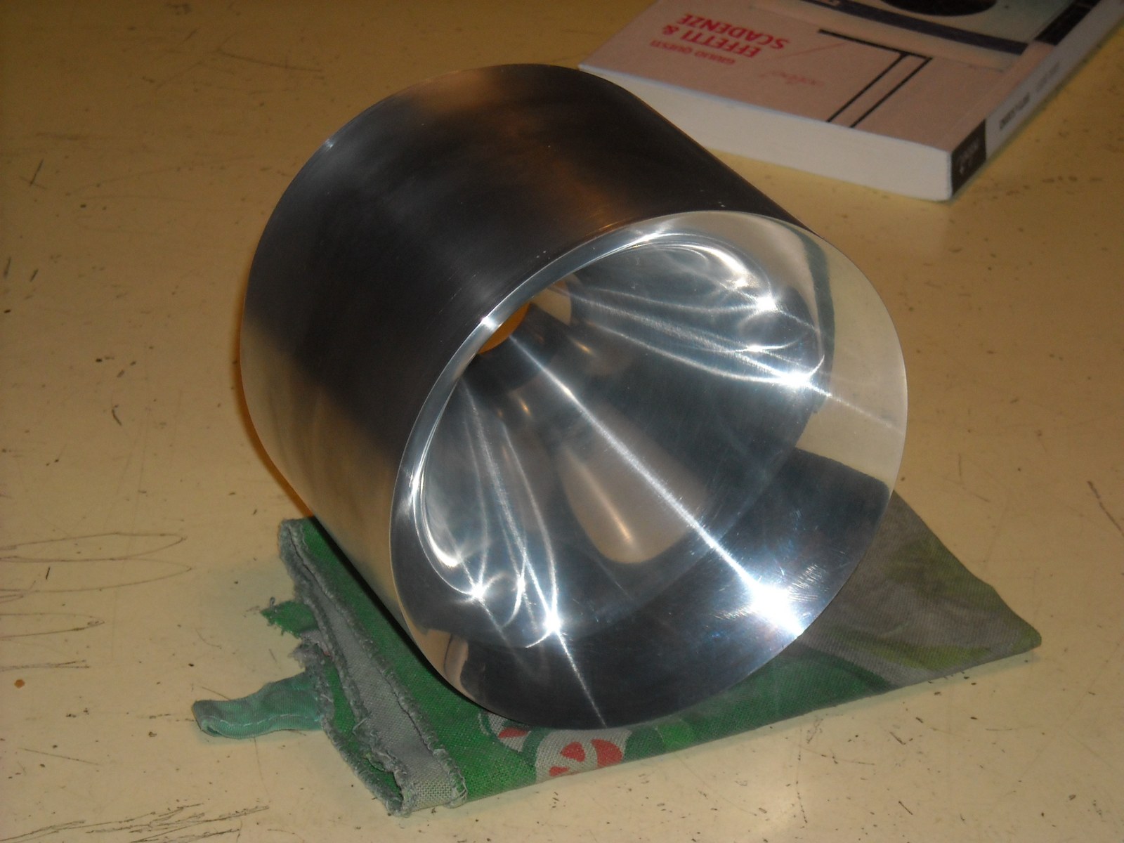

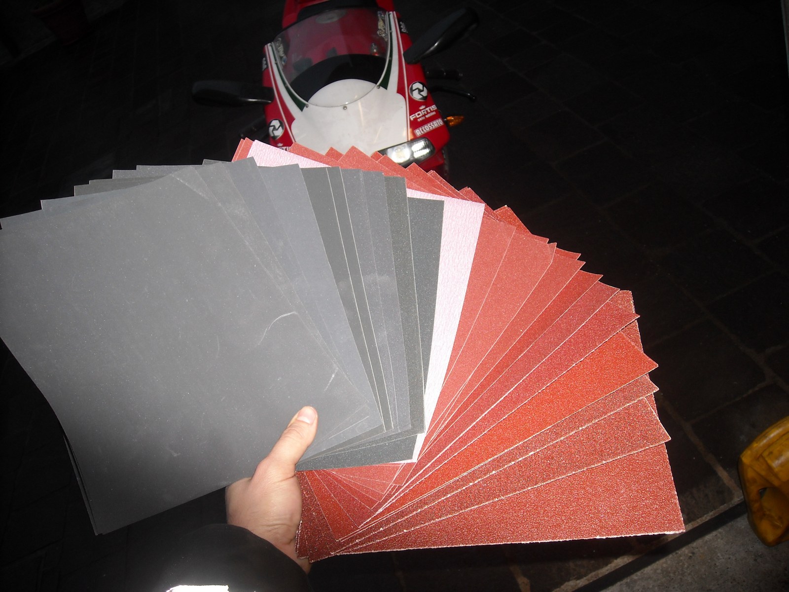

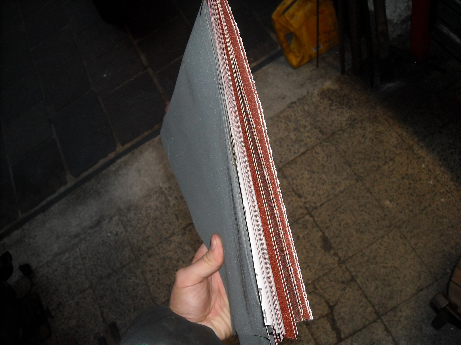

    I tried to polish the horn with sand paper from 40 to 1200, but i found some problems. Sometimes maybe some dust from paper left ugly signs during passage, and the second, more important : i need to learn polishing
    i tried with horn on lathe to put some white paste (i think the first of available in grit), difficult to apply because the shape, it sticks like glue to the inside of the horn, forcing me to remove with a wooden piece. the last pic is White + polish for car , not enough for me, it doesn't shine! it's something between satin and glossy ...
    someone has some good advice?
    thanks!
    saluti
    stefano

    Hi Stefano, Thanks for the update...sorry to hear about your plumbing problems...
    As for the inserts: These inserts have 0º rake (clearance angle) and in my opinion the .4mm (1/64") radius tip is way too small for a good finish. Here are some links to the Widia Pages for your inserts. Here is a chart for the Number description (Pages F8 & F9) to figure out what you have. D=Romboid, N= 0º clearance angle, M=Tolerance Class, G=Features (chip relief) etc. Yours are listed on page F13 at the top.
    If these are all you have the only thing I might recommend is if you have a diamond stone you might Try to adjust the rake to 10-15º and give it about a ~1-1.5mm radius. This is approximate to what I use (final couple of passes) to get a pretty good finish to start polishing...but again I prefer Hi-Speed steel to carbide on aluminum.
    Polishing: My experience is that you work a grit until you have a very even finish all over, then move to the next grit up...to say 1200G which should be fine. If you are having a dust issues use a tiny amount of water on the Wet or Dry 1200 paper. I have some 3000-10k grit foam pads I use once in a while but typically don't need to. For aluminum and brass I always use Simichrome on a soft lint free cloth, as a final polish...best I have ever found...and tried a lot of fancy hi$$ stuff. Should be able to find it in good hardware stores or automotive store, even in Italy. Think it used to be made in Germany (Happich)?...its everywhere I think.
    Hope this helps? Good Luck!

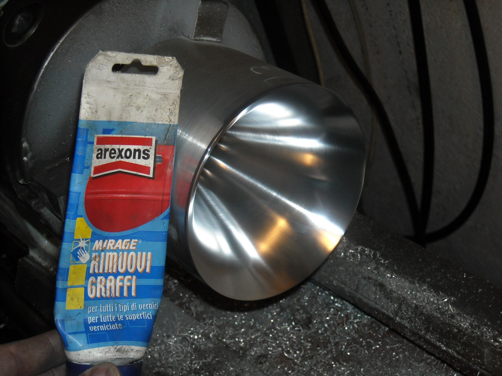

    Thank you very much for the info PJs! I will focus on angles and good steel!

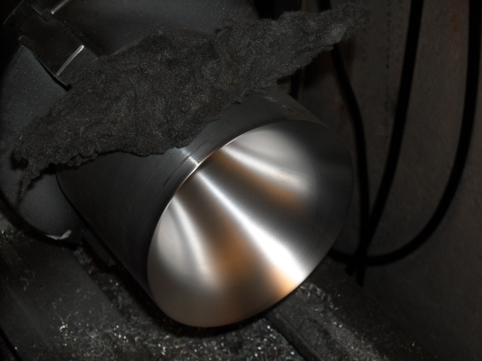

    I think Tomorrow i'll try to find some simichrome or other italian available compound, i tried some minutes ago from start, adding ooo steel wool, some better result, but nothing of special
    1200 grit, old photo
    000 steel wool
    "polish" with cotton cloth, 3 hands

    Looking Good Stefano. Hopefully you can find some Simichrome and can rework you inserts or some HSS ones for the other horn. Looking forward to your test results! Thanks, ~PJ

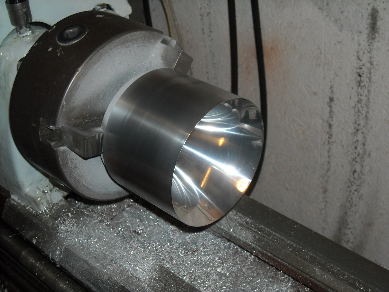

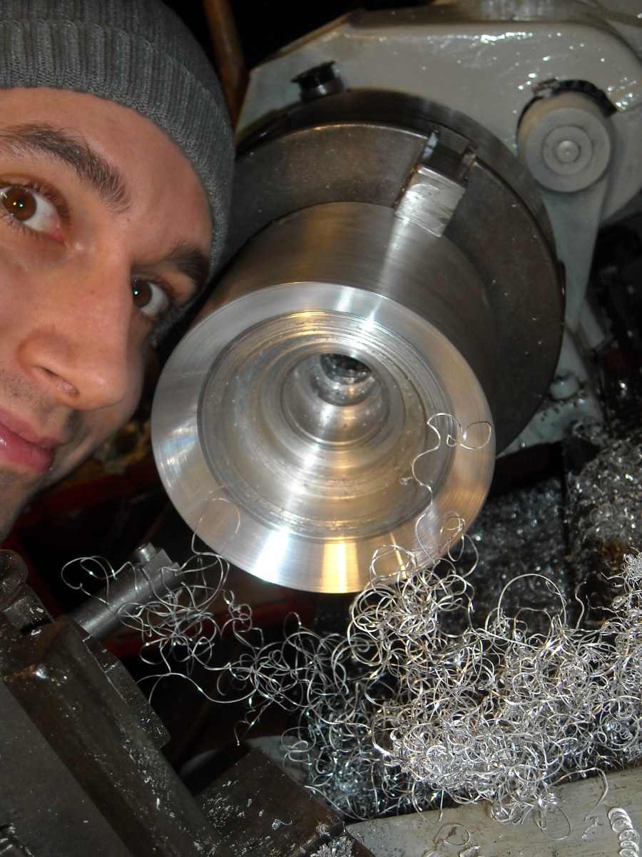

    I went to the dark side 6cm drill buffer, and a home made not good small buffer for the inner part... i hope monday i will find some better commercial new one. polishing with drill maybe it's the better way to do this job, now the horn is shining more than in photo. I hope i'll finish the first flange and do some test! See you on the next episode

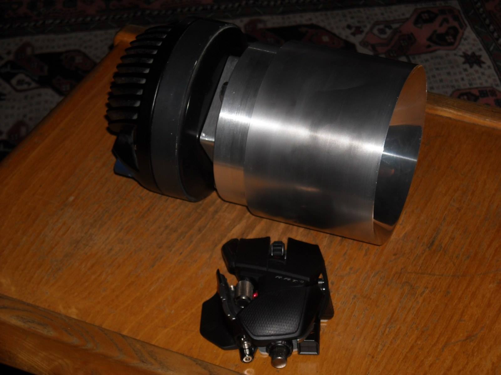

    I still have difficulties finding a tiny buffer for the small inside of the horn, dremel cloth insert are too short and I see that for polishing i need to press a lot. I will have the same problem for the next small horn of only 1cm throat ... i need to find something!
    apart polishing, i mounted driver-flange-horn for some test, sound is really good to my ears very detailed and focused! i build a simple rod for microphone, i'm waiting the key of a beta test program (medianet audio pro solution), hope that program is easier than "speaker workshop" who needs specifics cables with test resistors and an Lcr bridge.

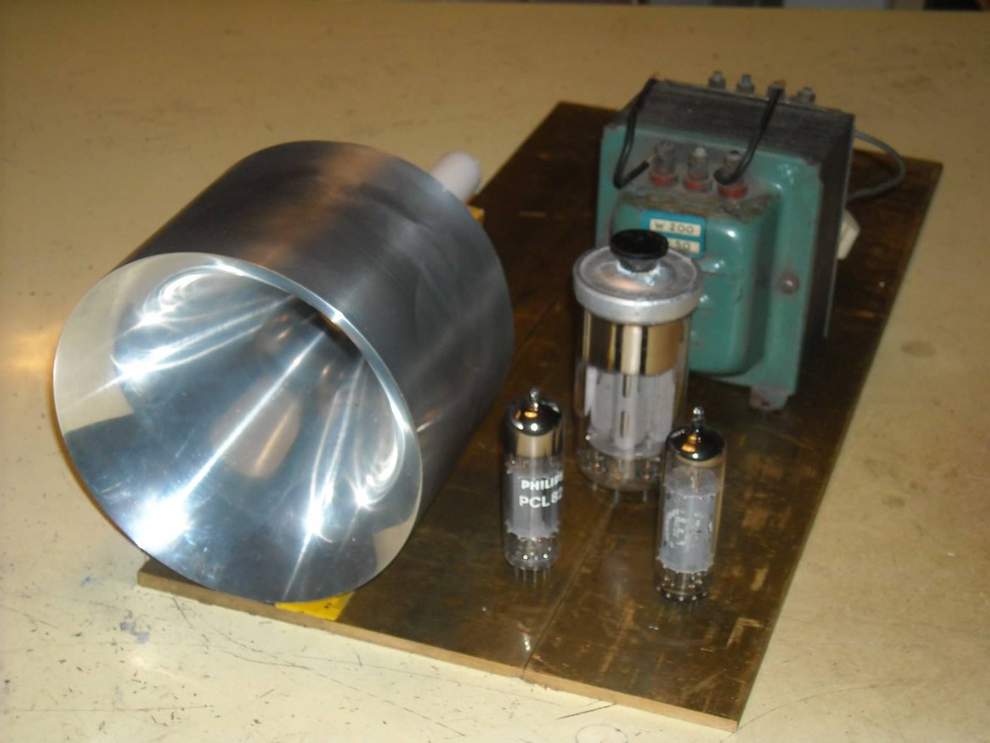

    OT: i'm planning a plasma tweeter

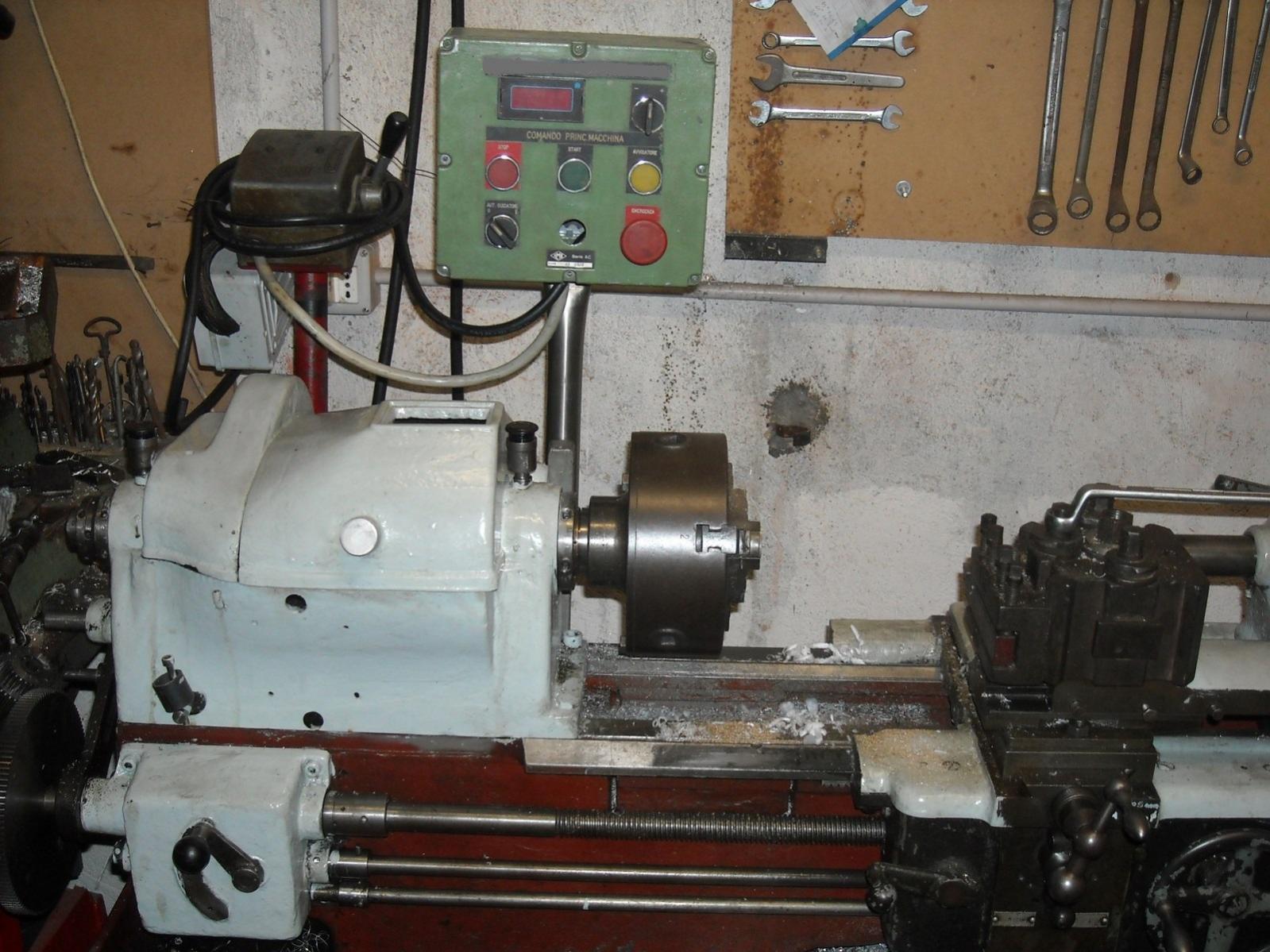

    OT2: i found a box with Emergency button in scrap, i added last night a contactor, need a bulb light for voltage presence. I mounted on my lathe, it didn't have the Emergency stop
    some pics as usual, the third photo is a generic layout of the new plasma speaker (horn will be 1\3), fifth pic it's a rat9 big mouse for size comparison

    Funny, i was just wondering about what happened to you yesterday Stefano! I guess that cold shop got to you I'm glad you are over your flu and back at it.
    Good pix as usual. As to a polisher, have you seen those special polishing balls for polishing aluminum wheels on cars. I think they have tapered ones.

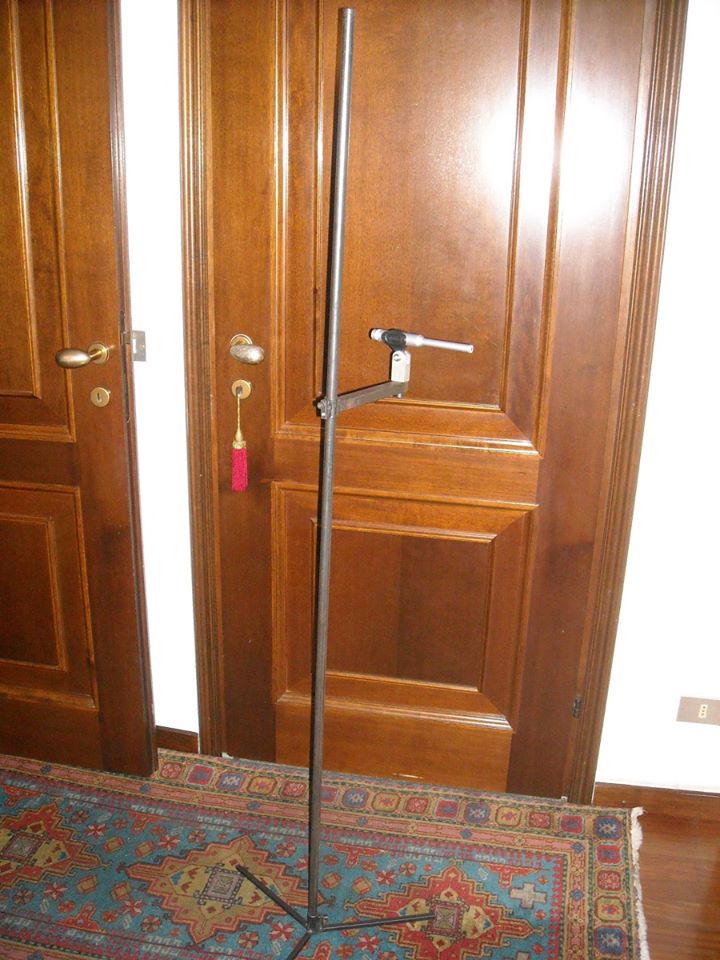

    I have one of those Berhinger mic's and I believe because it's omni directional, it needs to be mounted vertically. I could be wrong. The whole sampling/testing/pinking the room is a very tricky thing I learned from my buddy who does pro sound for a living. From what he told me you have to be kinda close to get more of the speaker and less of the room. Im sure PJ's knows more about this than I do and will be along soon and enlighten us both.
    Great score on the control box/ emergency stop! What a find.
    What I'm wondering is how to make some kind of pantagraph/ duplicator for your lathe to duplicate the next horn. I would think it pretty critical to make them the same. Anyway good to see you back, carry on!
