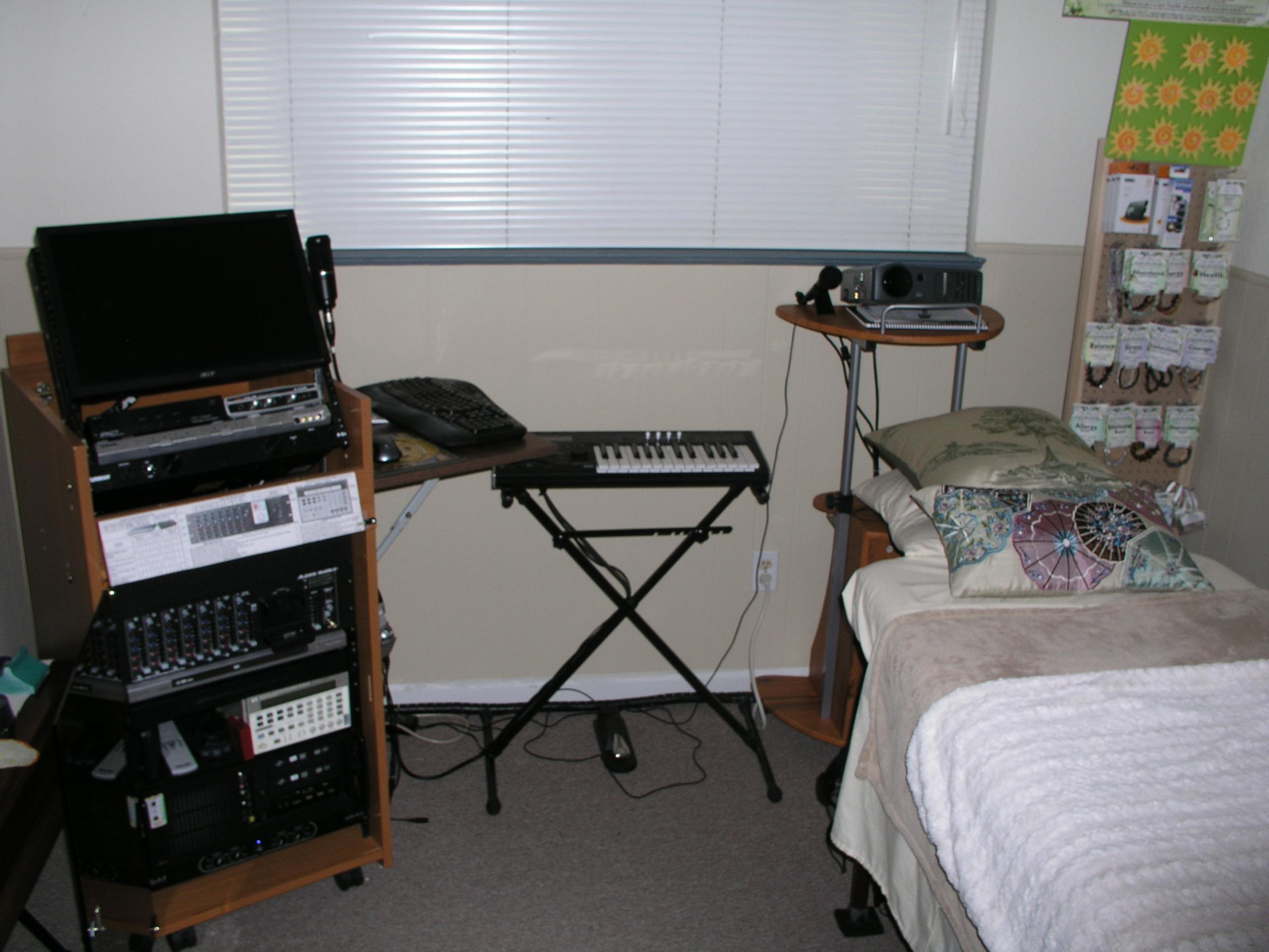

    Sound has always been fascinating to me and partly why I built my sound table and HAWK delivery system. Whether it be listening, meditative or healing, I have a Strong Sense that Edgar Cayce was right with his point that "Sound will be the medicine of the Future".
    Here is a picture of my HAWKs system. Note in the middle of the rack is an HP, 4 channel signal generation that works from DC to 600Khz and the ART SLA-4 amp at the bottom. The other pic is in our clinic (now closed) and shows the Korg attached...one of many delivery systems including 5.1 Surround headset driven optically.
    Good advices for a newbie (threading tools lathe)-hawks_full_web_w_logo.png Good advices for a newbie (threading tools lathe)-p3160066.jpg
    It's now in storage and may donate it to the VA one of these days...when I'm ready to let go of it.

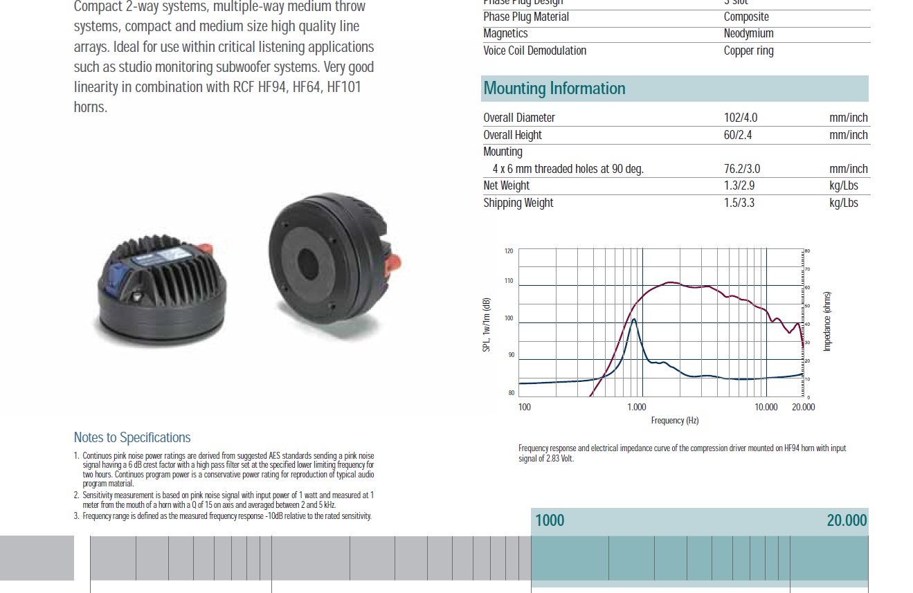

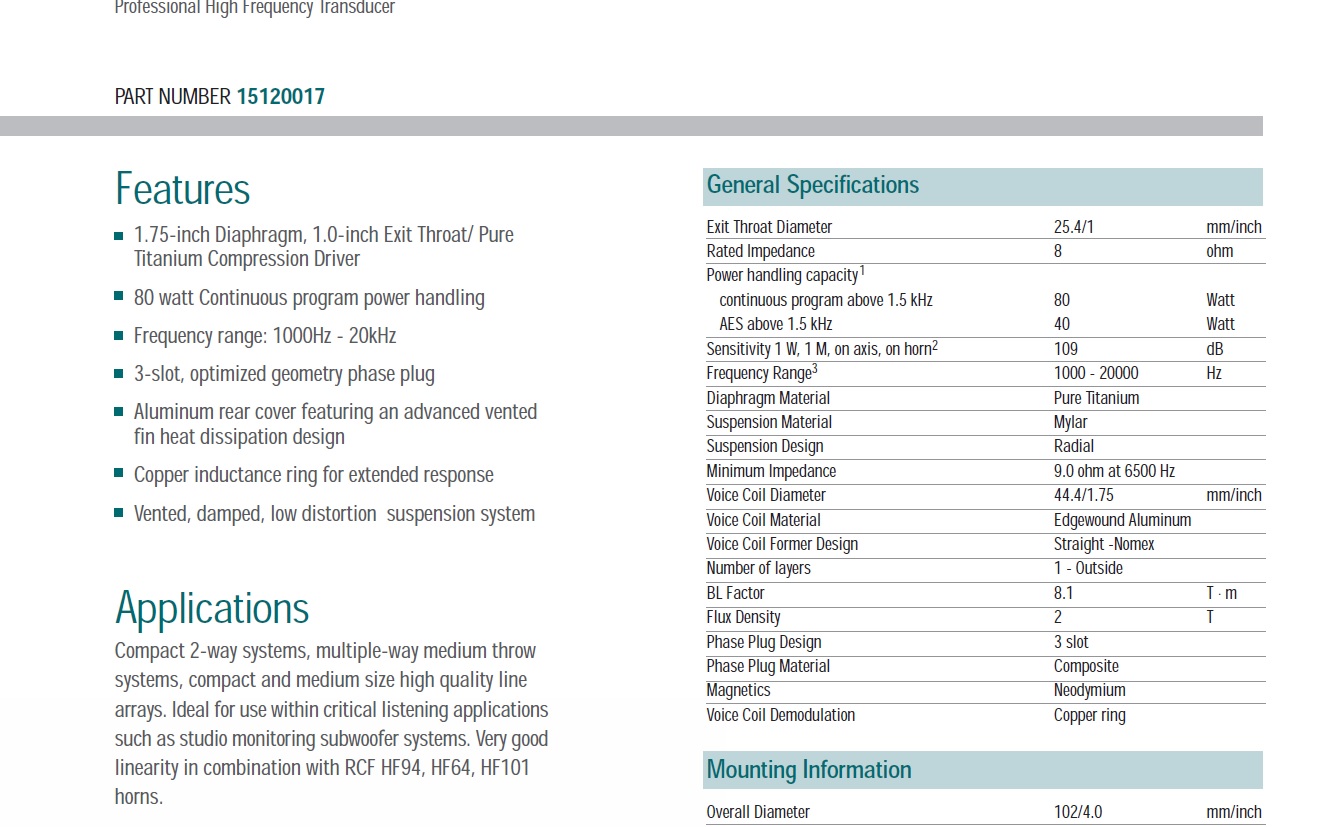

    Curios what the depth of the cone will be based on the 1k-20k response on the driver? Is it some exact multiple of the wavelengths (1/f) of that frequency range (.0001 to .00005) to achieve some sort of resonance in the cone? With the exit port being 1.000" it seems you have the opportunity to tune the range a bit with the depth of the cone and of course the shape.

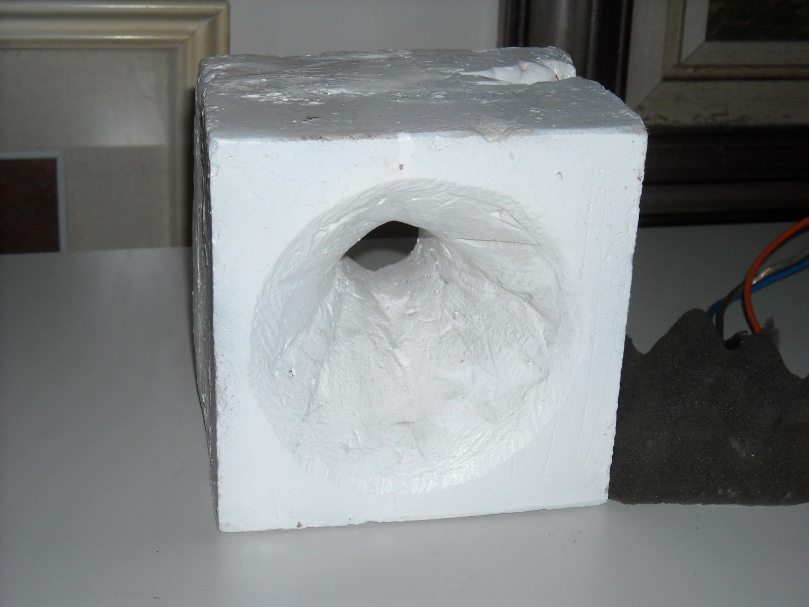

    many thanks!
    good physical activity is healty for the body! hope that the temperature raise fast ... here we'll have the next 2 months colder
    the range 1k-20khz is the "recommended" by rcf, in my opinion this driver sound good from at least 1500\2000hz to 10000hz, no more. under 1,5k and over 10k in my opinion it sounds bad and not so loud. I post a couple of pic of datasheet of the "new type" with neodimium magnet, i had a paper of fq response of my ferrite driver, it has 108db\w\m (1less than neod) and a bit more range up to 10khz. In my opinion it needs courage to claim the driver usable from 1 to 20k ... but the component is intended for pro audio... than...
    you're right, there is some "tuning" opportunity. In my big horn i tried to settle both front and rear chamber for working togheter, basically not only the dept but the volume. Horn is an "air trasformer", unfortunately i have to find my old papers where i wrote the formulas, i got weak memory . I remember that a front chamber (not compression) introduce a high pass filter, but in this case it's not our problem
    Here we got a pre-tuned solid compression chamber that is the back of the driver, and we don't need to add a filter before the throat. With this kind of horn in my opinion only shape, cut-off and material are importants.
    I tried some really ugly horns in plaster and cement, really bad internal surface as you can see, they sound good! I think that the real "tuning" is choosing the right cut-off frequency of the horn during design, not too low or the high freq will be cut, not too high or lowest freq of driver will be cut ...
    ...in few words, for this horn, we have to choose the cutoff with head (and shape for the right use). imho only bass horns have narrow range of fq (mine big are 150-350hz realistic) horns up to 1khz have less issues
    Good advices for a newbie (threading tools lathe)-dscn0116_1600x1200.jpg Good advices for a newbie (threading tools lathe)-spec-1.jpg Good advices for a newbie (threading tools lathe)-spec-2.jpg
