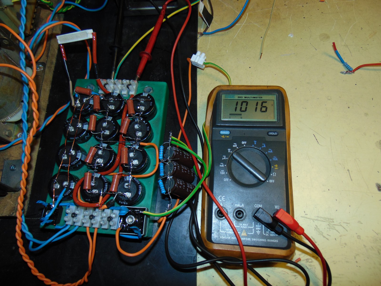

    I want to make some changes in power supply, I'm thinking that can be more helpful tuning coils and circuit with final voltage, and not with the reduced one.
    I tried a voltage doubler with 4x400v capacitor in series, an huge waste of capacitance, but my only way to use a doubler up to kv. Voltage without load is 1016 volt now, with load connected I think i'm in datasheet manual of tube. Hope it will give me some good results in flame stability and autofire.
    keep fingers crossed for me!

    Food for thought...website:
    "The Cockcroft-Walton multiplier serves as a more efficient high voltage source for photomultiplier tubes requiring up to 2000 V. [ABR] Moreover, the tube has numerous dynodes, terminals requiring connection to the lower voltage “even numbered” nodes. The series string of multiplier taps replaces a heat generating resistive voltage divider of previous designs.
    An AC line operated Cockcroft-Walton multiplier provides high voltage to “ion generators” for neutralizing electrostatic charge and for air purifiers."
    Used them a few times back in the day a few times. Just keep in mind the ratings of the components and that each successive stage is less efficient.
    Did you get your test equipment? Thanks for the update! ~PJ

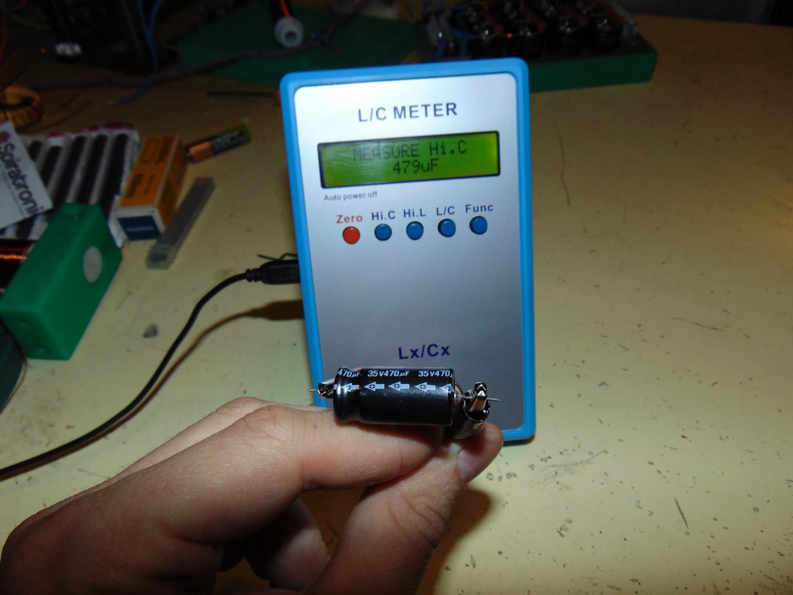

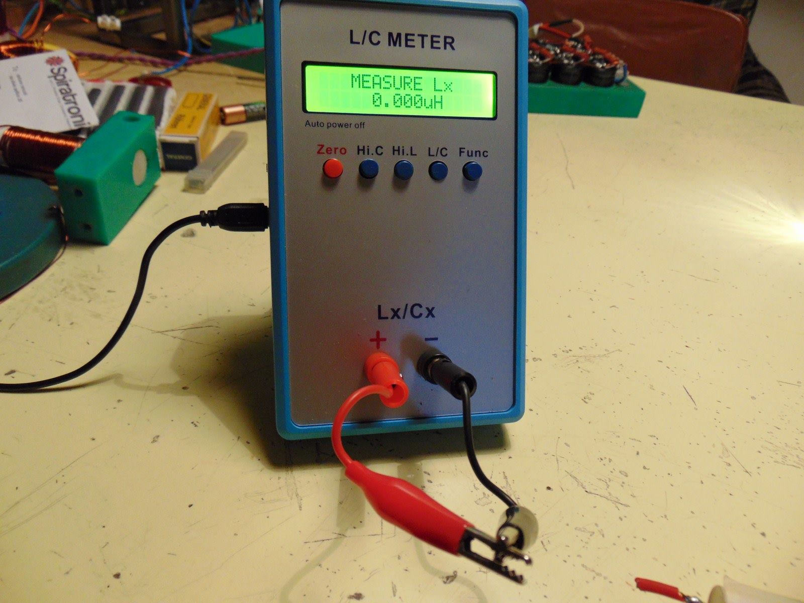

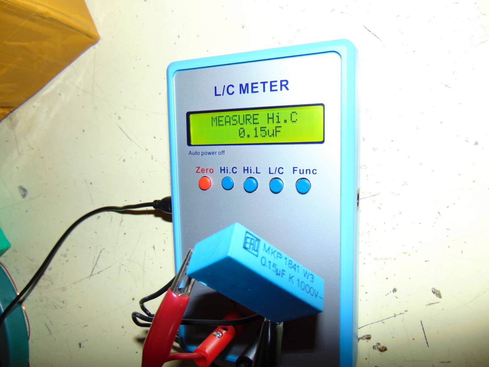

    Thanks for the link! Very nice with graphs and info

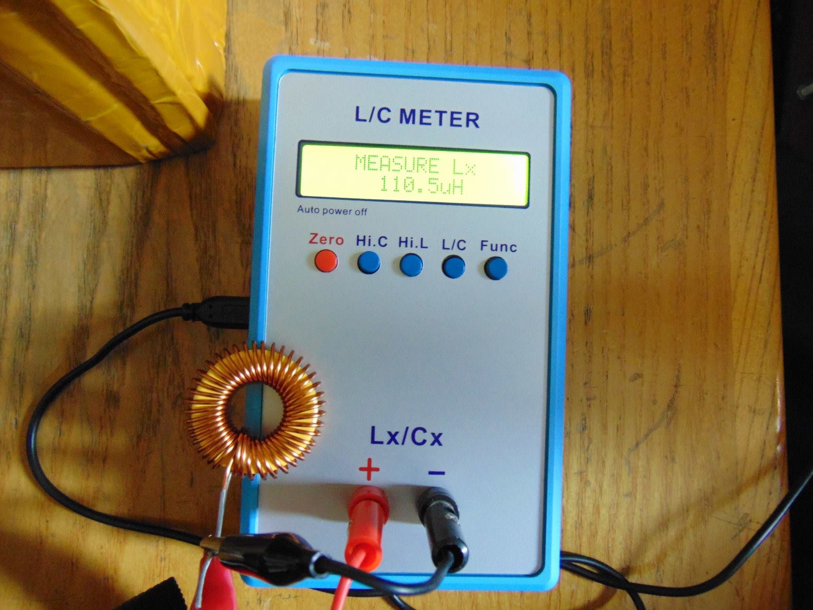

    Yeah I got only the Lc meter, frequency counter is still on the mule's back It takes really a lot of time to shipping with normal post from china... i buyed also 2 of these:
    Nebbia Sistema Lubrificazione Spray 8MM Tubo Aria Tornio Mill Esercitazione DB
    A friend near my town buyed, I hate emulsion pump, it makes a lot of sludge. I use it occasionally, it's more time that I spend to clean pump than the time i use milling machine. I want to use a small fridge compressor and a bottle with emulsion, fast, "clean" and transportable. I want to put one on lathe and one mobile for drill and mill. They cost few bucks, the hose alone, here in italy cost more than 2 of these components shipped. I want to try

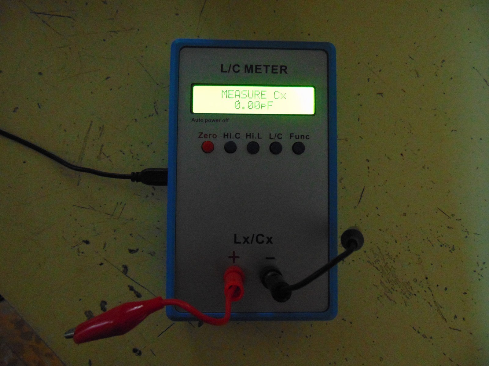

    The Lc200 meter is quite good! the plastic case is something re used from another circuit, it shows 9v dc instead of 5vdc , power on off button is marked "ac- dc", no included instructions or manual, but at least it's good at measuring components. A strange thing I saw is the choice between high and low capacity button. The threshold is 1uf, I see that in this range the circuit is in low cap mode, and not in high as manual says.
    Oddities aside, once I understand how it works, it gives nice measurements! Every start I check if resetted to "0", both for capacitance and inductance and then try measure.
    in few words, not as immediate, but for the cost and above all for the precision is so good. There is anothe one better meter, but price is too high for my pocket, and for my usage.
    here the manual:
    http://mpl.jp/lc/LC200A%20%20EN%20V5.0.pdf

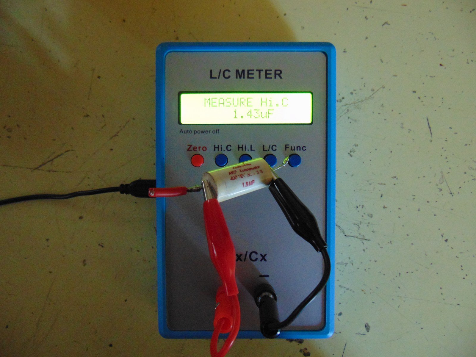

    I tried different componenents, the measure of coil is so accurate that it's the same value I tested at coils factory with professional Lcr bridge. Capacitors are close, I was sick from the measured value of a standard mundorf capacitor... it's 10 years old component, I used it on speaker for some test, like other parts, the value measured is not so nice, compared to the name. Maybe it's my cap, or maybe the basic line is not so nice
    Good advices for a newbie (threading tools lathe)-12983865_10209058617925325_9032863888249994227_o.jpg Good advices for a newbie (threading tools lathe)-12998277_10209058578564341_7947155775104605289_o.jpg Good advices for a newbie (threading tools lathe)-13029618_10209058573724220_7197422857412254693_o.jpgGood advices for a newbie (threading tools lathe)-13041057_10209056829480615_8287201077825218464_o.jpg Good advices for a newbie (threading tools lathe)-13041244_10209058563763971_8545835188291686025_o.jpg Good advices for a newbie (threading tools lathe)-13041324_10209058619605367_5803639789384188284_o.jpg

    The meter looks pretty good for a small price. As for the cap being old and out of 3% tolerance, you also have to keep in mind the meter is only good for 5% at either range of measurement 1-10uf (lo) or 1-100uf (hi). After 10 years it's probably seen its day and been a loyal component!
    Hopefully this will help you dial in the circuit and make sure the components are up to spec.
    Nice little mister for ~8 euro. Thanks for the update! ~PJ

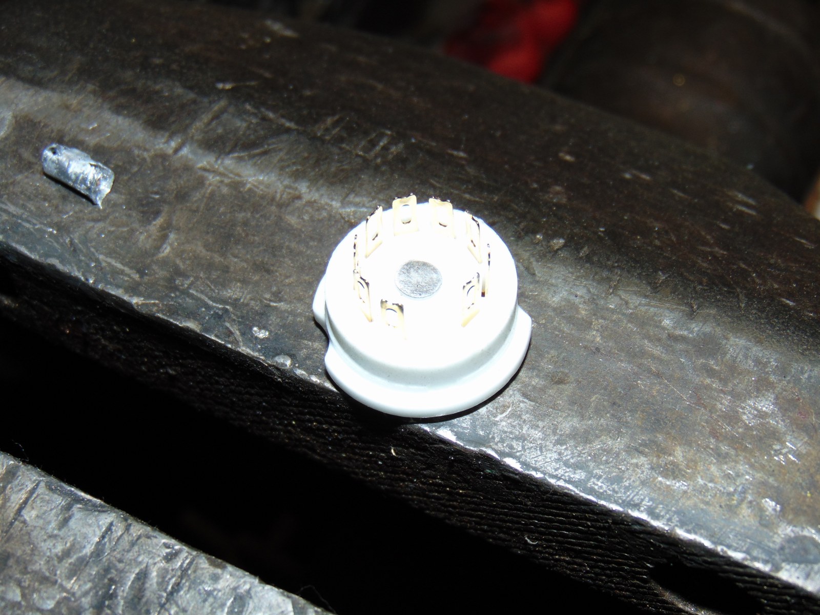

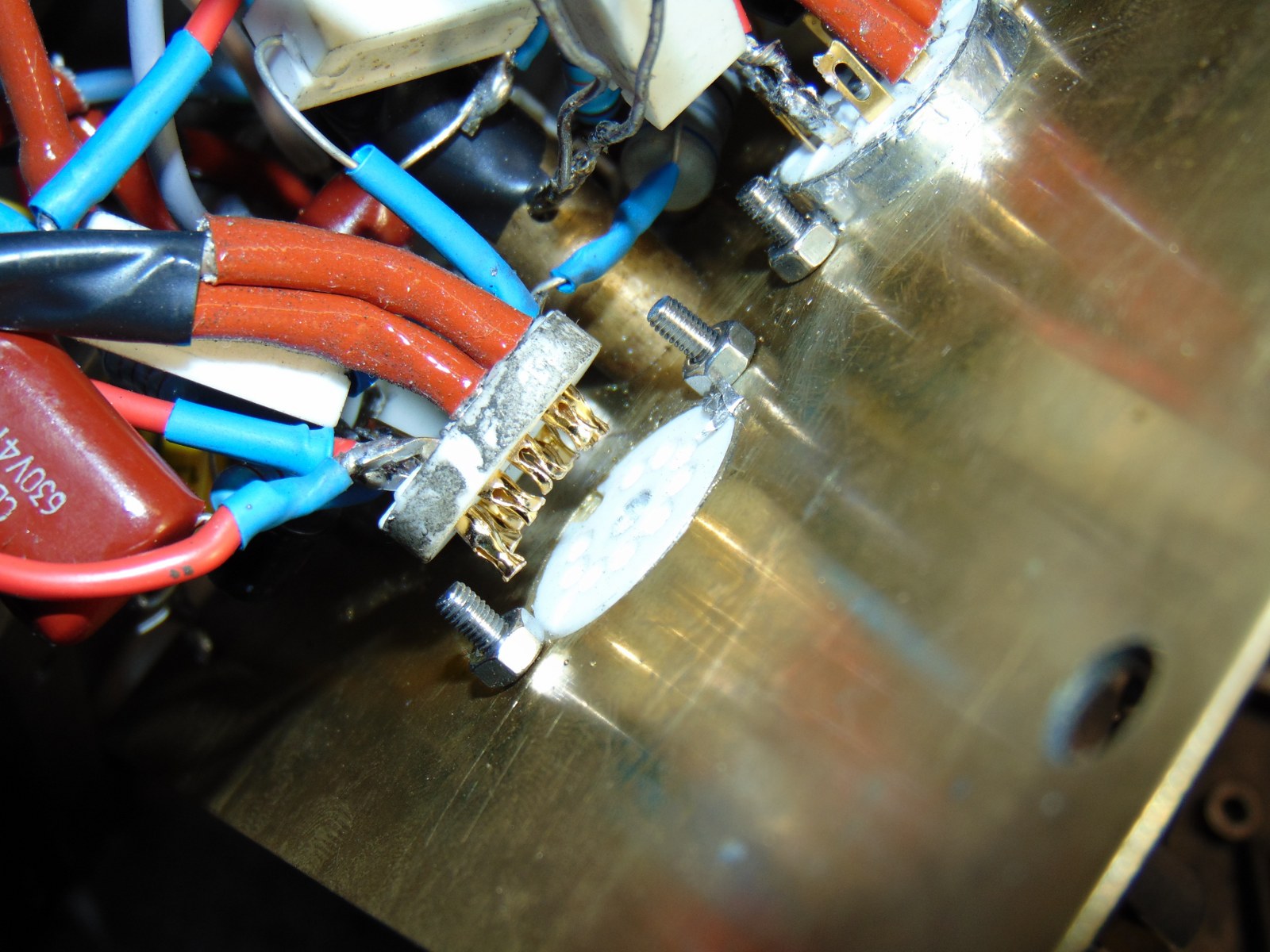

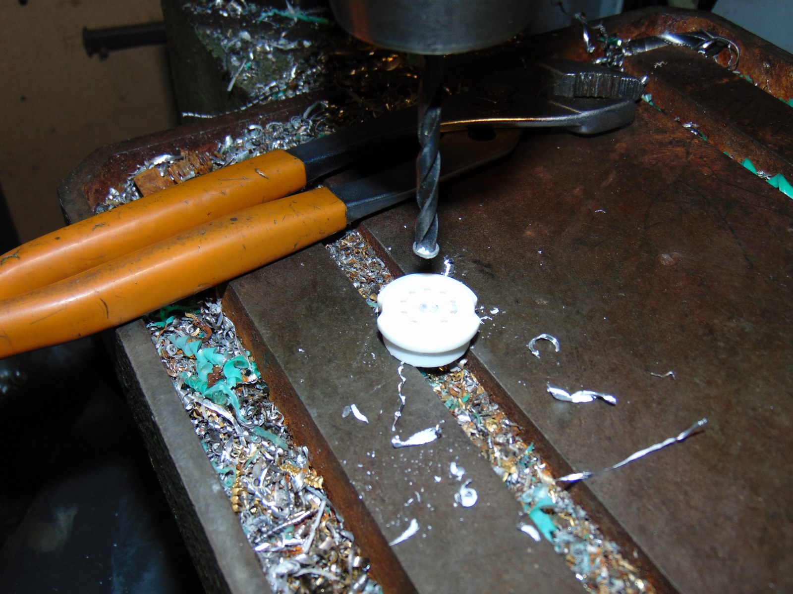

    I noticed a fault of the noval socket, after maybe 3\4 insertion of tube it loose strenght. Looking better the lower part peelings off the socket! The fault is of very poor quality of the rivet ( It's a low quality aluminum alloy ). For sure noise and connection troubles are linked to this component. I got mounted 2 of these noval, for pcl 82 and el84. I drilled the rivet, tomorrow I will find some good ones. I want to send a mail to the shop who sold me these parts just to know his position.
    ...it's like building a new house, begin to decorate and discover that the foundations are rotten
    I sacrificed a new socket in order to test the goodness of materials... poor poor pooooooor quality!
    Hope I will repair both sockets without desoldering the 3 stage before oscillator ...
    Thanks for advice! I have to make some research of spectral and lenses, i never thinked to ozone as an external capacitor.
    I'm trying to understand how this plasma runs , the "large flame" is just for aesthetics (at this point) maximum sound level is obtained with low flame and high audio imput. It's even strange that there is little ozone, only up to flame. I played with high volume for 3 hours but no smell of ozone in small room (4x3m +/-)
    Good advices for a newbie (threading tools lathe)-dsc00412_1600x1200.jpg Good advices for a newbie (threading tools lathe)-dsc00414_1600x1200.jpg Good advices for a newbie (threading tools lathe)-dsc00415_1600x1200.jpg

    Thanks for the pictures. Sorry to hear about the socket troubles. Porcelain sockets are quite good usually, particularly for higher voltage/RF. From the first picture it looks to have a lot of stress from the wire gauge and components close to it. It's also a bit fragile from torque. A slight over torque from the mount screws can put hairline cracks in it. When I built that HV supply years ago, I used them but found some real nice silicone coated wire to use on it and very carefully torqued the screws. It is quite flexible and holds up to HV and RF. It had much larger rectifier tubes but that puts some strain on it too. Food for thought...
    Hopefully your dealer will warranty them or discount some new ones for you.

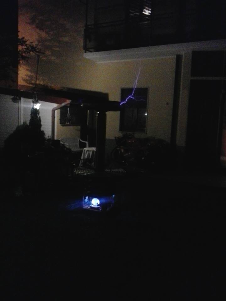

    I post a pic of some night ago, a friend built a big tesla coil, really nice and loud!
    Good advices for a newbie (threading tools lathe)-13124644_10209208311747577_6162394587605069116_n.jpg
