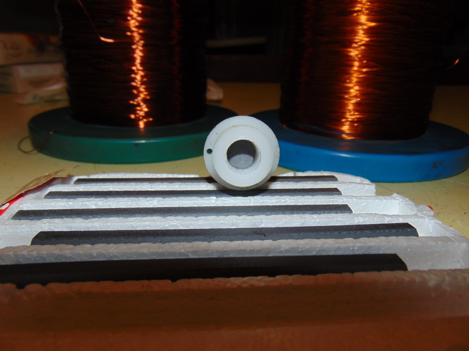

    Thanks Stefano. Food for thought from experience...When I get to a stuck point it is easy to get into a hurry up, try this try that mode and usually forget to document what I did and the Results. I relate it to trying to fight my way out of the inside of a balloon! Usually I find that letting it go for a day or two, something bubbles to the surface that either puts me on the right track or the actual solution. Allow some Ω time. ~¿@
    The 1.5Mhz filter is a bit odd to me too, but it's mainly the configuration of the 2 filters in series. I do not consider it (1.5Mhz) an RF filter in this circuit.
    As for the coil builds...Start with the calcs and work a little either side of what is needed. The 10-40 turns is a big swing...especially changing diameters too. Document each!!
    Had another thought about the coil and the proximal capacitance effects. Maybe you are experiencing issues because of that??

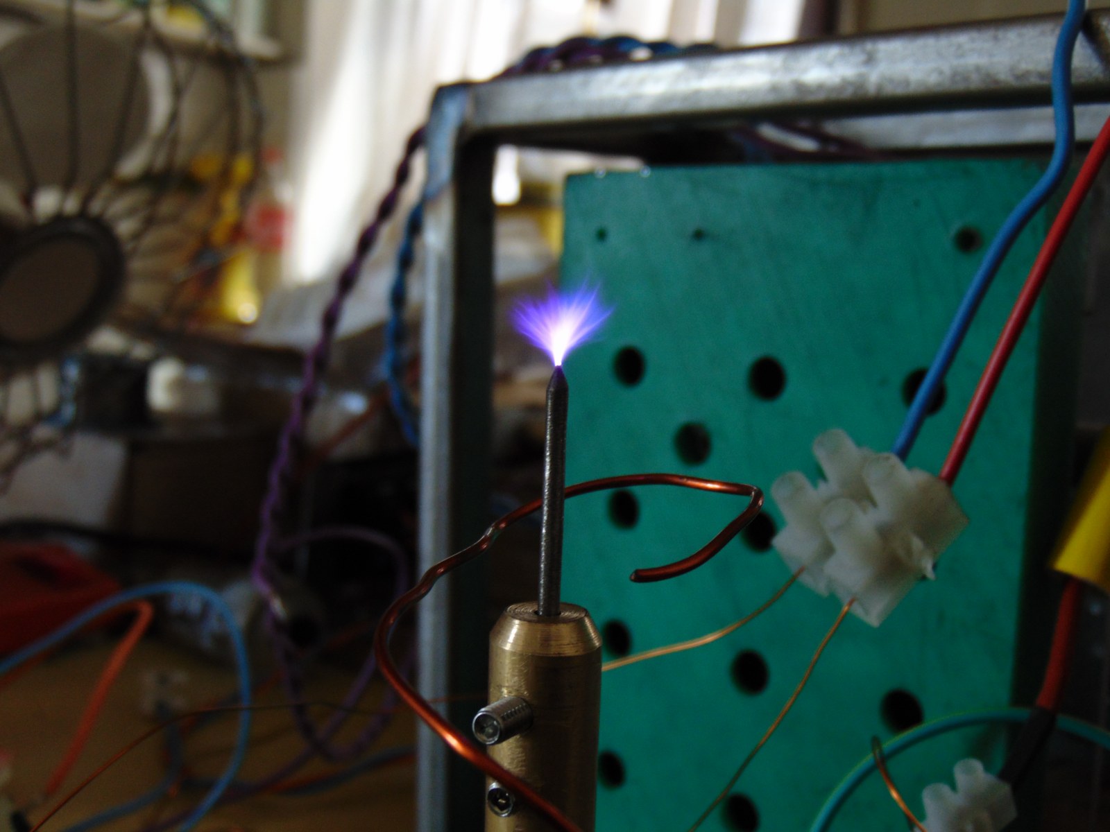

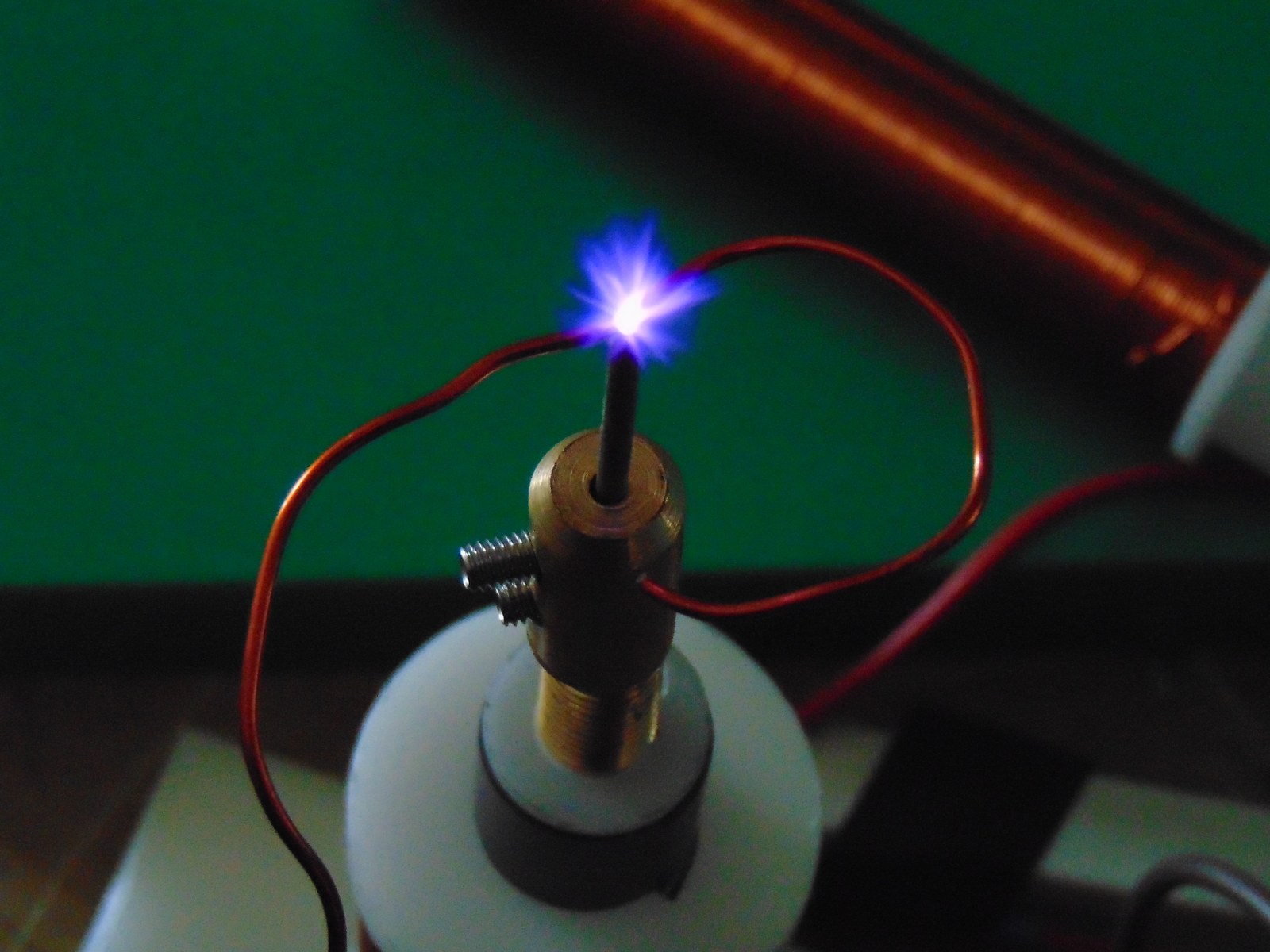

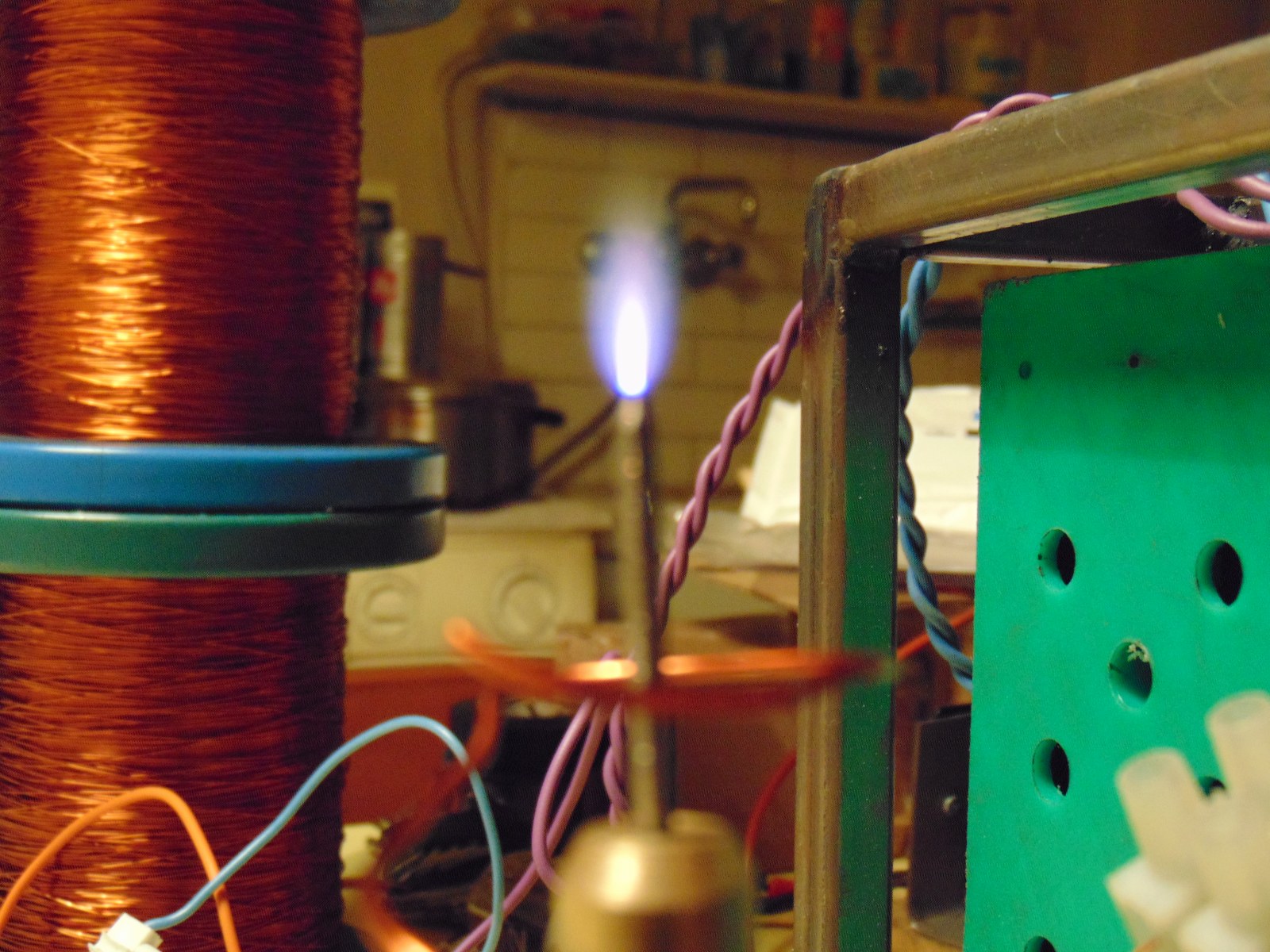

    Hi!

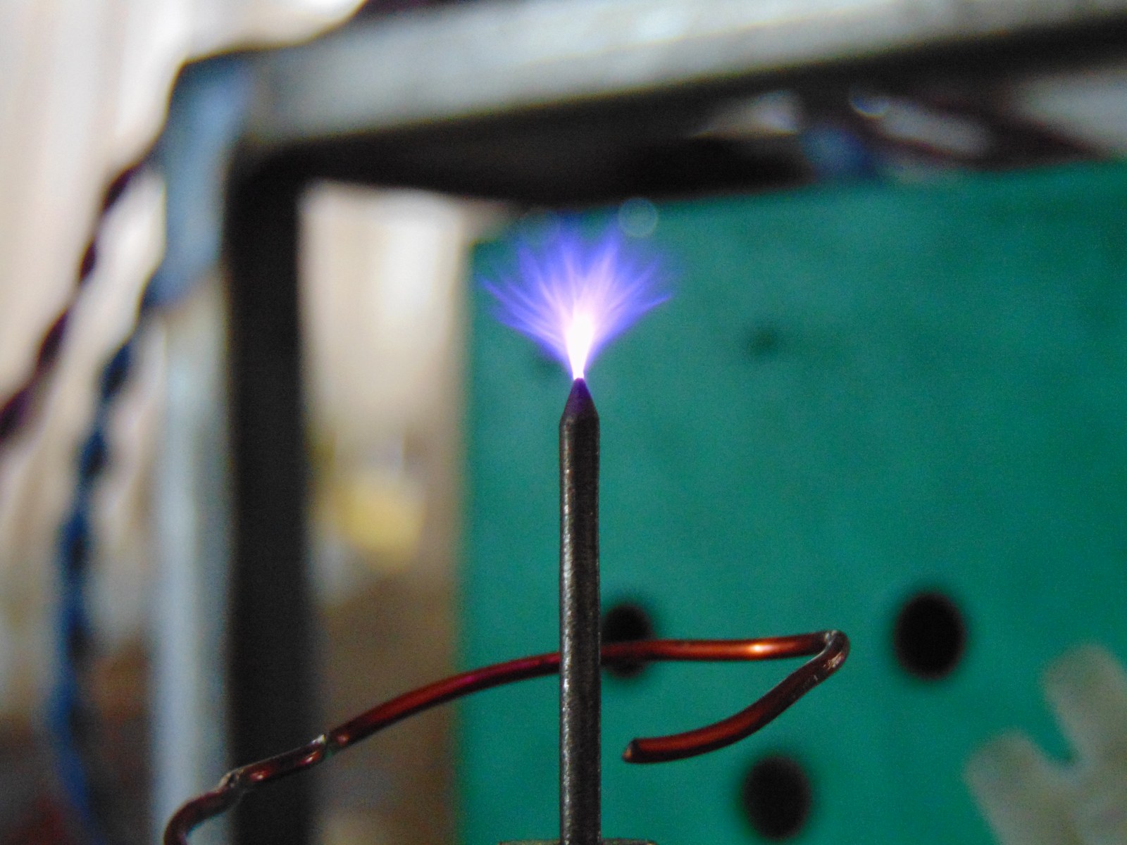

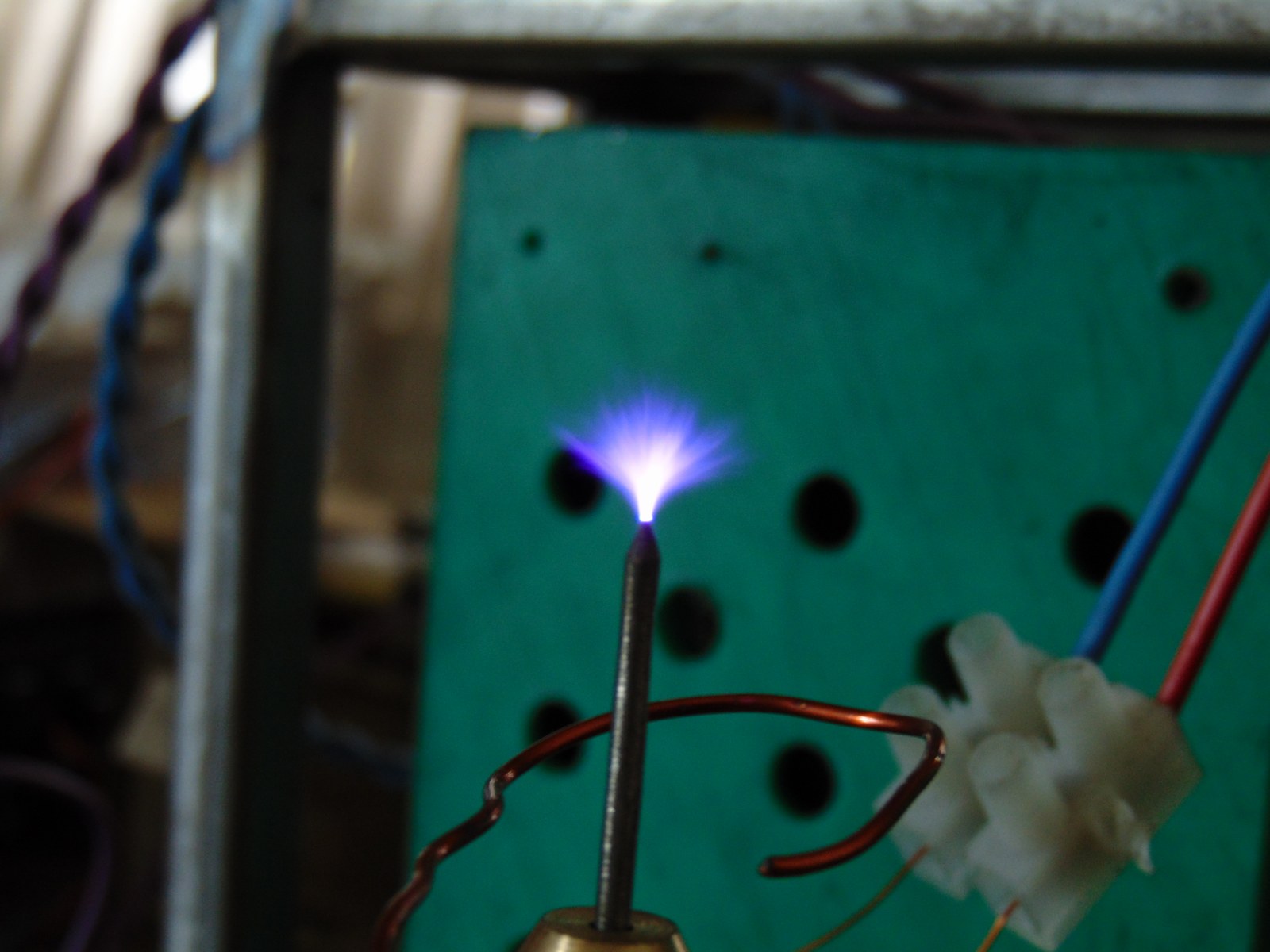

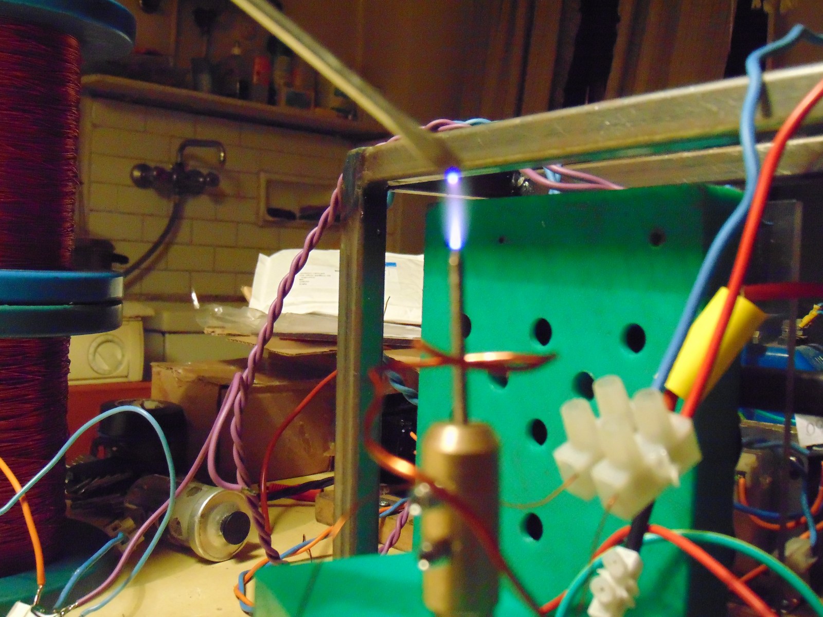

    Big update tonight

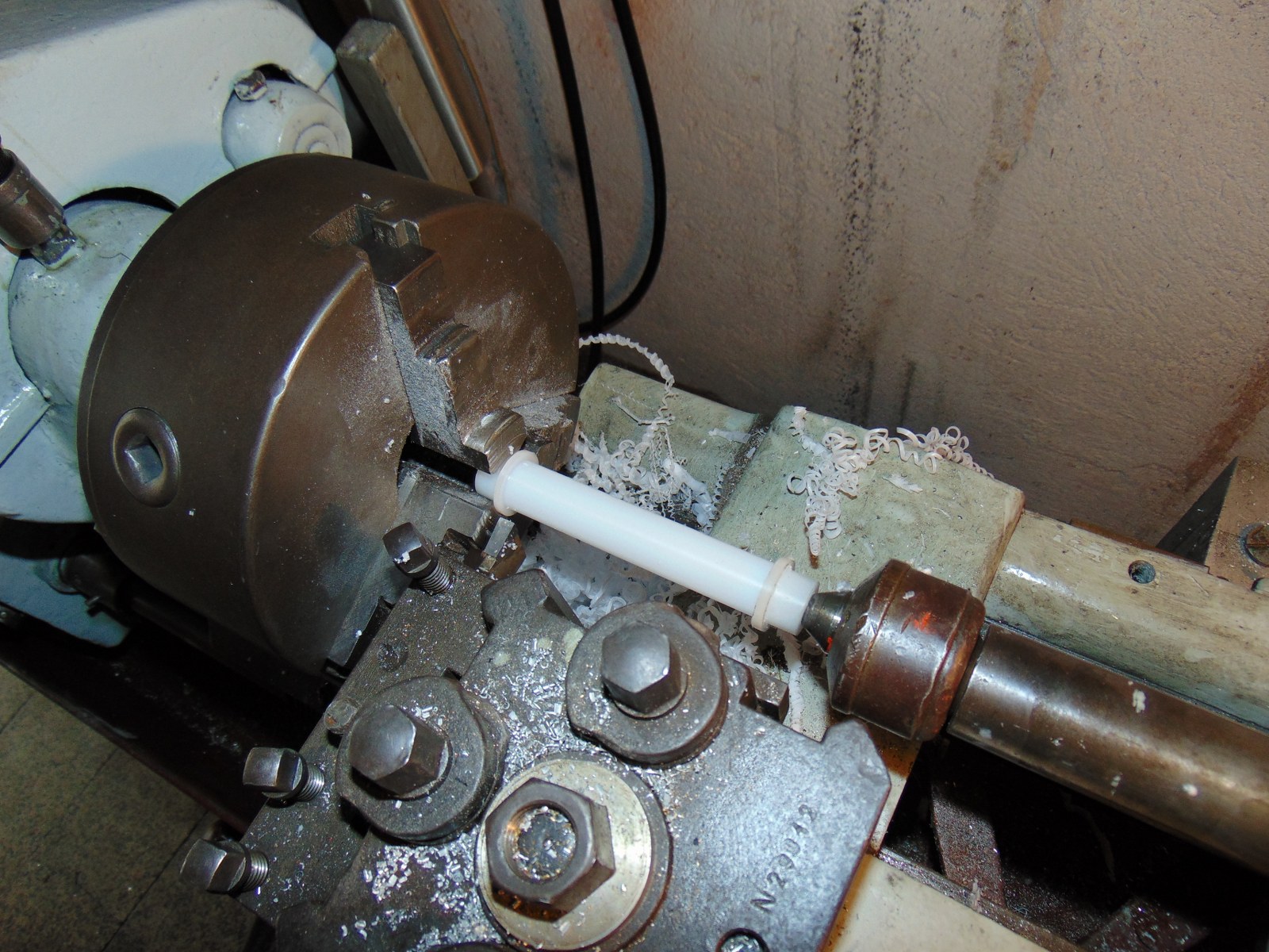

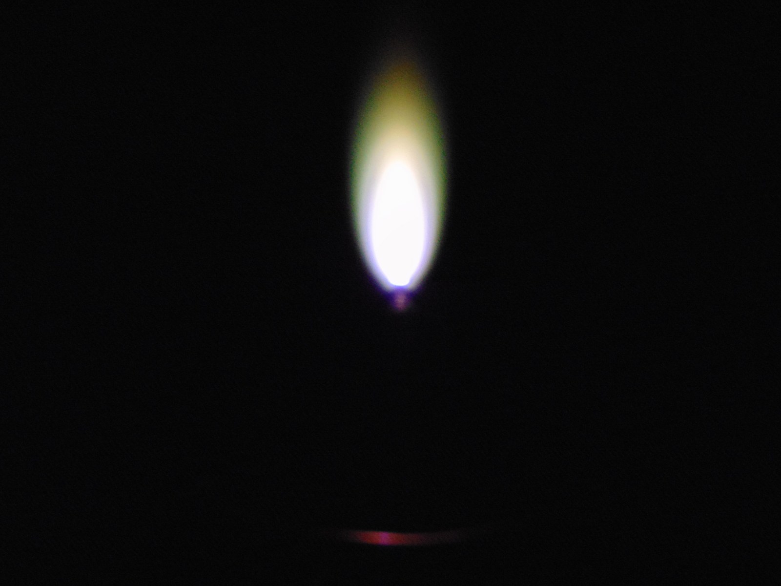

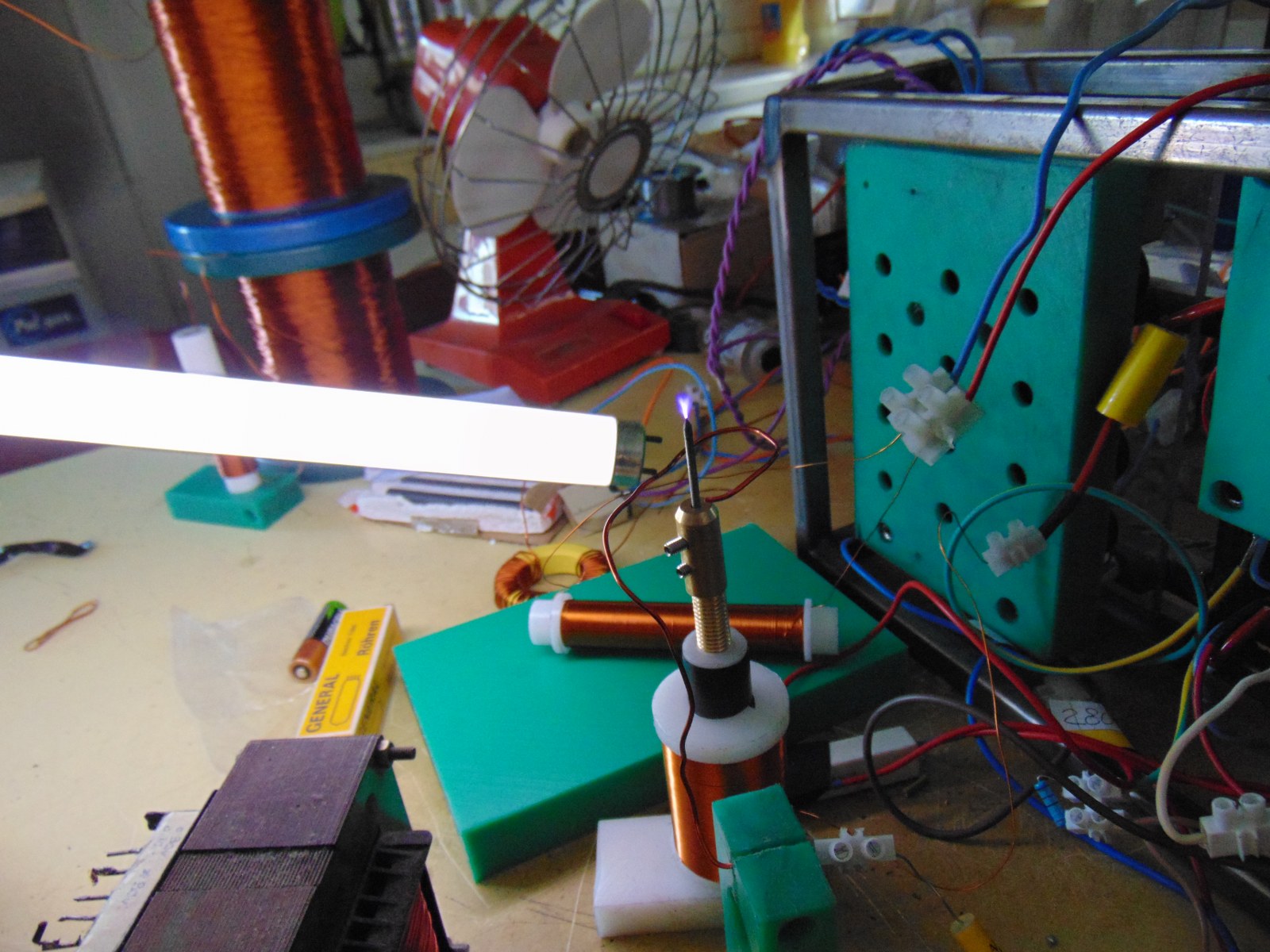

    The new coil is running better than others! Full gas flame it's a little bigger now, but the main thing is that now lowest flame possibile (with closed potentiometer) is stable and is +/- 6mm after warmup. Tube oscillates better, less heat till 150ma, after grid become red, but it's good, in this conditions it's 70v over maximum rating. I need the measurement tools to drop a line, but I'm happy to see that I'm on the right side now, even if there's a lot of work to do! An other good thing is that power supply make less noise and coils runs colder.
    Got a question for you, I noticed a change in flame color, till 1cm +/- it's a bright purple, when I push the limit flame becomes white, not only in the flake (idk the correct name, it's the outside of flame) but even the dart is clearer. Actually I don't know if it's matter of power, or maybe some frequency change. Next days I will try to vary the tuning freq, Hope measurement instruments will arrive soon! I need to know at which frequency the oscillator is running.
    making of the new coil
    Good advices for a newbie (threading tools lathe)-dsc00289_1600x1200.jpg Good advices for a newbie (threading tools lathe)-dsc00290_1600x1200.jpg Good advices for a newbie (threading tools lathe)-dsc00292_1600x1200.jpg
    play with flame, the last picture is the minimum new flame at full closed potentiometer
    Good advices for a newbie (threading tools lathe)-dsc00295_1600x1200.jpg Good advices for a newbie (threading tools lathe)-dsc00304_1600x1200.jpg Good advices for a newbie (threading tools lathe)-dsc00307_1600x1200.jpg
    Good advices for a newbie (threading tools lathe)-dsc00308_1600x1200.jpg Good advices for a newbie (threading tools lathe)-dsc00312_1600x1200.jpg Good advices for a newbie (threading tools lathe)-fiamma-minima.jpg

    Looks like you are getting a pretty good corona now, small and tight! Nice Going!! Good your power supply and coils aren't straining (humming) now. Hopefully your new instruments will help answer some questions for you about frequency/power etc.
    Not sure about your question but think you are questioning/witnessing the oxidation of the atmosphere with the larger white flame/corona from more power being applied (picture 6)? It may also be some oxidation of your needle as the picture has some yellowing out toward the edge. Forgot what material but seem to remember tungsten alloy for your tip??
    Question for you. I can't tell from the pictures but have you moved the 3/4T coil up and down slightly?
    Thanks for the update, nice progress. ~PJ

    you're right, the tungsten rod shows some oxidation, I can try grinding the tip in order to see if something change, maybe the flame can oxidize the tip continuously during operation? I remember old chemical exp with copper sulfate and flame, it can be something similar in fact
    I tried different position and different capacitor + resistor of the 3\4 reaction loop. separate discussion for components, because they change with main coil, i adjust the position of this loop with neon tube. There's a range of half inch about in which the strenght of the field is stronger, using neon tube it's pretty easy to locate the best position
    I see another good thing with the new tuning, semi faraday gage is still helpful, but the negative interaction with the environment is decreased, as temperature of coils and even temp of power transformer. For sure it drains less current relating flame size. Excepts for overdrive, datasheet of tube said maximum operation value of 250v, at this driving voltage i got 130ma at flame, with great size.
    I'm going to make some modifications on circuit, hope to got some news in few hours

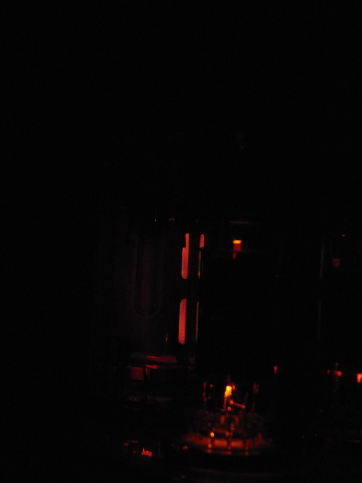

    I havn't measured the output voltage of walkman, but I want to use a soundcard of old pc to make some test, with this I can use even a frequency generator. At this time i don't want to use my Scarlett 2i2 soundcard, I prefer be safe
    The tape is applied to a high pass filter at imput (don't know if it's running good or not) then triode + pentode of Pcl82 tube. Flame now is better but there's lot of work to do, it's not stable with audio connected. Troubles with starting and restarting, it's a clear sign of bad tuning frequency of coils imho. In video I try different position of both volume control and flame:
    - sound is nice, clear and loud at low-mid flame. optimum is from minimum 60 ma to max 100\110ma, when big flame appears volume lowered and quality decreases.
    - if I raise the volume of audio too much, the flame turns off, i think the oscillator stop running, and it's difficult to restart
    I think the trouble is the oscillator and the length of cables - position of components. Maybe 3w pentode audio stage is not enough to play louder, there's still this possibility
    I'm focusing on main and block coils, I found that they are responsible for the major changes, I just finished a new double turns coil, as expected circuit runs better. Hope freq counter will arrive in few days, that's my only way to see at which freq circuit is running.

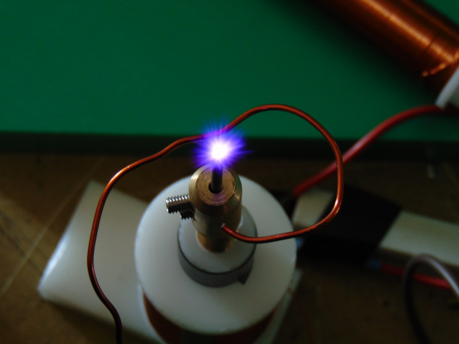

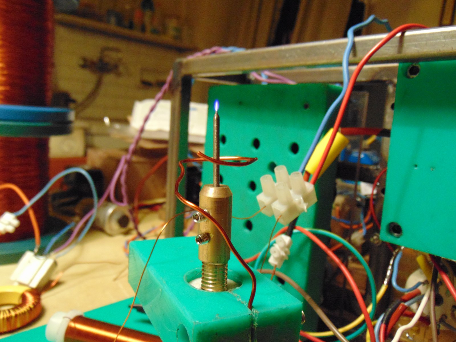

    sorry I forgot pictures
    Good advices for a newbie (threading tools lathe)-dsc00318_1600x1200.jpg Good advices for a newbie (threading tools lathe)-dsc00319_1600x1200.jpg Good advices for a newbie (threading tools lathe)-dsc00323_1600x1200.jpg
    Good advices for a newbie (threading tools lathe)-dsc00326_1600x1200.jpg Good advices for a newbie (threading tools lathe)-dsc00333_1600x1200.jpg Good advices for a newbie (threading tools lathe)-dsc00334_1600x1200.jpg
