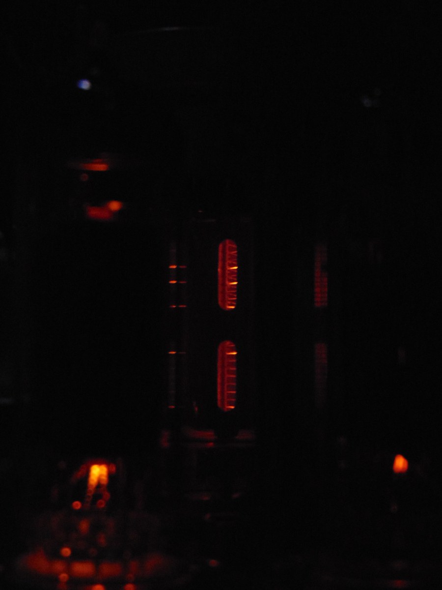

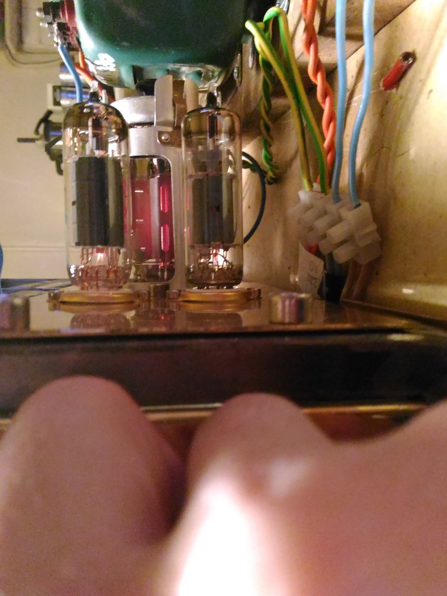

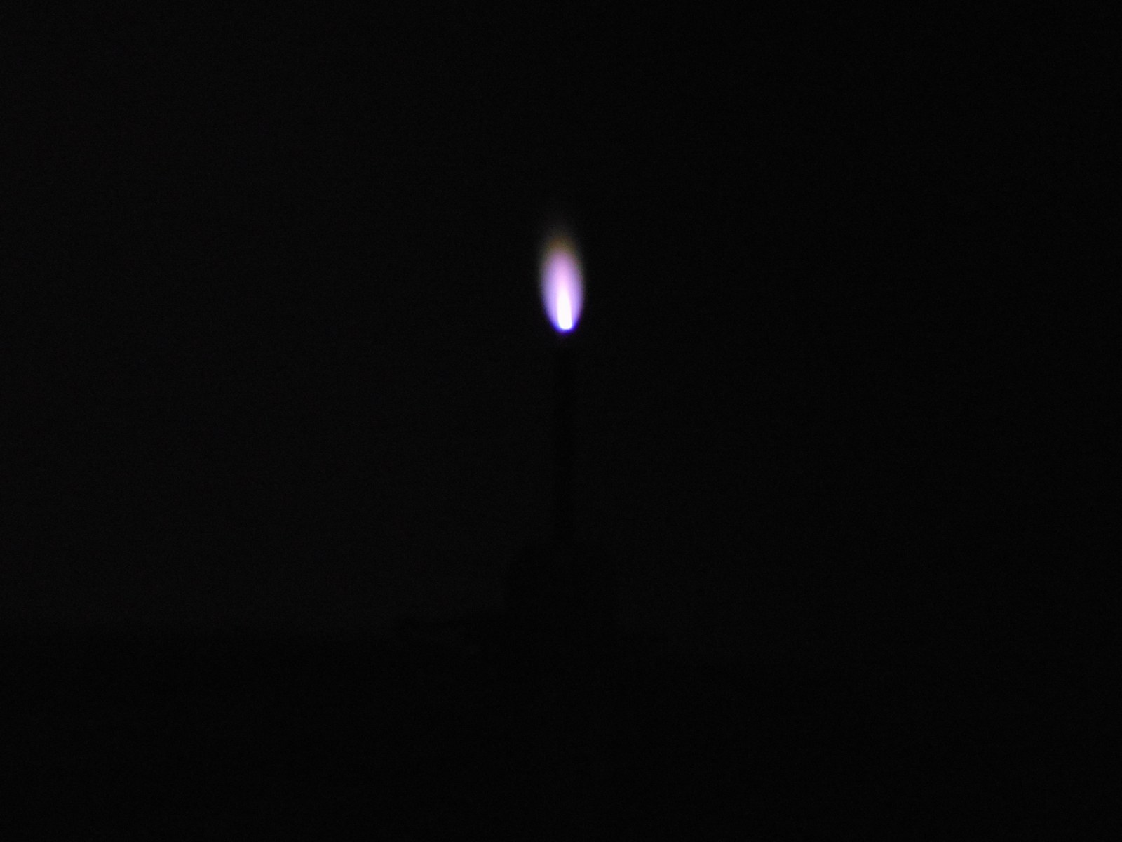

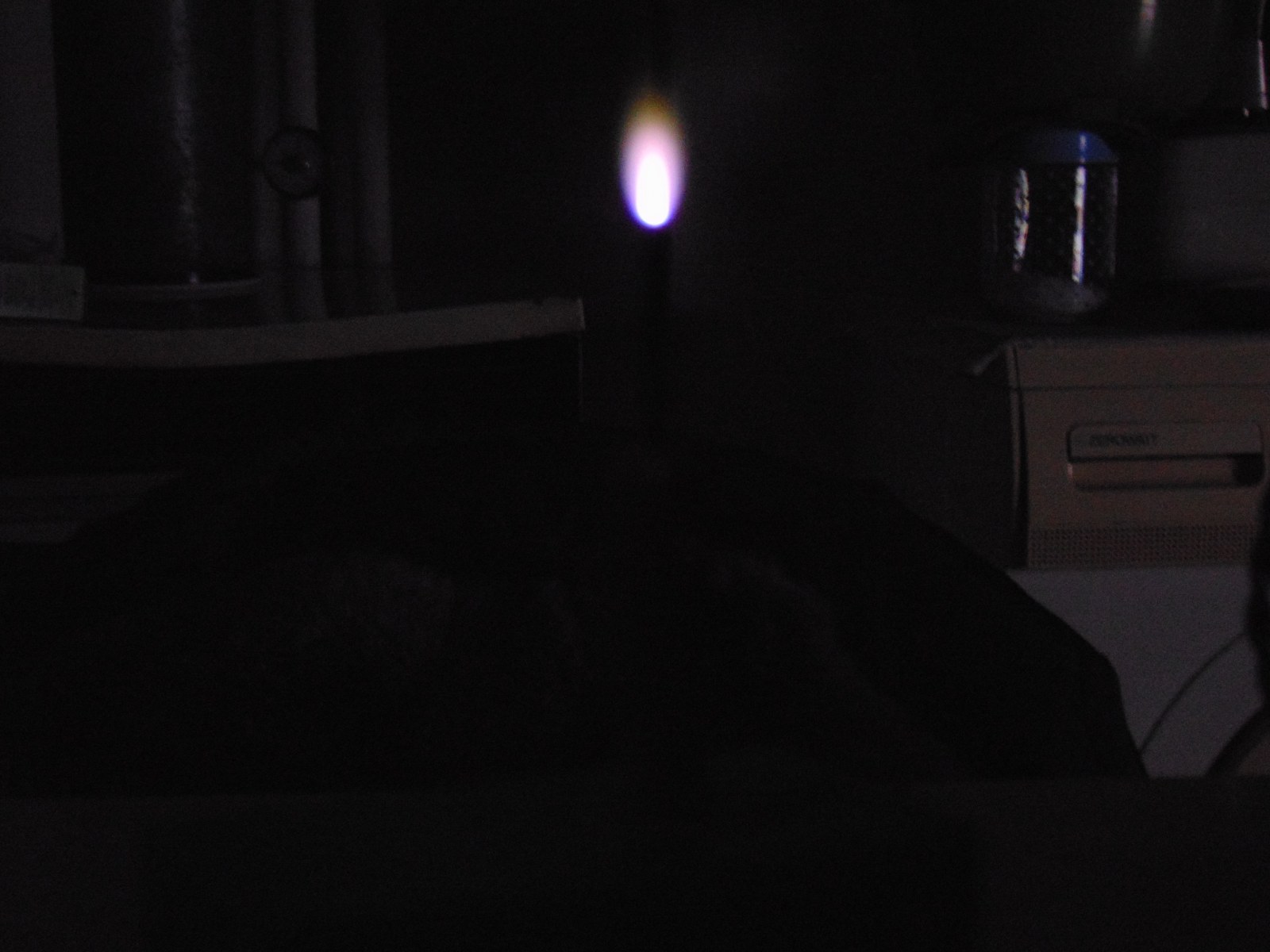

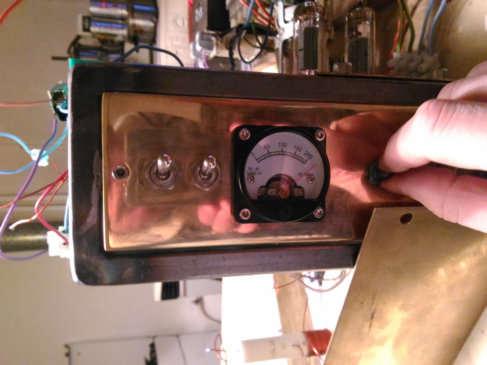

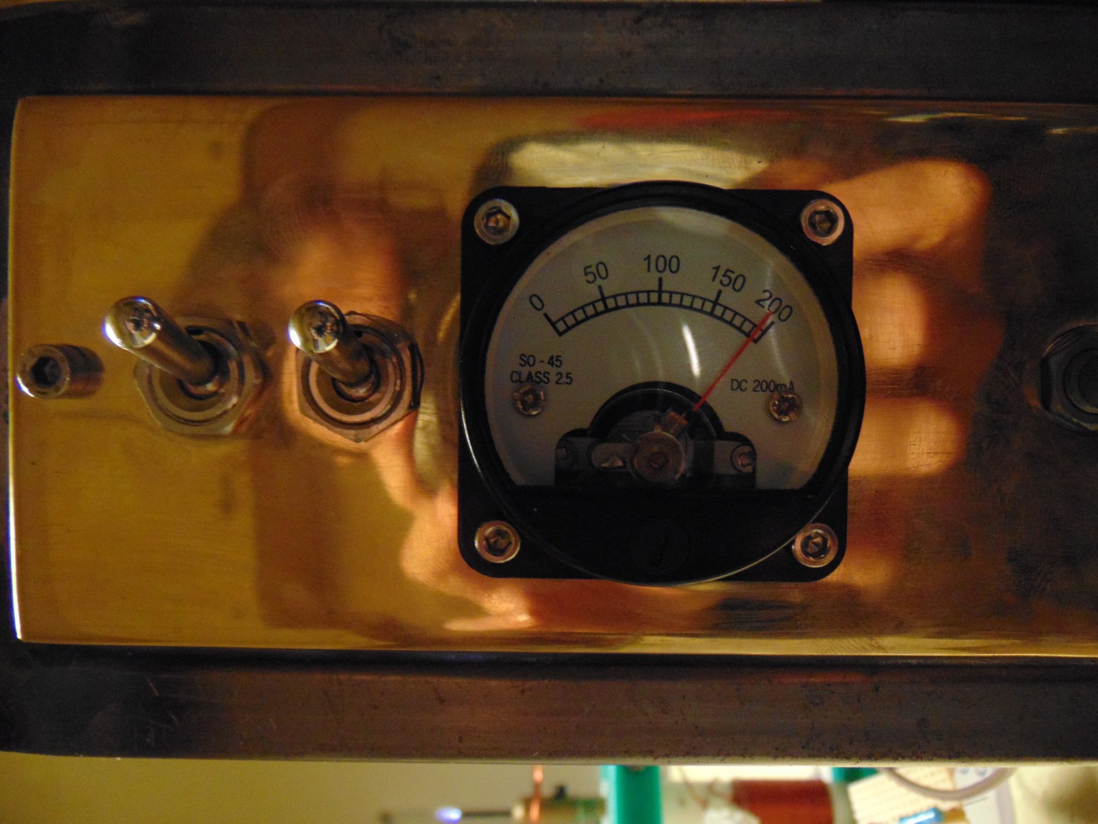

    Hi! new update!
    This plasma is similar to Sasha Grey, it sucks current like a princess!
    The final part of circuit is not running well, got a nice flame but it drinks too much bourbon, tubes and coils run too hot imho, have to make test, for sure I want to avoid burning tubes.
    Flame is hot, really hot! I can smell a little ozone only with nose up to flame, not so alarming. Flame is silent, completely no sound from spark! Got some noise from 2 transformer of power supply, not a big problem, the single unit will be a toroid, maybe from poland, covered with resin.
    Still not have auto fire, i hope i will tune the circuit. I have to improve fuel consumption and interactions between coils. Maybe frequency is really too high... I'll do some test!
    Really impressive interactions with objects near, without metal shield around flame coil the metal edge of the wooden table gives spark to my hand! Without shield if you touch the edge the flame lower size!
    I never thought that the cage was the first part to be designed! I discover new things every day! Have to think the shape, and how to create a good and nice one!

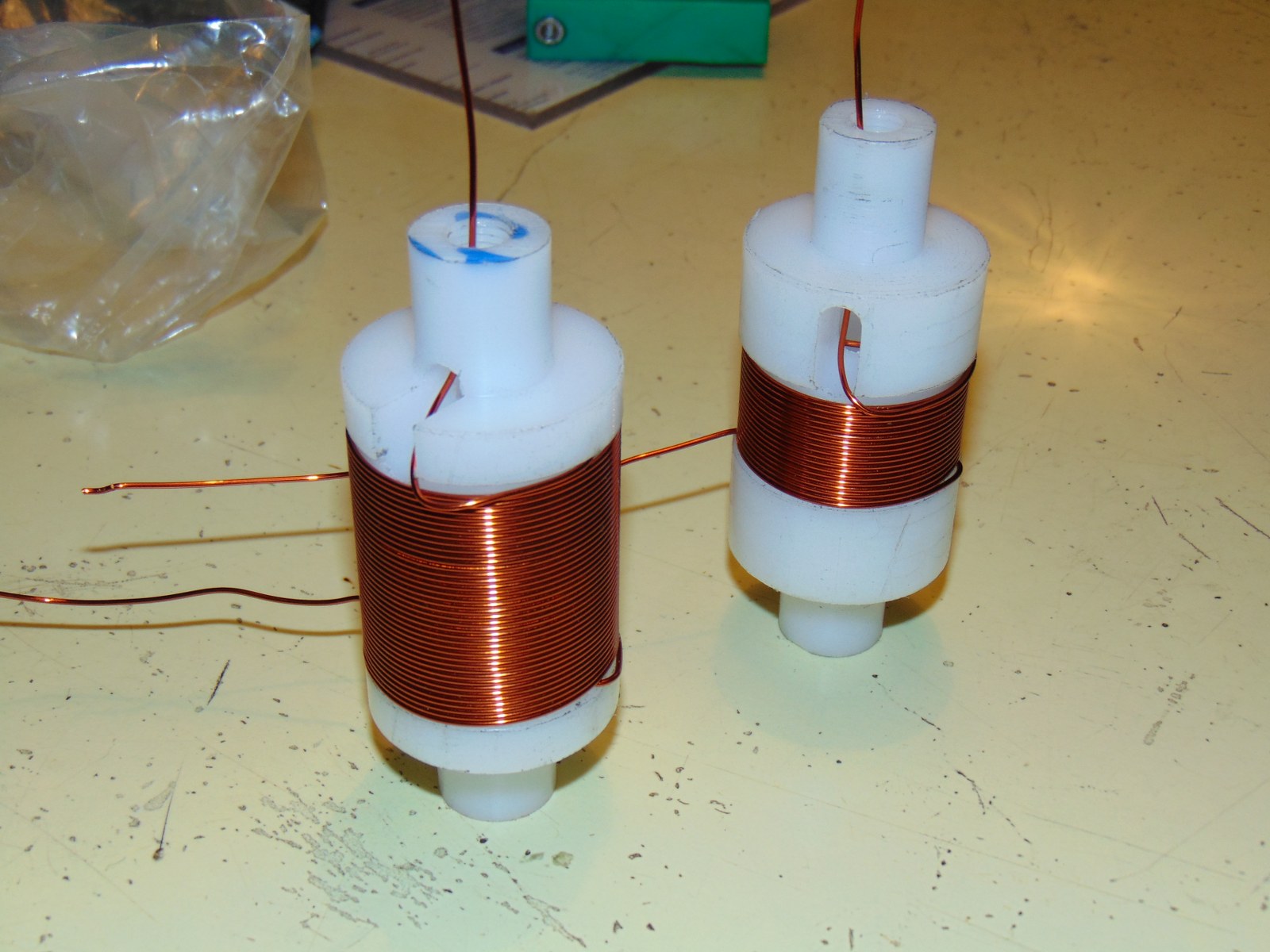

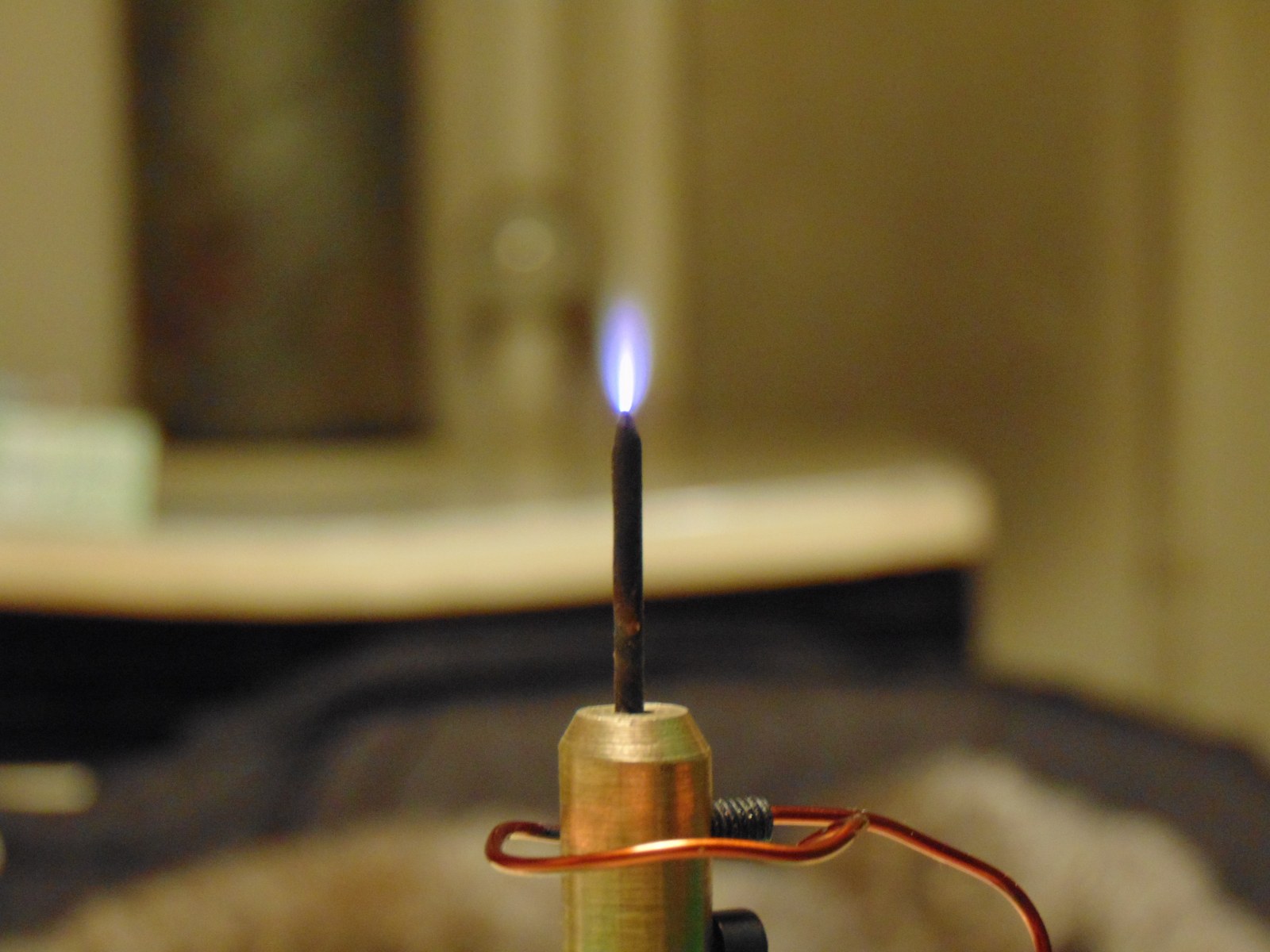

    Hi! I begin to understand why there are few plasma tweeter and they cost so much... developping the circuit is really hard!
    I tried different coils, resistors, capacitors but the tune isn't easy and it's not trouble only working on circuit, it's a complex set. I built some new coils with lathe for test. It's really impressive that very little changes can make huge difference or destroy the tube. In the 3rd picture under 10 sec up to overdrive can turn the final tube bright red. I buyed some testing equipment for doing measurement, a frequency counter and a lcr meter, for sure they can help, hope they get here soon from China! I'm searching in this days for a good oscilloscope with probes.
    Have to make some steel gage all around frame and coils, fix in different positions coils for easy substitution. Unfortunately I'll have to modify many parts from original idea ( and I don't want to sacrifice early 316 inox )
    In the meantime I carry on for easter with pear and chocolate cake and some good belgian White
    Good advices for a newbie (threading tools lathe)-dsc00265_1600x1200.jpg Good advices for a newbie (threading tools lathe)-p_20160325_004205_900x1200.jpg Good advices for a newbie (threading tools lathe)-dsc00266_1600x1200.jpg Good advices for a newbie (threading tools lathe)-p_20160325_004119_1600x1200.jpg

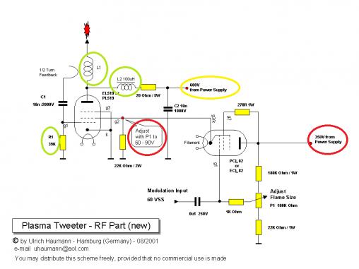

    If I can express my humble opinion, on the net there are many circuit with "strange" solutions and components, in few words, many circuit not running or performance not so good.
    Thanks for the links! I wrote to conscious flash, he gave me some advice, but he said that his plasma with gu50 resonate at very low freq (1mhz +/-), it's clear because he used a very tall Hv coil. He said also it was a "stand alone project" not for hifi use. I want to replicate his low freq coil just for experiment, to see if the circuit runs (with autofire).
    I think that big flame with flyback tranformer is good only for show, not for audio. For sure "tesla people" make this because it's funny and cheap, but it's not good.. I tried flyback years ago, they are not made for keeping current at high freq, and with low freq we can't talk about hi end use. I destroyed 3 or 4 flyback, and audio was really poor with noisy flame.
    I did some research on solid state, mosfet type plasma, but for high freq troubles everywhere and very poor efficiency.
    The base site for diy plasma tweeter is this, of Ullrich Haumann
    Ulrich Haumann's DIY PLASMA TWEETER
    It's a very good starting point, with info on all commercial type and diy schematic (hybrid and full tubes). I spoke with Ullrich and he said that the efficiency was really, really low, even with the "turbo" tube version.
    My schematic uses the same concepts as that of Haumann, there is the last tube that is a class C oscillator tuned with few parts and cathode to gnd, driven by a modulator with a series resistors with potentiometer that modifies the voltage in g2 of final tube. The first "little" part is a normal audio amplifier with triode+pentode.
    I only wanted to use different tubes, pcl82 (triode/pentode specific for audio) and el84 as modulator, then cheap and strong Gu50, but the big basic parts of circuit are the same. Haumann was right, 27mhz is a right tube for oscillator, it helps keeping flame silent , efficient and good sounding.
    I havn't the truth in my pocket, and I know that before speaking I should do a trial run, but Il you see the schematic i can tell you something:
    - with 600v B+ and 350v on modulator , nothing happens
    - with 600v on both modulator and oscillator something happens
    - adjust g2 to 60-90v for use, at the moment i can't keep the voltage so low (or the current so low like Conscious flash ) the circuit starts at a minimum of 130v till 300, i'm completely over range.
    - maybe the problem is something in frame-cables- optimisation, but with 100\200 uH coils, nothing happens, my coils are bigger non slightly...
    For sure my circuit is not tuned well, but i see too many strange things in different schematics, and either some friends that experienced plasma tw building said the same.
    if you've come this far, you can feel that many builders stopped developing circuit as soon as first start, and don't replicate for stereo. For sure this oscillator circuit is 5 parts, but it's really hard to tune.
    Cbag you're right, my circuit is drawing lot of current! it's good that the flame even at full power is completely silent, but the grid of gu50 is a bit red and that's not good. I post my facebook video of the flame, with no sound ( i'm focusing on oscillator parts for now ) you can see the ammeter is nearly closed to 190ma, but if you see the color and the shape of the corona discharge is completely different. Conscious flesh seems to have a longer flame, more narrow and not so stable (see angle) with less current.
    i talked also with a owner of a commercial Corona, and he said that in audio use, flame is 5-6mm, really tiny compared with mine... but i want to improve performances of entire circuit
    The choice of horn comes to the need to use quartz or pyrex cell to degradate ozone. For sure 360° sound can be a great experience, but for closed rooms it's better avoid ozone, and the cell can help a lot. Horn for sure helps keeping flame low, it's at least +10db without touching flame size, that can really help with high efficency system
    https://www.facebook.com/stefano.ran...8729516698000/
    I hope I have not bored you with this technical info
    what do you think at the light of the new information?
