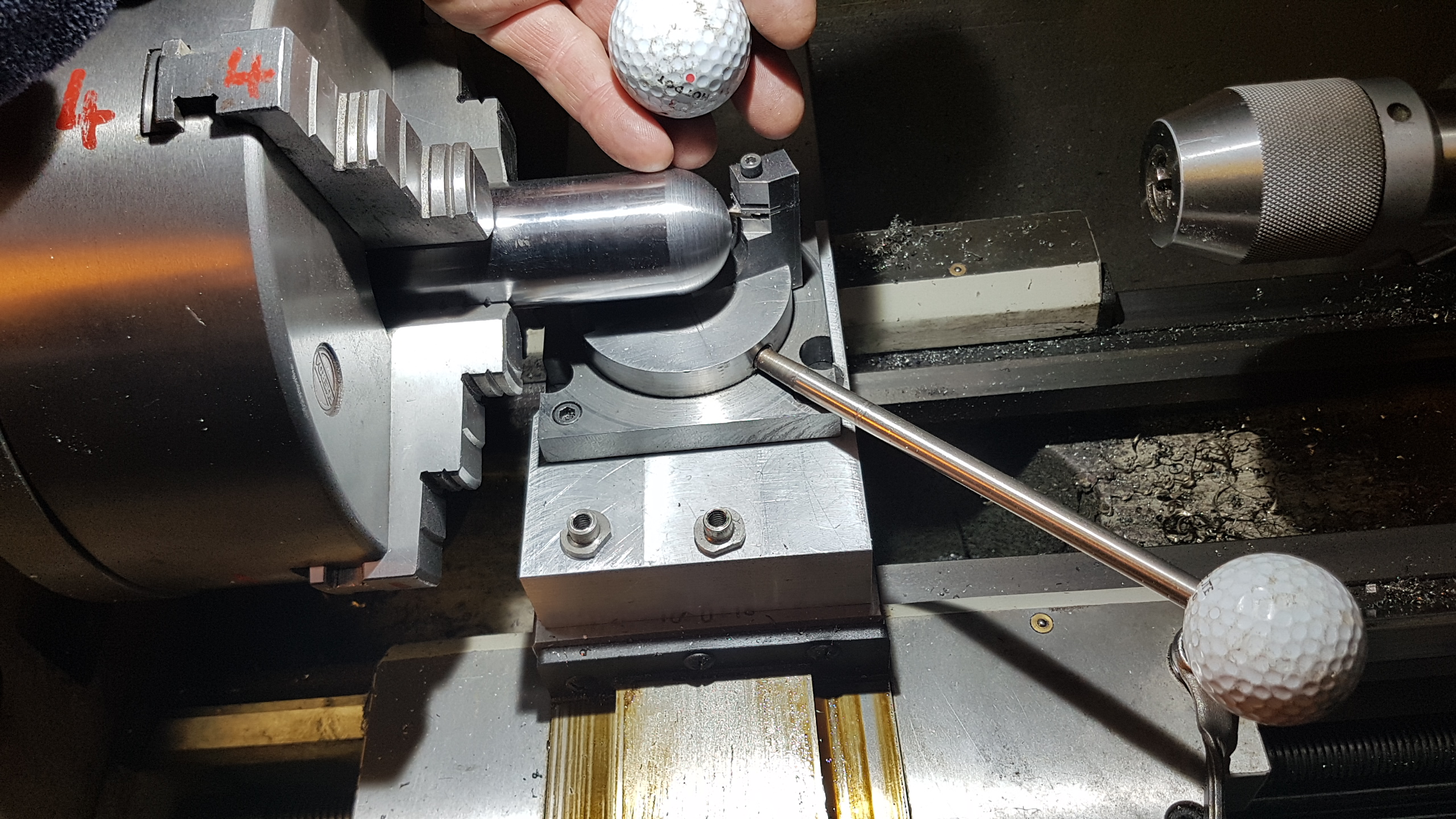

    Golf balls make great handle ends. They are very comfortable in your hand, extremely easy to fit, a visual novelty, free or very cheap and electrically insulated. Just make sure you drill the hole using a lathe (so as to easily locate the hole symmetricaly along the axis of the ball) and drill 1 mm undersize for the shaft you're fitting, then press on.Golf ball handle ends-golf-ball-handle.jpg No tapping of threads or adhesive necessary yet the ball can be removed if necessary without damage. Join the club!

    I don't play golf either, except at the 19th hole. Waste of a good walk they say. The recent golf balls I've used in the workshop are solid plastic, and drill very well with 10 mm holes at 600 rpm, no melting or fumes. Perfect for drill press knobs.
