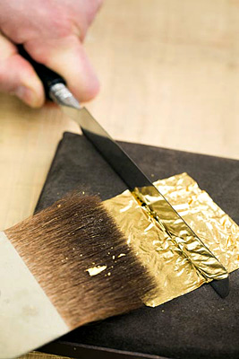

    May I ask some advice about gilding with gold leaf?
    I will build soon a pair of speaker with 8" fullrange, I was thinking about a gold-copper inlay on wood front panel. The idea is to use a chisel, or dremel to create a tree pattern, use bolo clay (or vermilio paint as base), glue and try to add the thin gold layer. I read that there are also some bitumen wax or special paint to age the inlay.
    I know that a mininum of tools is required for a flat gilding, a sort of special knife (I wanted to use a sharp scalpel), a cushion to lay and cut the leaf and a Vajo brush (squirrel hair?) to move the gold.
    Any advice about this mad idea?
    Thanks!

    Well, bookbinding is a specialty of mine and it involves laying a good bit of leaf. So I guess I can weigh in here.
    It sounds like you have the general ideas right. Although by glue I'm you probably mean "gilding size" not Elmer's. The knife you've shown is ideal, but a kitchen table knife can work. It does not need to be particularly sharp, the leaf will cut with ease. The cushion can simply be any smooth cloth folded over several times. The squirrel hair brushes are ideal but fairly expensive and so soft you won't use them for anything else. A goat hair brush or cotton ball can work quite well too. Another approach is to use "transfer gold leaf" which has a tissue paper backing making it easy to apply, no brush needed.
    1) No drafts. Windows closed, air vents closed, no pets or kids. The leaf is so very light it will blow away from you with any draft of air. Transfer leaf is the exception to this and hence it's normal use is outdoors.
    2) Practice on something non-critical first.
    3) You can layer multiple pieces of gold over each other to cover boo-boos and to add "depth" of color.
    4) Don't worry about the edges of separate pieces showing when they are laid over one another. They will all burnish into invisibility.
    5) Don't try to cut exact shapes of gold. Make the piece larger than needed. The gold will only stick where you've put the size. Any excess can easily be rubbed off.
    Probably tons more could be said but just try it. It can take a lifetime to "master" but you can likely do a pretty good job first time out.
    Lots of videos and suppliers online.

    I’d say Inner has given sound advice.
    I’ve used gold and silver leaf in the transfer form and while I’m not skilled at it the results were quite satisfactory.
    I definitely recommend practice and test runs. The color of the underlying surface can show through due to inconsistencies in the size so consider base color that will accentuate the look you are going for. And you won’t need any sharp tools. The stuff is so thin that it floats and bunches and sticks and tears and blows and waves. It can be frustrating and yet also very rewarding.
    Good luck and have fun with it!
