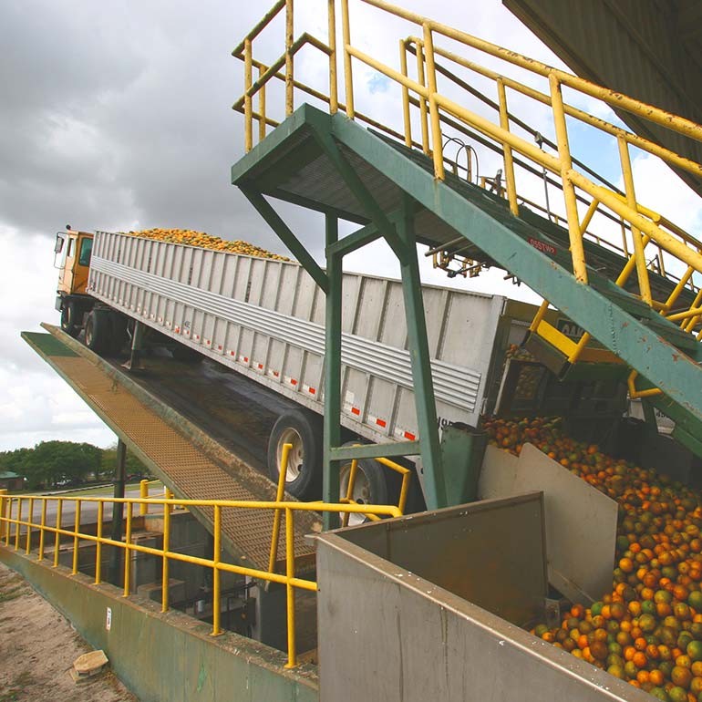

    They use them for oranges too

    Not many grain trailers are equipped to be dumps but since the popularity of live floors has come on the scene many grain elevators and other facilities have managed to ramp up their offloading production by having several drop chutes for the trailers to back up to. But the belly dump trailers are by far the fastest they can be unloaded in motion. The driver drives over a trench and begins to open the belly doors by the time he reaches the other end he just closes the doors and drives back across the scales for his weigh out ticket. Weigh in weigh out never even comes to a stop, unless his company is not on the list. One of the largest collection of grain elevators in the country is in Saginaw Tx. back in the late 70s/ early 80's my shop was directly across the road from one of them we could just see the lift raising trucks off in the distance but at times there could be as many as 300 trucks waiting to unload some with live floors some belly dumps and some put up on the lift.

    I worked 40 years at Weyehaeuser pulp and paper, they had 4 or 5 ( they were putting a couple more larger ones by the the time I retired. Chip truck dumps were what was called "chip facilities department" on one end of the mill. There was two hog fuel dumps just like them at the other end of the mill, at the hog boilers that burned it the for electricity. On top of that the the pulp chip facilities also had a rail car dump that was neat to watch as they rolled one large chip car over and dumped into the conveyer in the pit! The rail car was secured in a large clamping frame work and just rolled over hydraulically! The chip cars were big, a little more than twice the size of two chip trucks! But as for riding along in the chip truck as it's being dumped, is absolutely illegal! As we have seen a couple hydraulic failure!
