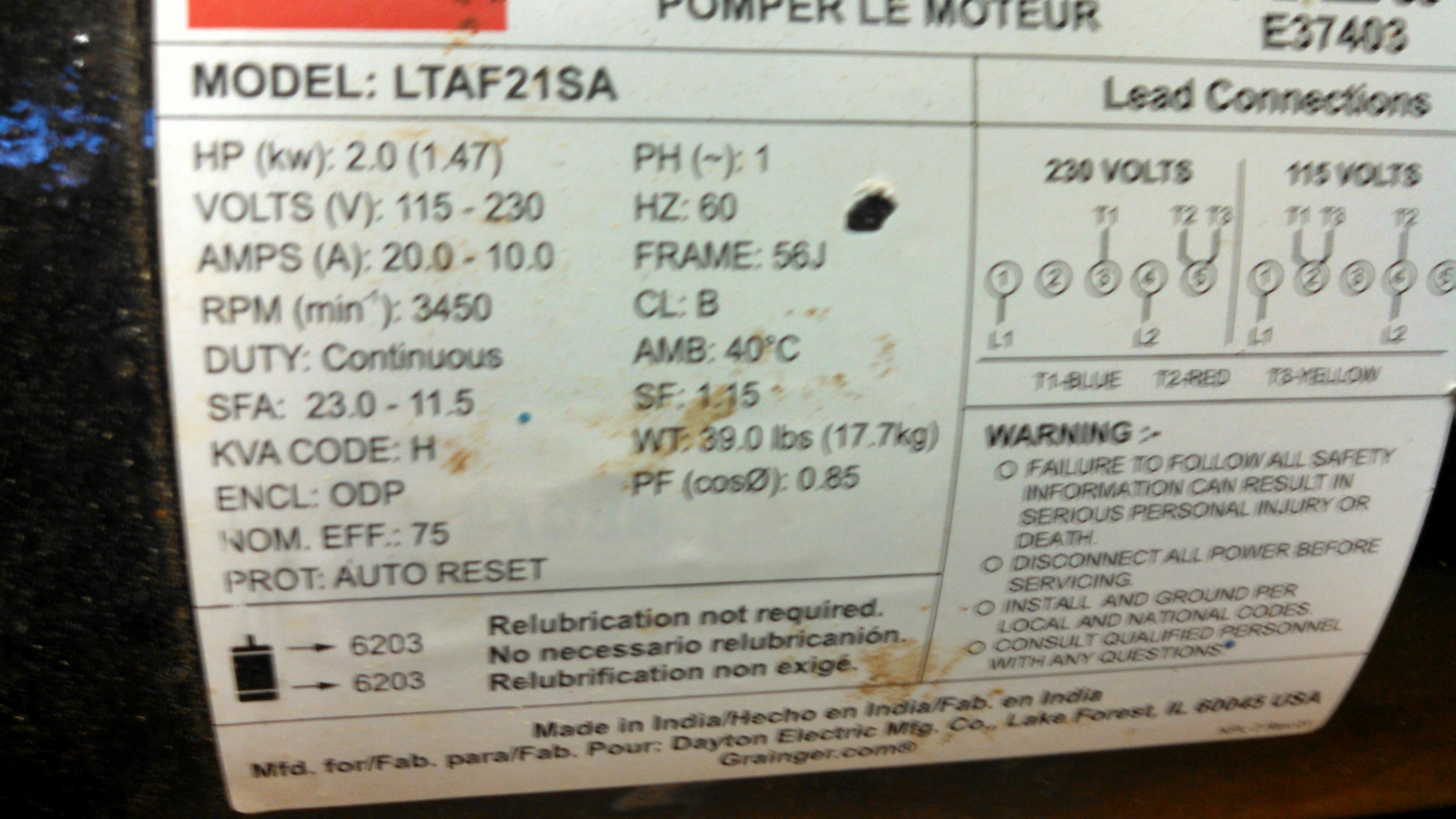

    What would these pumps be best for? 2hp 1ph 115/130v. Are these too powerful for disc sanders? Would these be good for a band saw? Any good ideas that would suit these motors? I have at least 3 or 4. They were used for centrifugal pumps. Thanks

    Wow, lucky you! For what it's worth(and you are getting it free) I don't see hp as the limitation if you build or modify SAFELY. Good frames with proper guards all done right will mean you'll have quality equipment. Most manufacturers make their equipment as "economically" as possible. Smaller motors are cheaper. These are quality industrial motors that are made for harsh environments which means they are perfect for a dusty environment like a wood shop. Speaking of which. One of the first things I'd make or modify would be a dust collector. Not only is it a mess and a fire hazard it's horrible for your lungs.
    Where I see your challenges will be in mounting and speed. Flange mount is not seen as much in the home shop equipment and not everything runs at 3400rpm, so you'll have to check your speeds.

    Sorry if you know all this.
    What's not immediately apparent with the cyclone/vac setup is its efficiency over one of those dust collectors. Everything that's sucked up with a dust collector goes through the fan blades. So they get caked and worn and lose efficiency. Then there's the way the dust collector body is set up. It's usually big with no taper and the filter(bag)is exposed to the swirling dust.
    In a cyclone the vacuum tube comes in from the top and goes somewhere about 3/5's the way down. And the inlet comes in at an angle even with top /side of the cyclone,this spins the dust fast and as it goes down the tapered side it gets even faster making the dust even as fine as powdercoat separate out then fall in the bottom of the bucket. And because the vac is after the cyclone it is pulling on clean air. It is really old tech that I saw the big ones sitting outside of shops all my life and never gave them any thought until I fell down the rabbit hole of trying to save my vac filters from getting clogged with powdercoat dust. Meanwhile along come Dyson and makes a mint selling you his "new tech".
