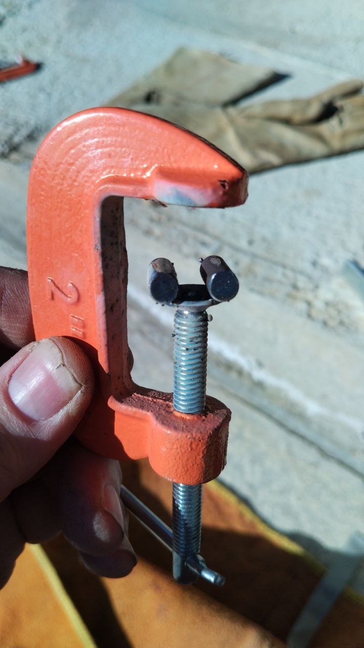

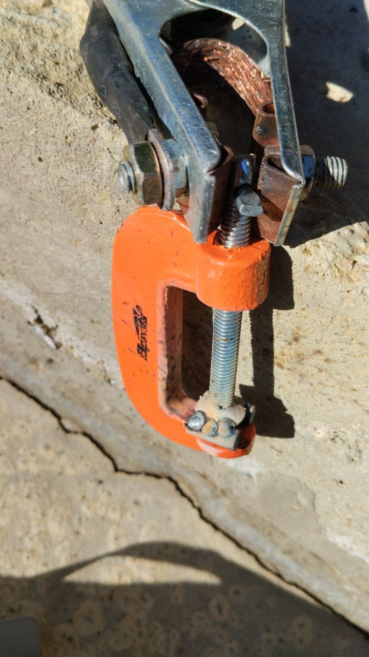

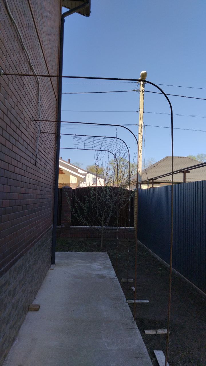

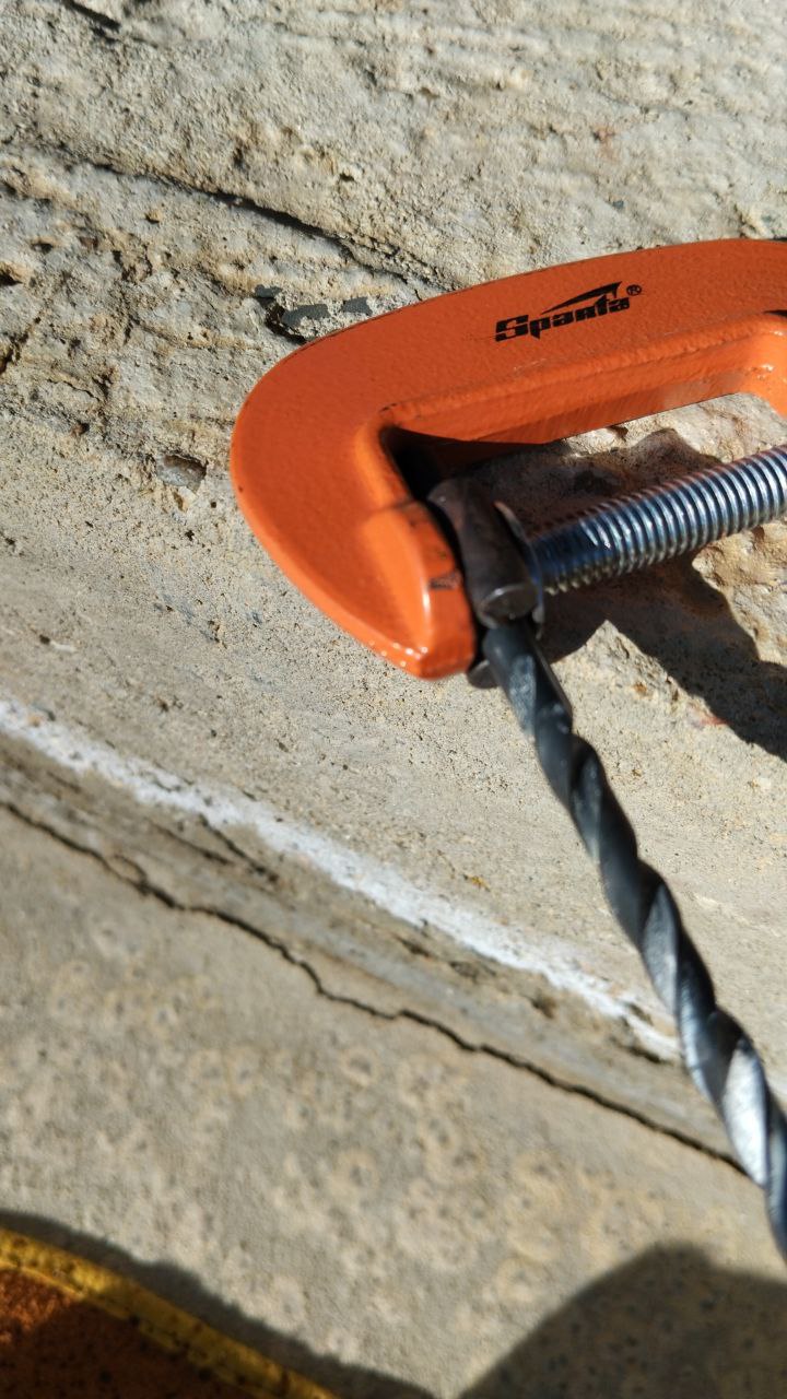

    Anyway, we've been working on finishing our house as we can. Currently we're building arbors for 18 grape vines and I needed a clamp to hold 4mm wire against 12mm bar during assembly.
    As you know, most clamps have flat faces and don't do well with round on round.
    So, we went browsing hardware stores and bought some cheap C clamps that I modified. It went something like this...
    Cut some scrap 6mm bar into short pieces, use a drill bit as a spacer and clamp them in the C clamp.
    Remove drill bit and prepare to weld
    Weld (20 amps with 0,8mm FCAW)
    Done

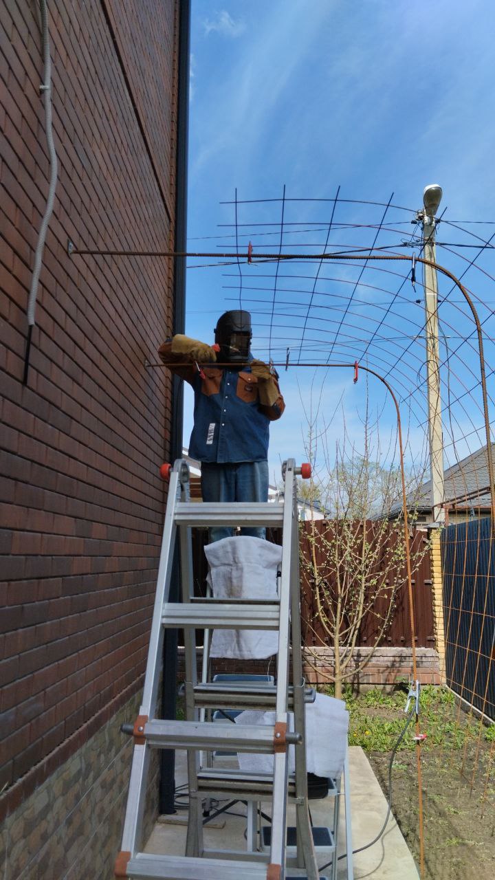

    Build arbors
    There will be some cross braces added to these, we just haven't cut the material for that yet.

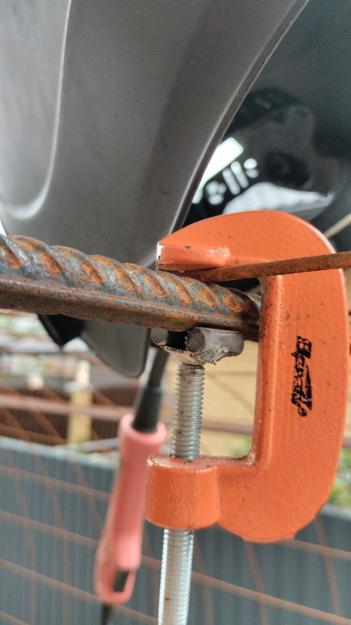

    Great solution.
    I certainly would have overthought this and made a handful of little v-blocks, and been short a 3rd hand to use them.

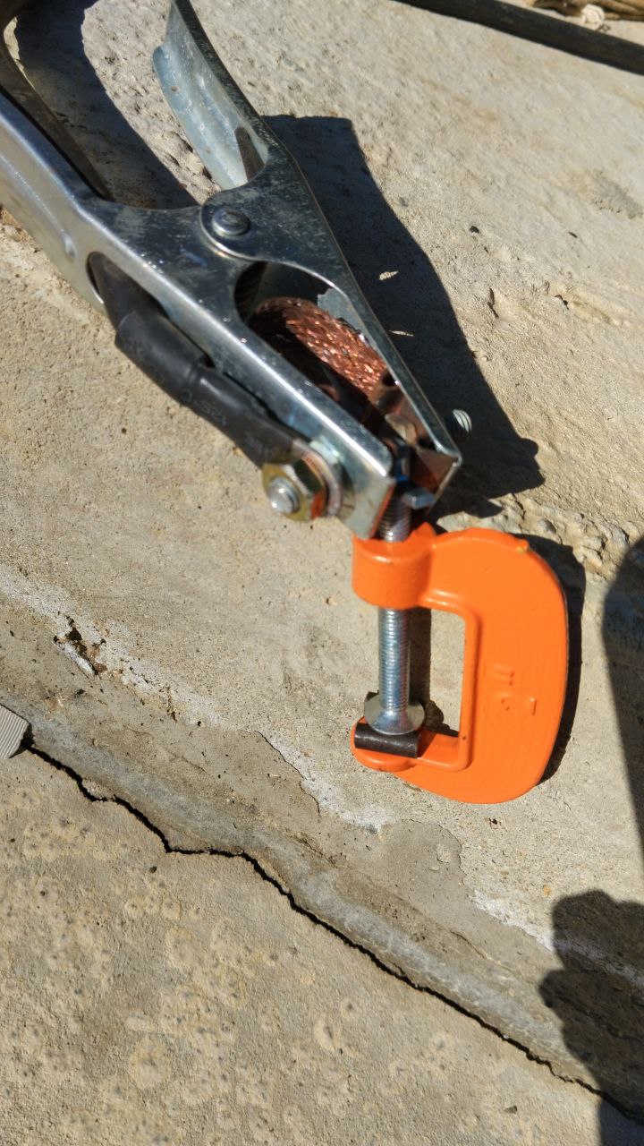

    I forgot to show the clamp in action! Duh!

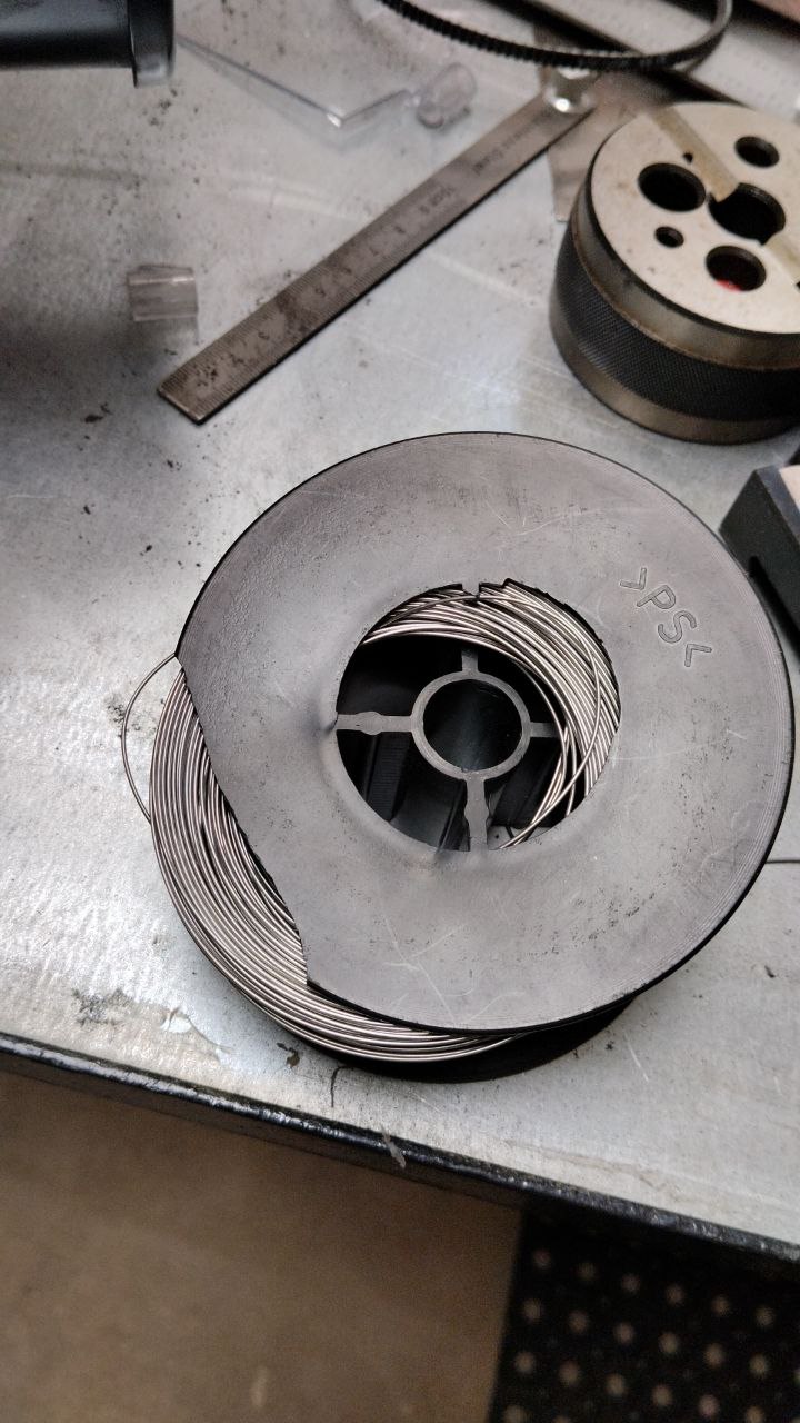

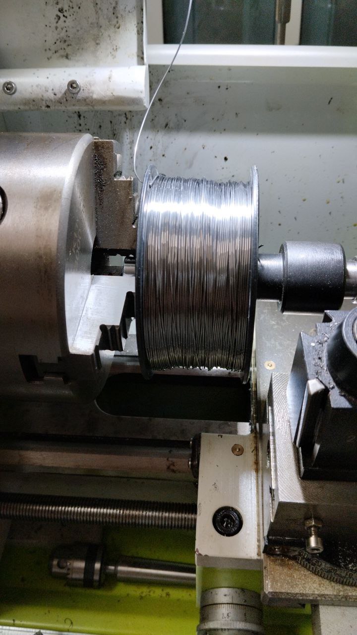

    I had purchased a couple of spools of welding wire back several months. Of course I didn't notice one was broken (still sealed in foil bag) until now when I went to use it.
    I have since bought more wire, so I popped on a new spool and finished my project.
    Now, about this broken spool. Do I toss it out? What, and be kicked off this forum? How could you even think that?!?!

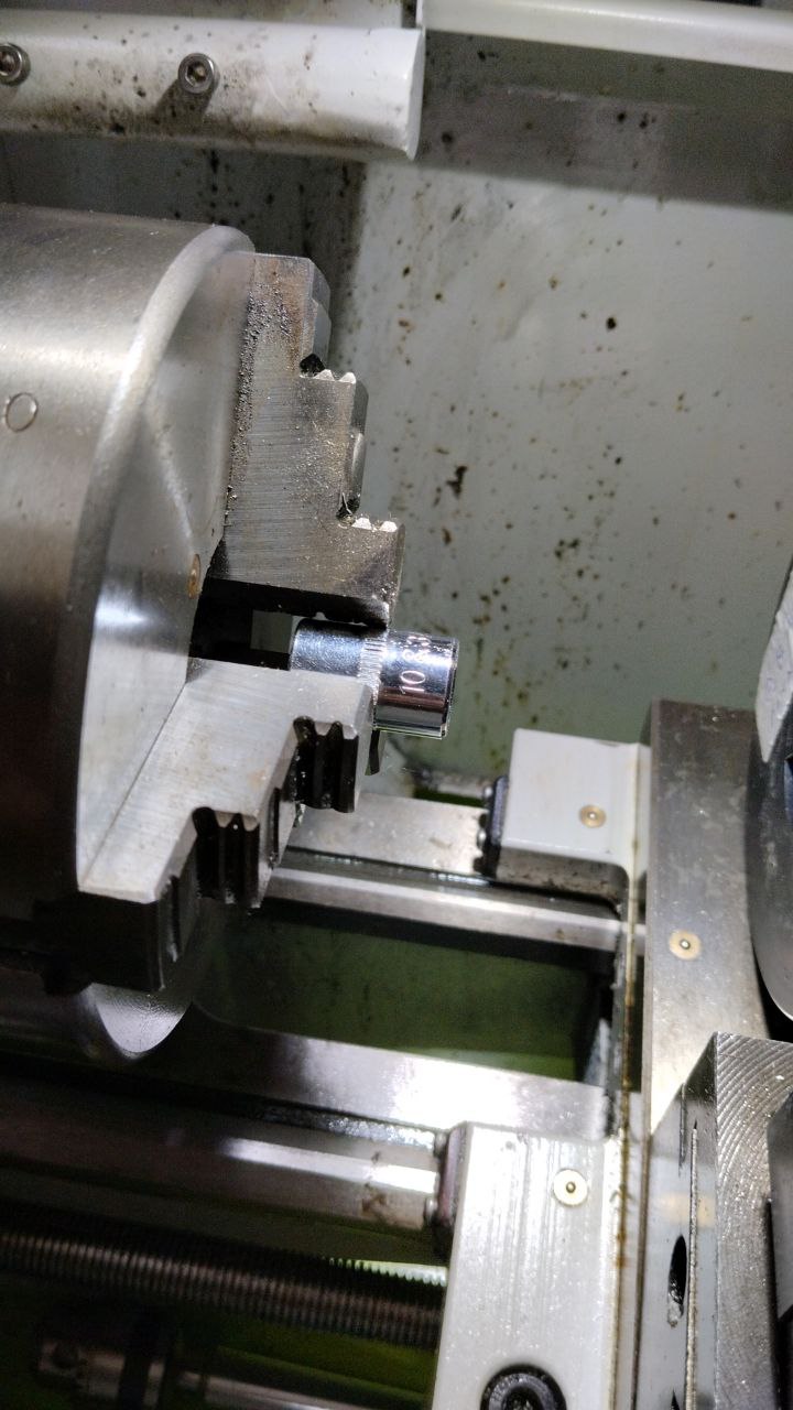

    I clamped a 10m socket into my lathe...

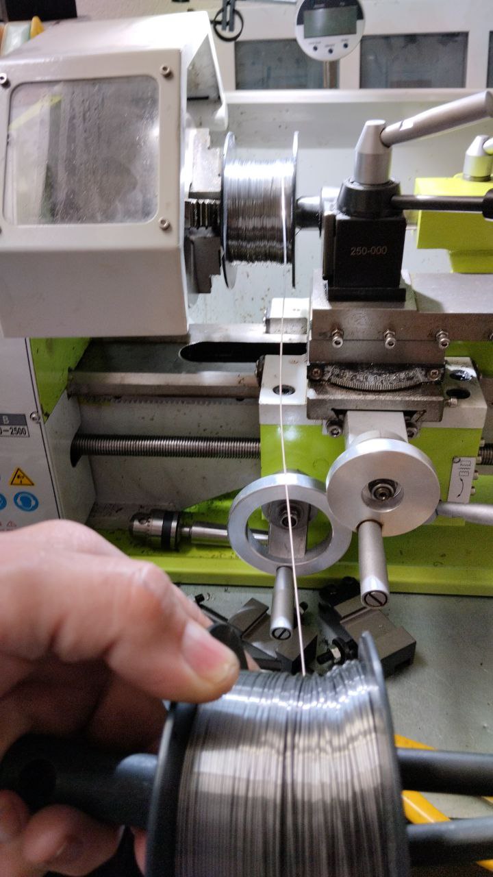

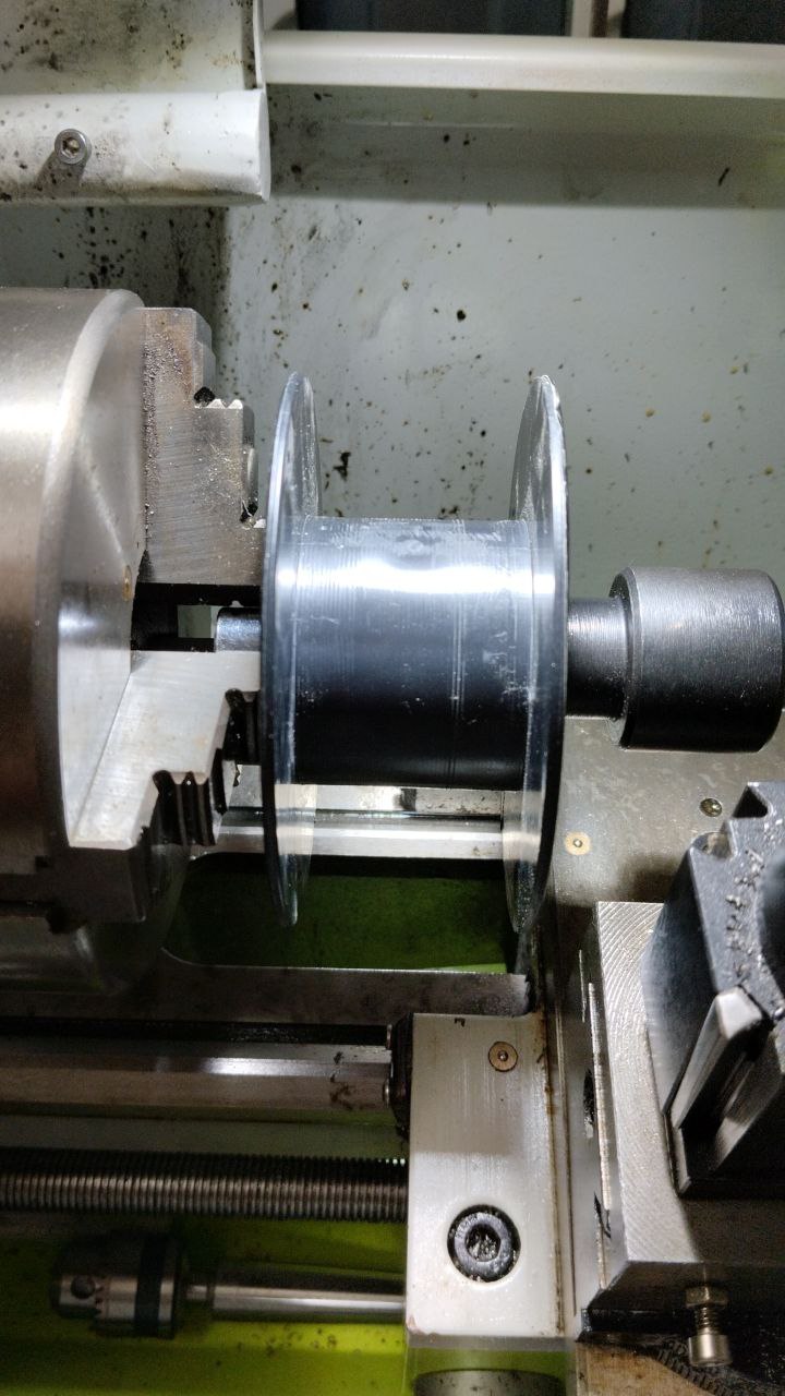

    and mounted an empty spool
    then, with the lathe on it's lowest speed (47rpm) I started transferring the wire over.
    I quickly found I needed to stuff some assorted lathe tools into the gaps in the spool hub to keep the wire from slipping down too far and kinking. Only a few meters of wire lost discovering that.
    And then, after what only seemed like two days, I was done.
    There's a few wavy sections of wire, but no kinks that would cause problems.
    I hope.

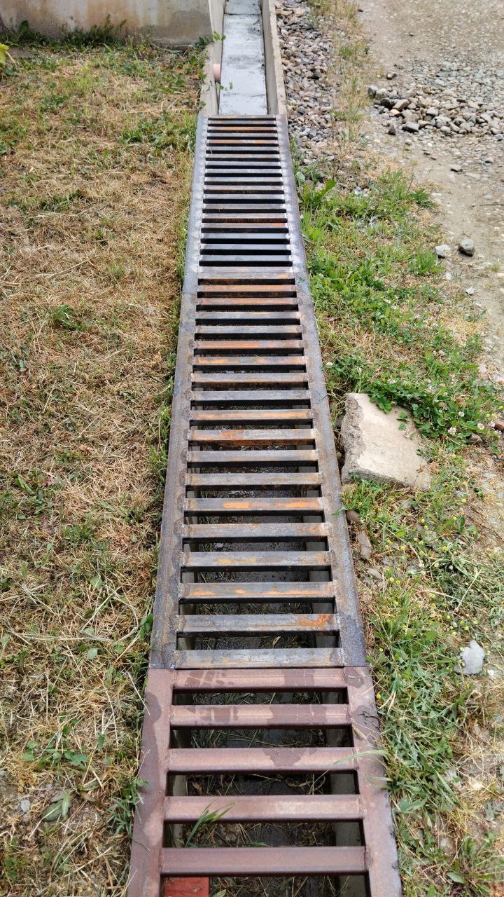

    We made two more sections of storm drain cover to make getting out of the driveway easier. The across the street neighbor put up a short wall directly across from us which makes backing out more interesting. Now with the grates on both sides of the driveway I don't need to worry about the ditch. We plan to cover the ditch the entire width of our property in the future.

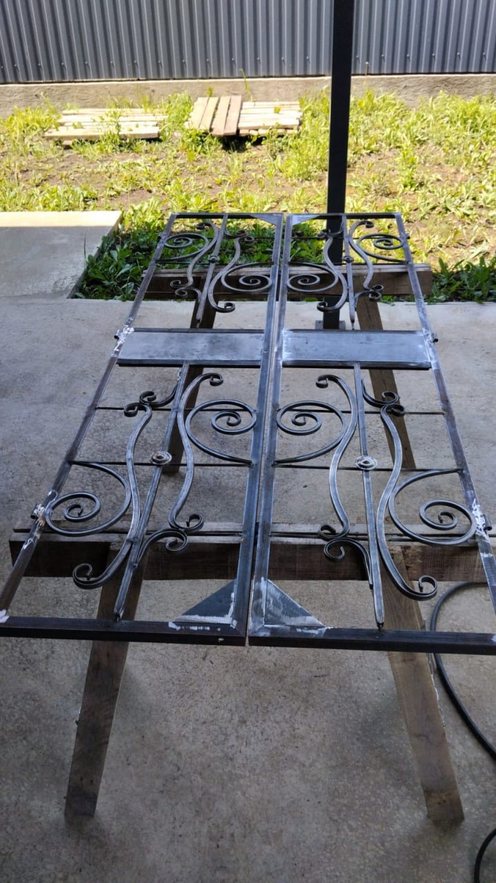

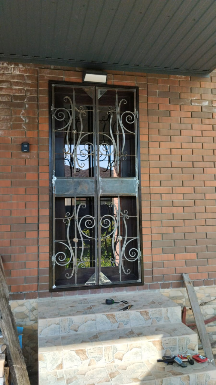

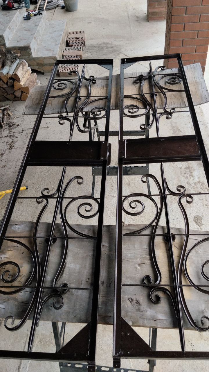

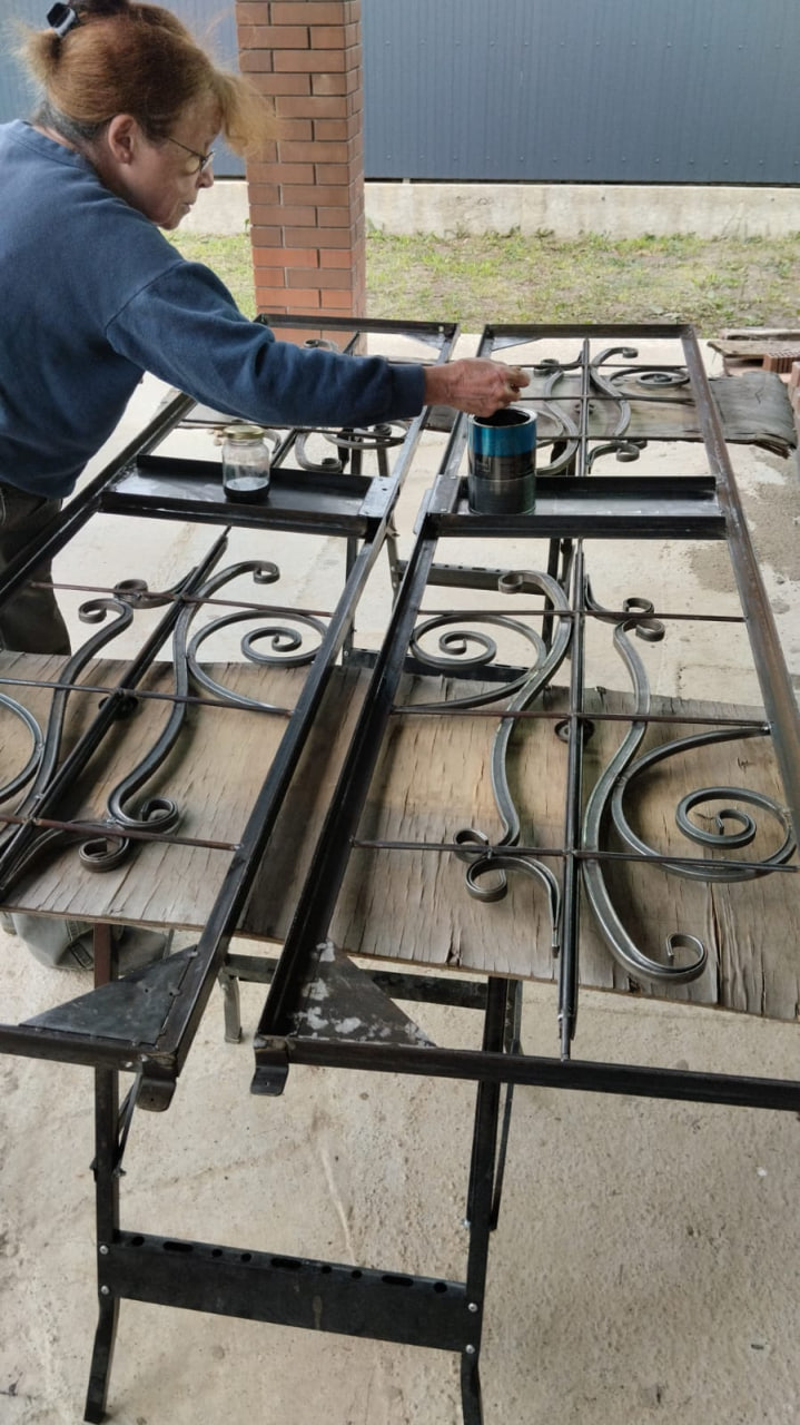

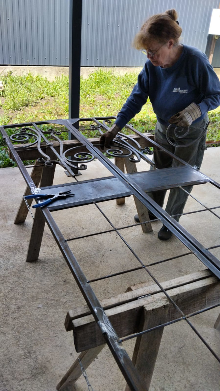

    We also made a security door for our back door.
    My wife test fitting the scrolls, she used to do this for a living many years ago.
    ready to weld
    in place, not finished
    her painting
    And backside painting done. This is brown blacksmith paint, we've painted other things with it and it seems to hold up well.

    I forgot to mention, that welding wire I respooled worked great. Used the entire spool with no kinks/bends/birdsnests.
