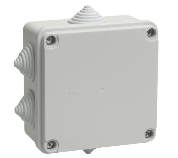

    A lot of people don't use any conduit, as you saw was in her shop from before. The surface mount electrical boxes generally come with glands or just rubber diaphragms that you cut a hole in and stuff the wire through. Since the subpanel will be in the shop which will have students in it, I opted for rigid pvc. When I run the long wire over to the greenhouse that will be in the super flex and just run through the attic and then under the patio roof over to the greenhouse.
    Here's some red stuff, no metal, just plastic. It's not really split, that's just for illustration.
    a junction box. The stepped cones are a flex rubber-like substance.

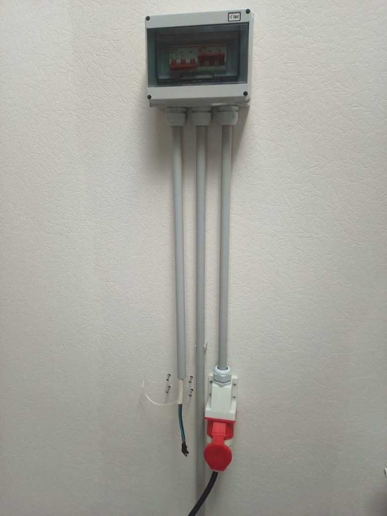

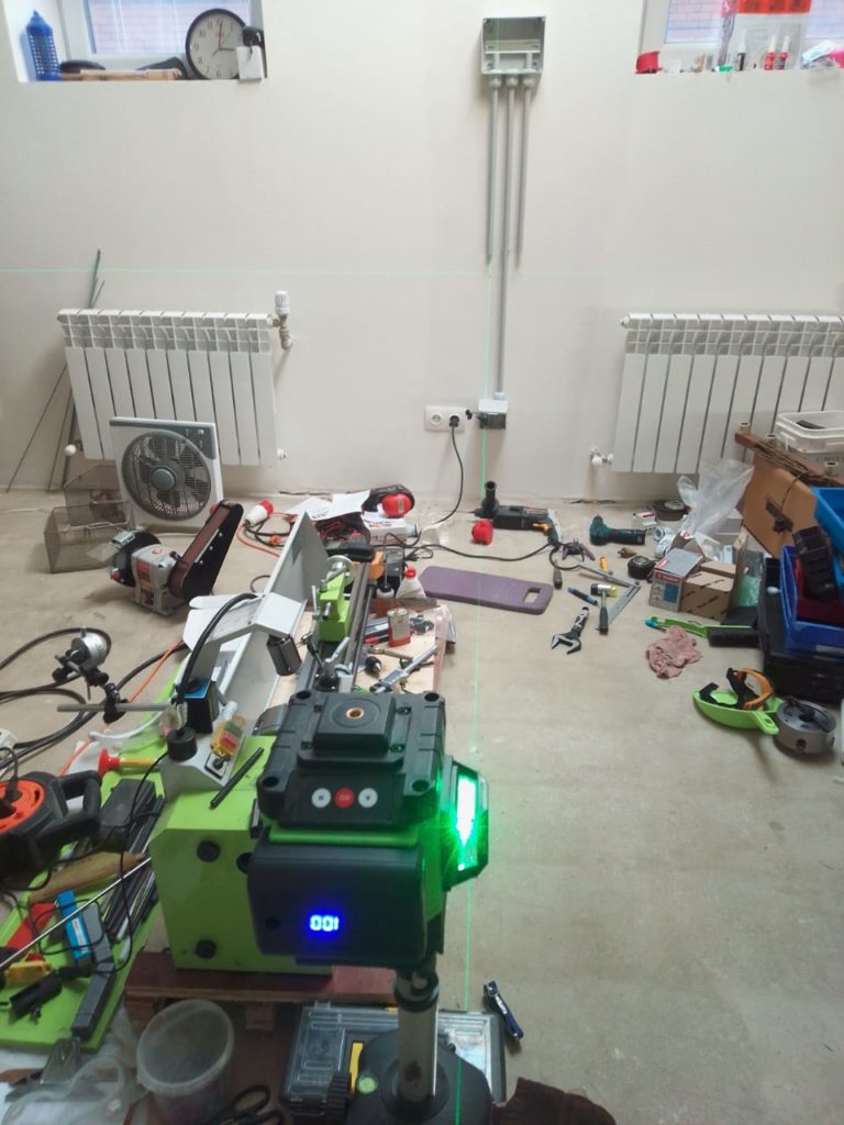

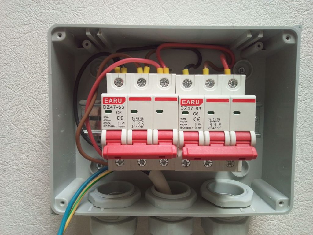

    Got the sub panel installed, but one of the Chinese outlets was bad, so I'll have to get a new one tomorrow. But, I hooked everything else up, plugged the saw in and it even goes in the right direction!
    The electrician just left a VERY stiff cable hanging out of the wall so I put a junction box over it, then connected that to the sub panel.
    Getting my Russian shop set up-95e20135-3388-4c39-a868-b9f310f5ee6f-768x1024.jpeg
    Getting my Russian shop set up-18acd8da-08ca-4383-b0e2-b88f28cdb2c5-768x1024.jpeg
    About time to bring in the milling machine. We've got students coming in about 2 weeks.

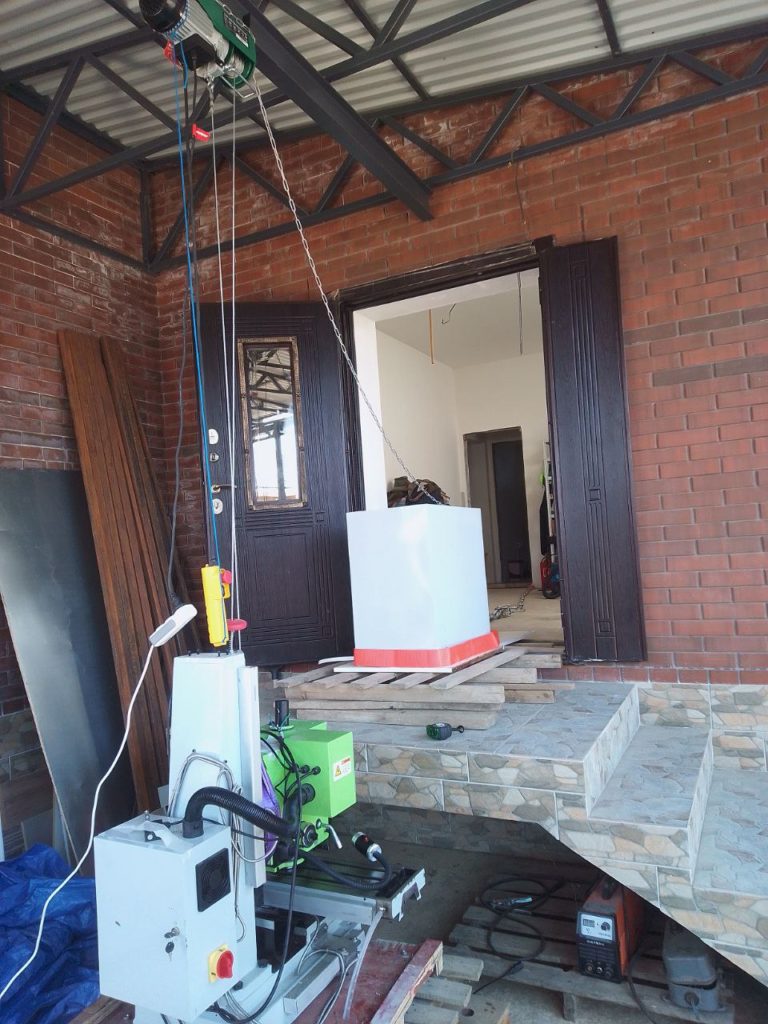

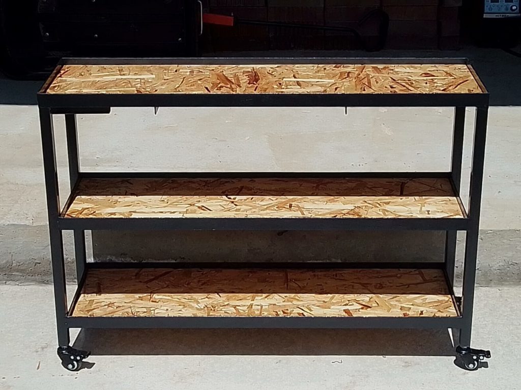

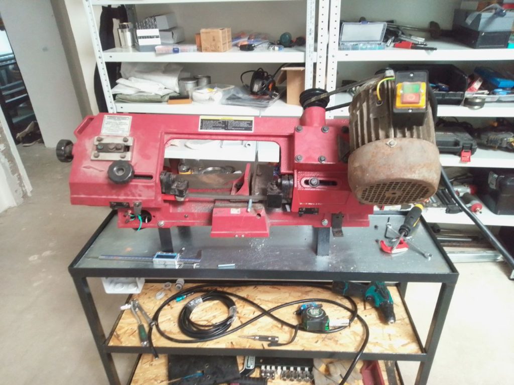

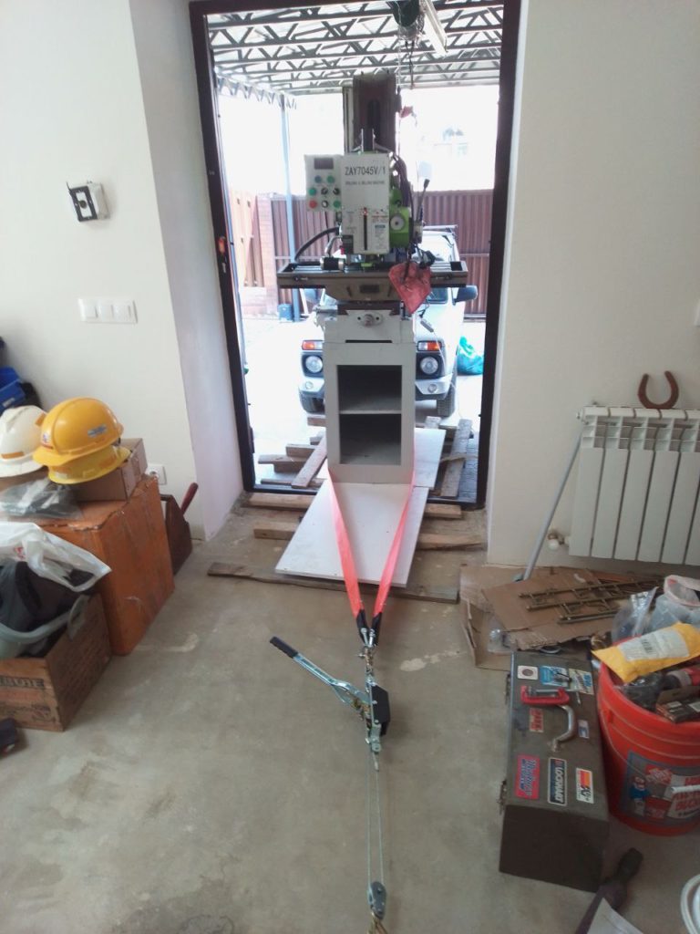

    Ok, some more work done. Band saw stand built and saw attached. I still have to add the automatic shutoff, coolant pump and tank, and a hydraulic downfeed damper. I have all the parts but for now this is good enough and it's off to other things.
    Getting my Russian shop set up-f404ad6b-0375-4358-b7ba-13f3c54cd42e-1024x768.jpeg
    On to the adventure of moving the milling machine into the shop.
    First, clean a space.

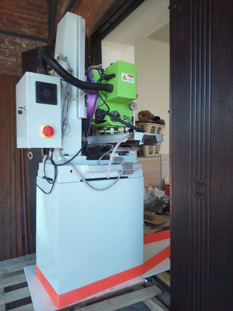

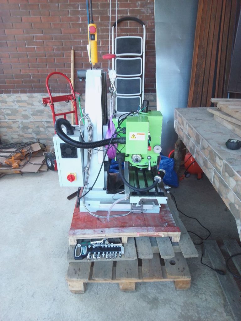

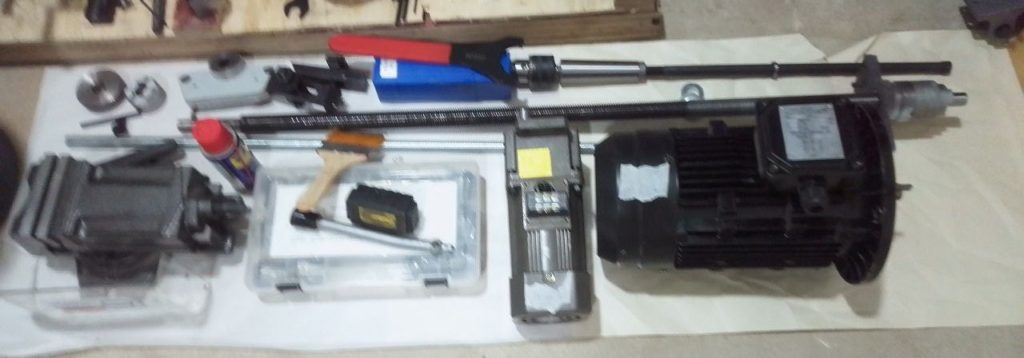

    Next I removed anything that was easy to remove from the milling machine such as the motors. This made it lighter and shorter. Here’s some of the items I removed.
    Here’s the milling machine with the parts removed and ready to be lifted onto the base.
    With all parts I removed, it STILL weights 297 kg!

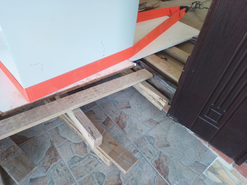

    How to get this machine from the driveway into the shop. As always, carefully plan out how you’re going to do it. Things will never go exactly according to plan, but it’s much better to have a plan to start with.
    Using a pallet and assorted wood including some nice smooth panels recovered from discarded furniture, I built a platform on the porch that was slightly higher than the door sill and tilted down towards the floor inside. It will turn out I got it a little too close to the floor and it made getting the wheels under the machine difficult.

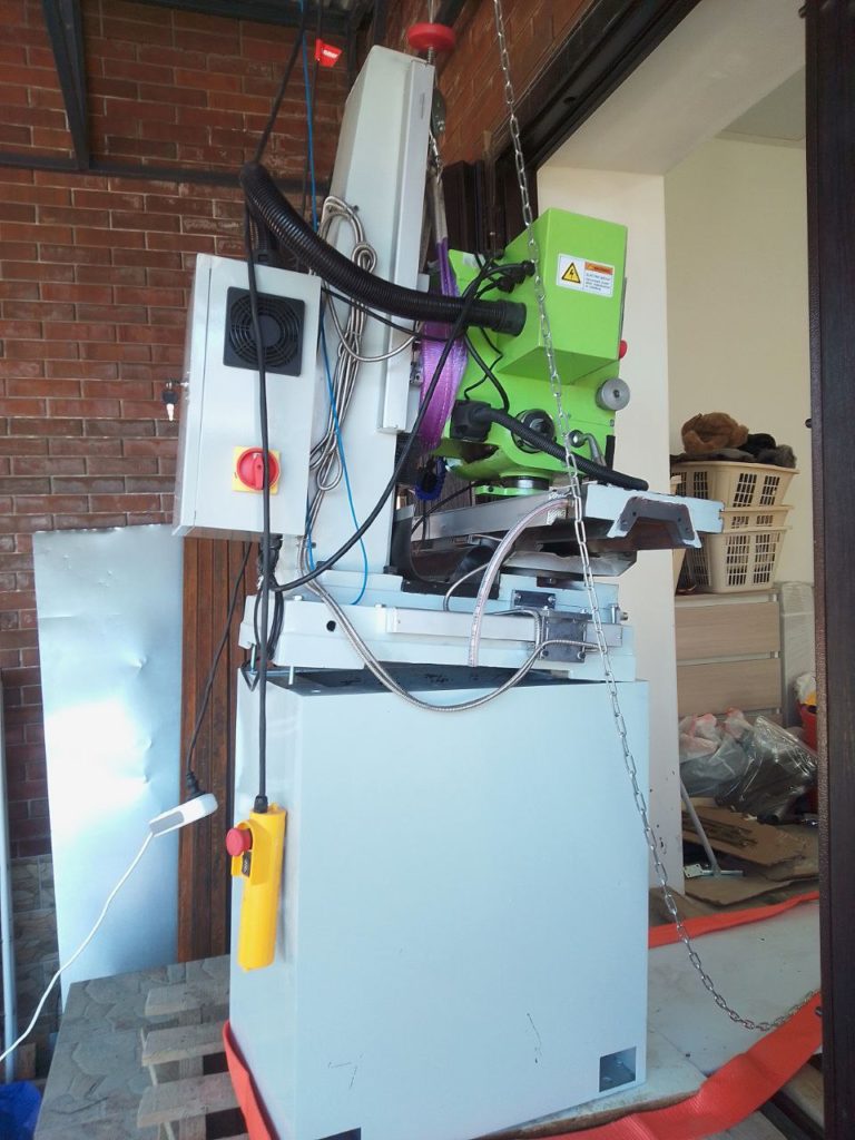

    Now it’s a “simple” matter to lift the machine up and set it gently on the base.
    Bolts installed, ready for next step. There should be a drip tray like a giant cooking sheet that sits between the top and the base, but that was lost in shipping along with several other parts. Those are on their way, but that means I’ll have to lift the top part off the base again to install the tray. I will be a portable hoist for use inside the shop to do this.

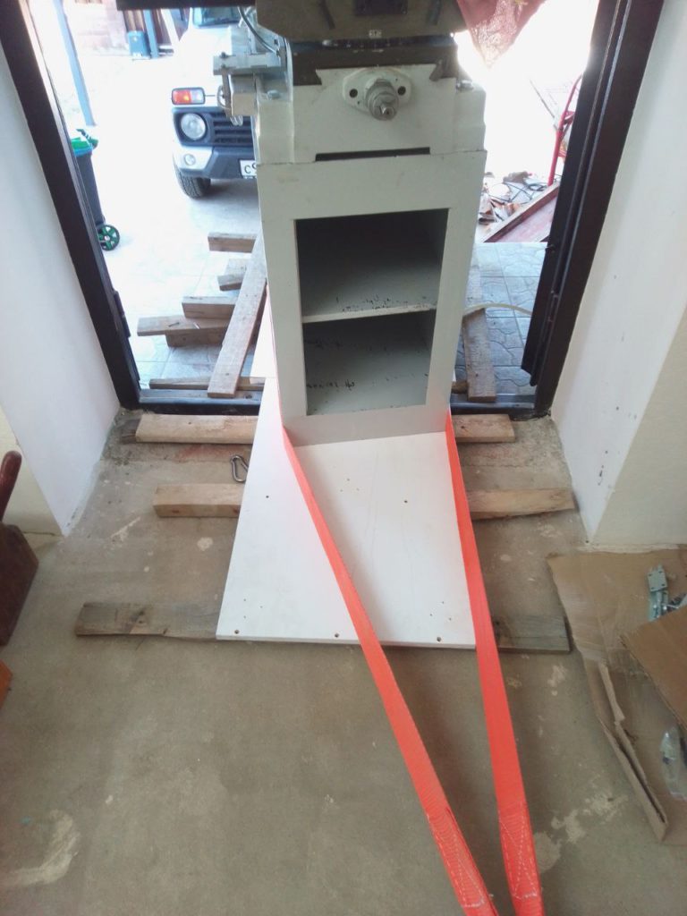

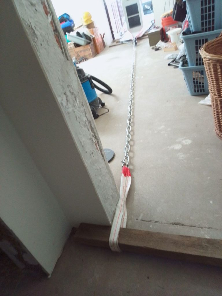

    The next pictures show carefully, slowly pulling this into the shop. The red strap is a tow strap for an automobile.
    The little wheels under this are “Extra Heavy Duty” furniture moving wheels. They just barely held the load and were somewhat damaged.

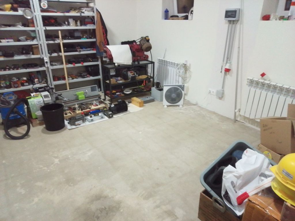

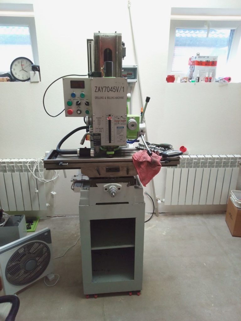

    And here is where it will sit. It will have to be moved for when we finish the floor, but after that it will be bolted down so it can’t tip over.
    I decided to stop there for the day. Tomorrow I’ll put all the pieces back on that I have and connect it to power. I will have to 3D print some hand wheels for it as it will be some time before the replacement ones get here. Also the motor that moves the table right and left was also lost, so for now it’s all done by turning the hand wheels.

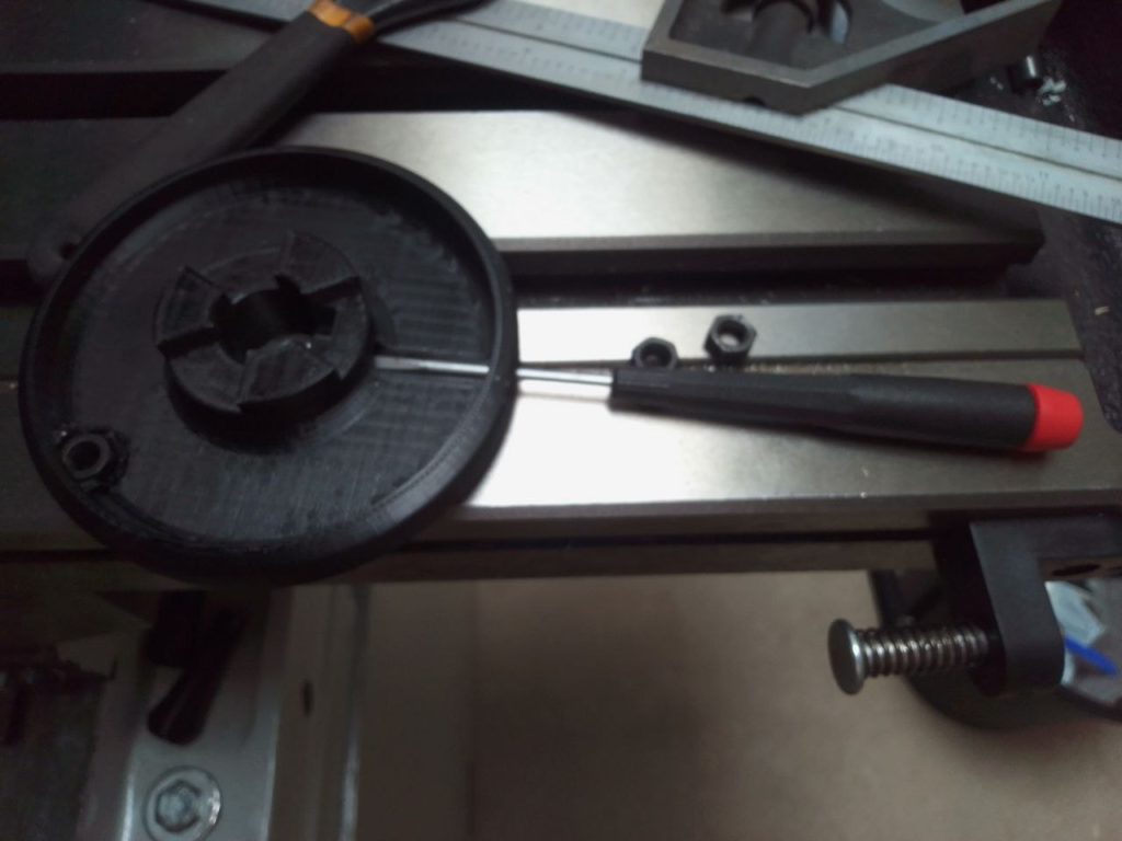

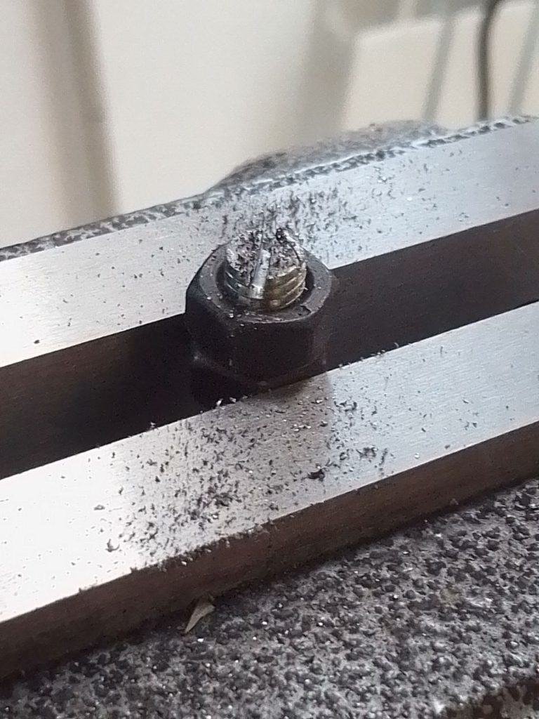

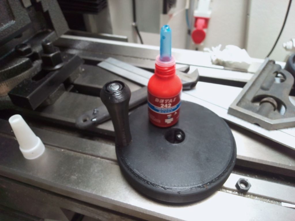

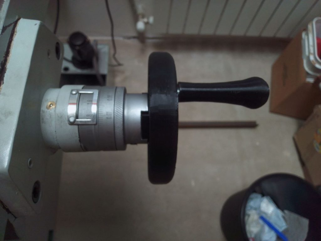

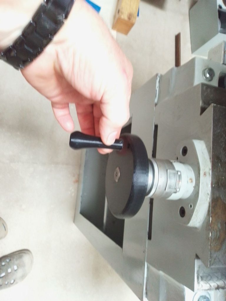

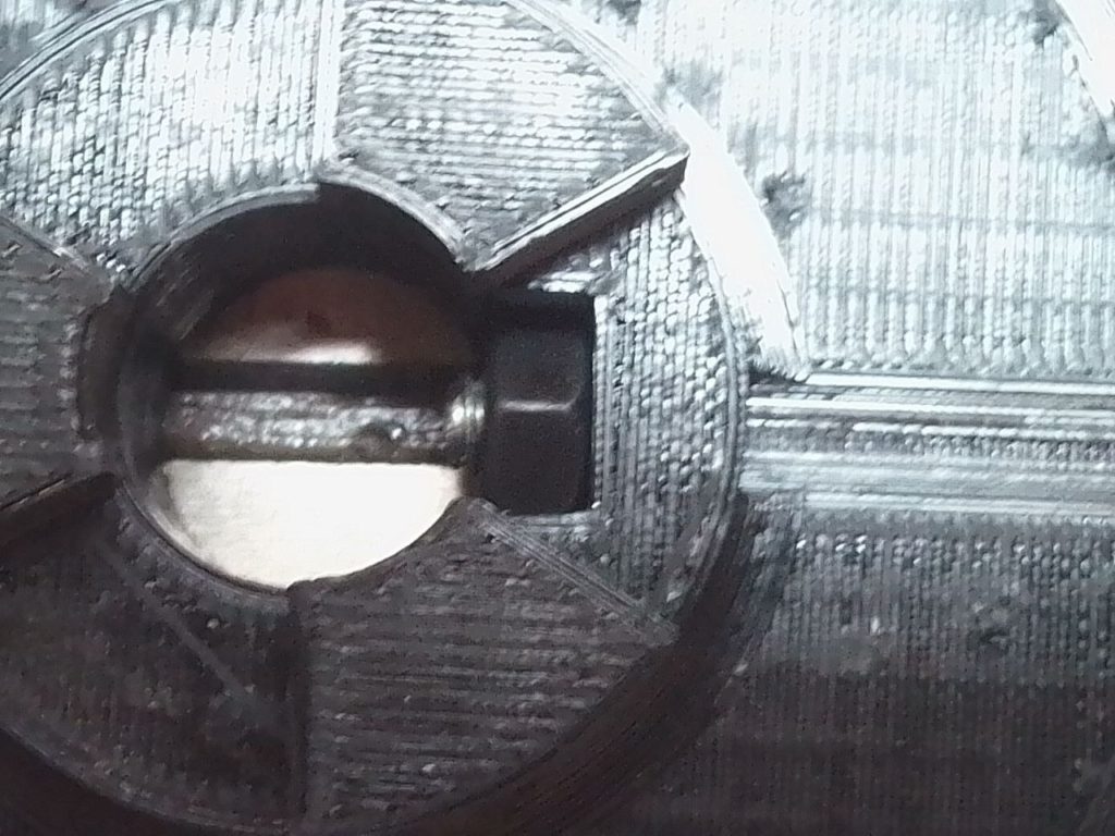

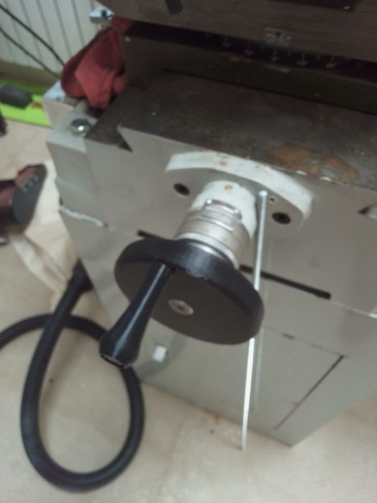

    Two of the things lost in shipping (seems the box was opened for "inspection" and all the not-bolted-down stuff "fell out") were the M16 draw bolt and the hand wheels.
    While waiting for the replacement parts to arrive (it's becoming a Johnny Cash Cadillac), I bought a stick of M16 running thread (all thread) and nuts as well as designing hand wheels to 3D print.
    Printed the wheels yesterday and when I got up this morning I started the handles printing. They would finish in a short while.
    Went downstairs and started looking at the news while sipping on my tea. I went up to turn off the printer and get the handles, came downstairs and the power went off.
    Turned off computers (battery backup), finished my tea and went to work.
    First, I put all the bits back on the mill (all the stuff I'd removed to make it lighter).
    Then make some set/grub screws for the wheels (after going to the store to get a hacksaw), and put the wheels and draw bolt on the mill. I waited for the power to come back to cut the M16 bolt.
    I had to modify the recess for the handle nut, I hadn't left enough clearance. I simply cut out the plastic, these aren't for show.
    And THEN, the power came back on late afternoon. That's the longest power failure we've had here since the big flood of 2021.
    So, draw bolt cut off, mill powered up and tested. All good.

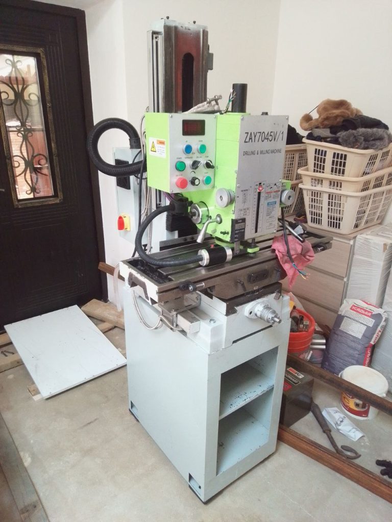

    Today I'm cleaning and adjusting the mill head. Peeled off the shipping plastic on the big name plate and used orange oil to clean off the glue. Looks a LOT better. Noticed some binding in the spindle DRO (just one of the bolt-on overgrown caliper ones). Got a big hammer and made some delicate adjustments
    Anyway, cleaned, back together, automatic downfeed gears greased... looks and works well.
    My wife determined she can definitely hear the variable speed drive whining and doesn't like it. I'll have to see if I can change the PWM frequency on that, can't be driving the spouse crazy (ok, she's lived with me for decades, don't driver her crazier or saner).
