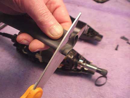

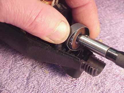

    Some readers probably think of the Dremel as a tool with too much slop in the frontend. You can fix that problem with some shrink tubing around the bearing race to make a tight fit as Frank Ford shows here: FRETS.COM

    Also did the same kind of mod as reported by Mark above, but I used a piece of inner tube wrapped around the bearing.
