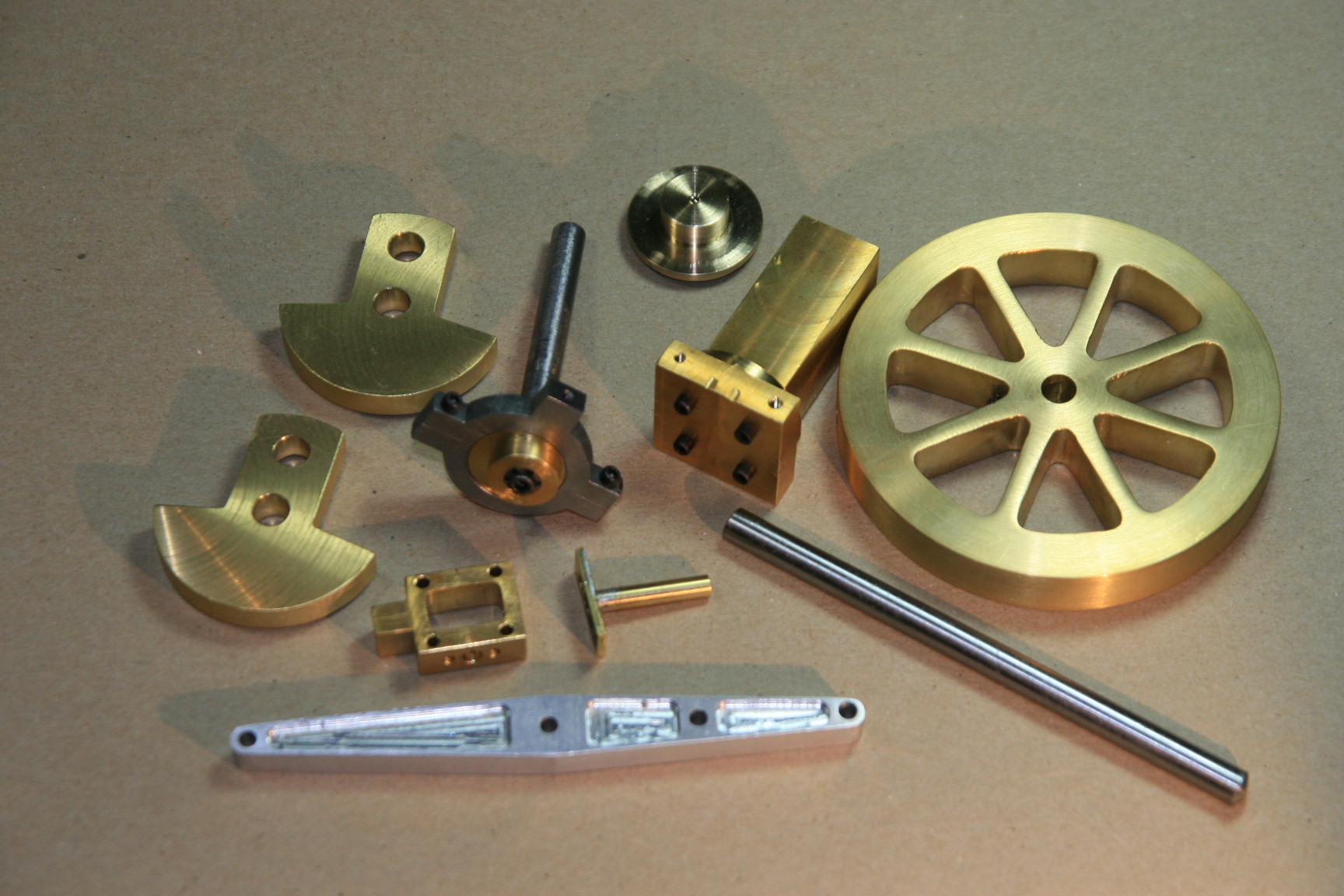

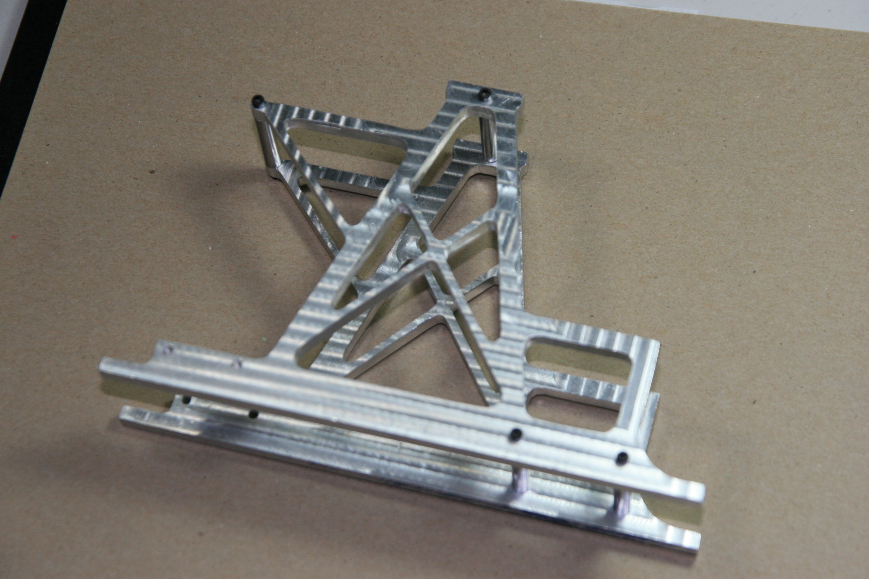

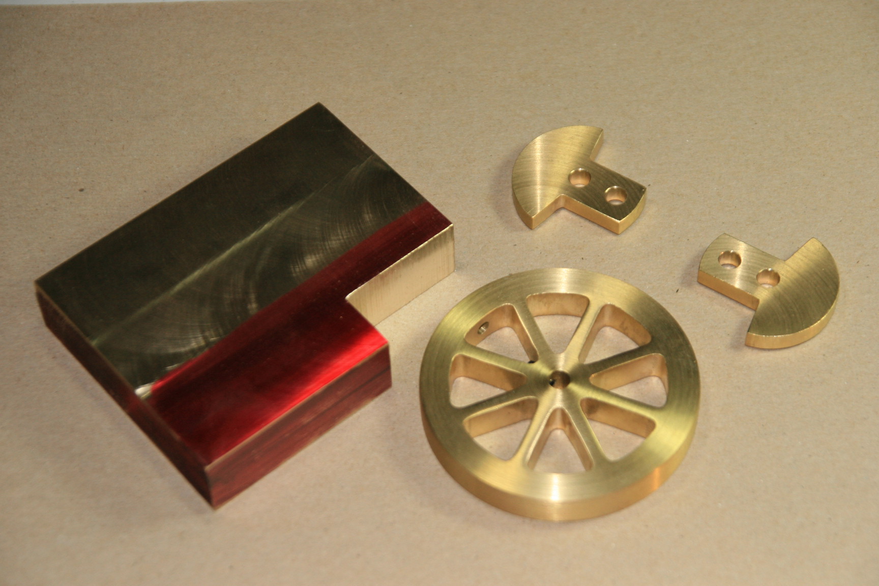

    A work in progress. Just had to have one of these so I thought I would build one.
    The frames and some of the linkages were made on my CNC machine. The rest
    was made in the shop with the lathe and mill. Still making parts for it and it
    has been quite a while ago that I started it. It will be done!
    When I do not know......
    Here are some pics of the parts so far:
    Attached Thumbnails Attached Thumbnails Gerry's Beam Engine-img_1085.jpg   Gerry's Beam Engine-img_1091.jpg   Gerry's Beam Engine-img_1092.jpg

    A few more parts

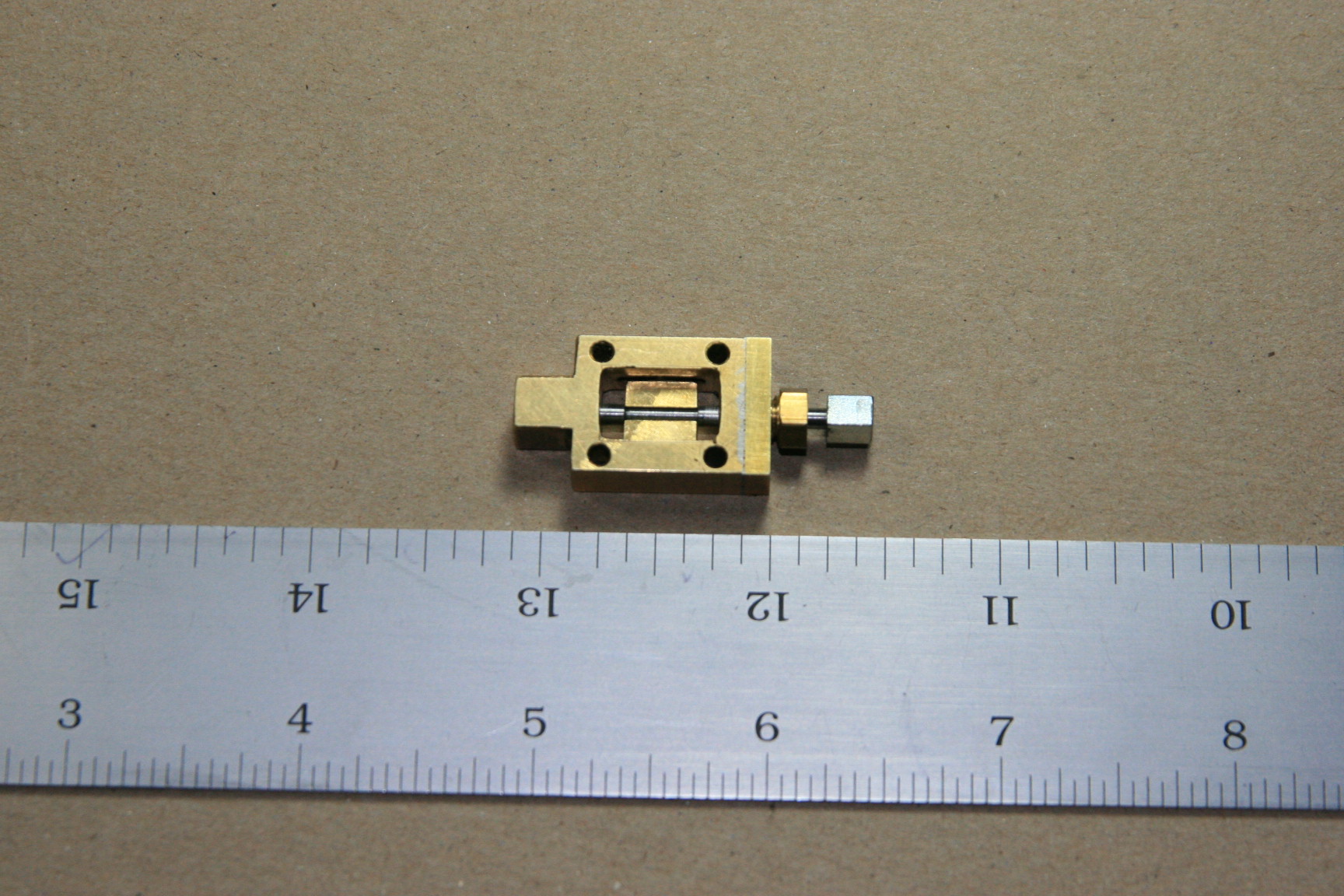

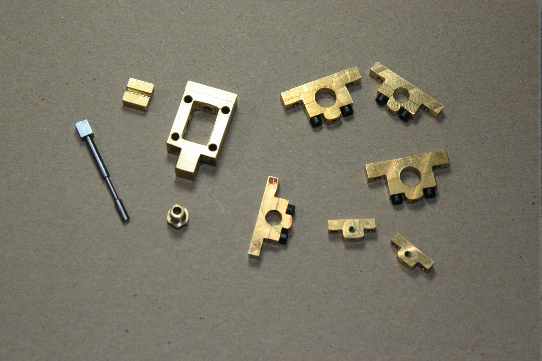

    Here is the latest progress on the little engine:
    The rod for the steam chest and valve was the most fun.
    Cheers, JR
    Attached Thumbnails Attached Thumbnails Gerry's Beam Engine-6.jpg   Gerry's Beam Engine-7.jpg

    With that steam chest arrangement it looks as if there is no way to fine tune the position of the D-valve. At least I can't detect one.
    In Elmer Verburg's design, the valve spindle is threaded. A slot in the D-valve restrains a nut through which the threaded spindle passes. The valve is free to float up and down on this nut so the steam pressure can hold it against the cylinder wall.
    By turning the spindle through 180 degrees the position of the valve can be adjusted relative to the intake/exhaust ports by an amount equal to half the pitch on the spindle thread.
    This fine tuning allows one to take out minor errors in the valve train and thus optimize the engine performance.
    If you have problems getting the engine to run well, you might want to think about using an adjustable valving scheme.
    Regards, Marv

    It will be interesting setting it up to run. The only adjustment I see is the length of the eccentric push rod
    which I believe would effect the timing a bit.
    Thanks for the info.
    Cheers, JR

    I checked Dykstra's plans and, yes, what you suggest would affect the positioning of the valve but it would be a lot more difficult than having the adjustment built into the design.
    My concern is founded on the fact that beam engines are meant to be run at a slow and stately pace. This means they need accurate valve control and a flywheel with a large moment.
    Hopefully, it won't be a problem and the engine will run fine the first time out.
    Regards, Marv

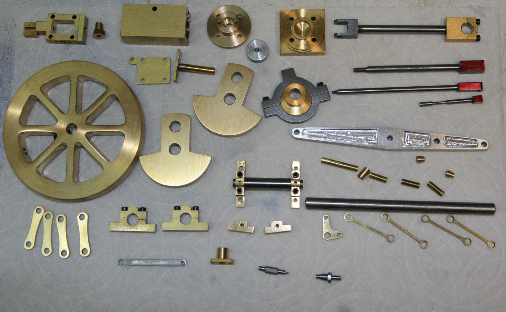

    The rest of the Beam Engine Parts
    Here are the rest of the parts all in a row! ( or is that several rows)
    The small ones are the challenging part of the build.

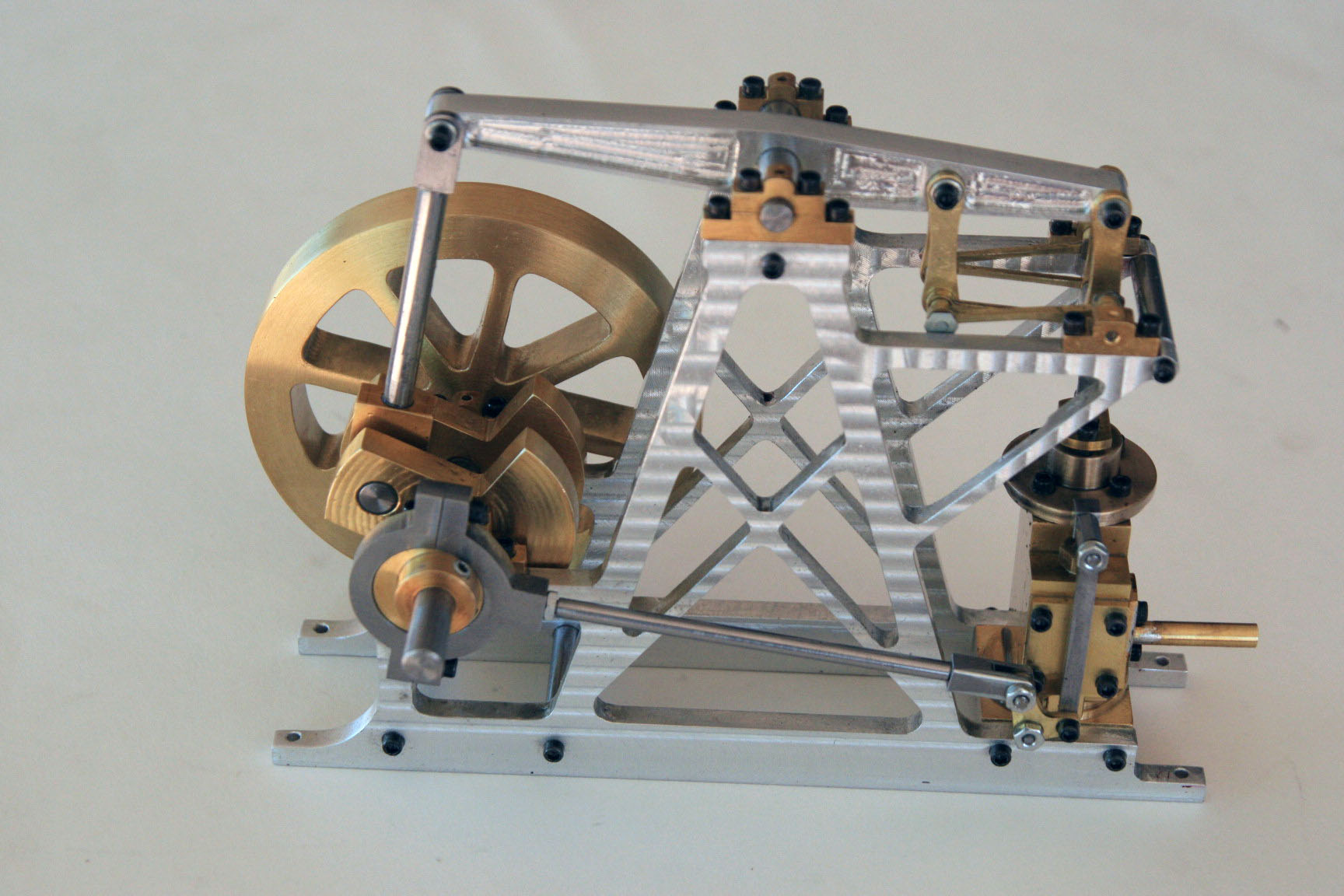

    Final Assembly Gerry's Beam Engine
    Tested and running fine. Still need to make a base and do a little video.
    Ok, jumped a head just a bit. Here is a short video of some of the break in process.
    Base to follow. Probably made from walnut but I am grouping the base with some
    other wood work I need to do.
    Cheers, JR
