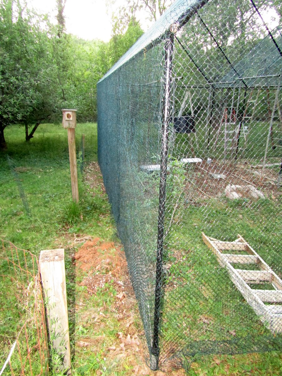

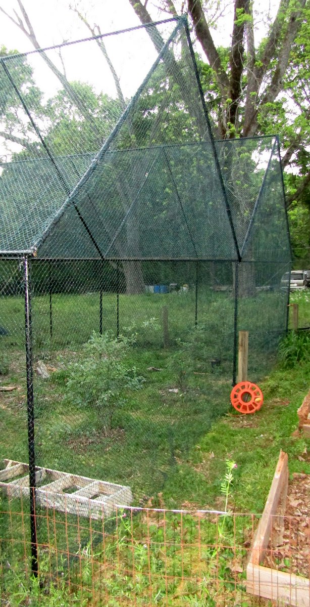

    Then, the gable ends were applied as single large panels and trimmed -
    notice there's no door yet -

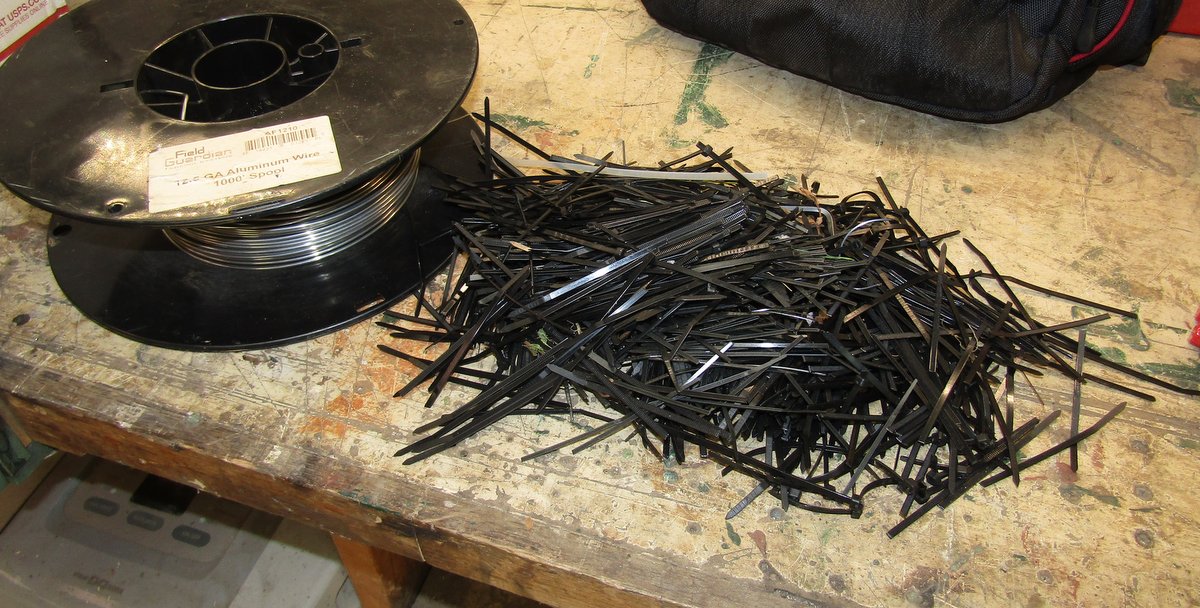

    Yes, it was hundreds of UV-resistant 8" tie-wraps and a bunch of aluminum wire - but it was all bulk stuff I had -
