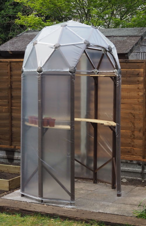

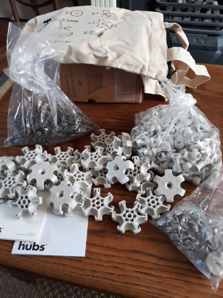

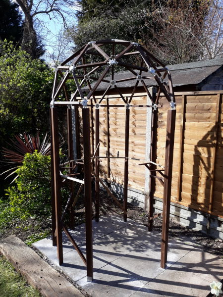

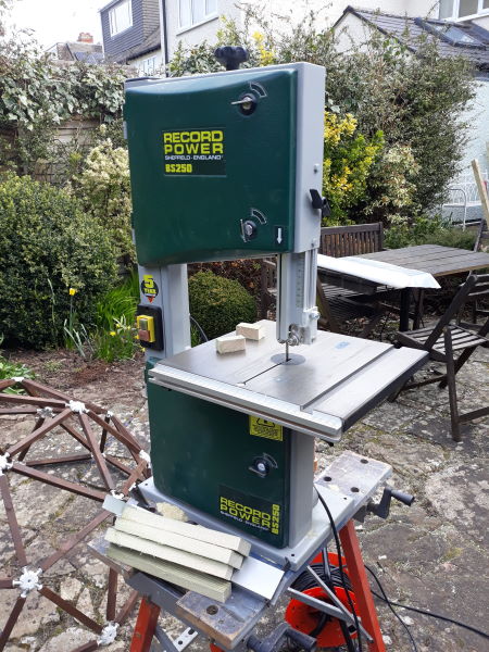

    Completely off topic for me, but spent the Easter week making a greenhouse using a Geodesic Hub kit as the starting point.
    Did get to use the bandsaw to cut up all of the parts out of gravel boards
    The assembled dome and frame
    The frame assembly
    Then I covered it, the dome itself was not so easy
    Must admit though that it is one of the best projects I made and has put a smile on my face

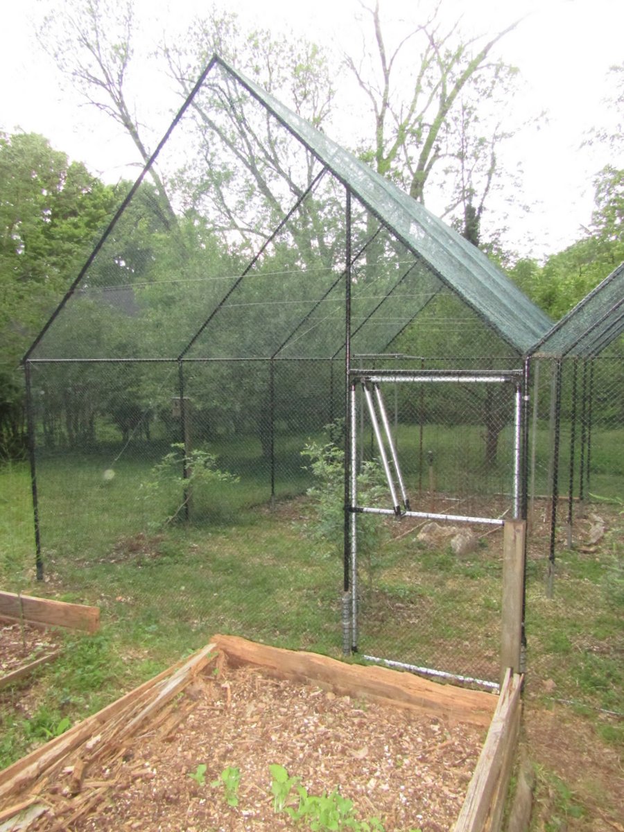

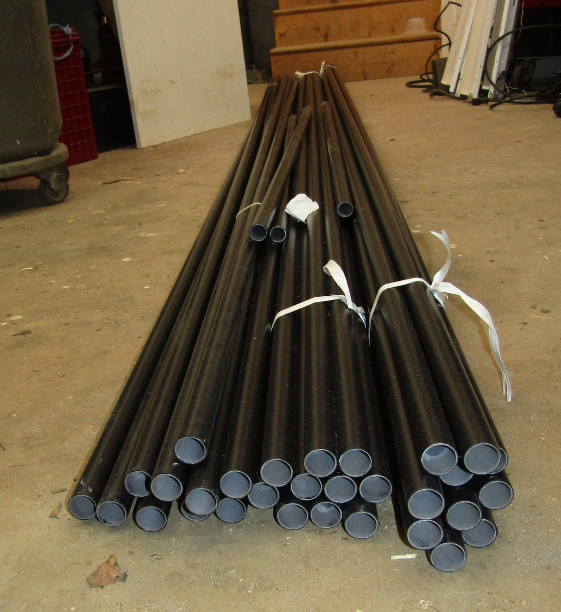

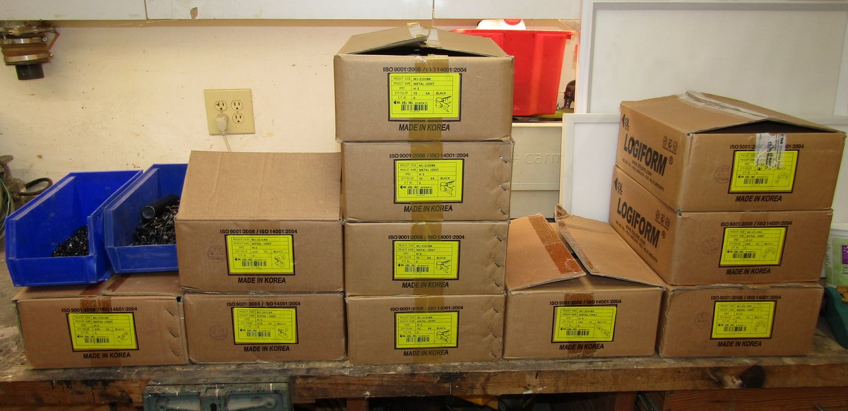

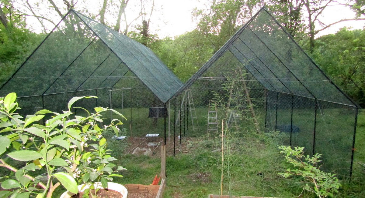

    The past couple weekends, I made this anti-bird cage from some discarded industrial assembly cell shelving and racking tube and connectors. I wanted to experiment with a geodesic, but she wanted a more conventional shape.
    The wife is very happy at me!

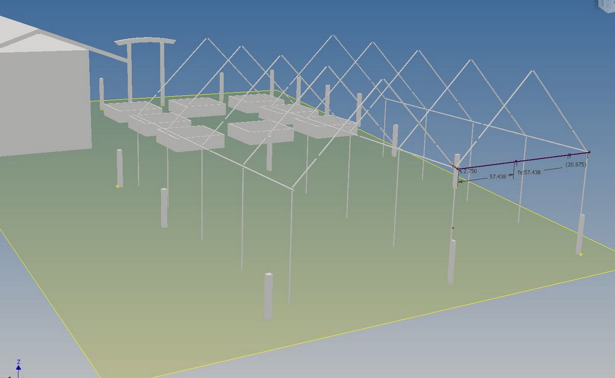

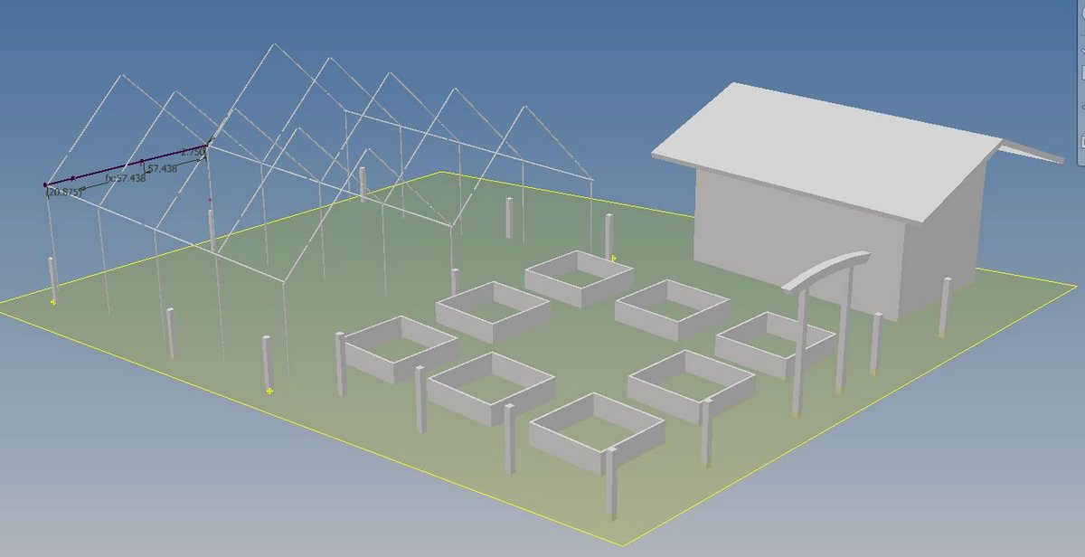

    Thanks all, my first "mention"!

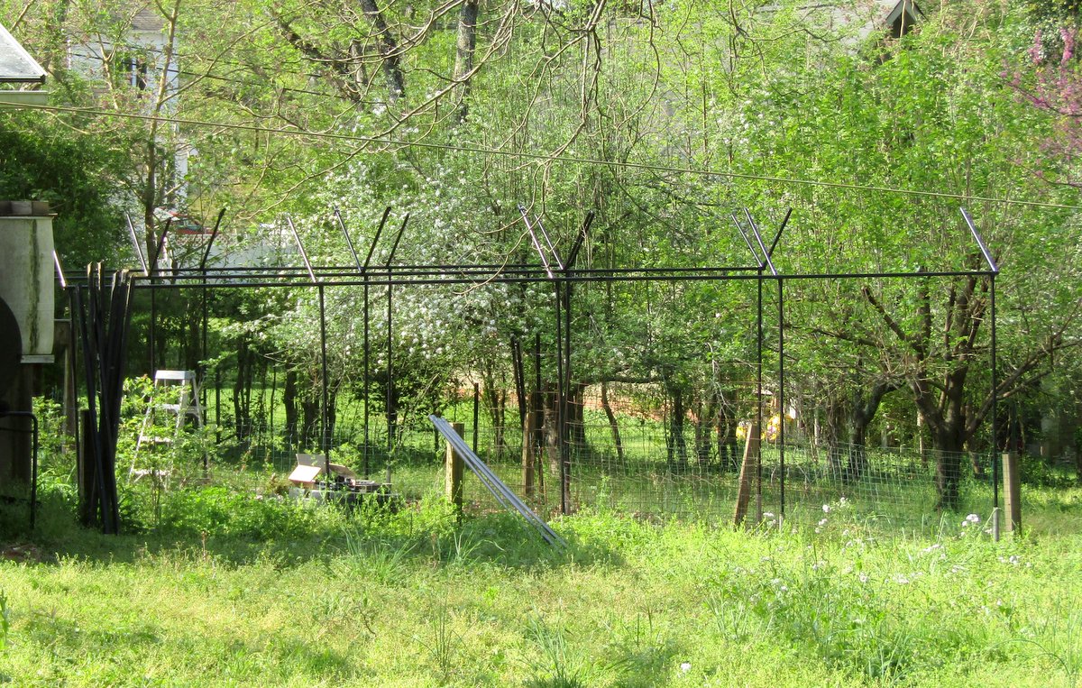

    I was pleased with my "Covid19" foundation method - I wanted to use what I had around.
    So - I designed it first in CAD to efficiently use the connectors and tubes I had salvaged.

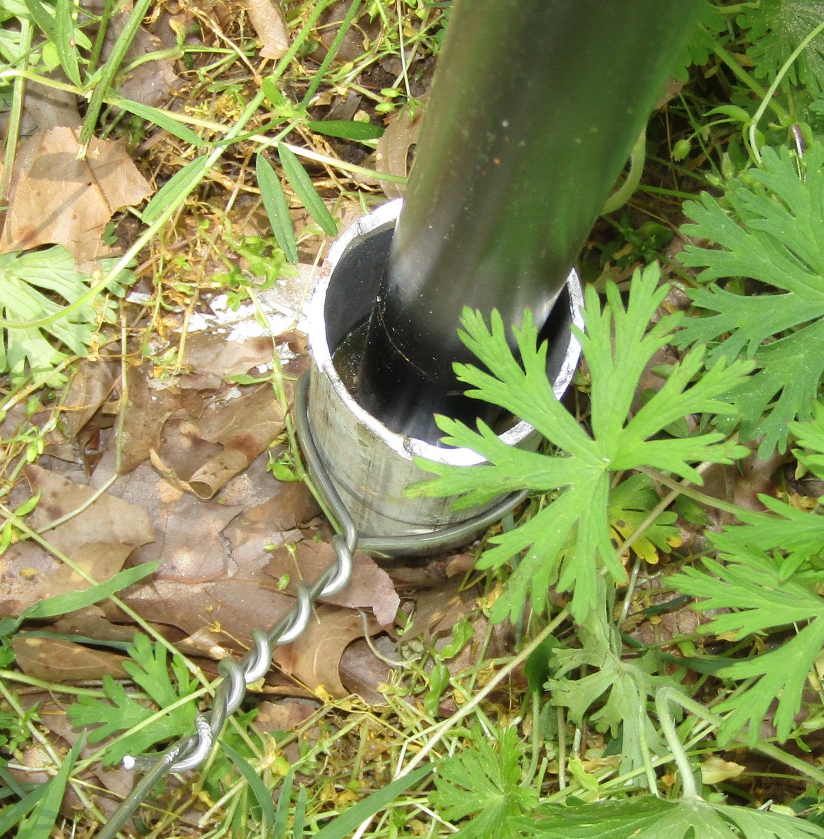

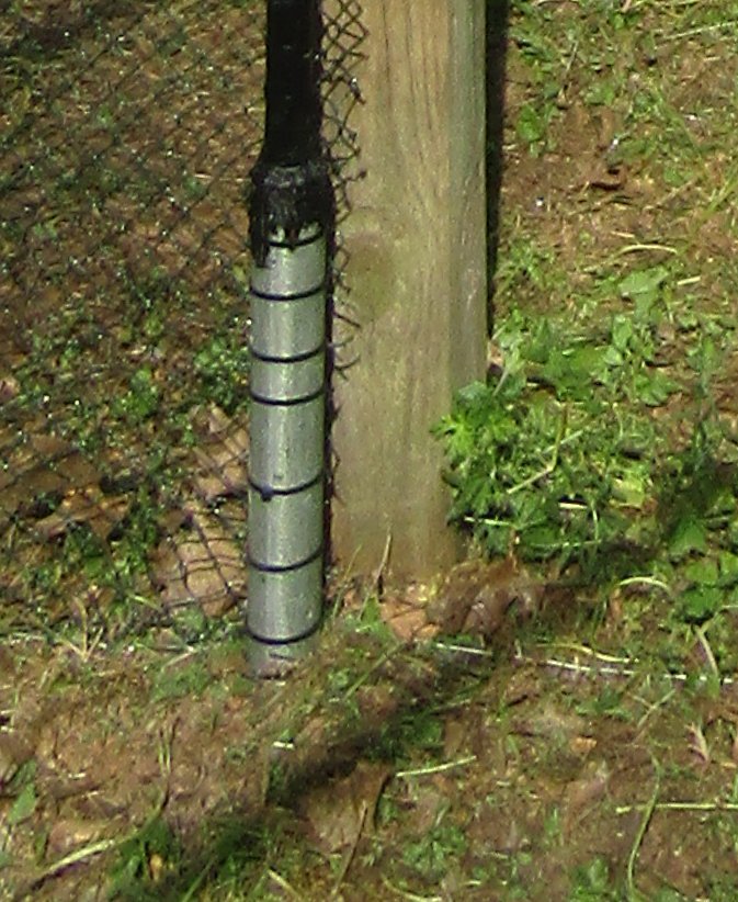

    Then, I laid out three 24'-long rows, 12' apart, and then put a pin every six feet along the rows - so fifteen pins, pretty correct in X and Y, but varying up and down with the ~2' slope of the yard. Next, I drove 3' sections of galvanized inch-and-a-half pipe at those pin positions, just to where they were getting hard to move - kept them vertical with a bubble level made for fence-posts.
    Then, I packed in some random amount of dry sand, hard with a heavy iron rod that just fit. Finally, I mixed up and poured about a half inch of polyester resin (like for Fiberglas work) onto the sand in each one - when it dried I drilled a weep hole right at the cured surface.
    Now - I had fifteen "hard point sleeves" with seats of varying heights. I surveyed them with a dumpy, or contractor's level on a tripod. This allowed me to cut all the legs to the individual heights to make their tops all within less than a sixteenth of a perfect level plane.
    Once the legs were set in and the structure was built and triangulated and plumb, I packed in more sand and then mushed in a cone of black roofing repair cement -

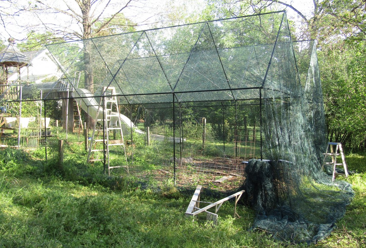

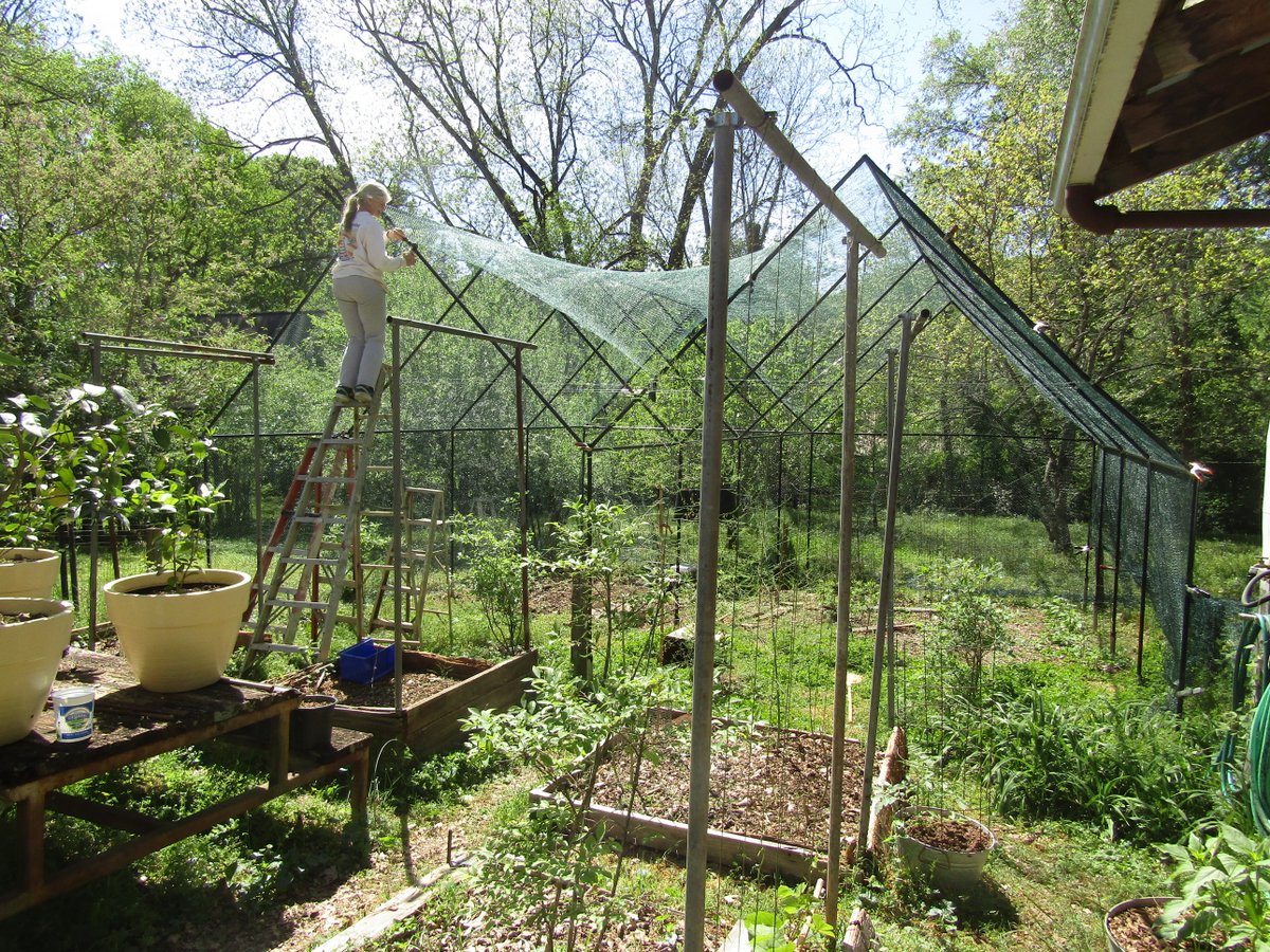

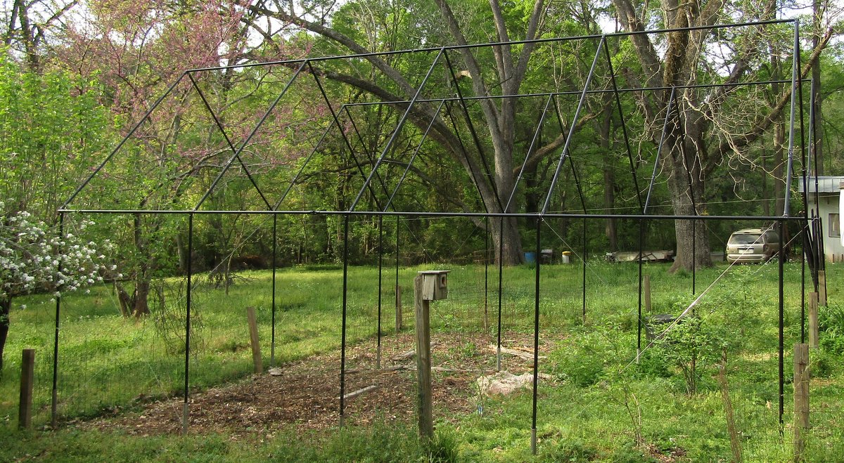

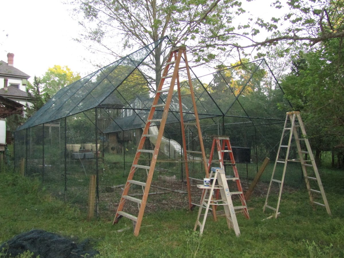

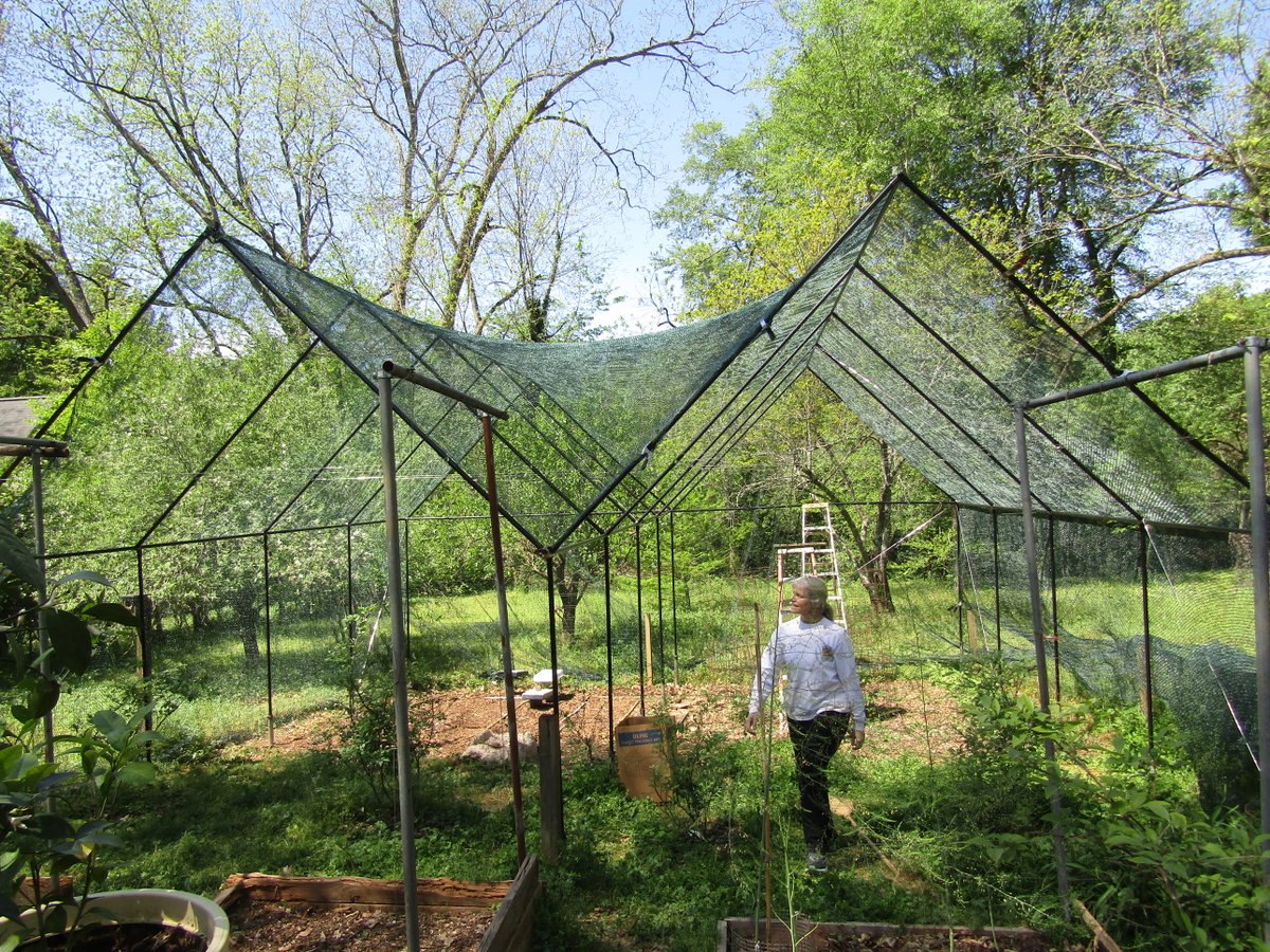

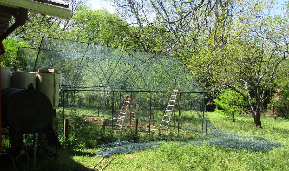

    Assembling it was a pretty simple matter. I had to piece-together the rafters, so I took advantage of that to install the stubs, and then built the entire ridge and rafter assemblies on the ground. Since I'm home with the wife and kids 16, 19, and 21, it was a simple matter for us to walk up five ladders and set them in place on the rafter stubs.
    You can see how dead in plane all the horizontal beams are -

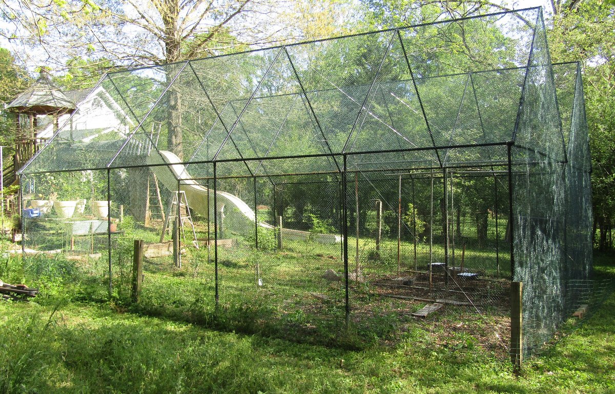

    Then since everything so far was "free", we splurged on some really great anti-bird net - a 50 X 66' piece. Horsing it up and over was pretty straightforward -
    We started at the left front corner, then went up the side wall, over the first gable, over the next one, then down the other side wall - my wife was a bear for precise spacing!

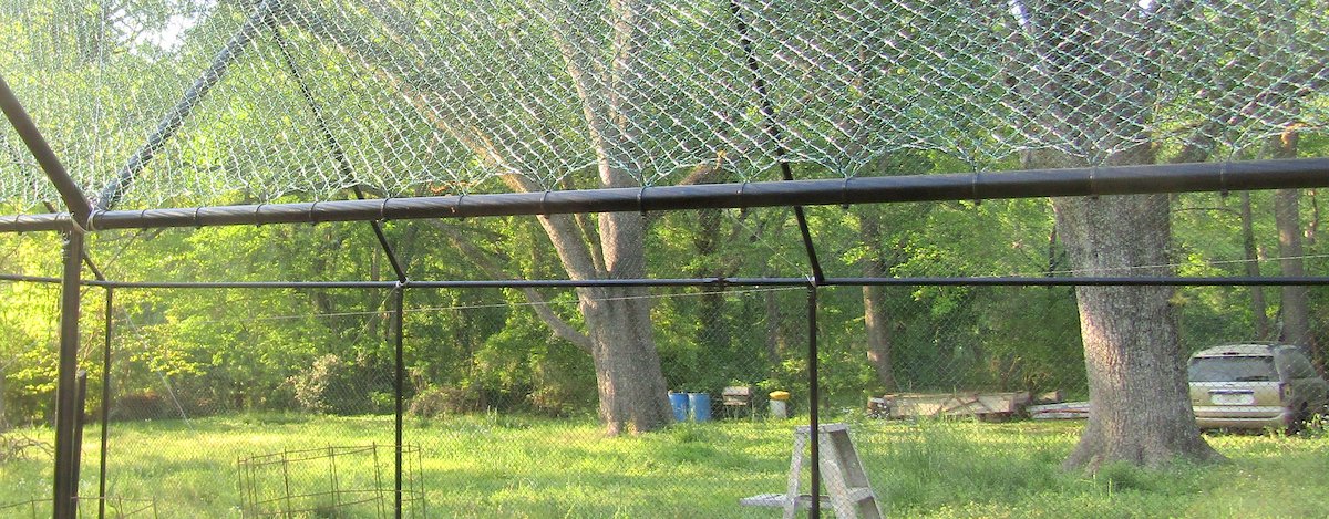

    Here's the far corner from our start, with all the spare material - we trimmed it off flush with the gable side all around -
    Forrest

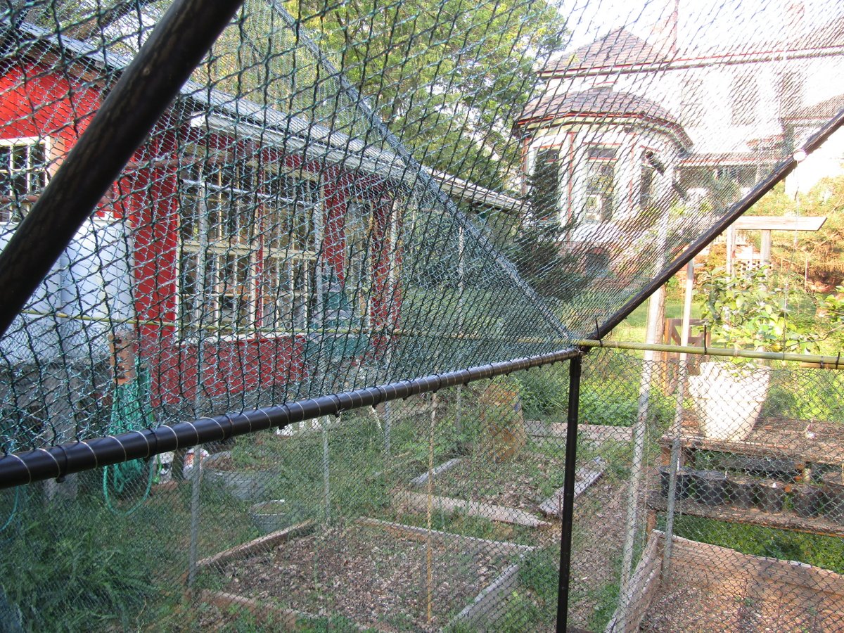

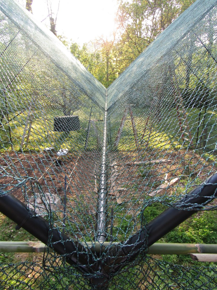

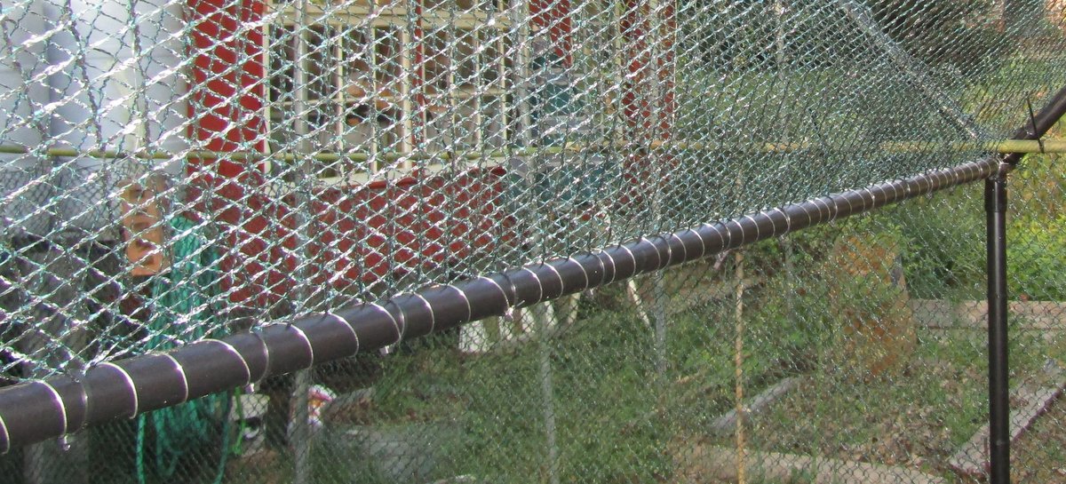

    I didn't like the way the valley was "pulling" with a tie every third or fourth crossing, so I wrapped it all in monofilament -
    I also put in "rafter ties" of heavy aluminum wire at the rafter joint level, and lots of X-bracing in various panels -
