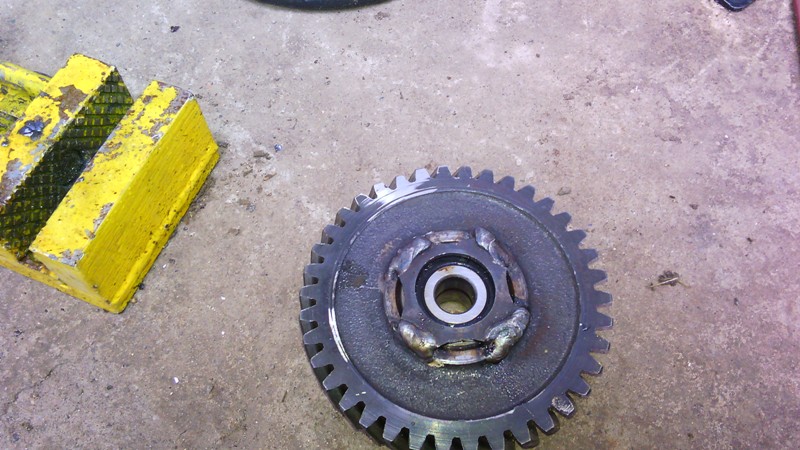

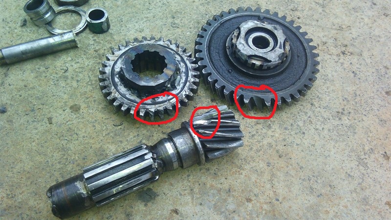

    Hi. Sometimes it's a very unpleasant situation when it's impossible to quickly find a new gear. I decided to restore the gear, maybe this is not the best way, but for some time it should work.

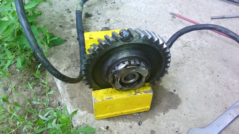

    I weld a damaged tooth with an electric arc welding

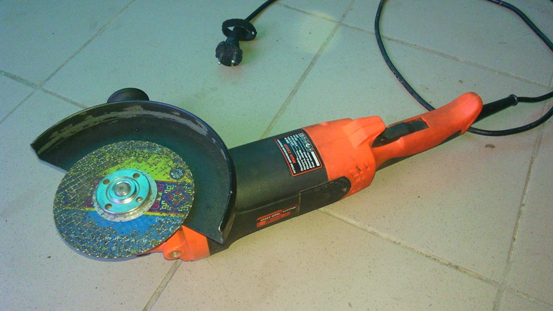

    Then after 10-15 minutes of working with this tool)))

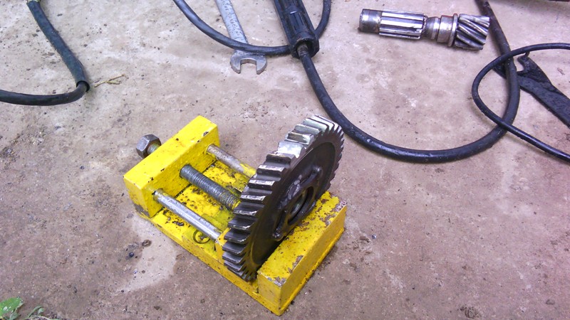

    Result. The gear is almost new

    I would be interested in why such robust gears got damaged, I seem to remember they were from a motorcycle gearbox.
    Olderdan
    Gears from a motorcycle and a car. The reason for the breakage is very simple, There was a nut in the gearbox, it hit the tooth and locked the gears.
