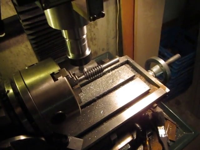

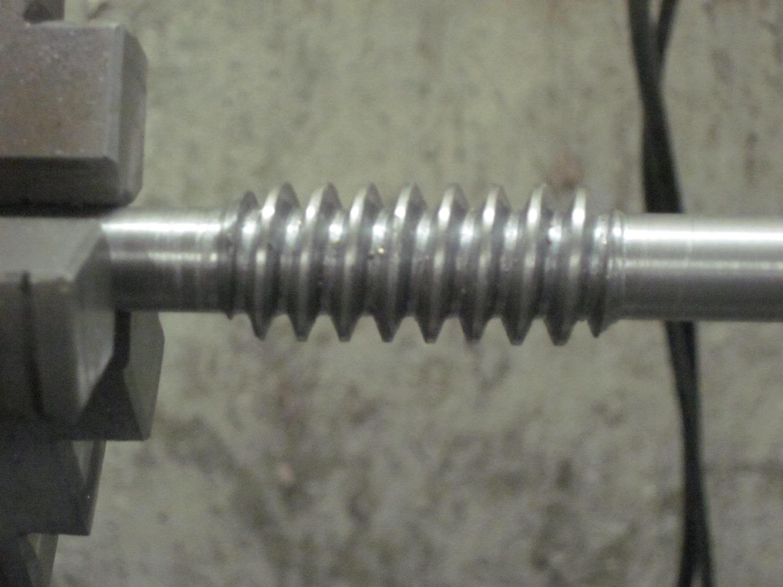

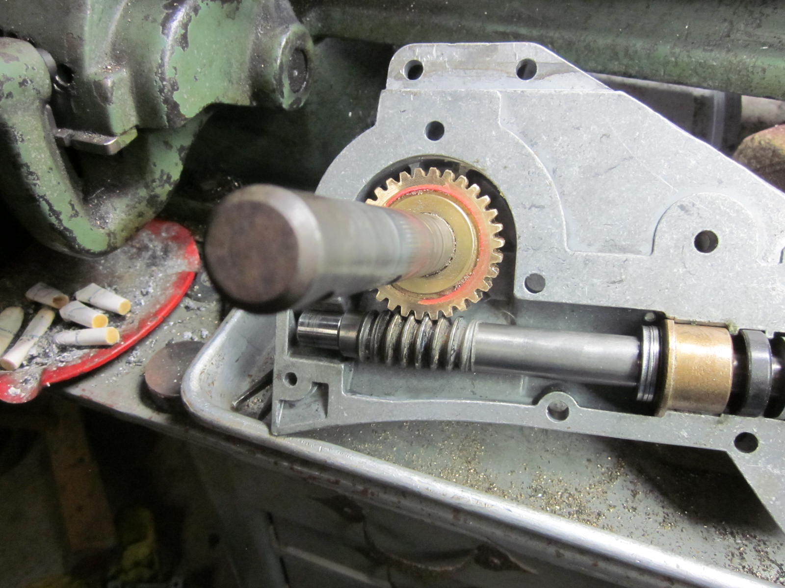

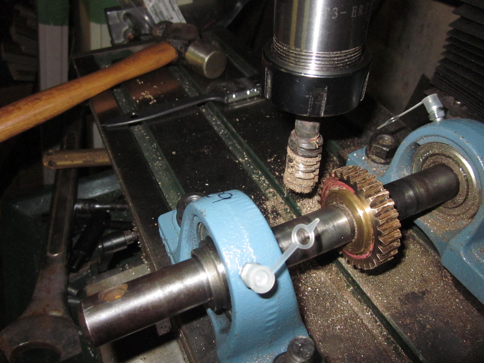

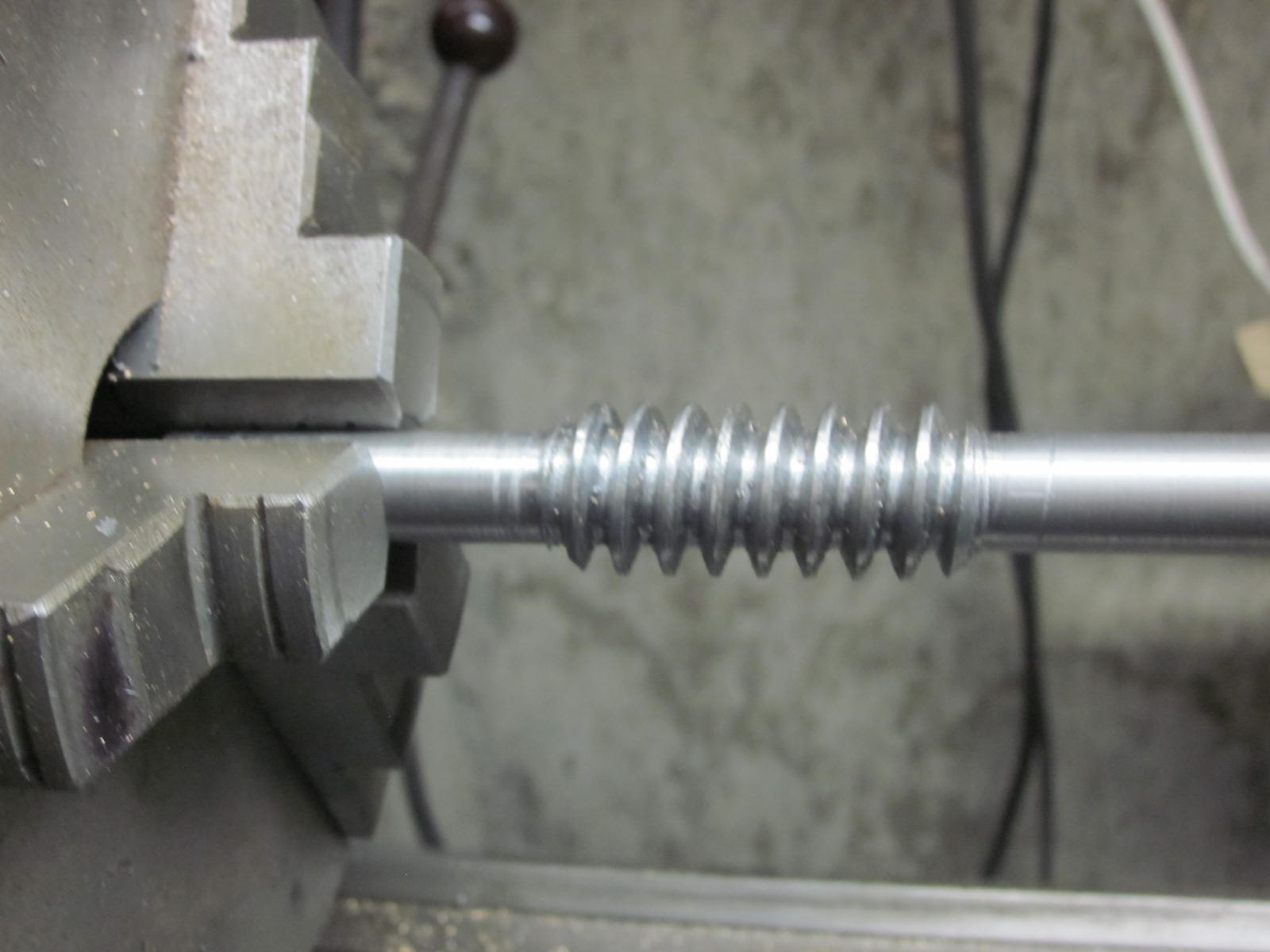

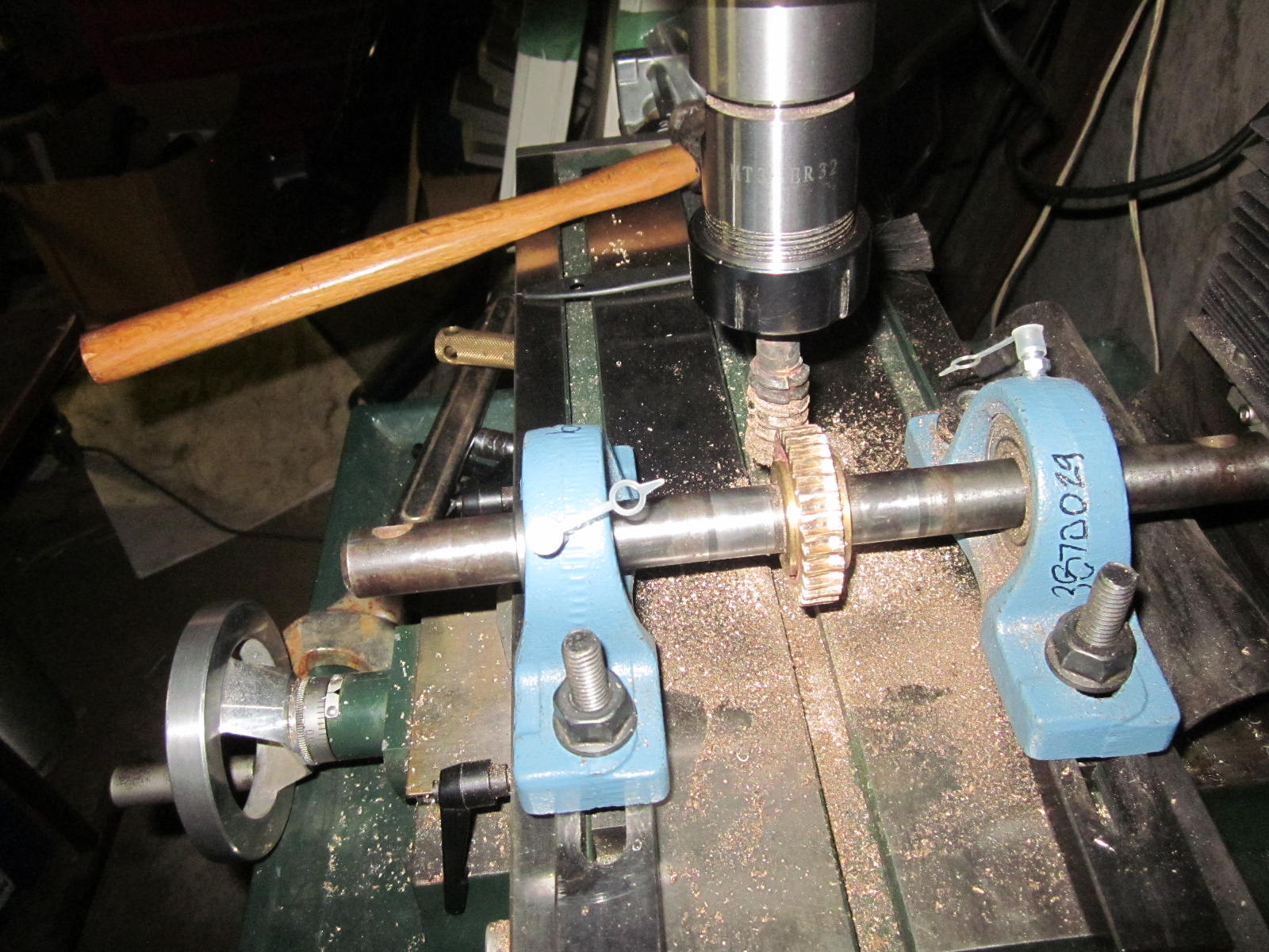

    The worm gear in my small rototiller wore out and they do not sell a replacement just the complete gearbox so I made a new gear for it using a hob. I made the hob which is from drill rod. I have include some pictures . I have a video but do not have it on line so it will have to wait. The gear works OK. I should have taken more pictures of the process ( next time ).

    Hi Blackangus,
    The helix angle looks pretty extreme is that a double start on that hob? Also how many flutes did you make on the cutter?
    One more, Any pics of the completed hob?

    judging from the gear Pics, it looks like a single start...

    How did you index the gear? All I see are the pillow block bearings holding the mandrel. Some of the teeth seem to have a concave cut in the center others look good.
    Ralph (brand new to machining so really curious)

    Ralph, here are a few unique points about worm gear drives
    # 1 there really is not a hob per-say used to make the worm wheel Some call it a hob but actually the cutter that makes the worm wheel is an exact profile of the worm screw itself.
    #2 if you are making your own worm drive from scratch you can design your worm screw and wheel pretty much as you like with a few limitations.
    #3 you can achieve an extremely high reduction with only 1 worm and wheel.
    #4 you can also get a reasonably low ratio as well by creating a 2, 3, 4 or more tooth starts or threads on the worm screw
    #5 just like a helical cut gear set you can design a worm gear set to be several degrees off from 90°
    #6 you can have multiple worm wheels being run from a single worm screw with shafts leading off at odd angles to each other
    #7 the worm screw can have a large diameter while the wheel is quite narrow or you can have the wheel wider than the screw
    If re manufacturing an existing wheel then you would first duplicate the screw then cut groves in it to resemble a tap then add in a bit of relief grind chuck you newly made cutter into either a lathe or a mill place your blank on a spindle and cut your gear That is over simplifying it a bit but the grist of the process is there
    I left out the part of needing to do the math to determine the number of teeth and in many cases it helps to pre-cut a radius profile then gnash the starter profile of the teeth with a hob and while indexing the wheel effectively making what would look like the beginnings of a spur gear with a concave face
