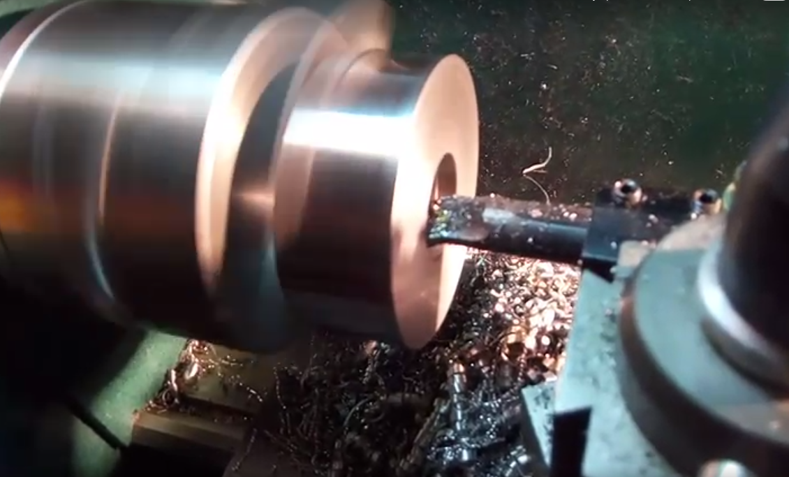

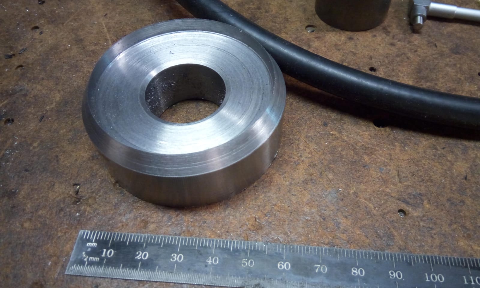

    Boring center hole for small punch.

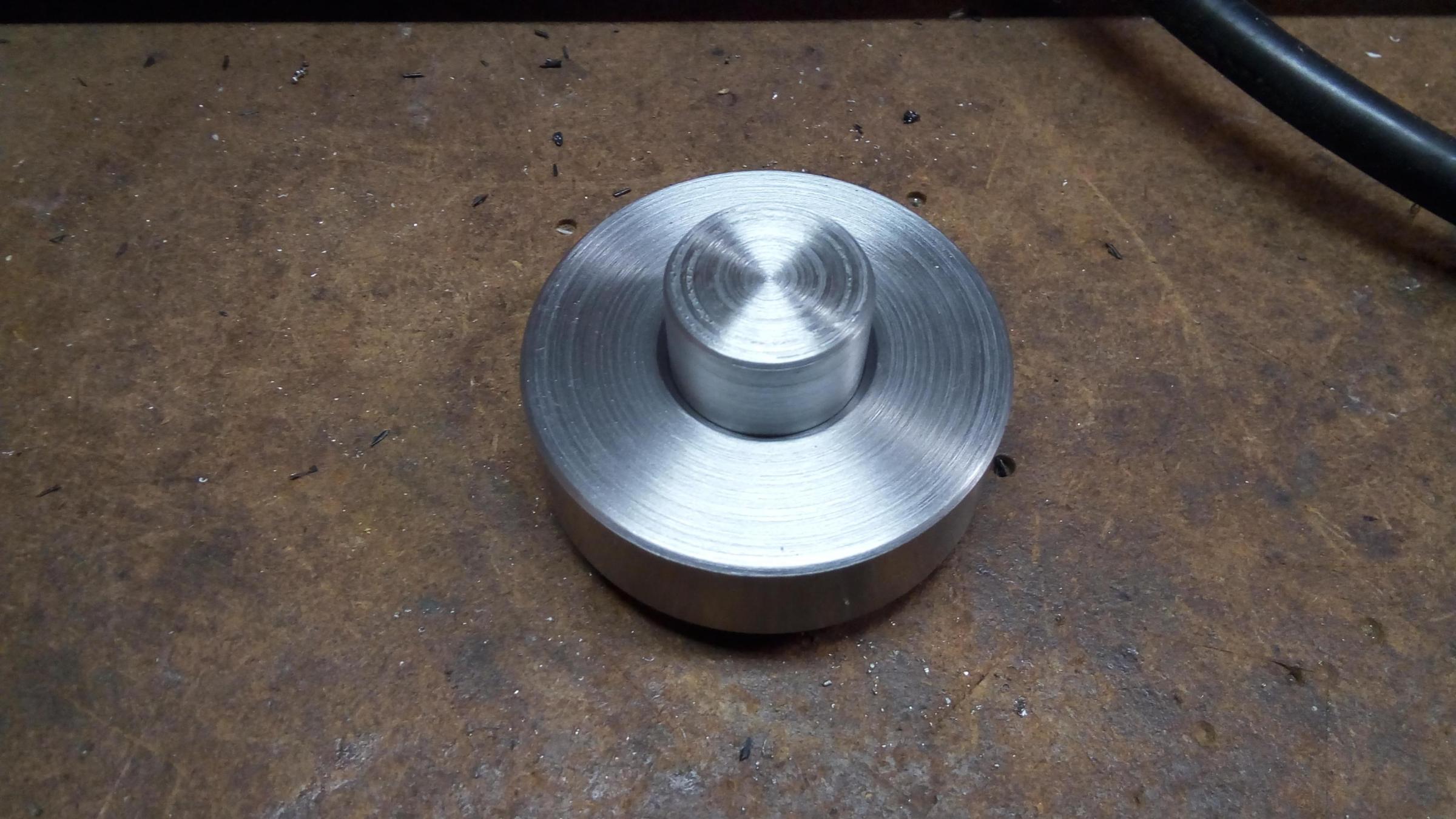

    Finished outer punch.

    I figured I'd post the video of the boring process, not very exciting but someone might be having a slow day.

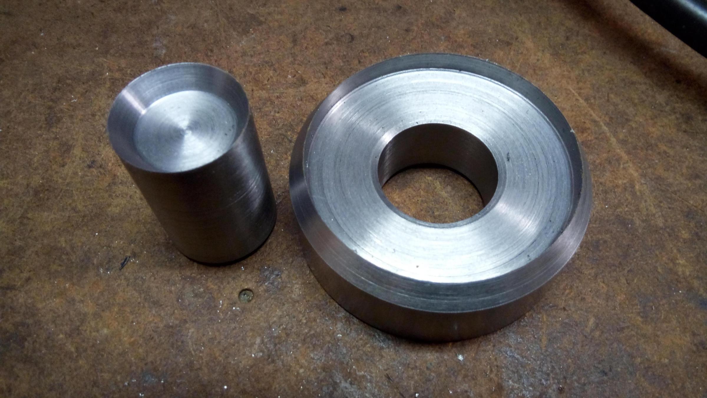

    As promised, the rest of the story...

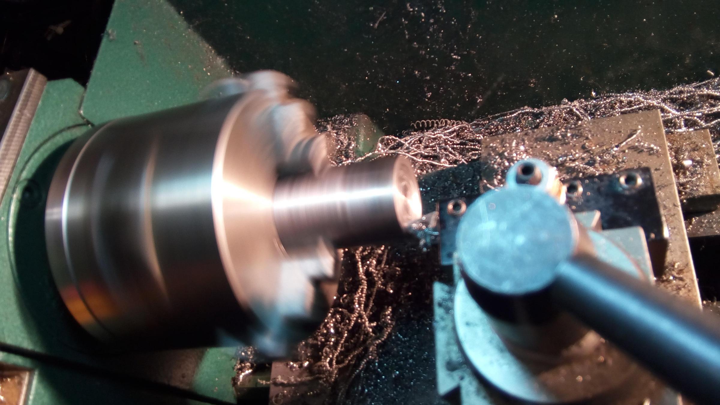

    The scrap steel I had for the center hole was too large, so turn it down to about 0.002" less than the hole in the main punch.

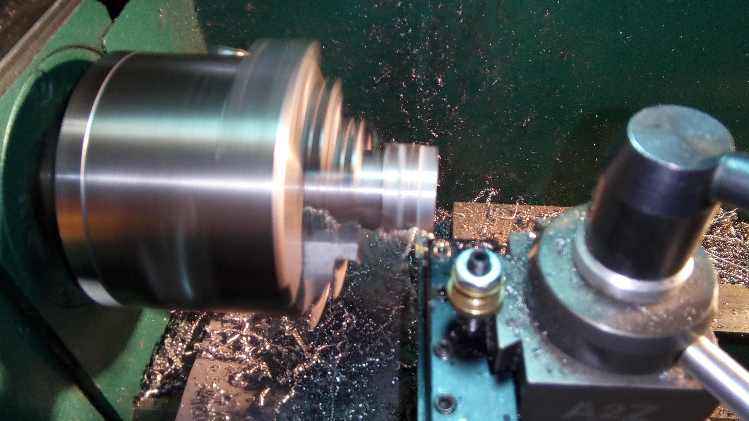

    Next, face and cut the cavity and cutting edge.
    Face back, chamfer edges, done.

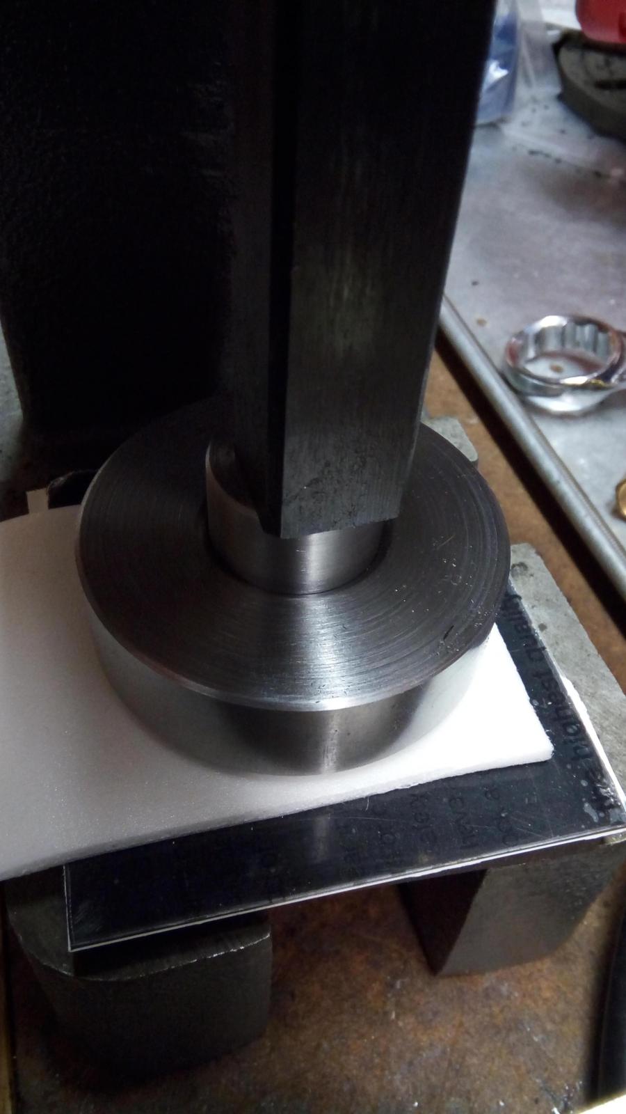

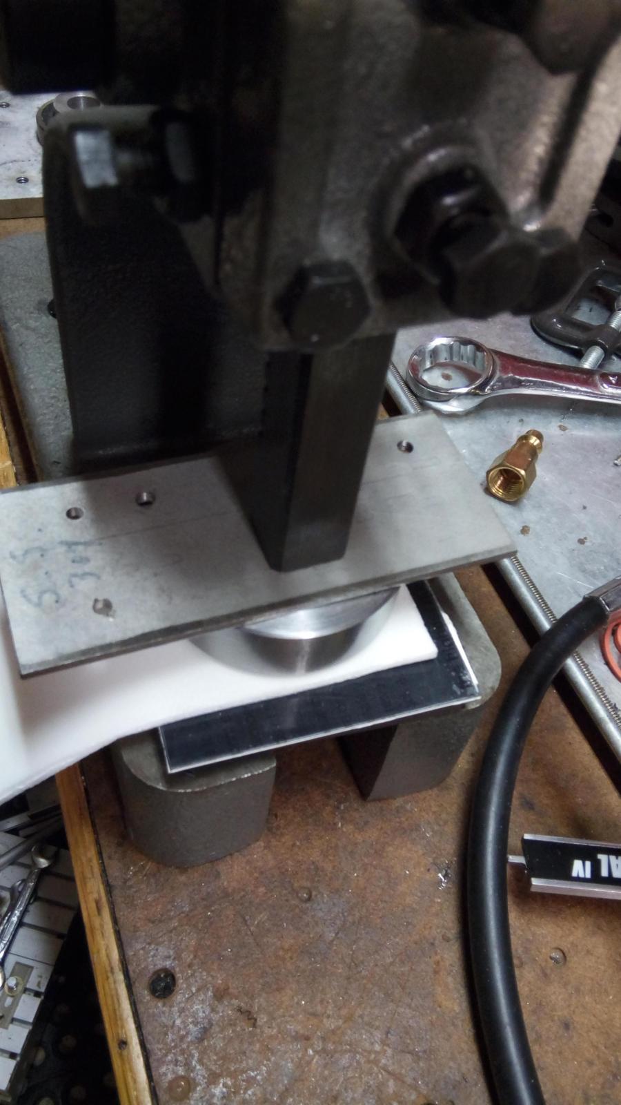

    Time to test, cut outer diameter
    Without moving the big cutter, cut the inner hole

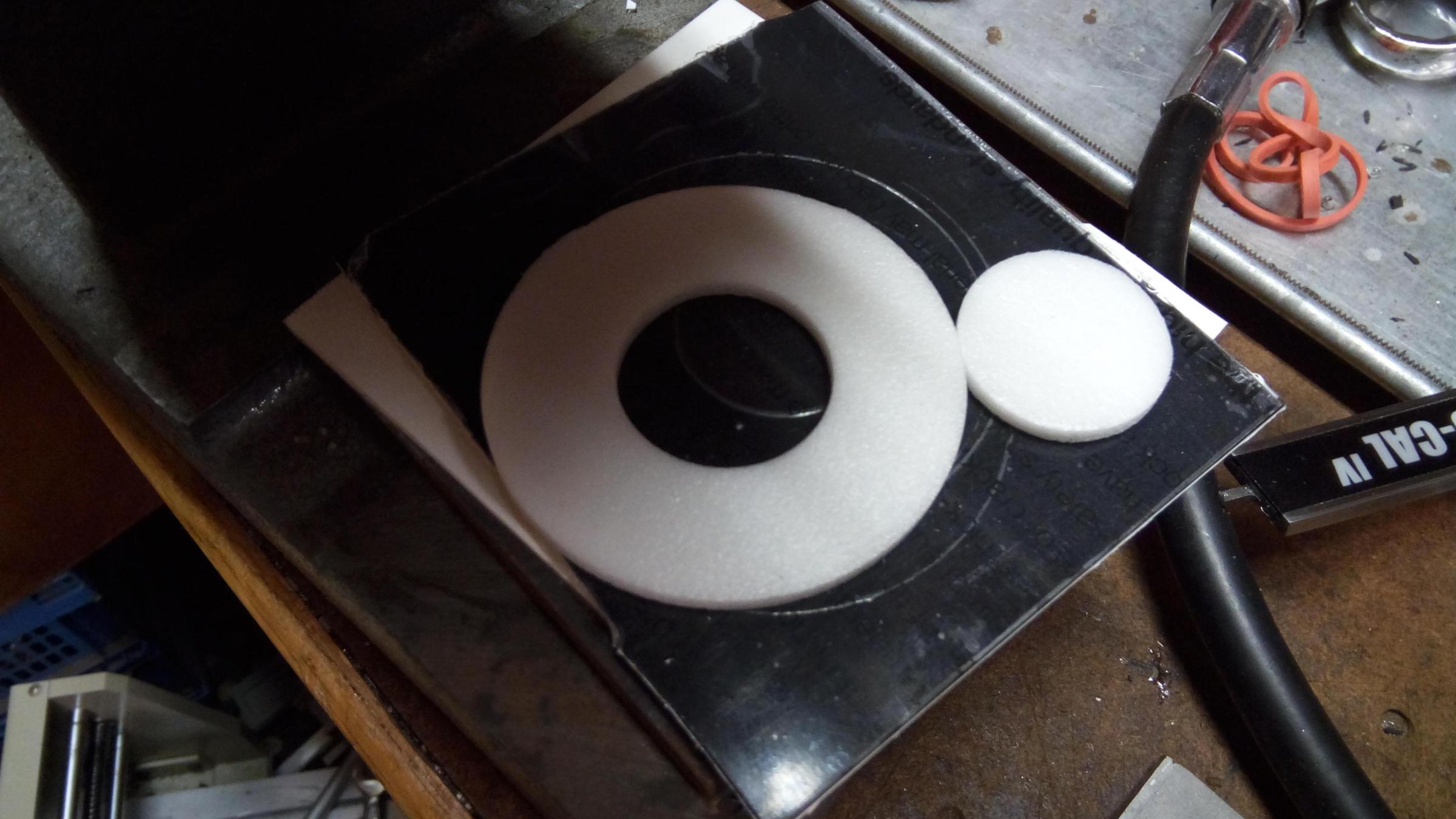

    Success!
    That's the actual first test part. There's two cut marks on the backing plastic because I didn't push hard enough to cut all the way through the first time. Large diameter needs a lot of push.
