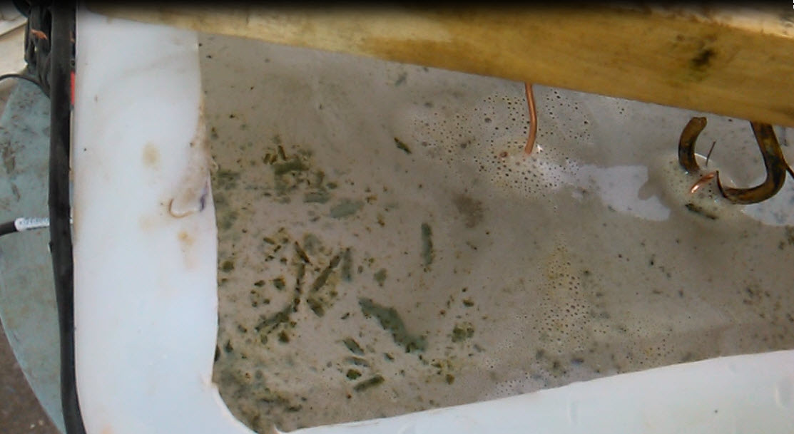

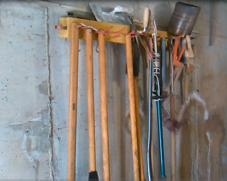

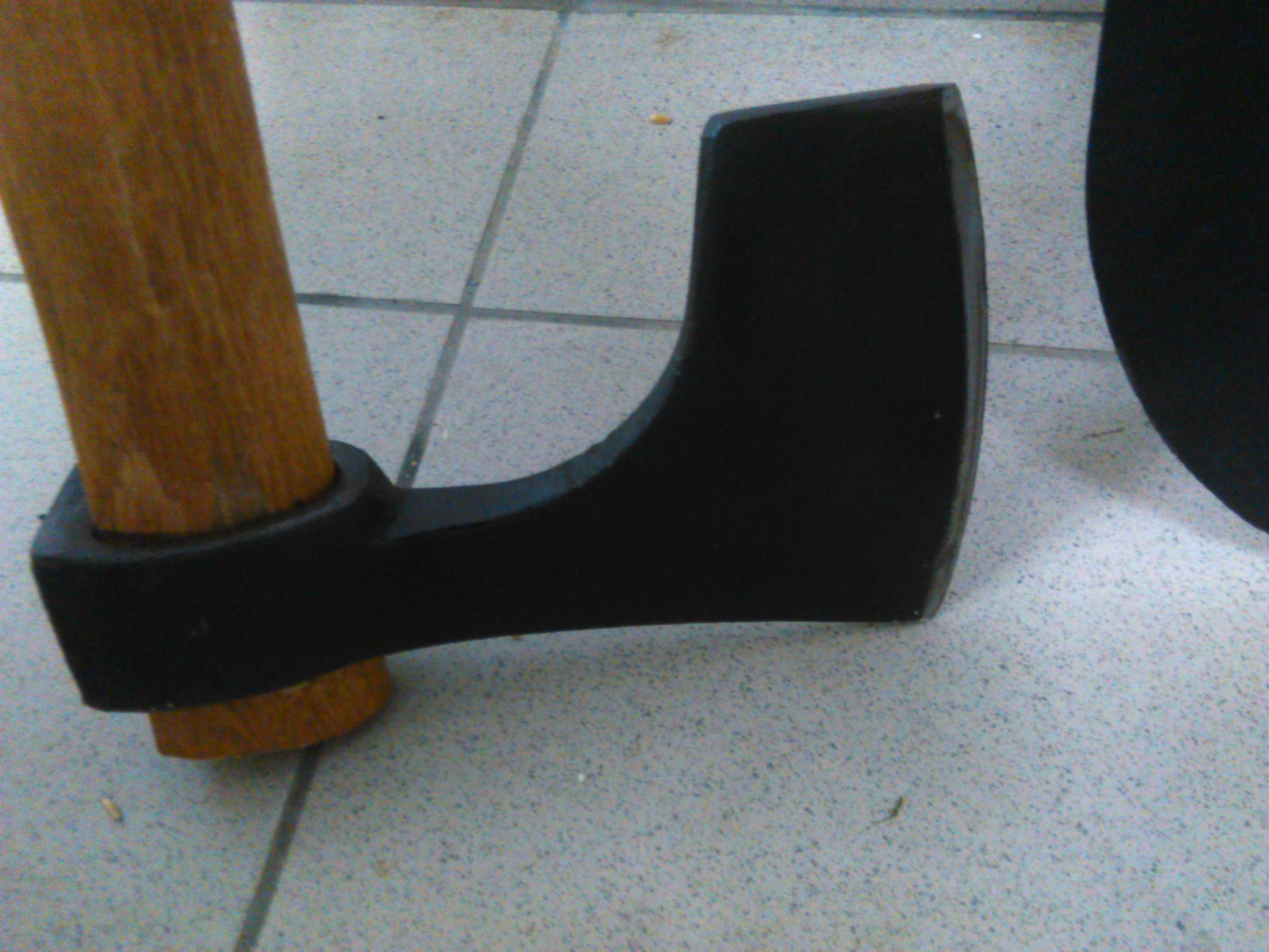

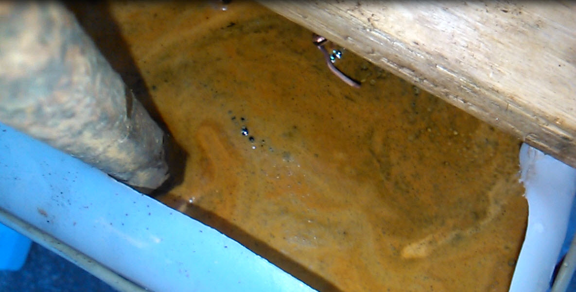

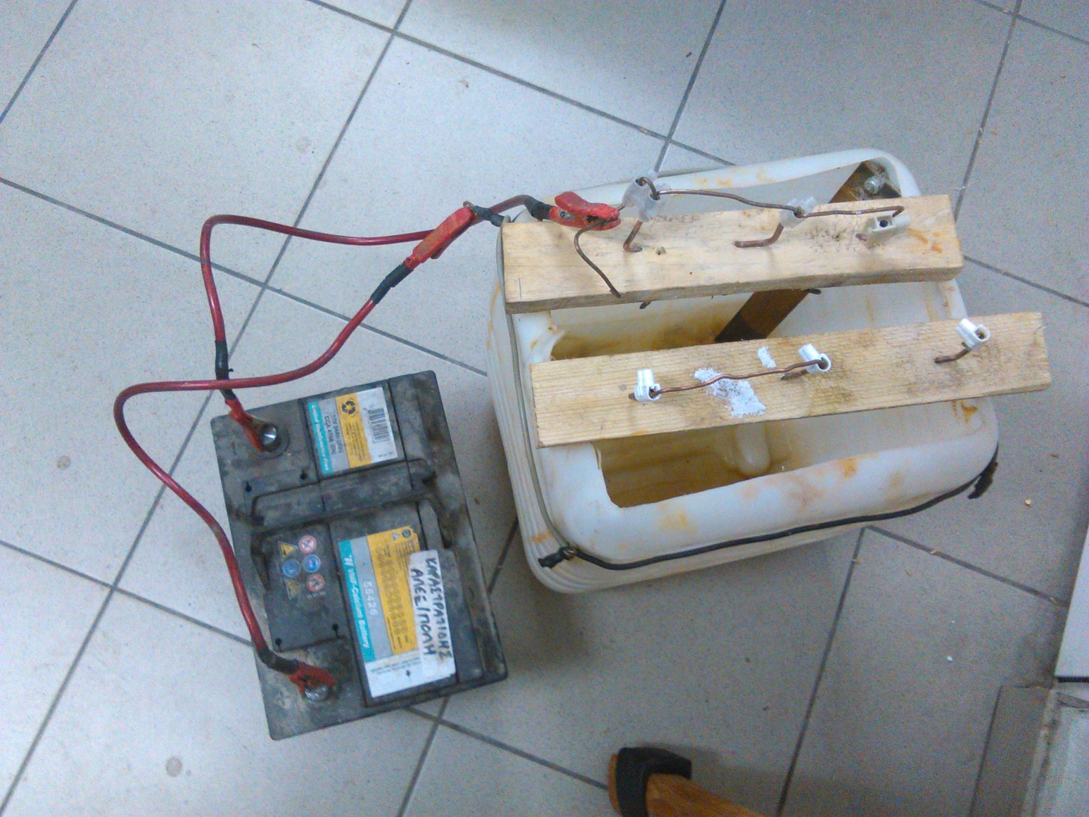

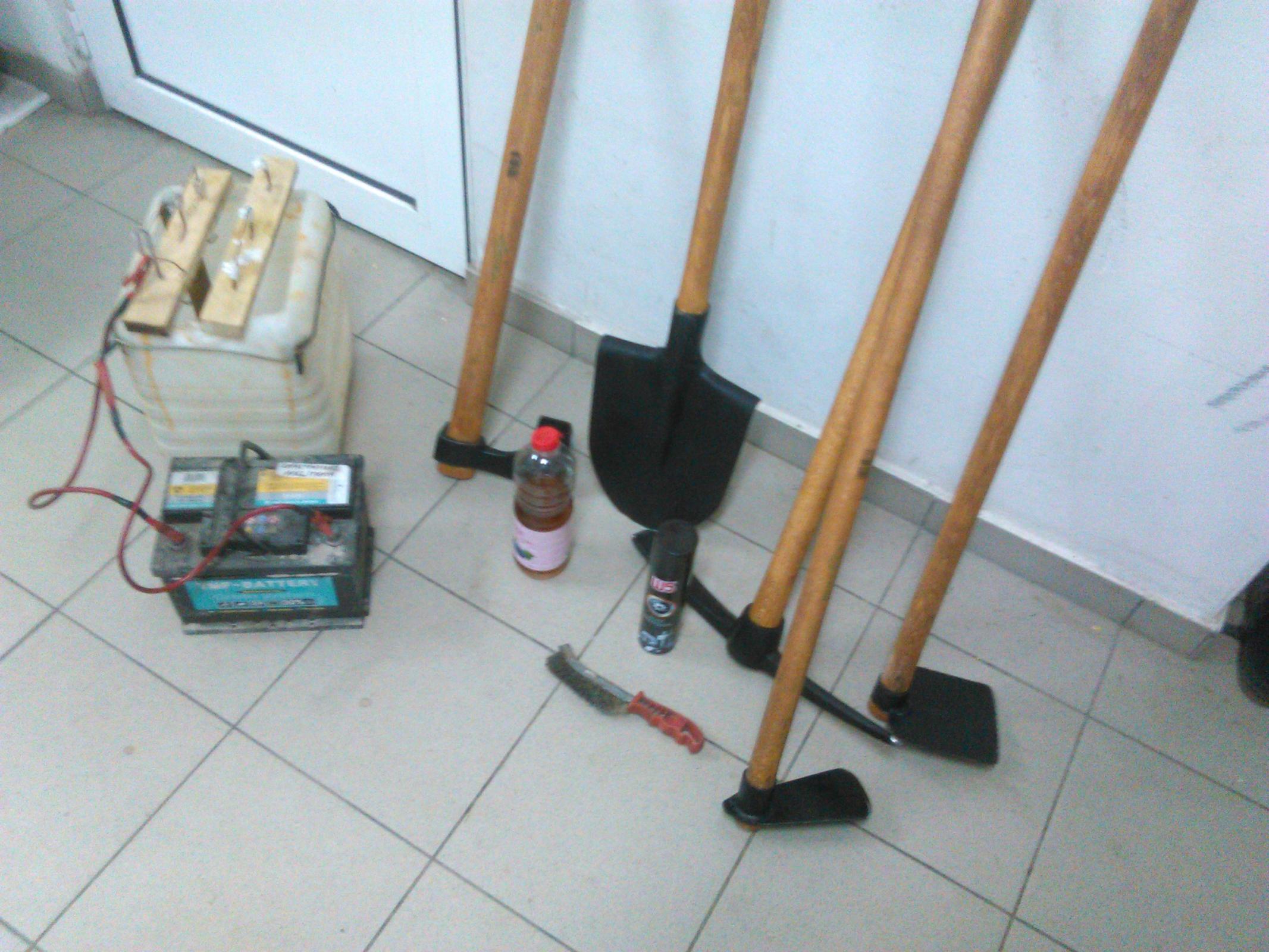

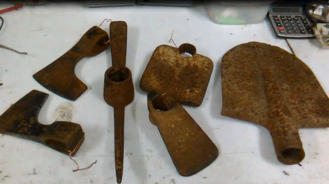

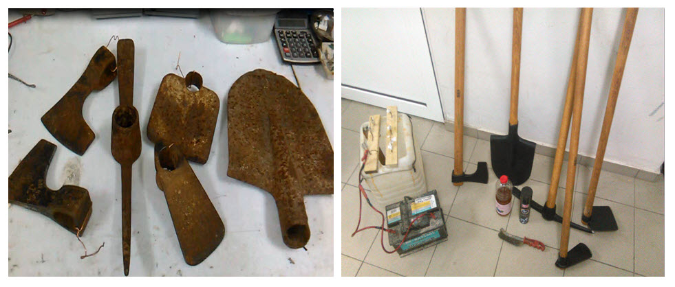

    In this video we can learn how to maintain our old garden tools. I use the electrolysis method first. You can see more details about this method on my channel.

    The guy is using Electrolysis for rust removal. Image 4 of the stills shows a container and a battery. Other folks use a battery charger instead of the battery. Search for
    Electrolysis Rust Removal
    and you will find many DIY articles with lots of pictures. Just make sure you do it in a well vented area.
