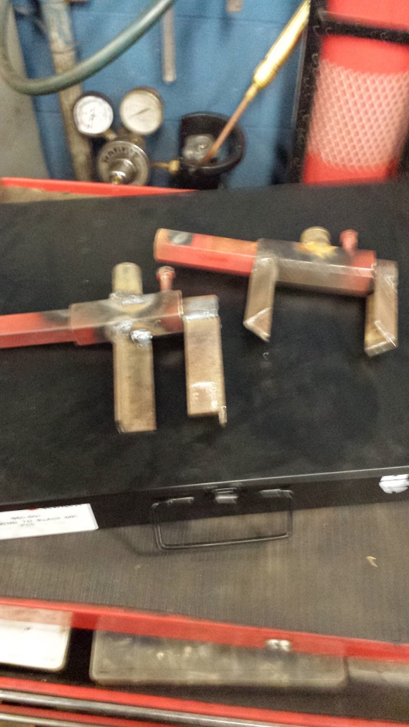

    I made two variations of this tool to fit different lock rings on fuel pump senders.
    They are pieces of angle iron welded to square tubing with one arm that slides to adjust various widths.
    The legs can be modified to fit the appropriate lock ring configuration.
