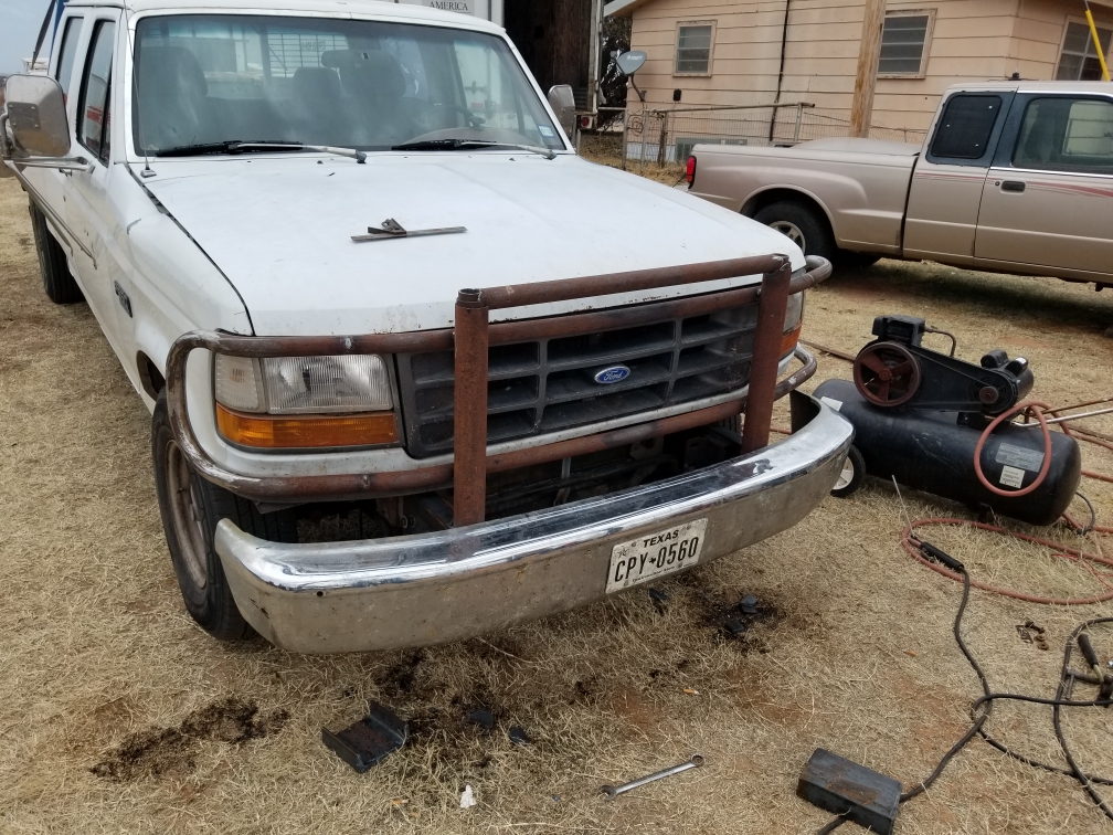

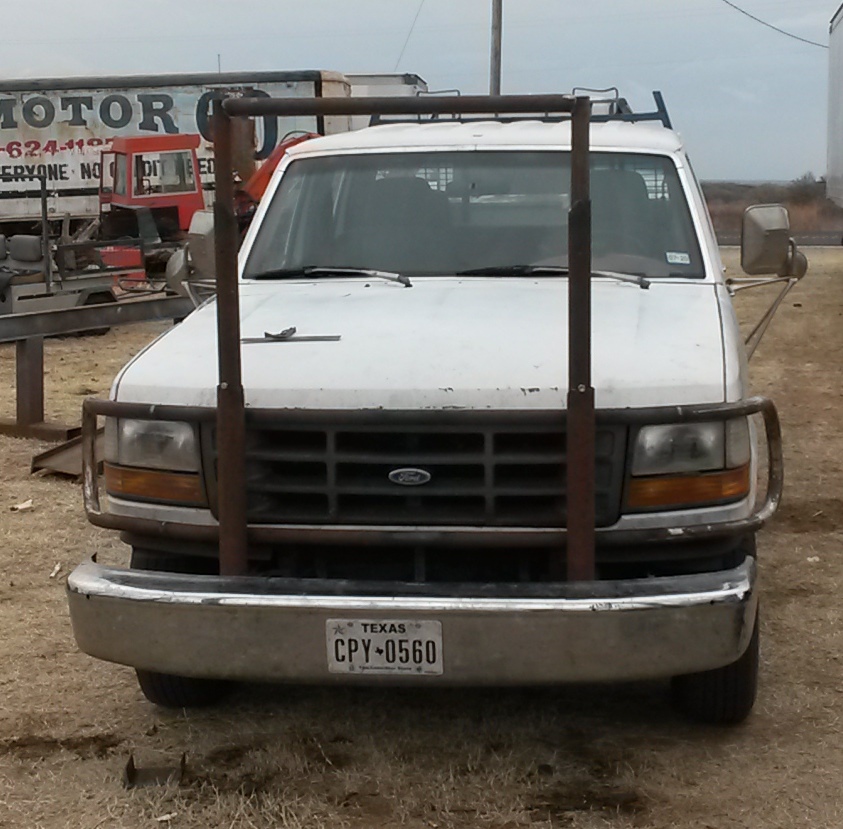

    I wasn't going to publish this until I had time to finish it but today the opportunity came up to make a trip to the steel supply making the grill gard/ haul rack an official tool in use I'll go ahead and publish.
    the grill guard is made of 1 1/4" sch 40 pipe with 2 1/2" vertical supports.
    later it will have some bars and more smaller pipes added to finish the guard portion
    the haul rack telescopes to above the top of the cab it is made out of 2" pipe and 1 1/2" pipe

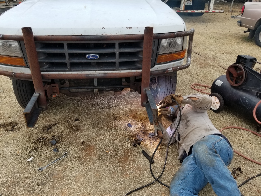

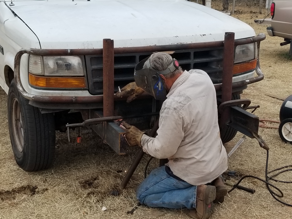

    the temporarily the front bumper was welded in place

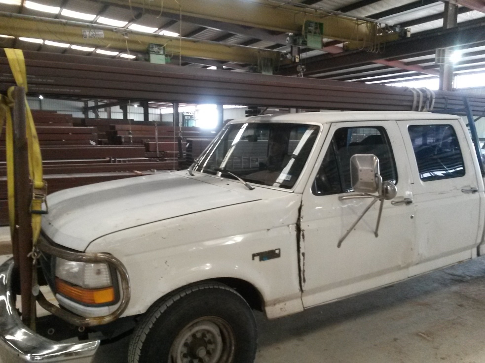

    a load of purlin to begin the roof of my shop

    This frame extension modification all makes sense now, with your posts on the truck repairs and 'cattle guard' addition. All leading up to making a heavy haul of material.
    I've hauled long boards in my light duty 1/2 ton, via a home built ladder rack using the existing side board holes in the truck box. This front support would have been handy when hauling 16' material.
    How is the perlin install going? I'm guessing you've made a crane to 'fly' them in place.

    If your 6x2C channel is .2 inch material, that's pretty heavy for 30ft, 8.2lbs/ft ~246lbs (lightest beam in 6 inch C shape; C6x8.2). But you indicated you hauled less then 1000lbs, and 10 of these are 2.5ton, so I'm missing something. Add in the side wall beams, 4) C4X5.4 @30ft (or were these C4X7.25?).
    Elevator should be interesting to see what you come up with.
  7. #6
    11,729
    2,237
    Thanked 9,229 Times in 4,406 Posts
    This is C purlin not C channel the 6x2 Purlins weight 2.63 lbf 789 lbs for 10 pieces
    the 4 x1 1/2 purlin weight is 1.91 lbf 286.5lb for 5 pieces
    the 6 " connector sleeve is roughly same weight per ft so 65.75 lbs for 1 25 ft stick
    same goes for the 4 " connector sleeve so 38.2 lbs for 1 20 ft stick
    total weight around 1179.45
    it takes over 6000 lbs in the bed of the old truck before the springs reach the overload helpers.
    But with the load situated so far forward due to the length and my front end can only take a max of 5600 lbs total and empty there is 3,200 on the steer so given that 2/3rds the load was being carried on the front axle around 786 lbs of the load was on the steer bringing the axle load up to just shy of 4000.
    I would have preferred they had loaded me about 3 feet further to the rear even if I would have needed to flag it due to having a 6 ft overhang to the rear instead of the less than 3 ft that I had but it was what it was the next time it will be loaded further to the rear as I plan on reducing the 3 remaining trips into 2 or I may just go for 30 more of the 6" purlin and 1 more 6" connector sleeve which will complete the roof requirement
