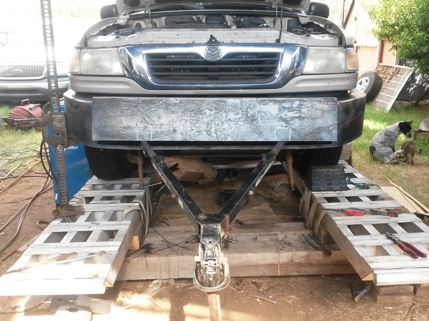

    The front bumper will serve as a means to store the tow bar inside of it and also there will be other storage areas inside the bumper for related safety equipment such as safety cables tow lights and a connector cord to plug into the tow vehicle

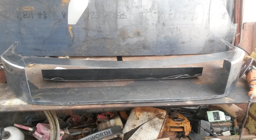

    Cut out to be the door hiding the tow bar

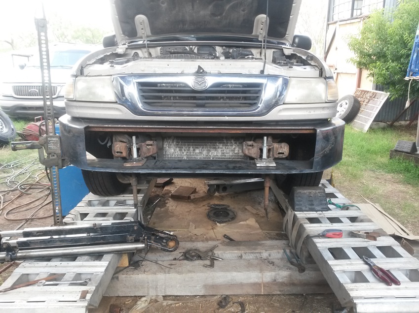

    bumper clamped in place

    Will have to add small cut outs so the door can be closed while tow bar is in use

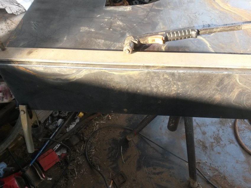

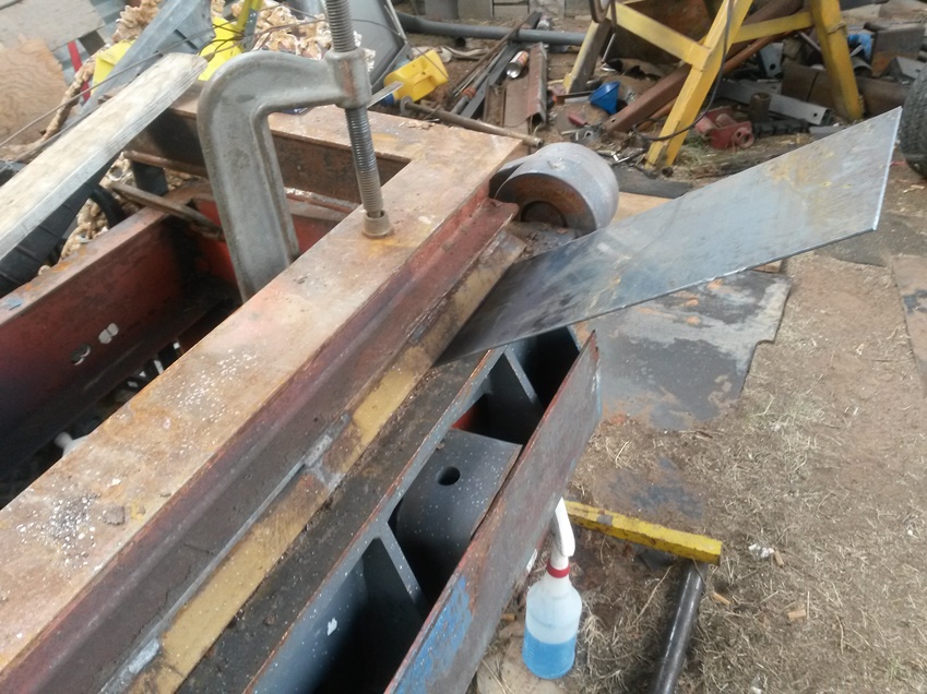

    Even though I may never finish doing the mods to my folding break it works perfectly

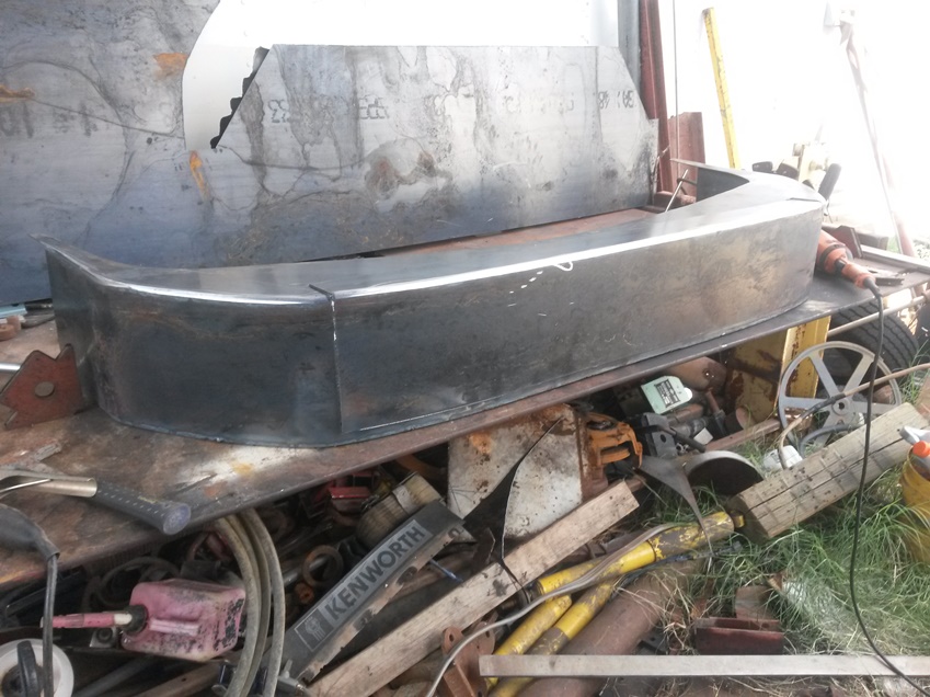

    For bending the bumper parts shown is a plate which will serve as one of the mounts and a back for the built in storage compartment

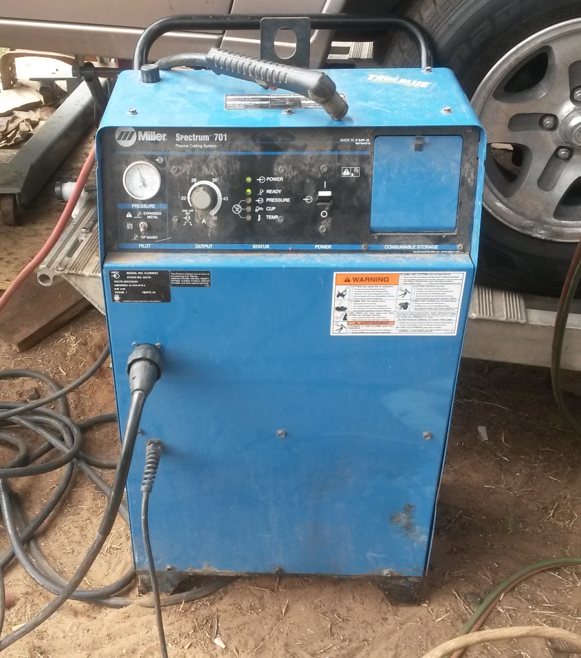

    Update for the bumper
    This is my plasma machine, In the construction of this bumper I used just about every cutting tool imaginable
    Plasma, Oxyacetylene torch angle grinders, band saws, die grinders, belt sander Drill press, lathe, and a pipe cutter. About the only things I didn't use were the chop saw and the mill

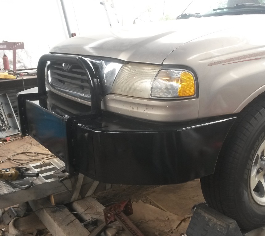

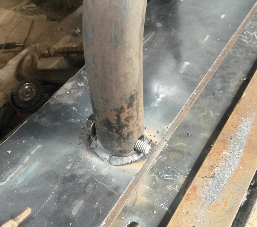

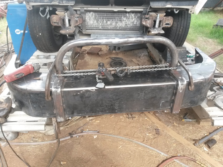

    fitting the grill guard

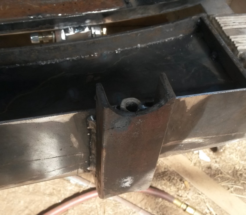

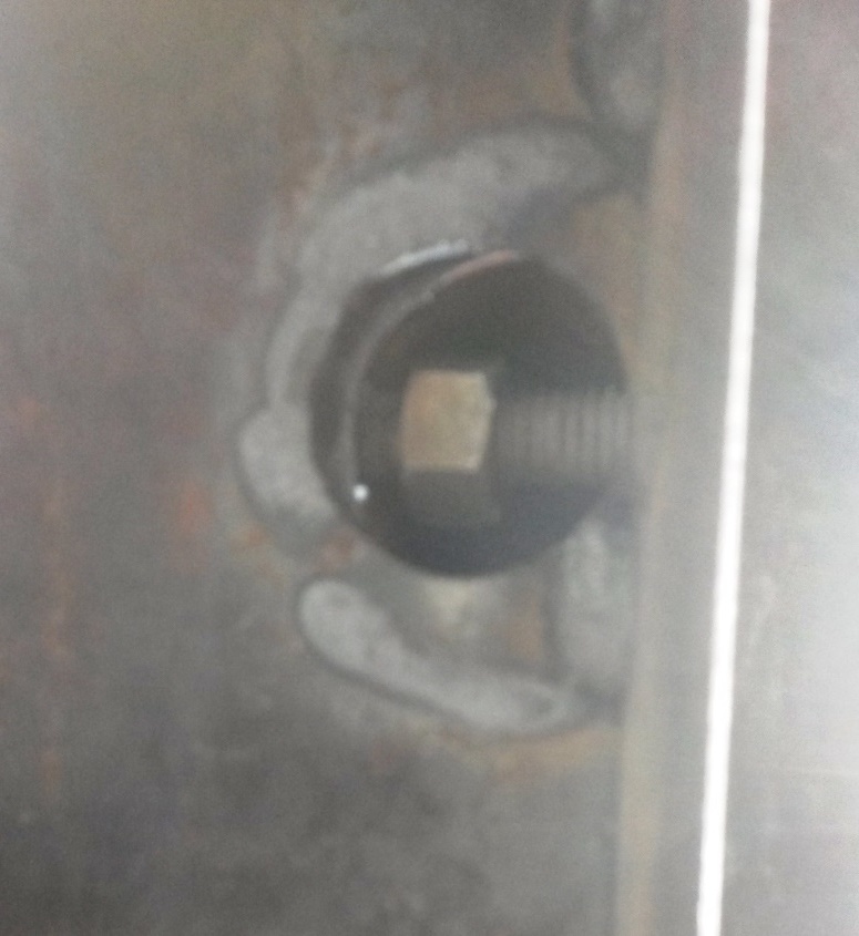

    the door measurement is done via 2 captured bolts passing through the verticals
    from inside the bumper there is a hole to access the nut that keeps the bolts from falling out when the door is open also should the need ever arise the bolts can be replaced
    this is the mating nut welded inside the door hinge /lock channels when the door is closed you have to know to look behind the grill guard or you might not know that the door opens

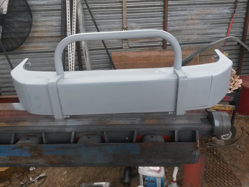

    A little etching primer

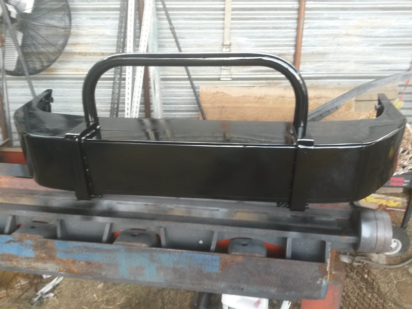

    Black bumper ready to be re mounted

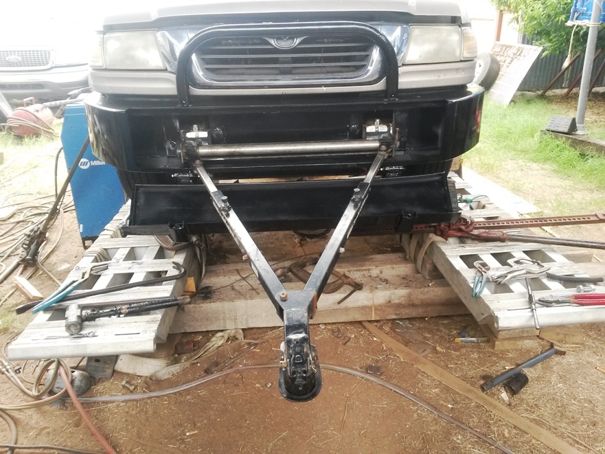

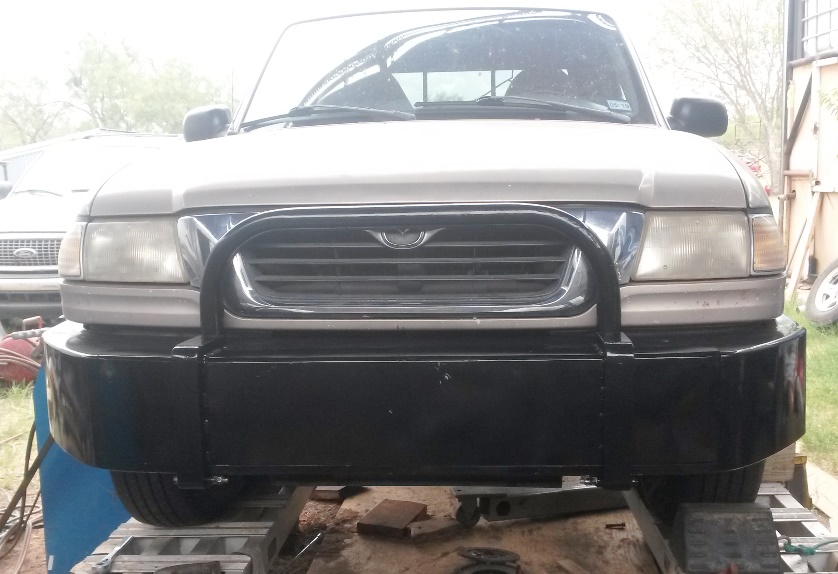

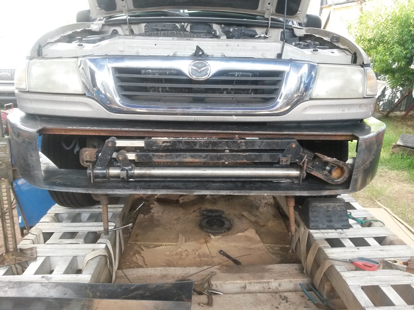

    the bumper is now on the truck with the tow bar mounted inside
    http://www.homemadetools.net/forum/tow-bar-mount-68720
    In case anyone is wondering the push bars on the door serve multiple purposes
    the hinges on the bottom and a means to secure the door

    Nice work Frank. What happened to the cutouts for the tow bar when "in use"? Or did you use a different work around?

    Click on the first picture to blow it up and you will see the face of the bumper just hinges open while towing the pickup there is no need to close the face so there are no cutouts
