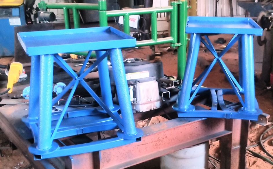

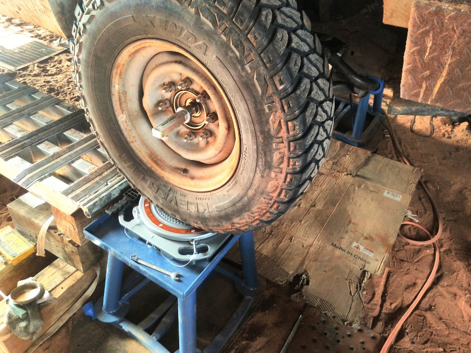

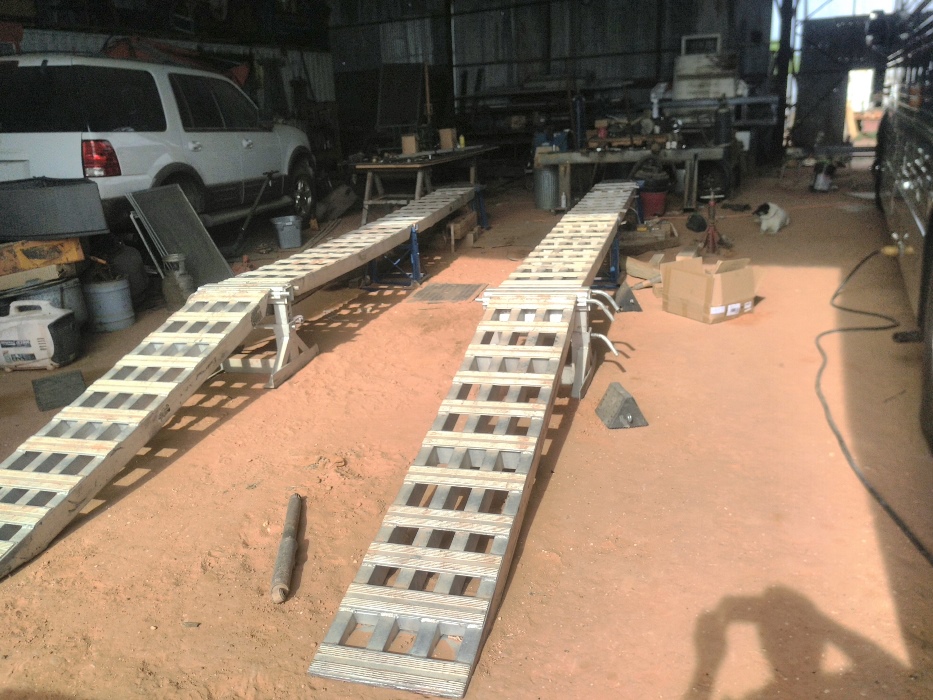

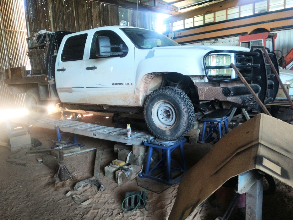

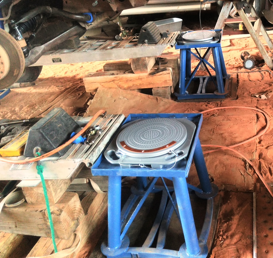

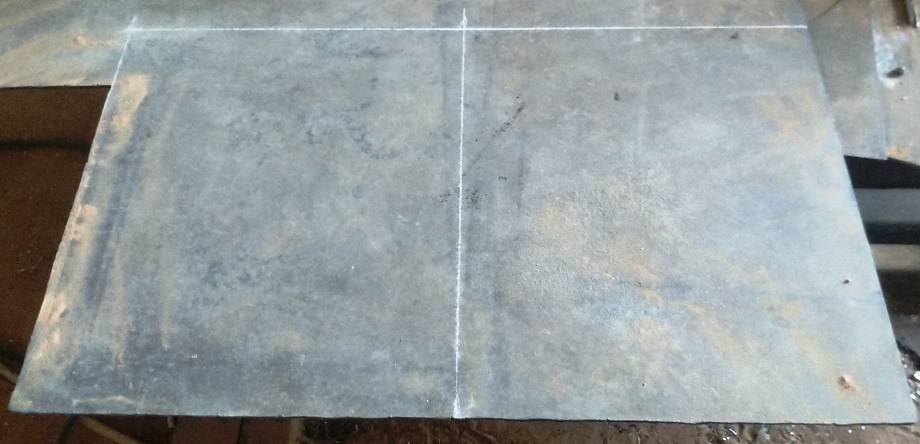

    After rebuilding the entire front end of a 2007 GMC 2500 HD. I got to thinking I already have this thing up on a rack making it easy to work on the only thing missing would be to be able to set the caster camber and toe. The way I connected the trailer ramps together was already reasonably level but if I put a pair of turn table alignment plates on top of them it would make the vehicle higher in front that the rear throwing off the caster adjustment. Not much but enough to keep me from being satisfied with the results. The solution was to build a pair of pedestals for the turn tables to sit in making the tops of the plates the same height as where the rear tires were on the rack. This way I could level the pedestals to each other as well Here is what I did
    the pedestals are made from a sheet of 1/4" plate some bits from a steel hose reel like I made the ramp stands out of Some 1-1/2" angle Iron some 1 1/4" flat bar some cut off scrap strips for bracing 1/4" thick rounds to give a solid surface to weld the legs on and some 2-3/8" oilfield tubing for the legs, all materials were upcycled except for the angle iron and the flat bar

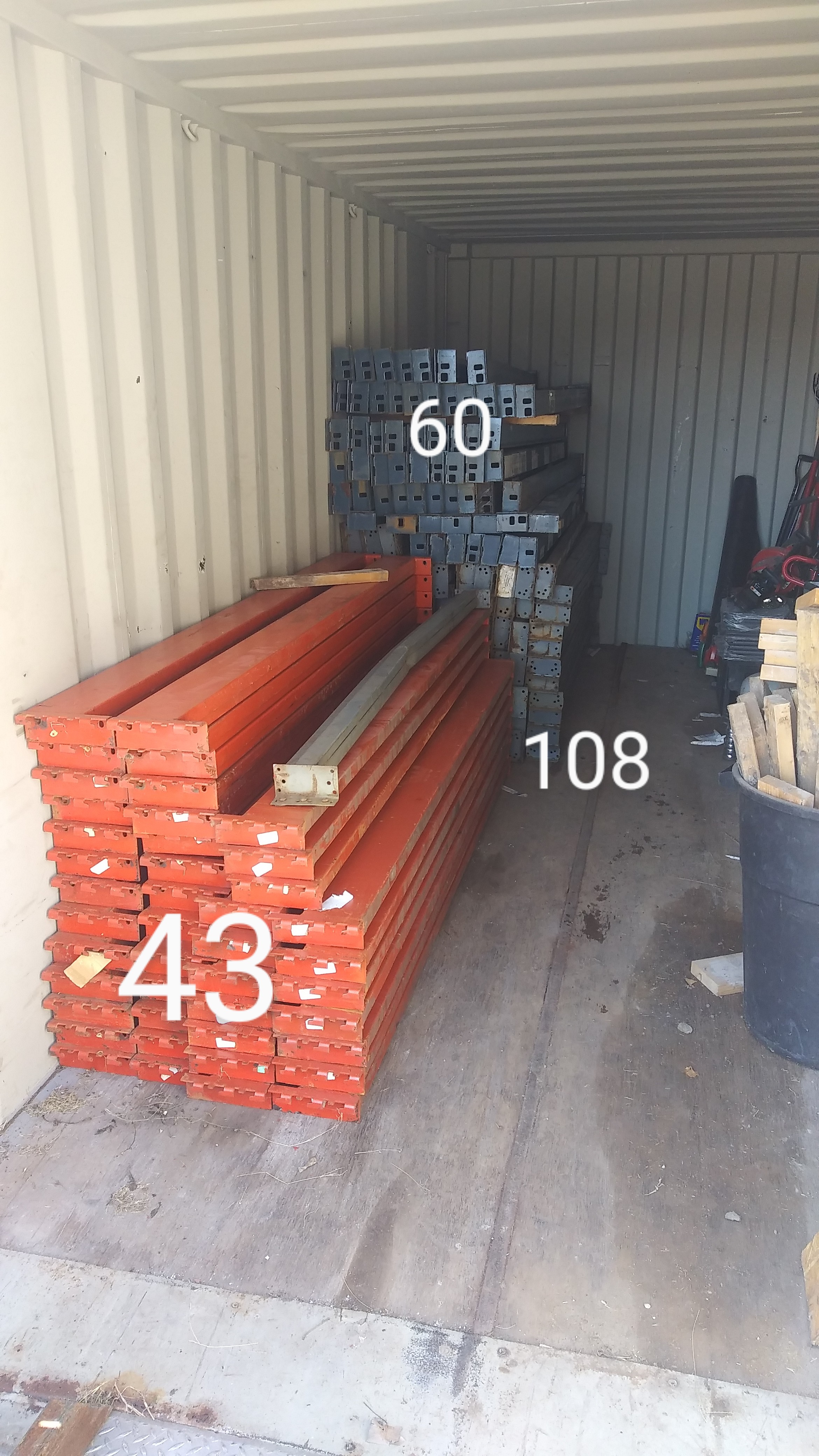

    Steel for example used to be incredibly cheap, not just by an earlier standard, even more so, looking back. Stocking up on usable material is a terrific hedge at whatever cost, now that transportation has skyrocketed. For the right price, I'll drive for what's deemed useful; with decent assurance at least one (acquisition or transport costs) will not be lower. 3 trips to Cleveland, 3 to Birmingham, 5 back to CA have not become sour or 'I shoulda'. Against limited resources, careful spending pays off, when allowing the period of appreciation defray what was spent.
    Buying in anticipation works knowing price ranges of items sought; like pallet rack beams @ $3 to $6 apiece, not $15-$22, floor grating 4'x12's at $50 each, not $250+.

    Your idea of a large lift is kind of what's been hanging in mind for me, with a little different use. I have little need to be under Class 6-7 or 8 trucks, but would sure like to park indoors.
    If such could lift high for drive off onto the dock-level building floor, and enough for passenger car storage and work (4 post lift), with heavy enough tread way for the truck when bottomed out, posts spread enough underneath stored vehicles . . . Solution awaits cutting floor down to street level and a big damn door, now 8'x12'.
