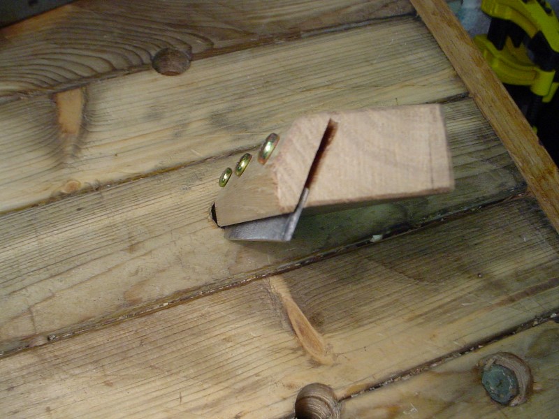

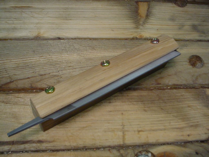

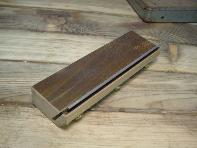

    In the luthier tool category, here is my tool for filing the end of frets on a fretboard :
    This is a pretty classical design, it uses a standard flat sharpening file.
    The groove is cut on the table saw.
    The screw holes are tapped directly in the wood.
    The woods comes from a scrap piece of furniture and the bottom is varnished, which happens to be more slippy.
    Cheers !

    I really like the varnish detail, Christophe. Never would have thought of that.
