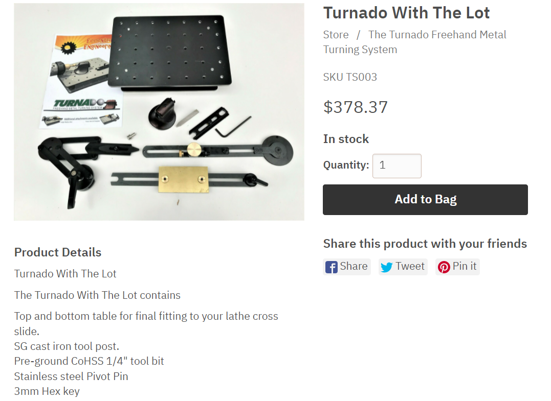

    Nicely designed and cleverly executed, Nigel!
    You could also add a profile / tracer attachment as these guys offer for just under 400 bucks:
    https://www.eccentricengineering.com...turning-system
    All the best!

    that's cool, would be great from creating brass parts like the chimney cap on the traction engine, thanks
