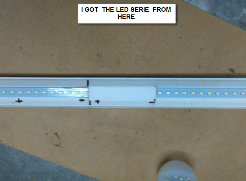

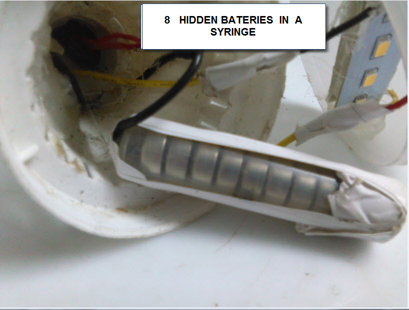

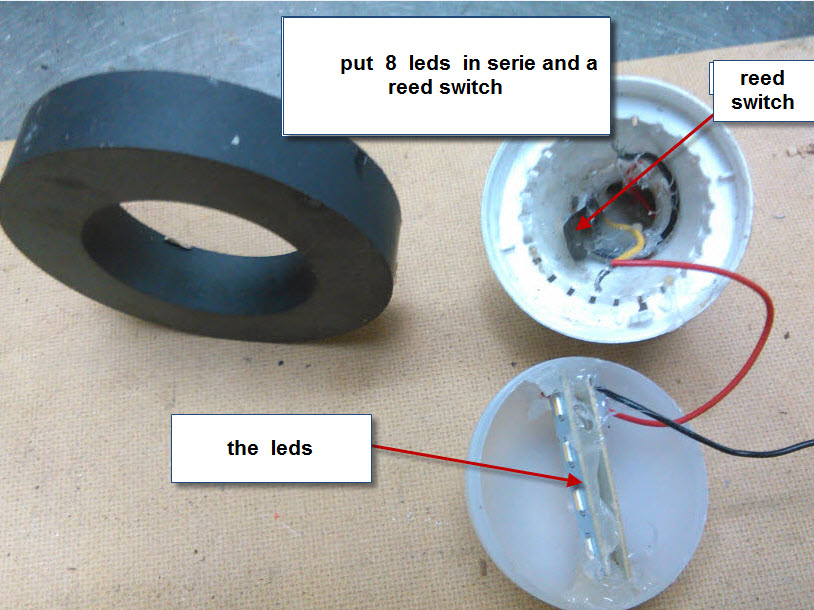

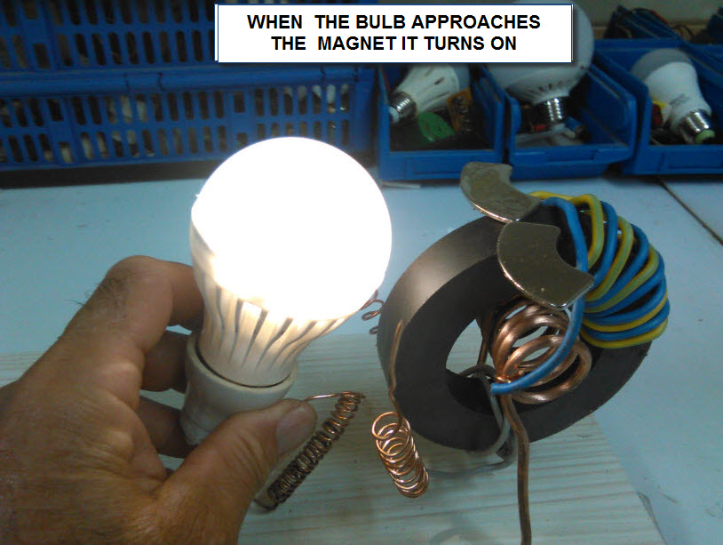

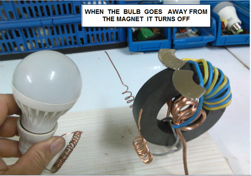

    Too many posts with free energy. All of them are fake. You must give energy to take energy . I made thiw construction that supposed to capture the energy from the radio waves of the atmosphere. In fact there is a hidden battery in a syringe and a homemade reed switch with some leds all hidden in led bulb. Othe r similar constructions give energy with a small motor with hiw baqttery hidden in another fake empty motor or they use the induction with a big coil hidden under th table and a foot switch that gives current to the hidden coil.

    Love it! You've gotta hand it to mariost. Made his 'generator' almost look like an electronic insect critter — with the hard drive magnet 'wings' on the mag-tube salvage magnet.

    I suppose there would be some people that would believe that worked because they wanted it to, but the way it just switches on and off without getting brighter or duller depending on the proximity of the bulb to the magnet points to fakery.
