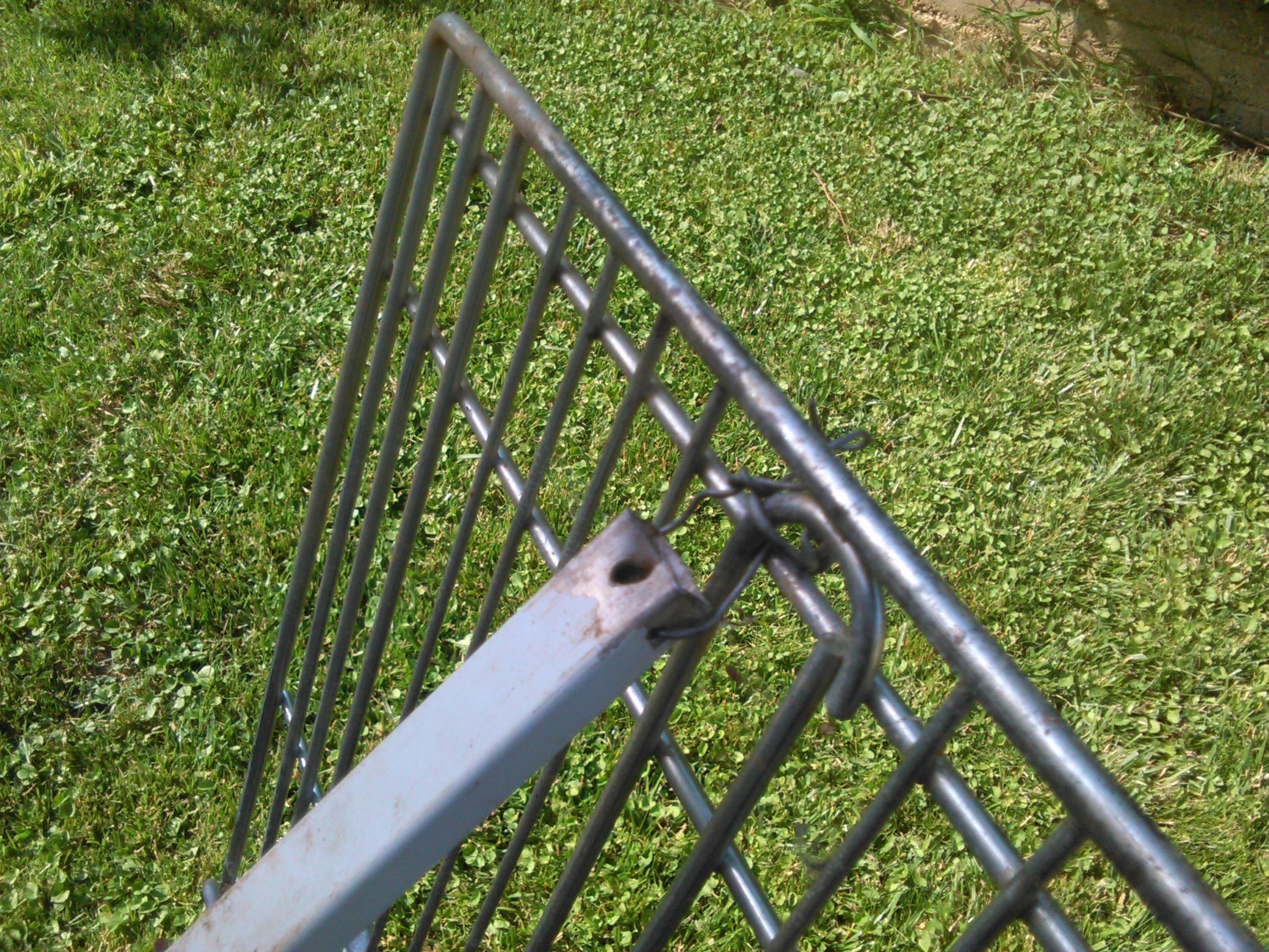

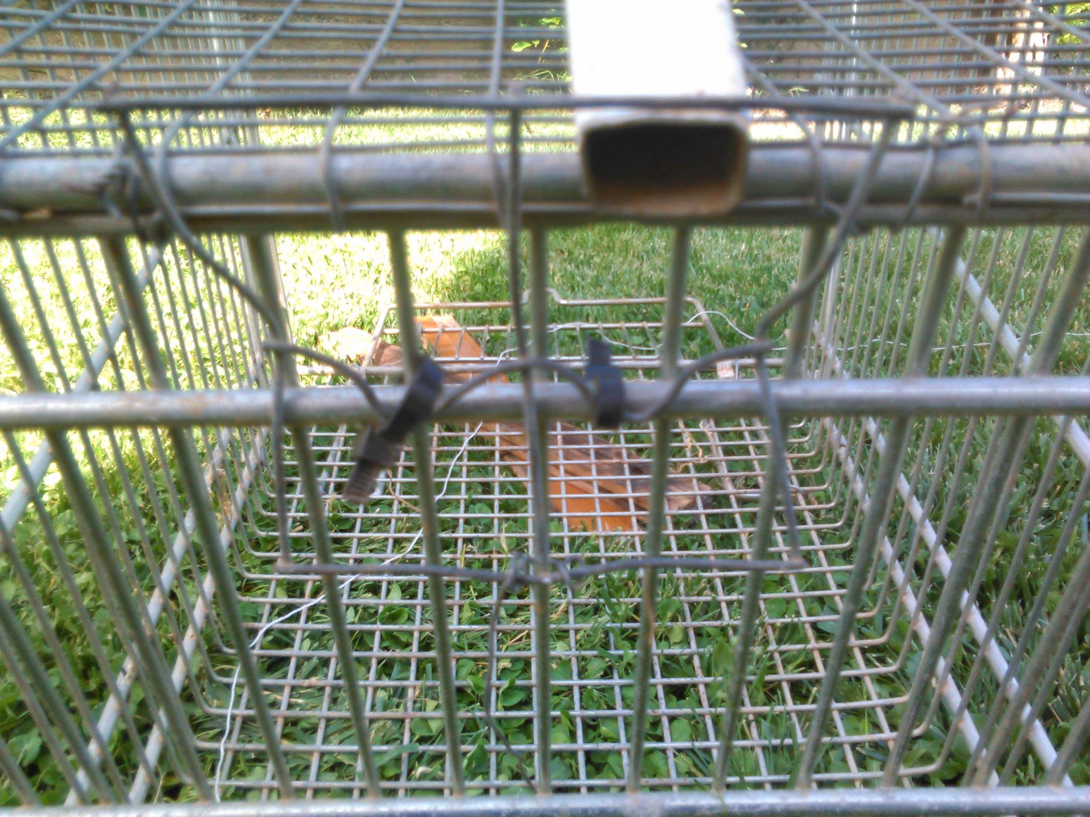

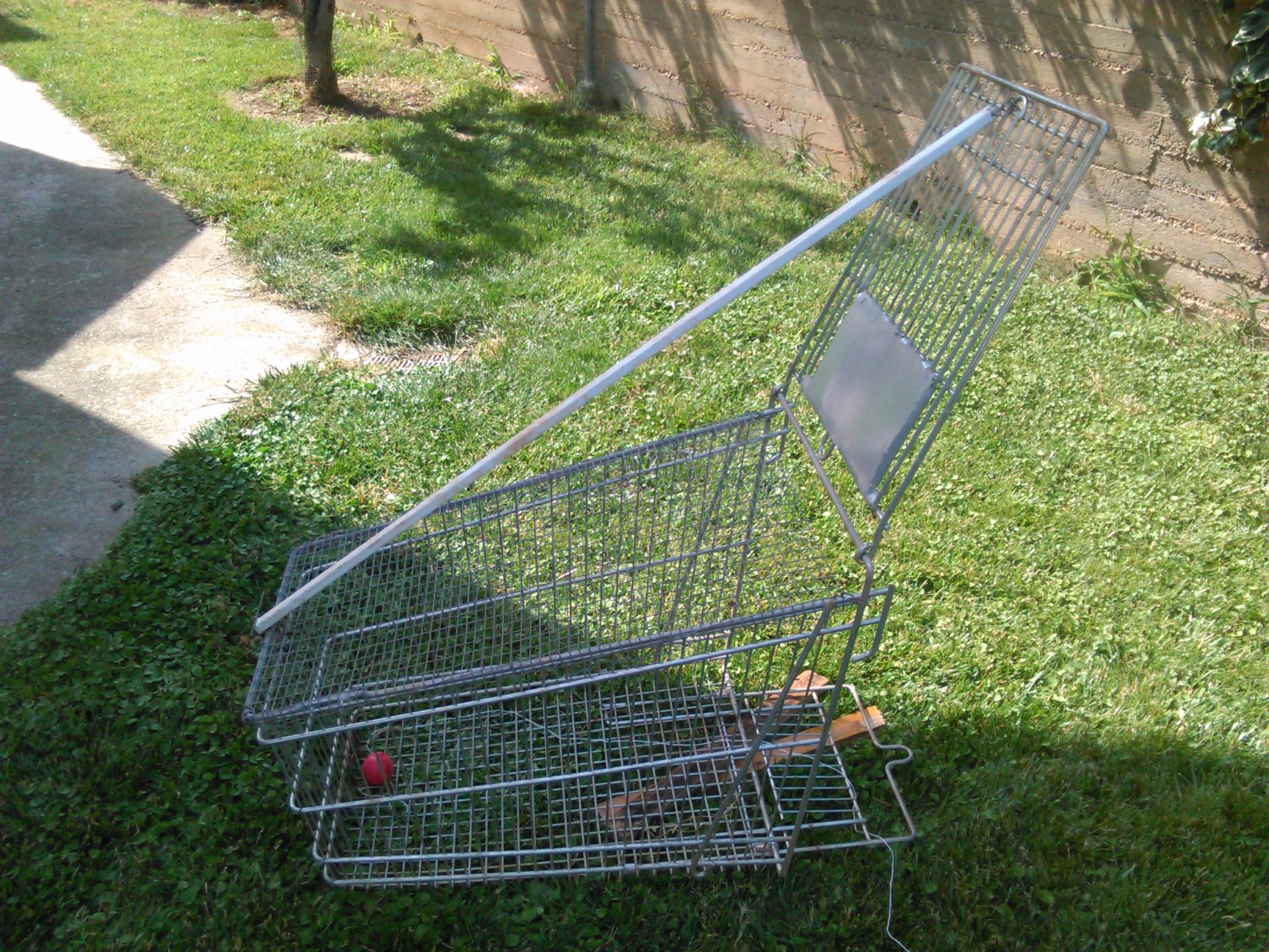

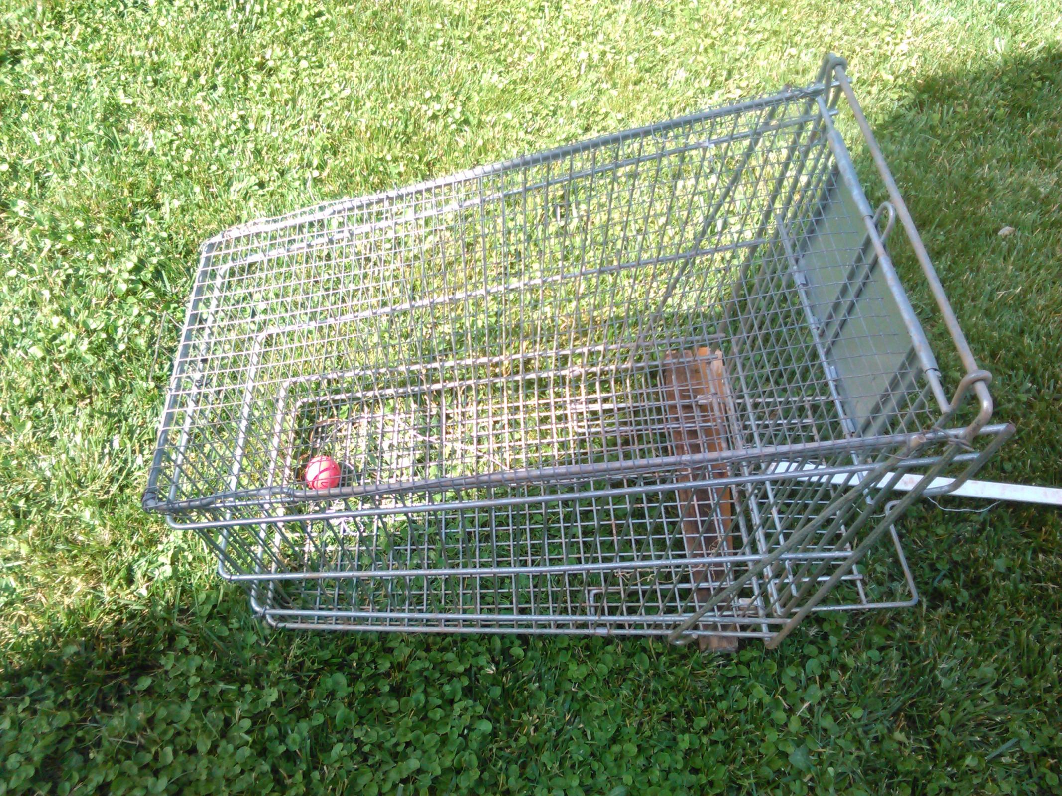

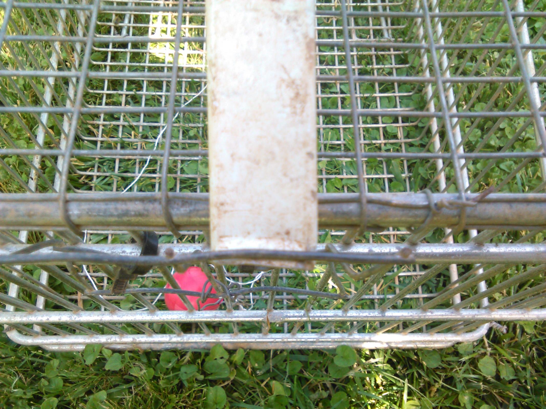

    An easy trap to make for the foxes and ferrets that visit your chicken coop during the night. The trap doesn' t injure the animal. After catching it we get it away to change neighborhood. Ιt' s made from a supermarket cart. To attract the animal we put fishes (tight them to the special tool) inside the trap . When the animal pull the fish , the metal bar get free and the trap closes and secures.
    YOU CAN WATCH HOW THIW TRAP WORKS HERE.

    Very nice action — and operation of the closer latch.
