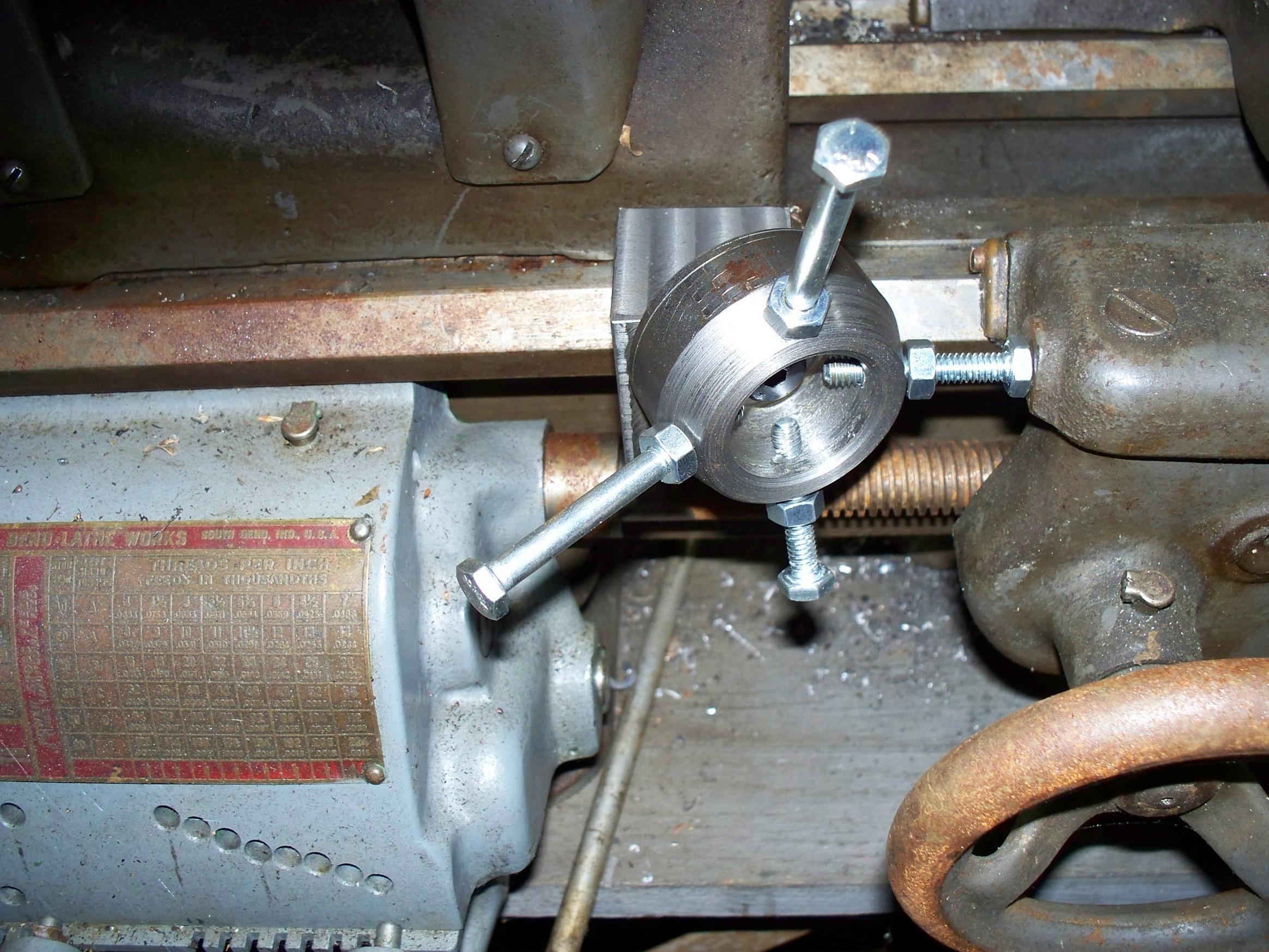

    Check out my latest weekend shop project. I wanted to make something different, so I built this 4 way carriage stop. It turns at a 45 Degree angle has 4 stops , and has a ball spring position stop. The angle lets you work closer to the chuck.
    I will replace the bolt stops with knurled machine screws.
    Any comments / suggestions appreciated.Four position stop for South Bend 9" lathe-south-bend-4-way-stop-001.jpg

    45 degrees - Great idea. Thanks for sharing.
