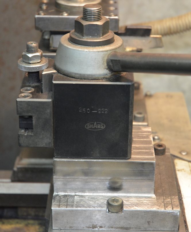

    Original (very bad) design is 2 bolts compound clamp with bolts at wrong places. There is a lot of flexing, vibrations and chatter.
    Picture 02
    New 4 bolts compound clamp and new beefier 4-way tool post.
    I have no intention of installing QCTP, as for the last 30 years or so I was working on various heavy duty lathes with 4-way tool post. Shimming is not a problem at all, especially if the same size tools are used. For this tool post and 16 x 16 mm tools I need 2 mm shim. For 16 x 16 mm boring bar holder I need 9 mm high shimming.

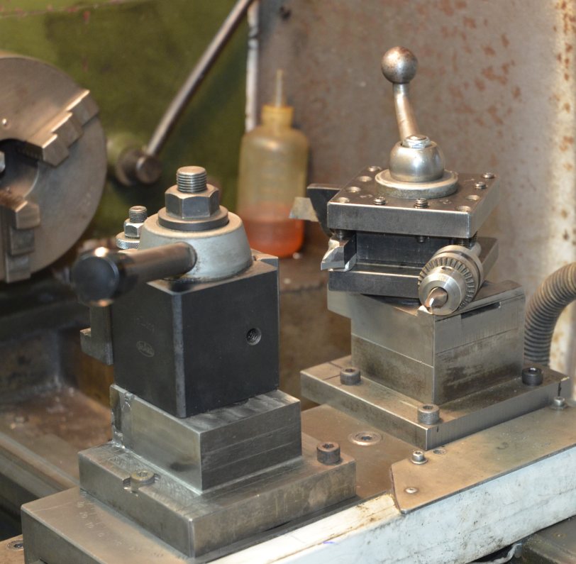

    Thank you for the excellent photos and instructions. Looks like a significant improvement over the original design. Can you take deeper roughing cuts and do you have a better surface finish on the finish cuts?
    Regards, Paul
    Download plans for clamps.
    Supporting Member LMMasterMariner's Avatar
    Jan 2016
    Dubrovnik - Croatia
    234
    588
    Thanked 582 Times in 132 Posts
    LMMasterMariner's Tools
    Hello Paul,
    Yes, it is big improvement. I can't feel any vibrations at long and thin boring bar and finish is much smoother.
    I can't take much deeper cuts as the motor is stopping, but there is complete lack of vibrations.
    Must say that I am very happy with this improvement.
    Cheers
    LMMasterMariner

    My similar effort uses 3 bolts but I went for extra rigidity by eliminating the compound slide. It only takes a minute to revert back whenever (seldom) I need the slide.
    I also added a rear tool post rigidly attached with a 4 way tool holder permanently loaded with a turning tool, cutoff tool and drill chuck with a spot drill.
    Four Bolts Compound Clamp-toolpost-mount-01.jpg Four Bolts Compound Clamp-fixed-toolposts-01.jpg Click images for full size.
