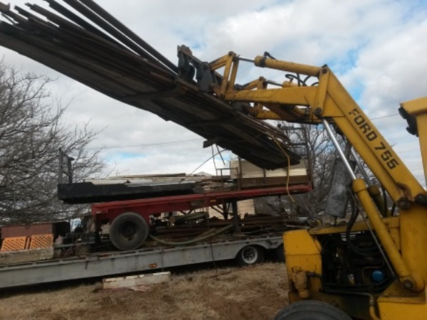

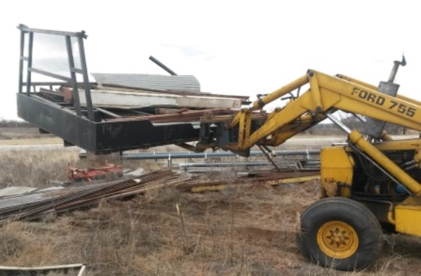

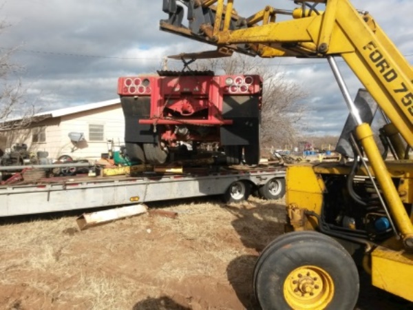

    Here is why to build things plenty stout
    Fork carriage for my Ford 755-20170118_144206a.jpg Fork carriage for my Ford 755-20170118_145943a.jpg Fork carriage for my Ford 755-20170118_153417a.jpg

    Kent it is never overkill as long as there is no detraction of operational usefulness.
    there is always underkill though which usually leads to destruction injury or worse
    the forks and carriage are strong enough that I can slide 1 fork all the way over to one side and at 2 ft out from the hock confidently lift anything the 755's loader hydraulics has the power to lift but to do that I would have to rotate and extend the hoe as far back as it will go with a bucket full of dirt. for an old machine it still has a lot of life left in it.
    the loaders on AG tractors are there for cleaning out the muck in the feed lots moving sand and gravel piles and general hauling of loose materials tons better than a shovel and a wheel barrow though.
    One word of caution about the tractor since I don't know what tractor you have I'm going to assume it is not a row crop tricycle. If you don't have weights on the rear axle have your tires filled with water, antifreeze + a rust inhibitor. the extra 1000+ lbs will be a real help.
