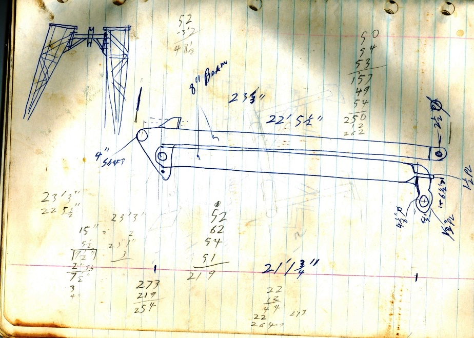

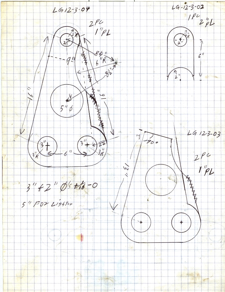

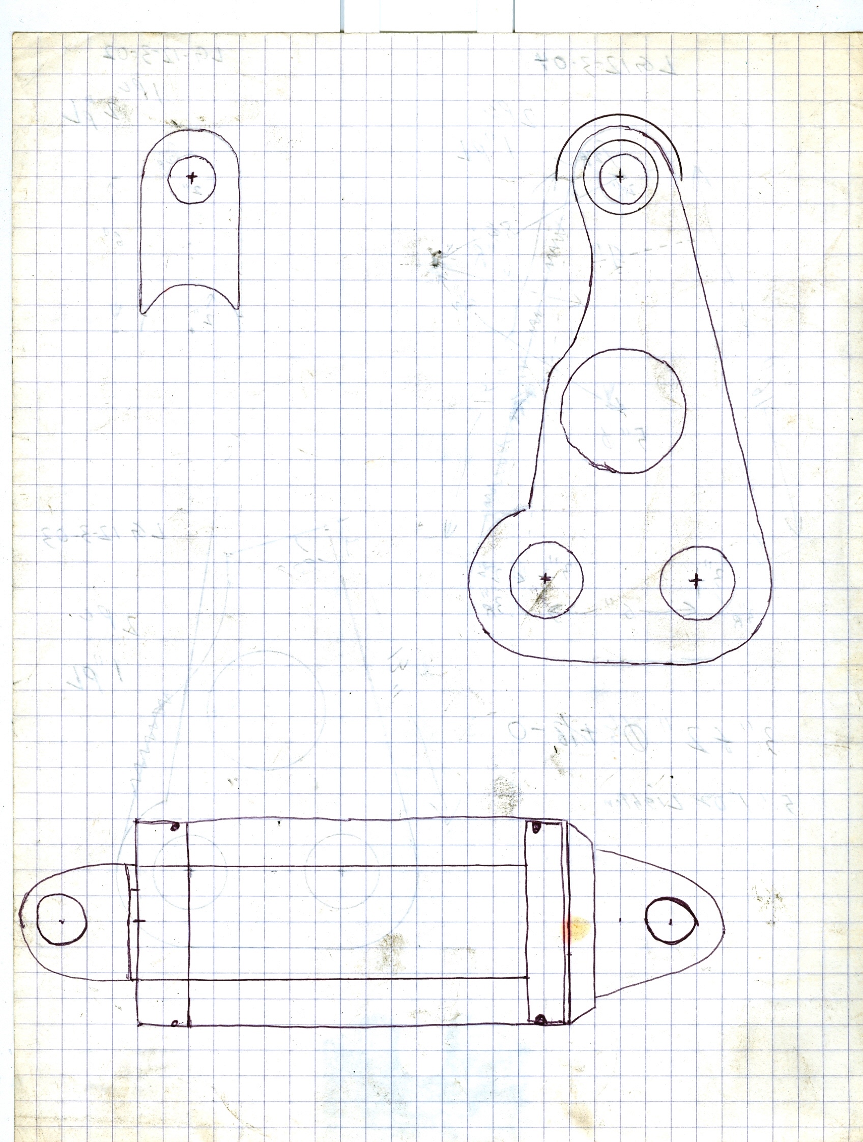

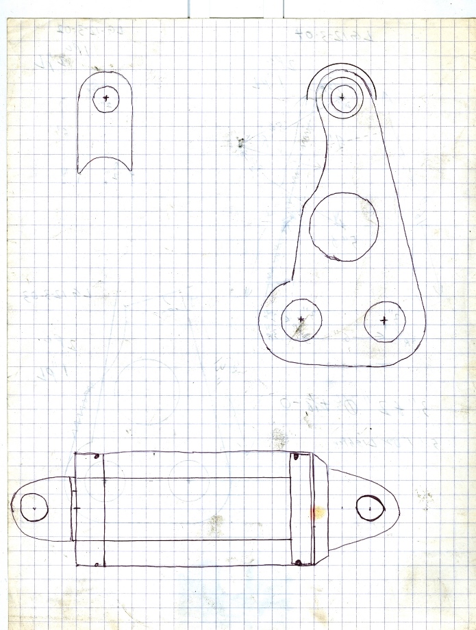

    Into my own personal rabbit hole I gleefully traveled And what should I find but the sketches of the ARMS of Destruction that I mentioned in another thread.

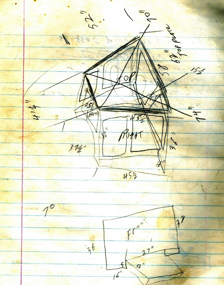

    the loader cab

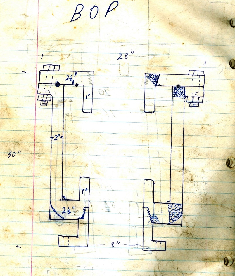

    the Blow out preventer

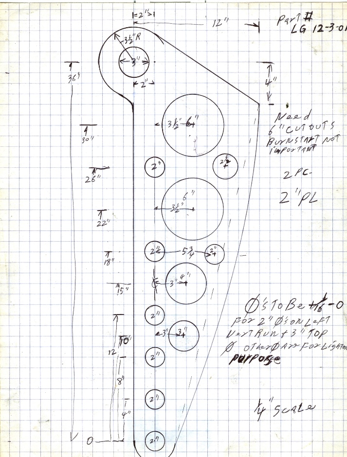

    "A"legs for the derrick

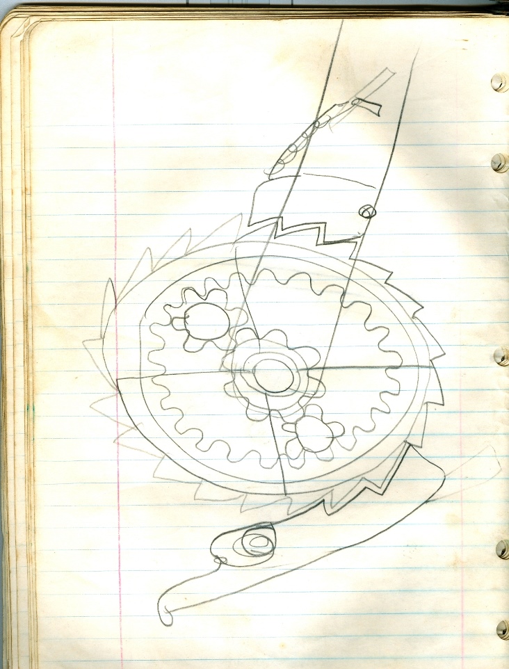

    A 5 ton come a long with epecyclic gearing

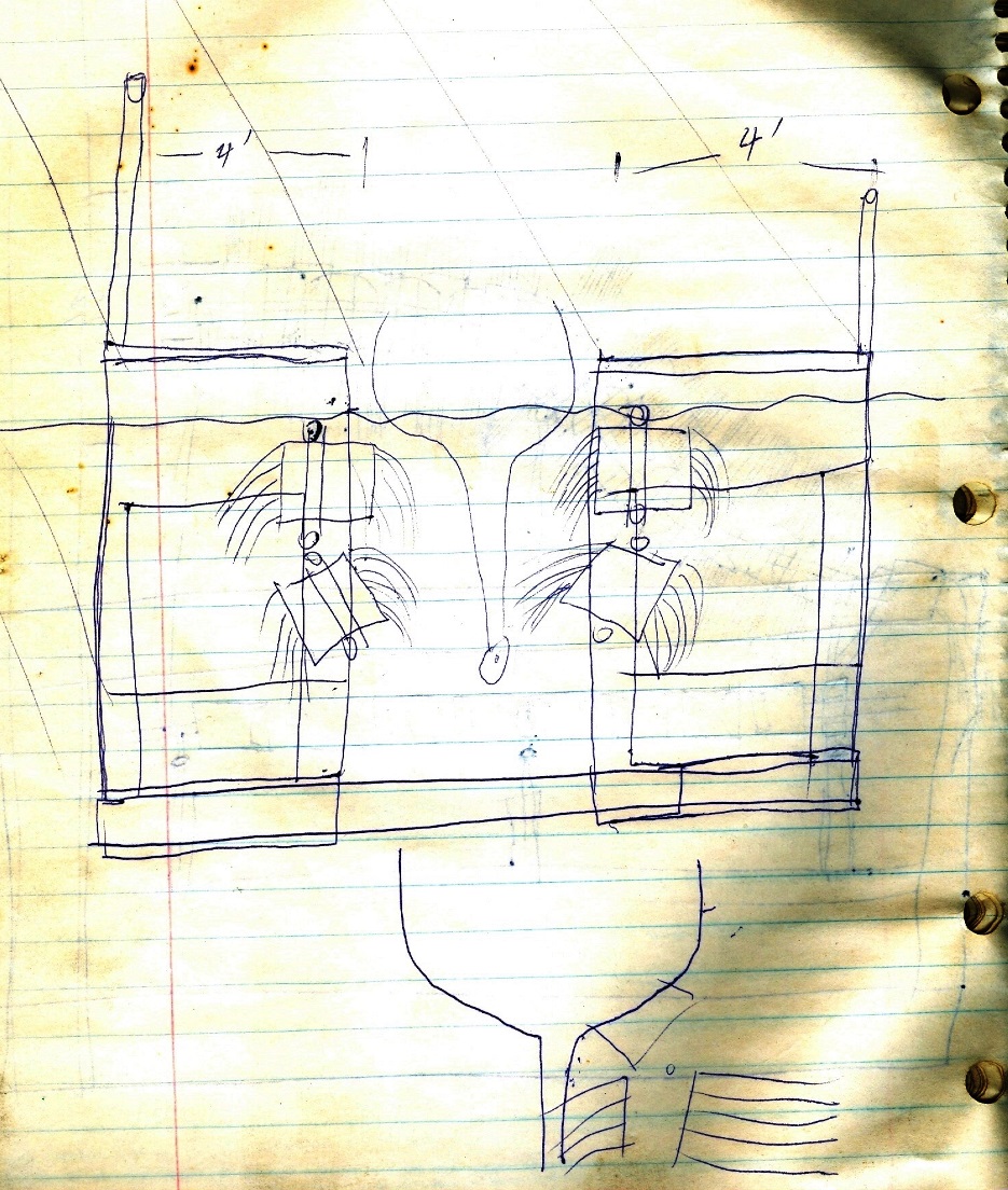

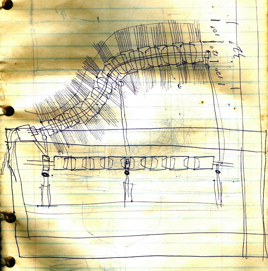

    Among these was a Sail boat hull cleaning system I proposed to the FT. Worth Boat club.
    It consisted of a pair of flexible shafts with nylon bristles the shafts were hollow and foam filled to give partial buoyancy. each was powered by a small gasoline engine and a belt reduction system. mounted in a frame on pontoons it could be towed through the harbor then moored to the ends of a couple of boat slips then a sail boat merely passed through the rotating brushes. After building it we discovered it cleaned the removable dagger board Keeled boats well enough but the larger boats with fixed keels were more trouble to clean with the machine than the results were worth. but the addition of several high pressure spray wands to assist in loosening the hull fouling algae helped immensely the problem was though in containment and removal of the algae from the water. submersible panels had to be made and a pump system to pump out the algae filter the water and return it to the lake proved the whole set up more expensive to maintain and meet water purity levels than could be economically justified so the thing was scrapped after only 1 season of use
    Here are a couple of the sketches I found in my note books another completely forgotten tool since I don't have any pictures anymore of many of these things
