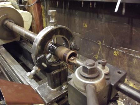

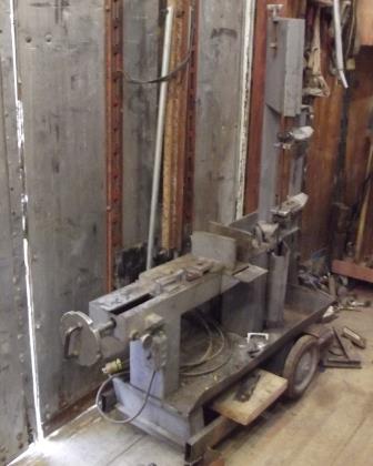

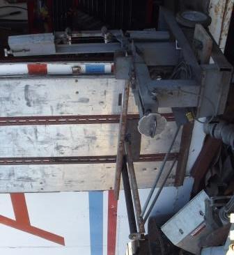

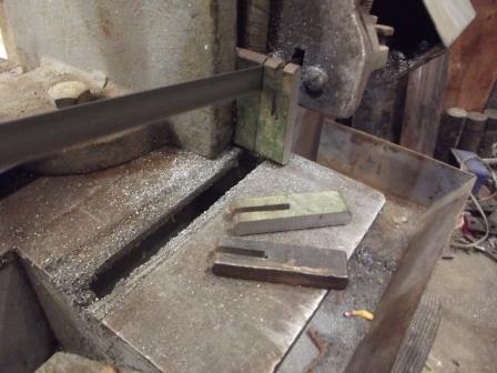

    Here is my folding roller I made today for my band saw
    First I had to use the steady rest I made a couple days ago so I could bore the ends to accept the bearings

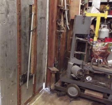

    Next was to cut the mounting tabs that would fit in the "E" track slots on the door

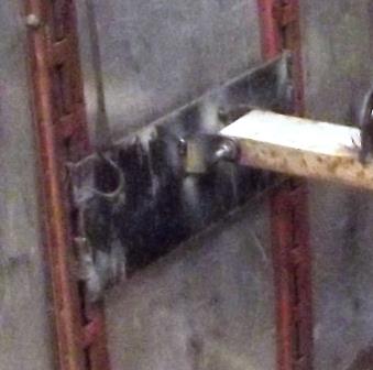

    Next was to weld the mount and attach the roller assembly

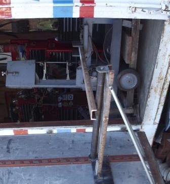

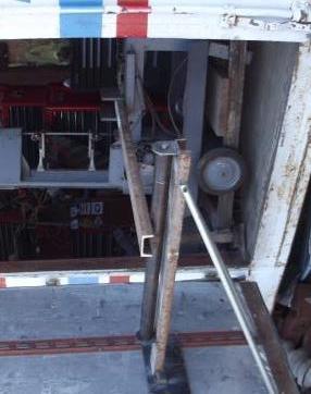

    Next was to check the alignment in all positions
    folding materials roller for swing away band saw-dscf6933c.jpgfolding materials roller for swing away band saw-dscf6934c.jpg

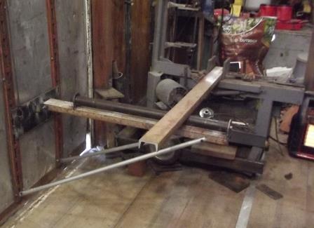

    Next to see how well it tucked away I will have to eventually get a better holding strap or a shorter bungi cord when it is folded up out of the way
    folding materials roller for swing away band saw-dscf6937c.jpgfolding materials roller for swing away band saw-dscf6938c.jpg
