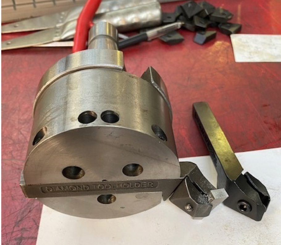

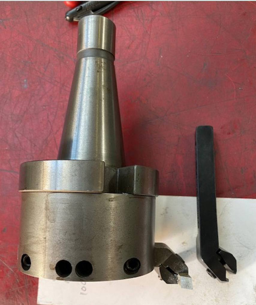

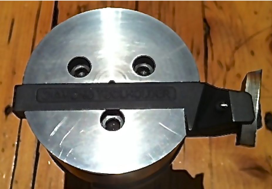

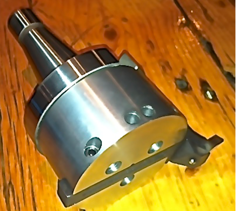

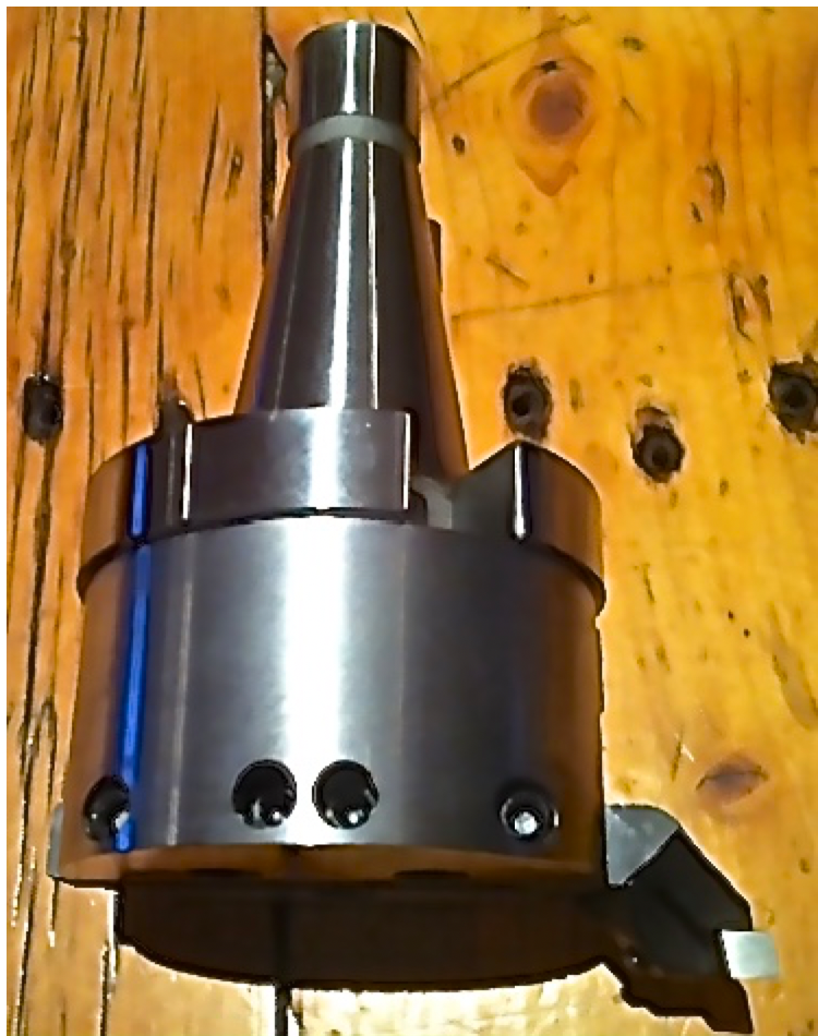

    The following are the photos Gary Sneesby of Eccentric Engineering sent to me.
    The purpose is to illustrate the Tangential Flywheel Fly Cutter concept.
    I would like drawing (CAD) assistance to create a stand alone Flywheel Fly Cutter.

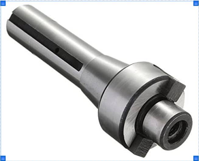

    As the majority of Mini Mills used by Amateur Machinists I suggest an R8 Arbor as the Mill Holding Tool insert.
    An R8 FMB22 as an example as the tool holder for the Flywheel

    Gary Sneesby has a professional grade Mill as he is a Machinist by trade.
    There are however many mounting that can be used and my concept is to use something most Amateur Machinist can obtain or have in their tool box that will work on their machine.
    The other reason for using the R8 based Mill mounting tool is with one screw the Flywheel can be separated from the mounting and only the Flywheel needs to stored when not in use.
    1/4 inch Square HSS or Crobalt tool bits are a simple and basic tool bit every machine shop should have.

    I wasn't aware that Gary had built this. I have had the bit move slightly on heavy interrupted cuts on the lathe though. The large mass would make for a smooth cut due to inertia and kinetic energy. Mass is good.

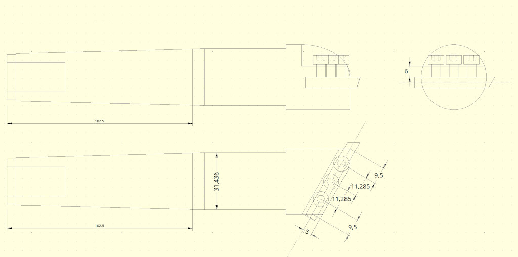

    The tangential cutter is an excellent idea, and I intend to build myself one once I have figured out how to overcome its inherent flaw: the toolbit is held by a single screw, and whenever I tried a single screw to hold my toolbit, whatever its design, the bit slipped during use, messing up my setup, and I ruined my work piece. Not again.
    If you still want to go that route, your easiest way to do that is to get hold of a screw of appropriate size and turn its shaft into a R8 mandril, and give its head a slot to hold your existing tangential tool holder, so that it looks somewhat close to this:
    and as a 2D drawing

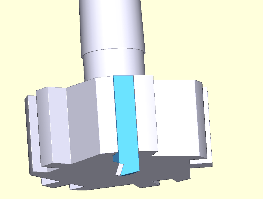

    Since the toolbit is not vertical to its axis of rotation, the risk of slipping out of its slot is much reduced, and the four screws holding the 6mm bit hold it much firmer than a single screw ever could. The dimensions on my drawing refer to my own machine. With its MT4 taper and 1.5 kW motor, it is somewhat stronger and bigger than yours, but otherwise very much the same design. When I built this flycutter many years ago, I wasn't aware of the tangential cutter, and thus its cutting edge is of the conventional design, with two faces to be ground.

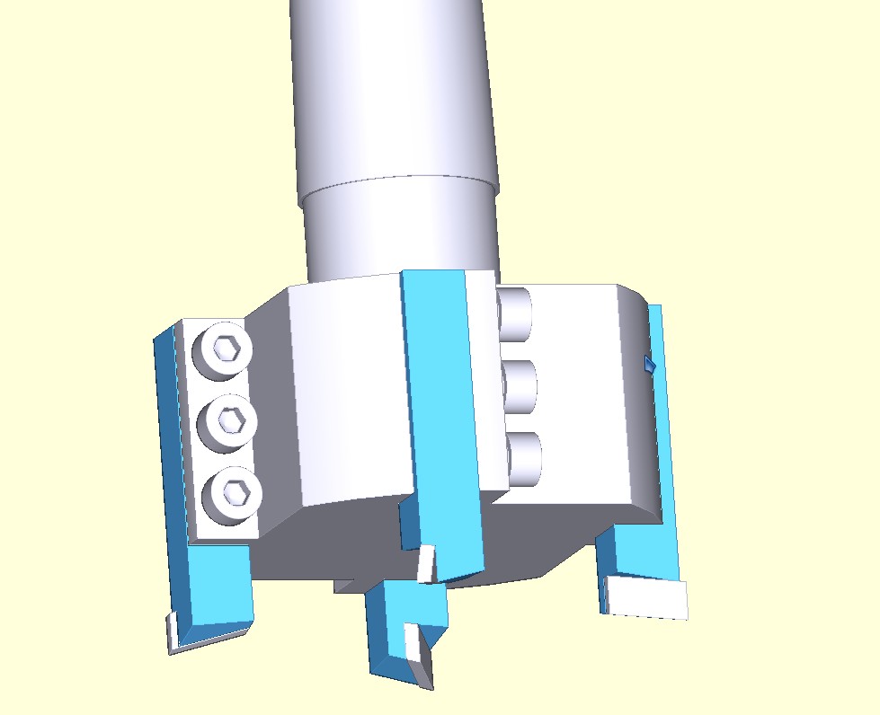

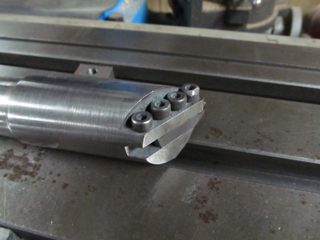

    When I bought my milling machine, it came with a face mill using four brazed carbide cutters - easy to replace and easy to sharpen, Just as I like it. But it is still two faces that need sharpening. Over the years I learned how to sharpen them, and how to mount them in the facemill, so that I can obtain an (almost) as-polished surface. It looks like this:
    I came also into possession of a large screw, with a head more than 80mm wide. It has been turned down to something close to another facemill, with the head ready to accept 5 cutters. And there it languishes . . .
    Clearly, a tangential cutter is not present, yet. What needs to be done here is to copy the angles from my attempt at making a less slippery tangential tool onto this facemill and then study the consequences - such as what setup is needed to cut the slots at the proper angles. So if you can keep me motivated . . .

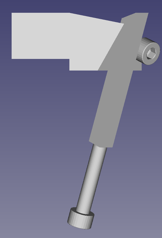

    Flywheel Fly Cutter for a Mini Mill Concept-screen-shot-2021-09-15-19.05.23.png I copied the screen image to my reply. Is this what I am looking at.
    CanBeDone: I used FreeCAD to open your STI file. Please explain what I am looking at. as I am at absolute ZERO on learning any CAD system. I do not know how to rotate the drawing to see what I may be looking at.
    However that in it self is a start. Thanks
