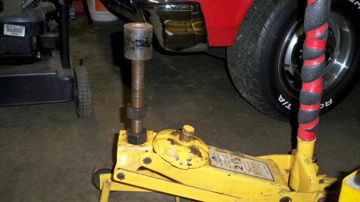

    Floor Jack Extension
    Floor Jack Extension-100_3155.jpgFloor Jack Extension-100_3157.jpg A heat treated 1" steel stud bolt,a short piece of steel pipe with heavy cut washers welded on both ends,Bolts to floor jack by 2 large nuts and the jack "cup" drops in the piece of pipe.
