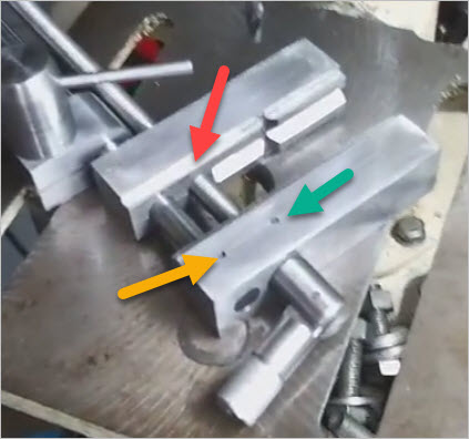

    I have a regular small size benchtop drill press and I have tried a number of vises but I was not really happy. I saw Mr Pete demonstrating a float lock vise on youtube he bought at an auction, it seemed quite big for my little drill press so I decided to make my own to match the table size.
    The jaws are from 3/4" square mild steel x 3" long. I used 8mm rod and cut a 8 x 1.25mm thread for the screw. For the shaft I used a 8mm hardened shaft from a printer. The other parts are all from mild steel.

    I like it! Can you clarify what I think I'm seeing?
    - red arrow = vise block tapped to match threaded rod?
    - orange arrow = dowel pin through the slider rod to retain it?
    - green arrow = ? looks like a pin but off to the side? I would think the vise block has a ID slightly over the thread rod OD? Can you elaborate on this or show the parts disassembled? Or a sketch?

    you are correct the moving jaw is tapped to take the screw (red arrow), the yellow arrow is a retaining pin for the rod there is one on the other end as well to secure the bottom, the green arrow is also a retaining pin for the screw and you are correct about placement. It is a 2mm pin and it is drilled at 4mm from center on an 8mm hole, I cut a groove in the screw that it slides into. I have a picture on my google drive showing the pin, offset and screw thread groove. Here is the link
