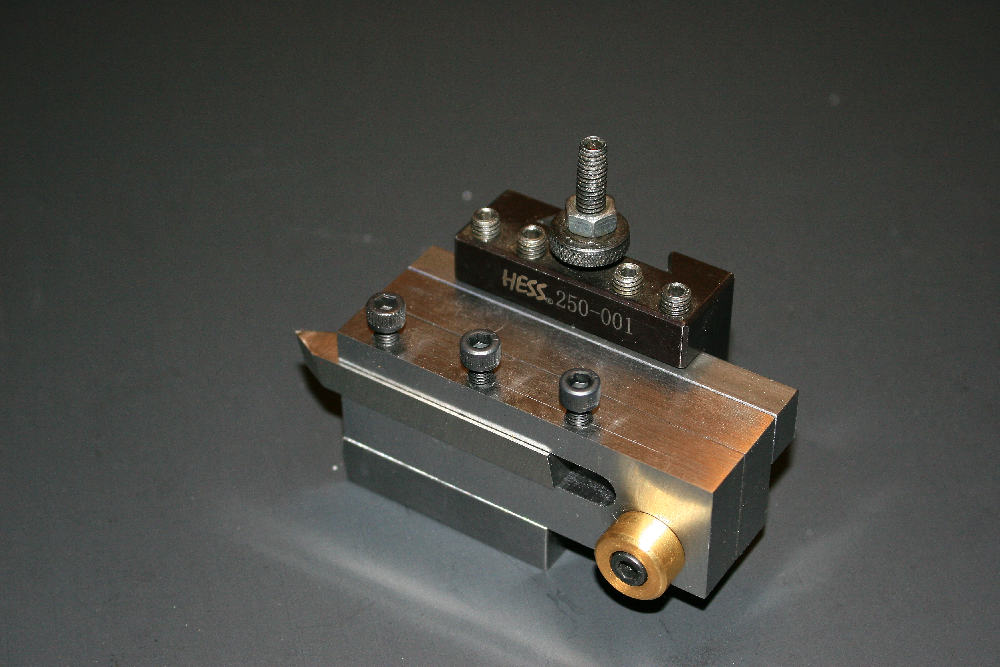

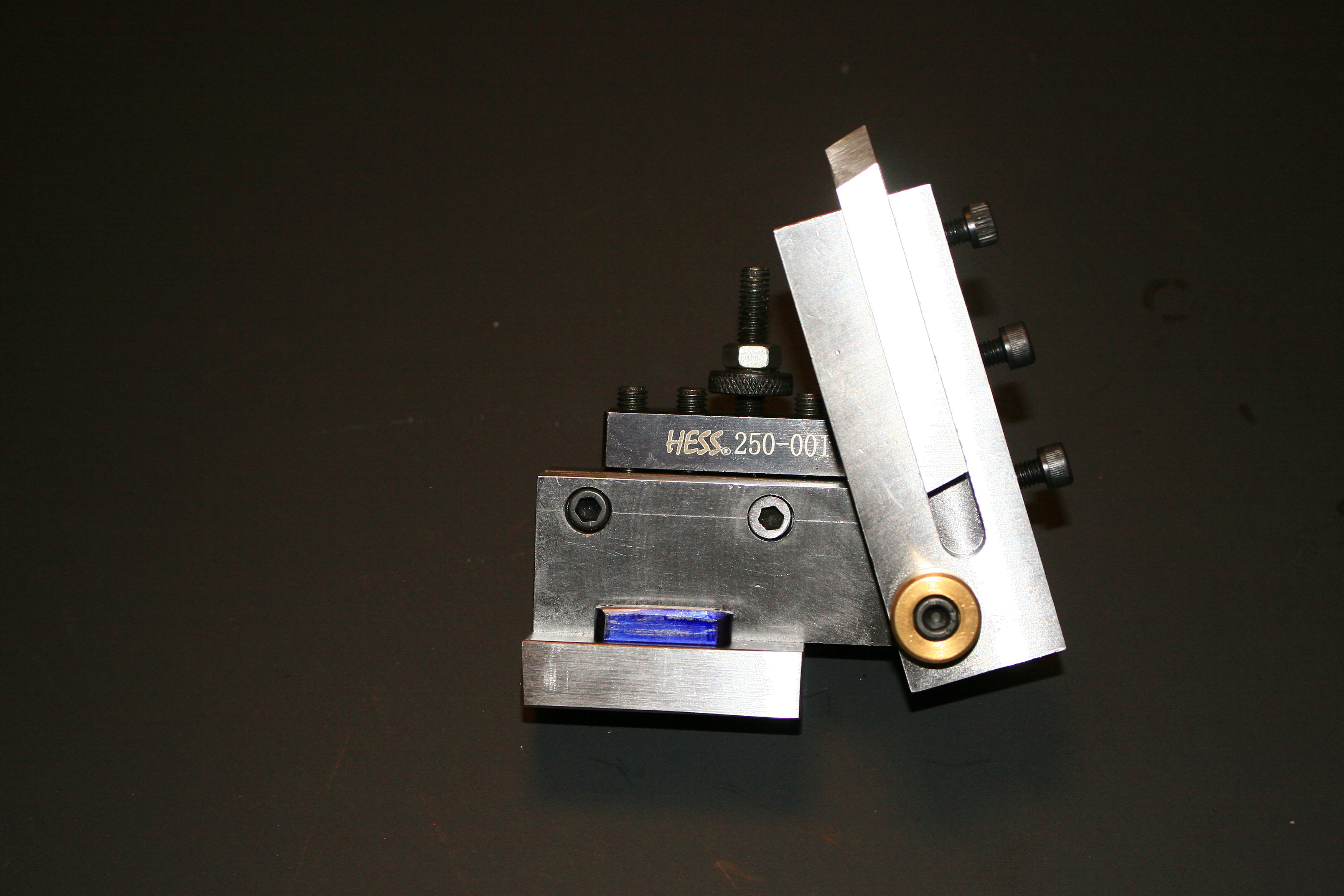

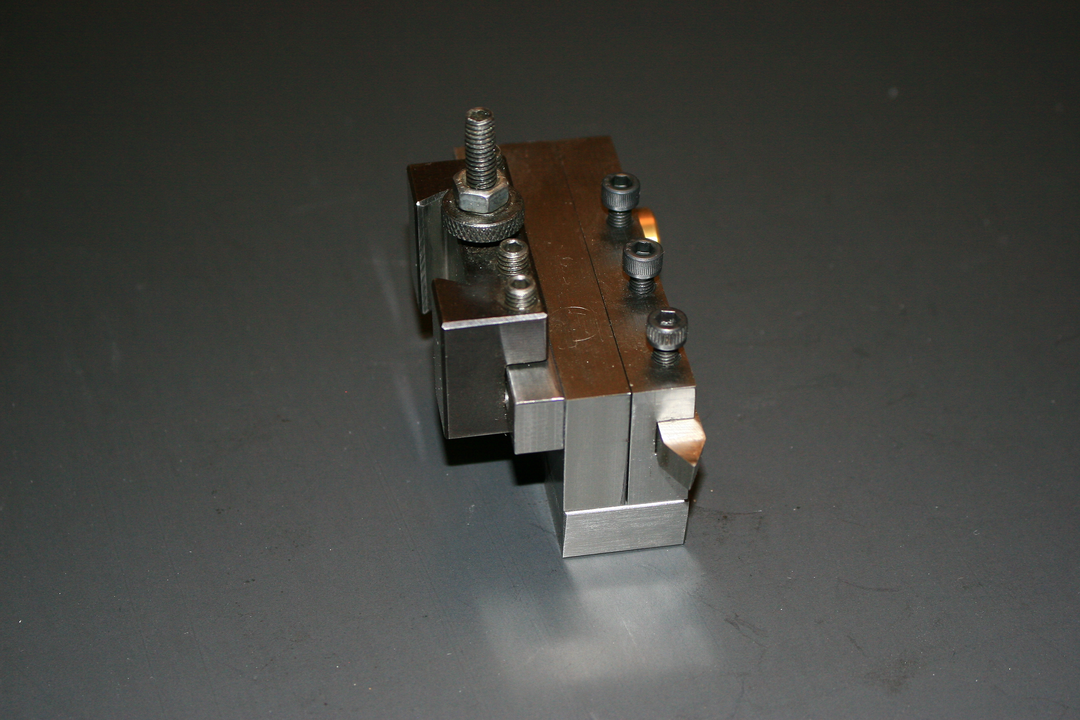

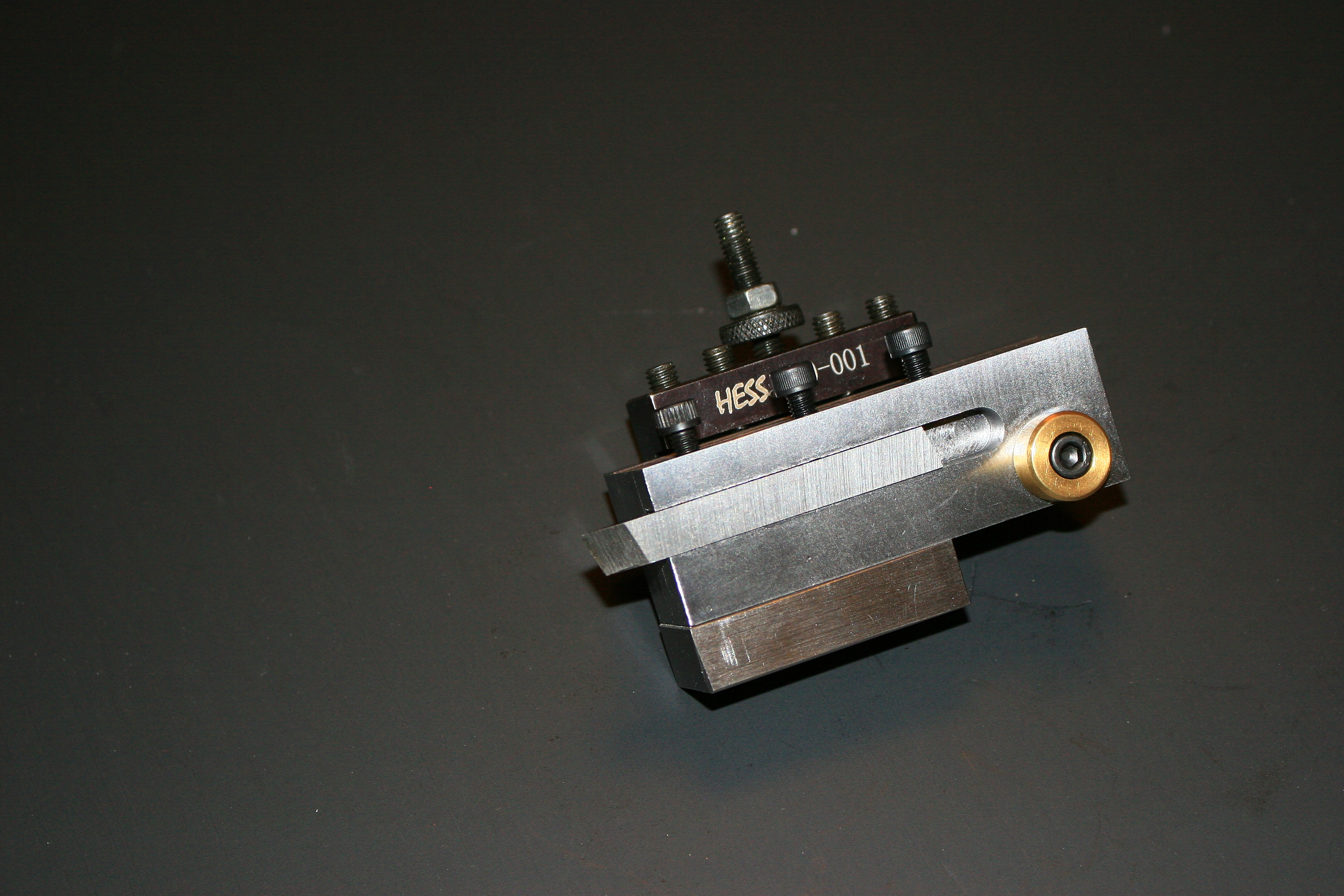

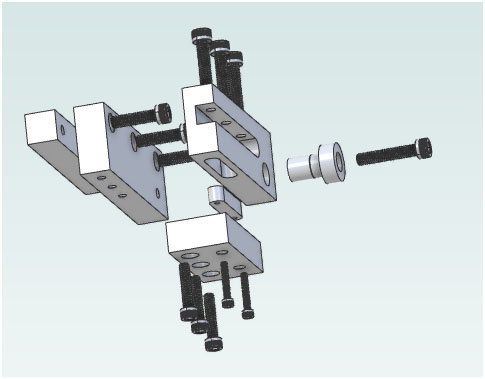

    Flip Up Tool Holder for Single Point Threading
    This version of the flip up tool holder is designed for the small 250-001 QCTP tool holders.
    They are for a 6 to 9 inch lathe which is what I have.
    This is not my design I found it online at:
    https://journeymans-workshop.uk/flipupth.php
    This is an excellent write up on the build and use of the tool.
    The difference in the one I made is the dimensions are not in metric and the size of the tool
    has been adjusted to fit the smaller lathes.
