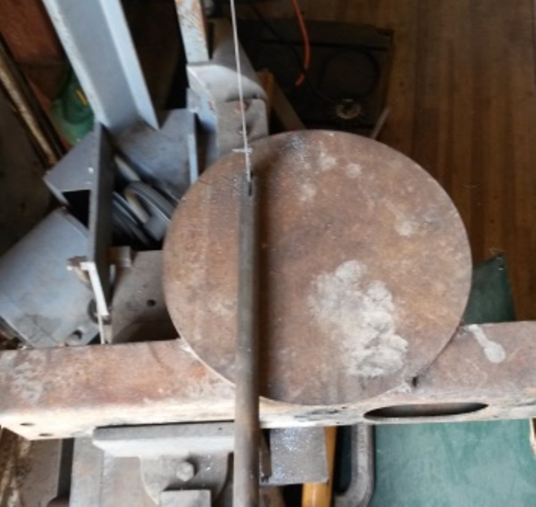

    OK it can be used for a lot more thing than that, but a friend brought his 6 "D" cell flashlight with duracell batteries in it and naturally they had leaked 3 of them had to be dug out in pieces. This left the bore badly corroded. bad enough that a steel bristle bore brush didn't get everything out
    So I turned 1 end of a 7/8" 1018 round bar down enough to fit in the chuck on my drill press then set my band saw up right and placed the made from scrap table on it then made 2 cuts in the other end of the rod to form a slot wide enough to place 4 layers of 1" wide 180 grit cloth in itflashlight bore cleaning rod-20170528_152810aa.jpg
    Before
    After
    mounted in the drill press
    I just left the drill press at the speed setting already on it, way to much drama to change RPM for a project like this
    I just held the flashlight body by hand and moved it up and down

    They're alkaline batteries so acids are the best thing to use to remove battery leak crud. Vinegar is safe and easily available. For something a bit stronger citric acid is available online in a convenient powder form. Still safe and can be dumped down the drain without dissolving your plumbing.

    Yes, I keep citric acid on hand for exactly the same reason. It's also useful as a pickling solution when silver soldering.
    Folks who don't want to order it over the web can find it at local stores that carry home canning supplies.
