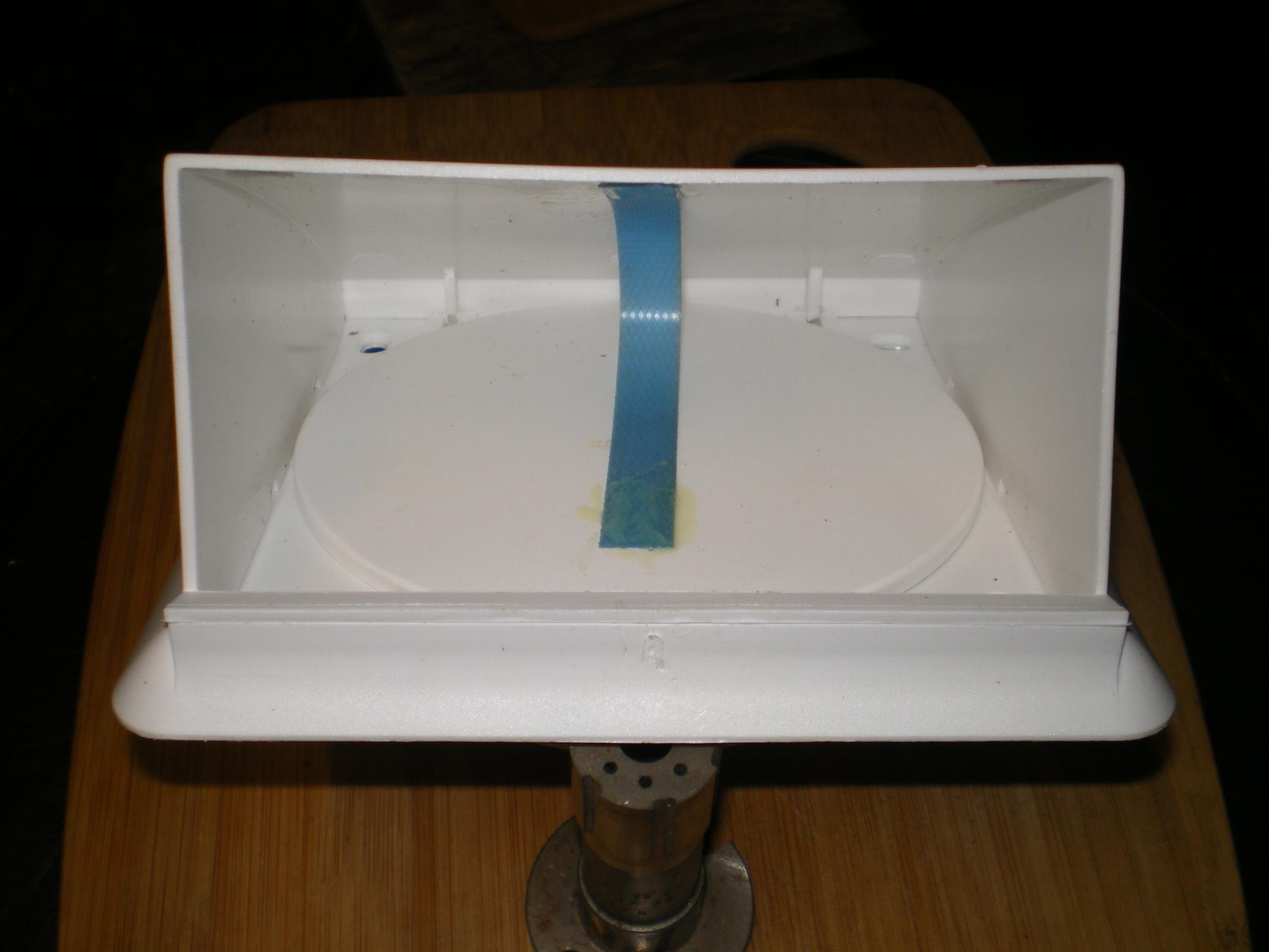

    Not sure where to post this hence the silly title.
    Ever had one of these fan hoods rattle in the wind all night?, There is a lot of discussion on the web for solutions so it obviously irritates a lot of people but none seemed to offer a good answer. Foam draft excluder, adding weights, buy a better fan with electronic shutters etc.
    Well it could not be much simpler to fix, just a piece of plastic parcel banding doubled over and epoxied in place to act as a very light spring, this gives just enough closing force to keep the flap closed in the wind yet it will still open under fan draft pressure.

    Good post. We actually have a new "Simple Homemade Tools" type of subforum planned, and stuff like this will be an excellent match for it. I have a feeling that, once we open that up, a lot of cool stuff is going to come out of the woodwork. Tape as spring is really clever.

    Very nice fix and more than adequate. Nice post.
