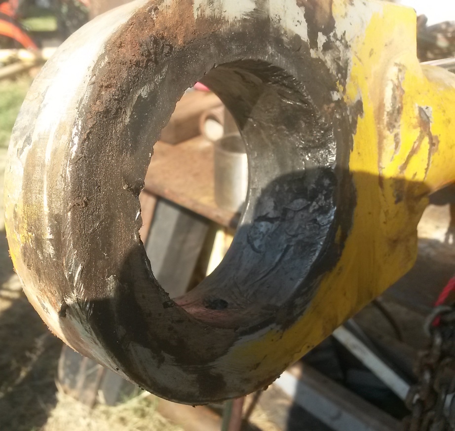

    So I drove out and had a look at the problem.
    A Hydraulic cylinder with a spherical rod end that he said keeps shattering the bearing cup.
    Sure it does it was the wrong application for the size bearing and there was no need for a spherical bearing to be there in the first place.
    The superintendent said they have replaced the bearing a dozen times in the past 3 months and he wanted a solid bushing or sleeve type bearing installed in place of what was there.
    They pulled the cylinder off and brought it to me last night so here is what I had to do
    First off I noticed that what the man wanted wouldn't solve his problem for the long term. What he wanted was to simply machine a thick bushing a little wider than the rod end and press it in then weld it in place. Which would have been fine except when the bushing would eventually wear out it would have to be cut out and another one made.
    I decided to take this 1 step further by making the bushing then making a sleeve bearing to the size of an off the shelf standard sleeve bearing.
    But the rod eye bore was severally damaged so first that had to be taken care of

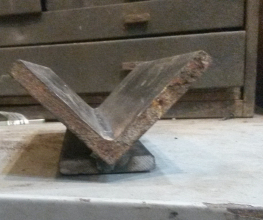

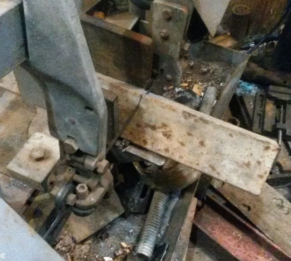

    I know I will make a fixture and clamp it to the compound and cross slide First I cut a 8" long 3 x 3 x3/8" angle from scrap
    next I cut another piece of the angle then clamped it down to cut off a strip to fit in the holding slot of the compound.

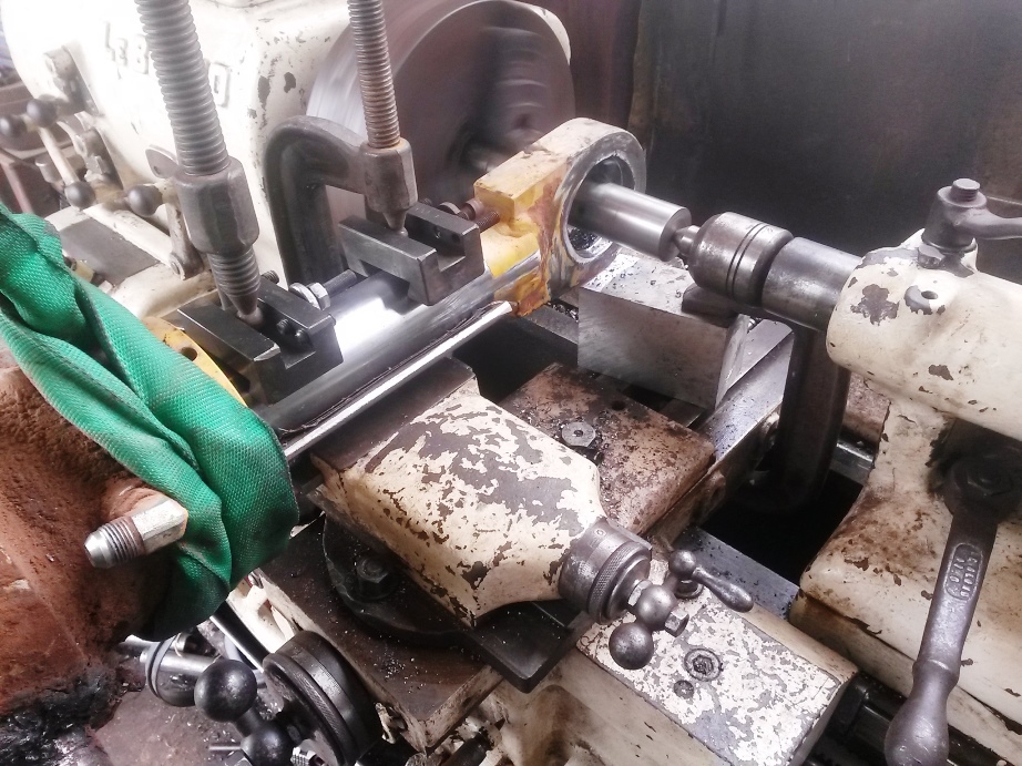

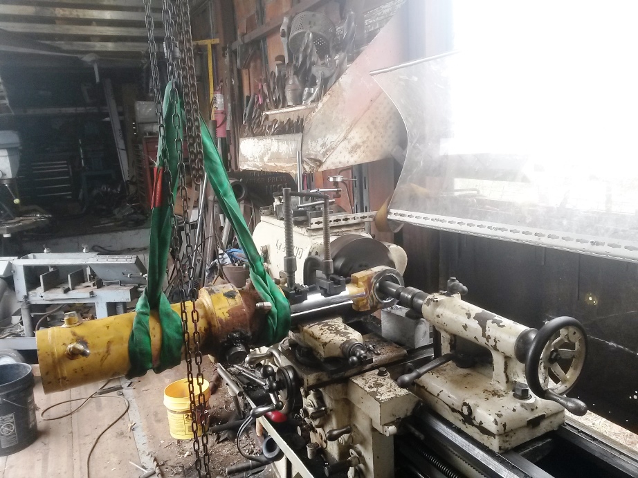

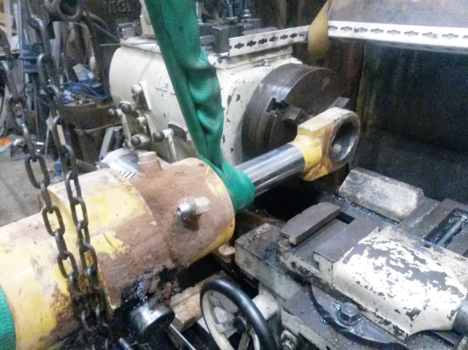

    Here you see the fixture with the cylinder rod clamped to it and the boring bar to clean up the rod eye
    Note the missing paint near the end of the rod where it joins the eye. To make sure the bore was perpendicular to the rod I checked the alignment of the rod to be parallel tot eh lathe chuck by using a known straight cylindrical bar positioned against the cylinder rod then measured the distance to the lathe chuck face with dial indicator the magnetic base on the chuck I rotated the chuck until the needle struck the bar at the horizontal my chuck is 12 " in diameter so I was checking the bar that distance apart I figured it was close enough once I found zero in 2 places.

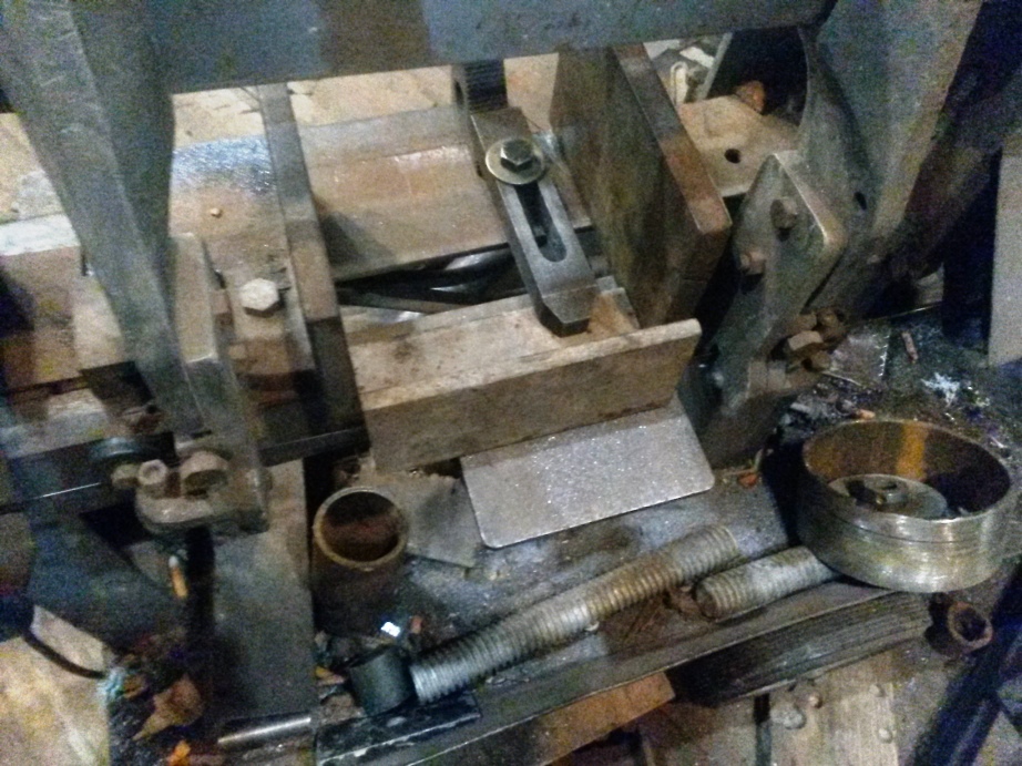

    Another view Has anyone ever used tool holders as clamps

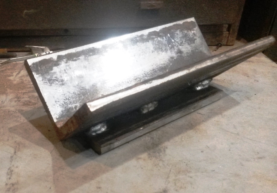

    The fixture

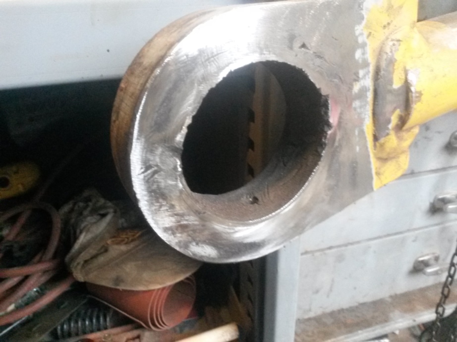

    the bore cleaned up

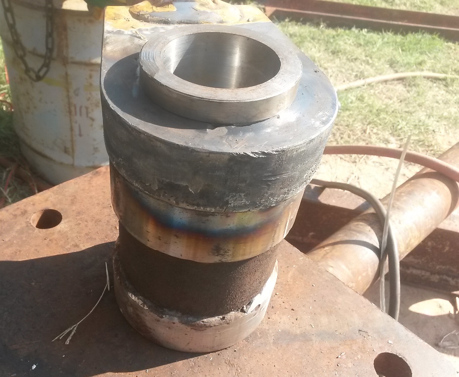

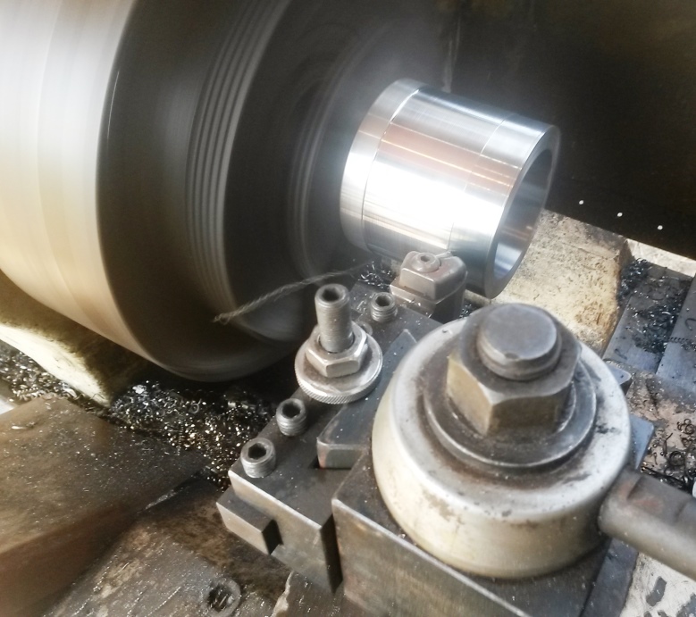

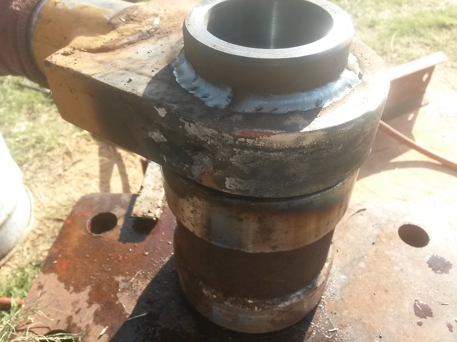

    TO complete the repair I made the bushing and sleeve bearing out of some old stock I had left over from other projects. Like the top roller of my plate roller

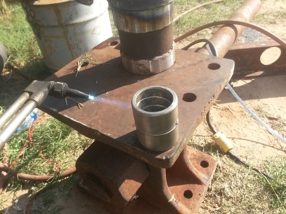

    I left the bushing about 0.010" oversized on the OD with a 1/2" wide flange 0.100" larger OD to give a positive locating stop.
    Then after heating the rod eye hot enough to allow the bushing to slip in I welded it in place
    Now I heated the sleeve bearing to red hot then water quenched it. I told the guy that the bearing will not last near as long as store bought one but this will get them by until the bearing I ordered come in
    No picture but after quenching the file test was fair but nothing to write home about. I knew it wouldn't be because I figured the steel didn't have much carbon in it to harden anyway.
    While the rod eye and bushing was still quite hot I installed the bearing still had to drive it in with a sledge hammer so everything is good

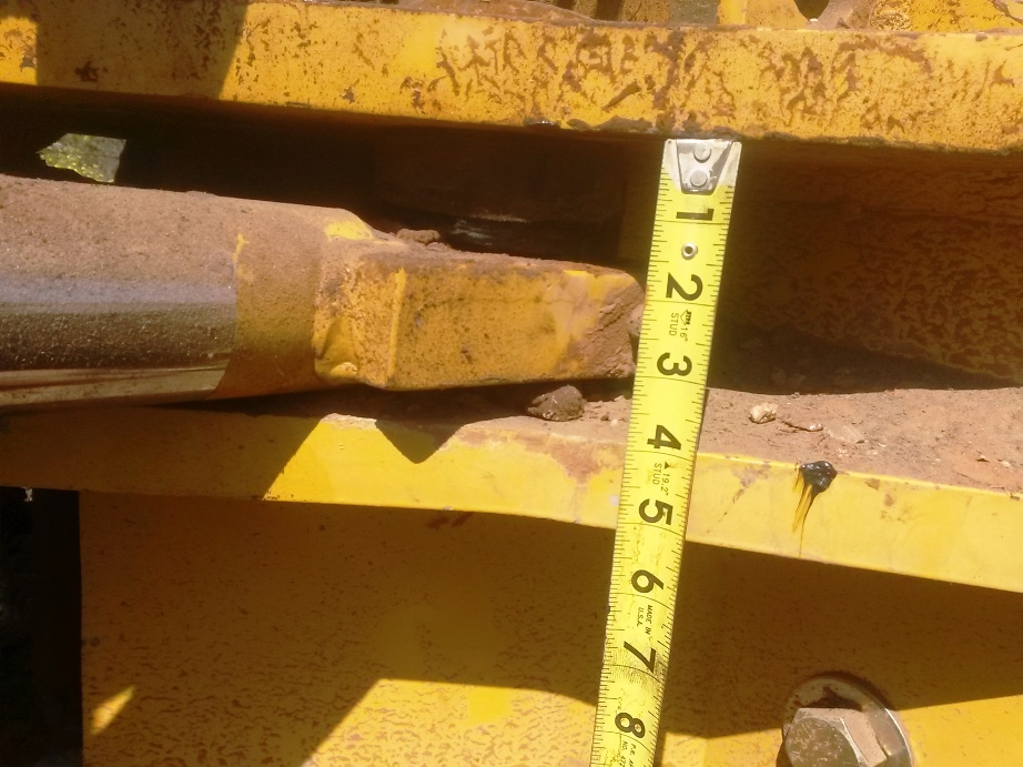

    here is a bad picture of where the application is on the machine. And the primary reason why the spherical bearing on a rod end is not the best choice.
    It is the articulation cylinder for a vibrating plow that installs poly piping in the ground.
    note the 4 inch distance between the top and the bottom plates. The spherical bearing is only 2" leaving a void of 2 inches.
    A tremendous amount of vibration is transmitted throughout the machine. those ball ends have a thin outer shell which is hard as the bearing the constant vibrations cause the ball to hammer against the bottom plate and the gap above allows the movement to be more violent. this ultimately is going to cause them to shatter.
    Now had the manufacture made the rod eye thick enough to allow retaining clips like a snap ring on both sides of the spherical bearing housing and filled the gap above and below the bearing then the design would have stood a much better chance of lasting for quite a long time. An extreme duty spherical bearing with a thicker outer shell would also help.
    Now there is one issue with the solution the superintendent and I came up with. Now that there is such a long ridged through hole in the bearing if there is any angularity in the vertical plane between the cylinder rod end and the mounting plates very high stresses on the pin are going to be introduced the cylinder rod is 3" in diameter and the travel is less than 9" so if the manufacture was lax in making everything square and perpendicular assembling the cylinder back on the machine is going to be difficult. As other pivoting points allowing for the articulation of the machine begin to wear higher stresses are going to be introduced on the 2" diameter pin. But millions of machines with articulating assemblies similar to this one have been made for decades without using spherical bearings in those areas quite successfully more especially when violent vibrations are in play. So I guess our idea is at the mercy of how well the rest of the machine was constructed at this point.

    This is real machining. . .for scale, note size compared to head of the combination square.
    Frank S is line boring again. Some would hesitate hanging that much weight off-kilter to the carriage and ways. Au contraire, it's balanced on the offside, in a choker slung from a chain fall, probably on a rail and trolley gantry crane. Effectively centers load on the carriage.
    Take that Mr. Gravity!

    Just as you said the weight is held by the chain hoist hanging from my
    jib crane
    Jib crane for my machine shop van
    Where ever I need one of these I'll build and install one
    Just another jib crane
    And if those can't do the job there is always this
    "A" frame gantry
    The carriage and more importantly the compound only had to hold the cylinder true to the bore line And carried no weight at all.
