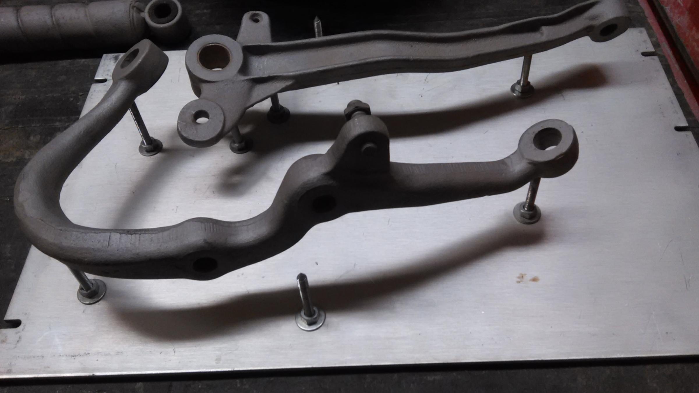

    I made this plate to hold specific parts from my 1957 Chevy truck front spindle assembly.
    My oven is not tall enough to hang the parts from. I have not used this yet, but when it dries off today will give it a try.

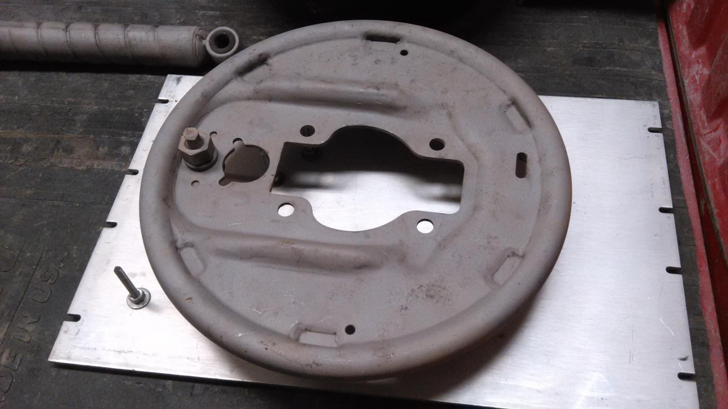

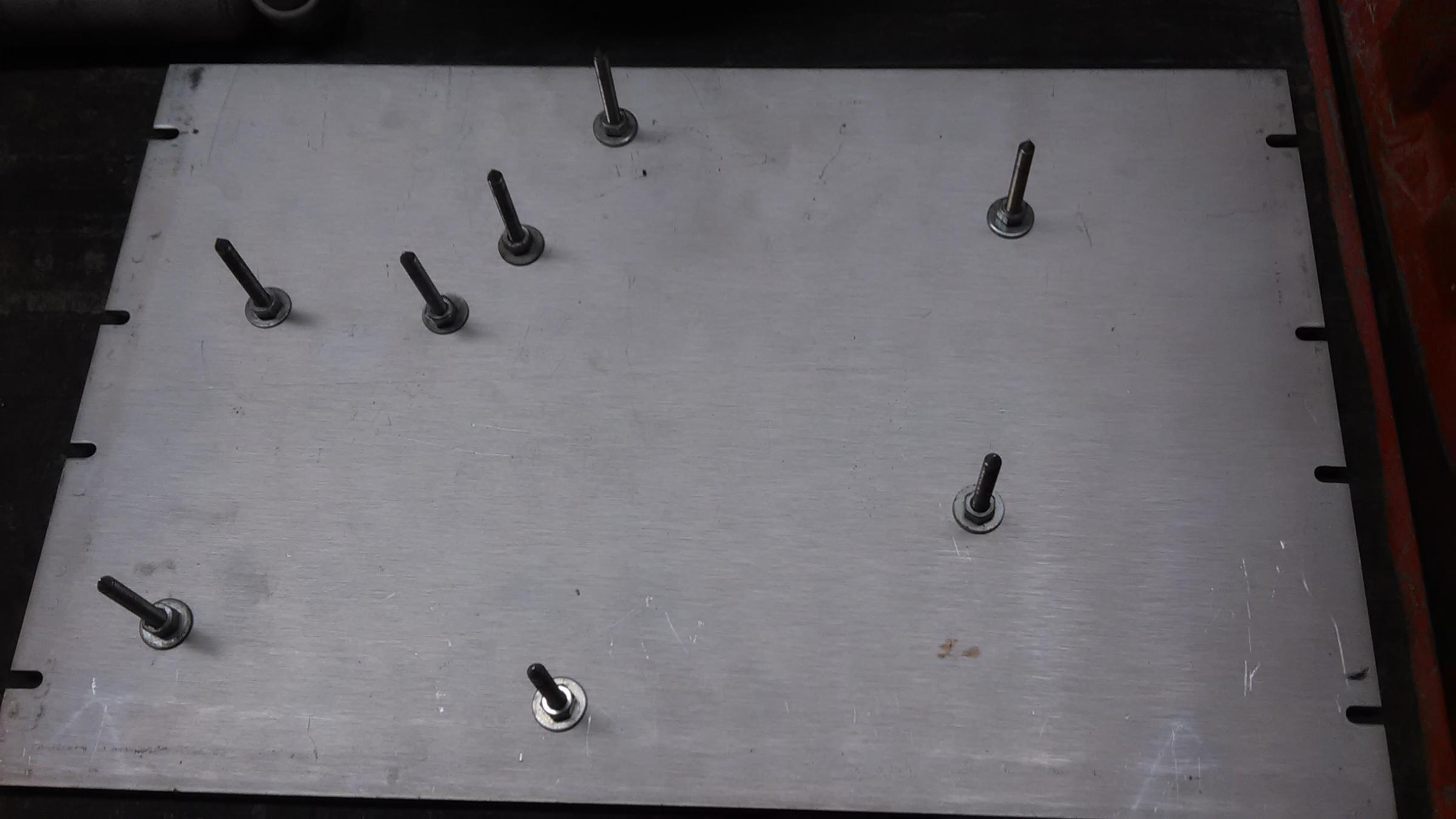

    Fixture plate to hold parts for powder coat oven cure-img_20190819_192023.jpgThe plate is 1/4" scrap (to me) aluminum from a 19" rack mount filler plate.

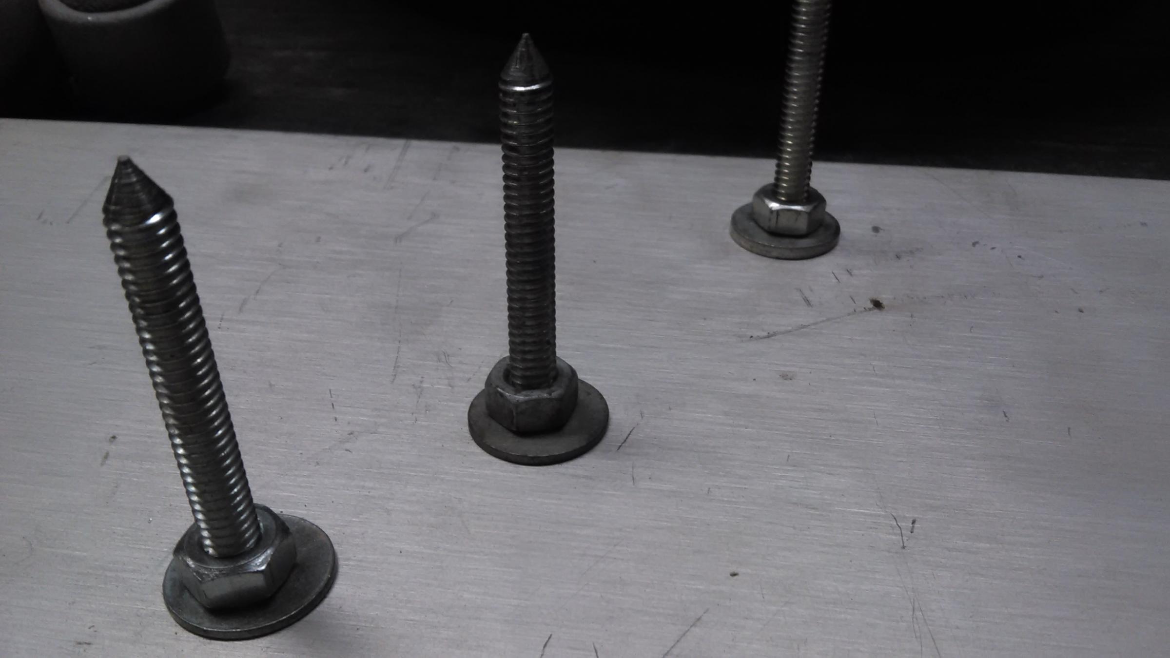

    Fixture plate to hold parts for powder coat oven cure-img_20190819_192034.jpgI machined the tips of 1/4"x20TPIx1-3/4" bolts to 60 degree point using a carbide threading tool.

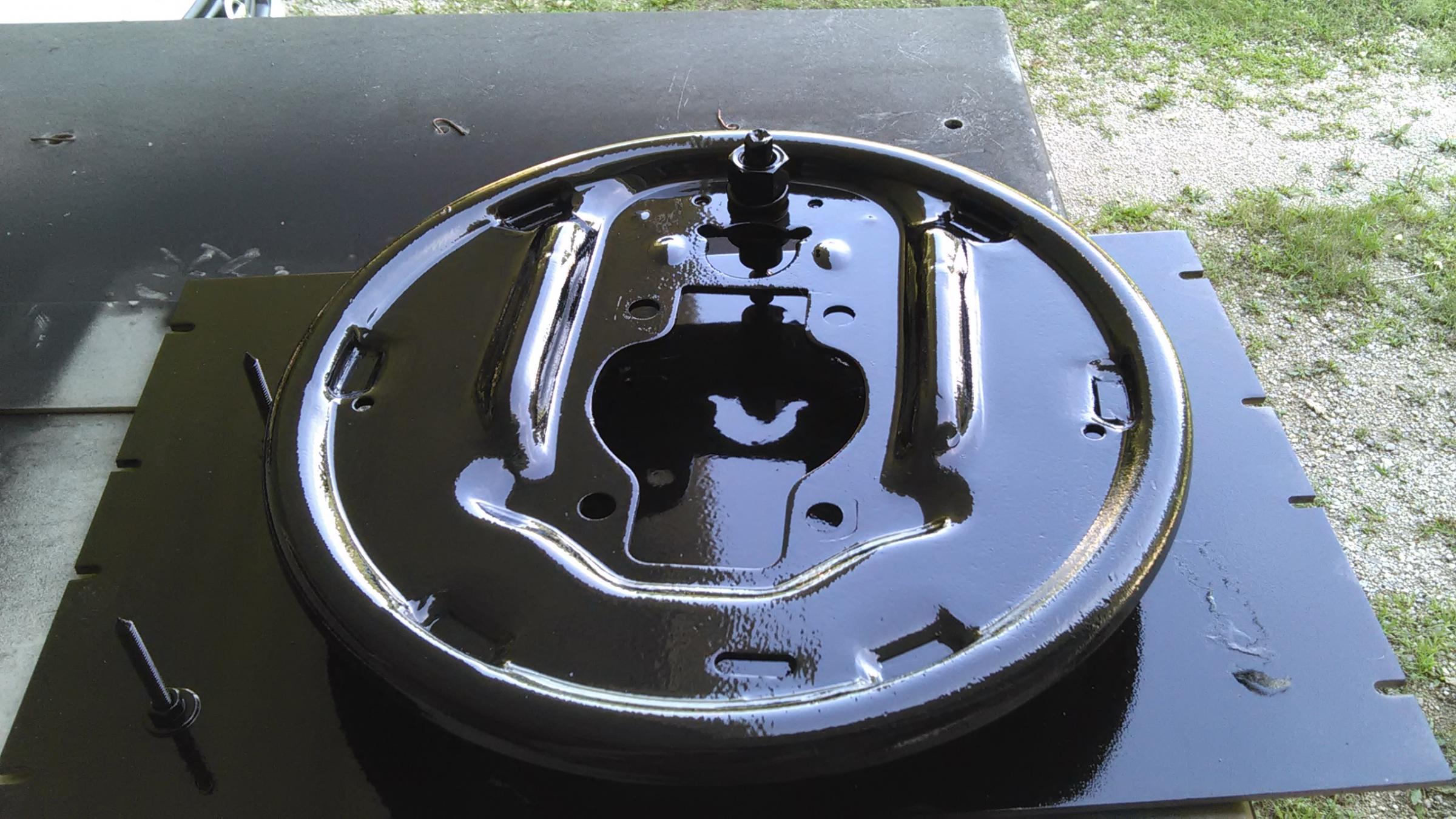

    Fixture plate to hold parts for powder coat oven cure-img_20190819_192009.jpgThe main brake shoe support plate

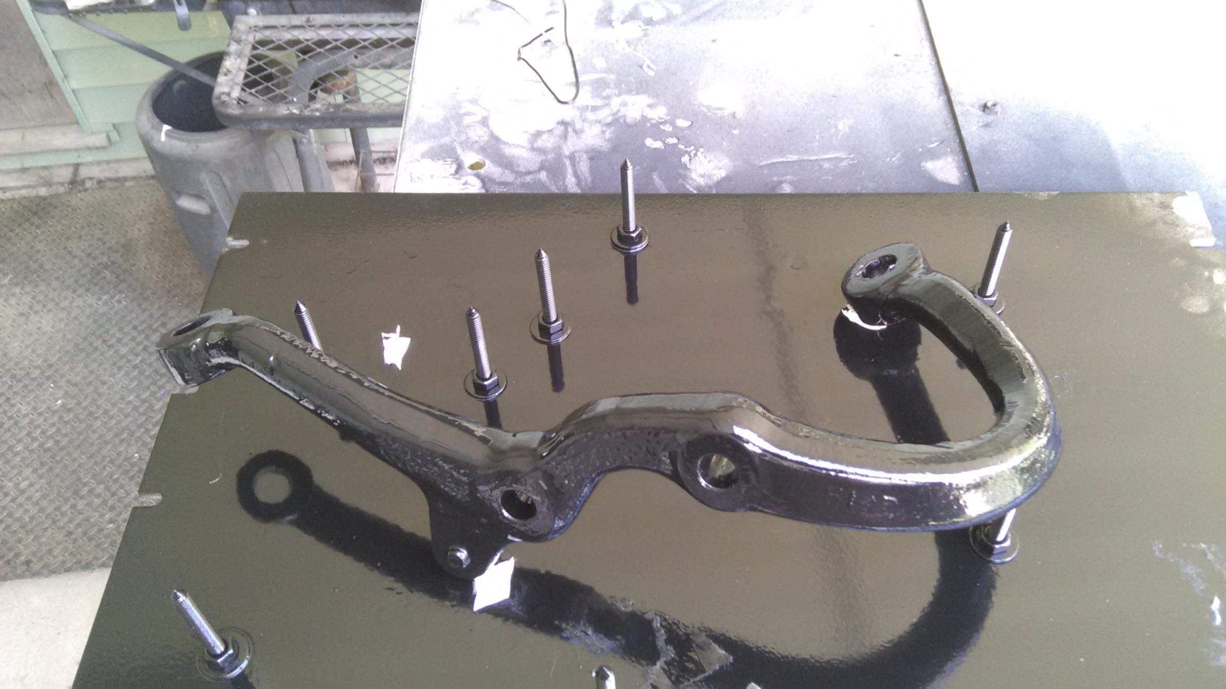

    Fixture plate to hold parts for powder coat oven cure-img_20190819_191936.jpgThe left side steering link, and the brake pedal link (between the foot pedal rod and master cylinder).

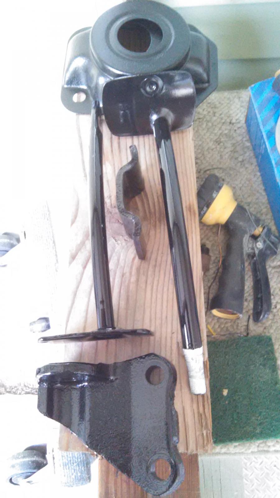

    Fixture plate to hold parts for powder coat oven cure-img_20190818_190231.jpgSome parts done in a toaster oven. There's the brake pedal rod, clutch pedal rod, a shock absorber mount, U-bolt spacer, and some sheet metal dust shields. I'm using gloss black from a random eBay seller. 380F@15 minutes.
    I've not done a lot of powder coating, but so far I've not had issues with oil or other surface anomalies. These are sand blasted with white silica fine sand, then just washed with spray engine starter fluid to remove the sand and rust dust.

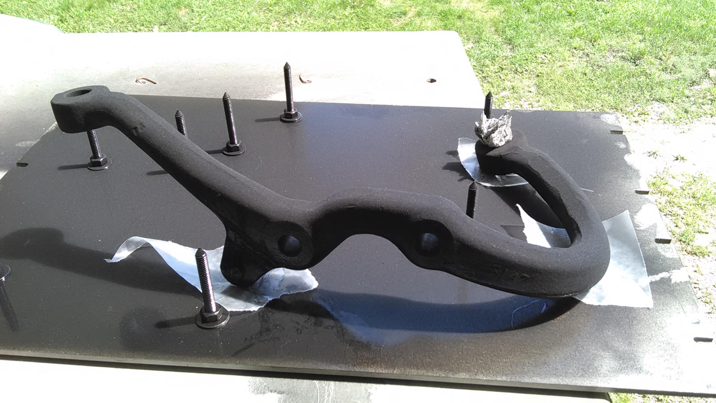

    Here are the results of today's painting effort:
    Fixture plate to hold parts for powder coat oven cure-img_20190820_160115.jpgThis part turned out perfect with one try.
    Fixture plate to hold parts for powder coat oven cure-img_20190820_125058.jpgThe brake pedal, I powder coated one side then flipped it, but steering arm, I tried without turning it over, that was a mistake.

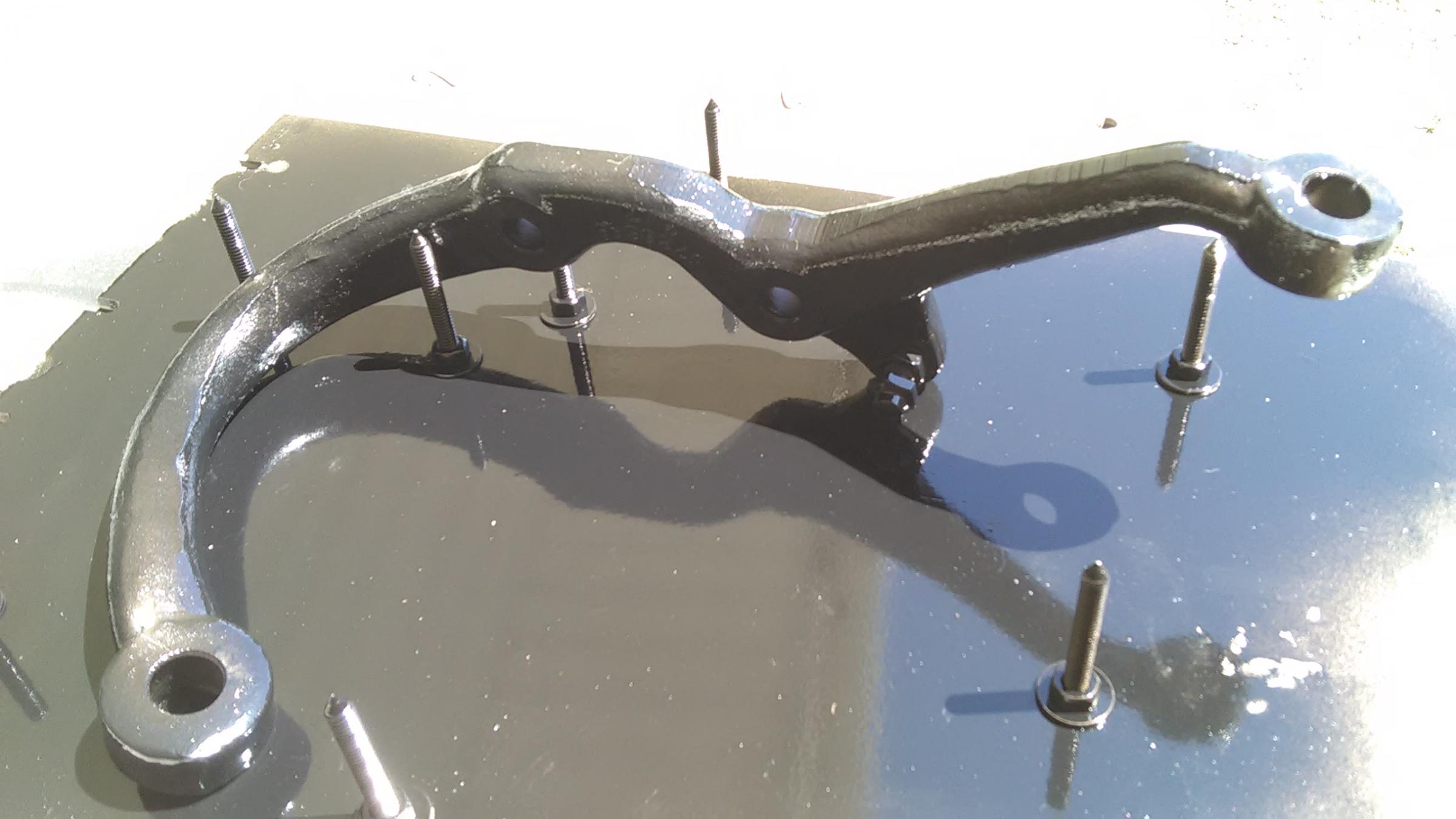

    Fixture plate to hold parts for powder coat oven cure-img_20190820_125425.jpgYou can see areas with no paint.

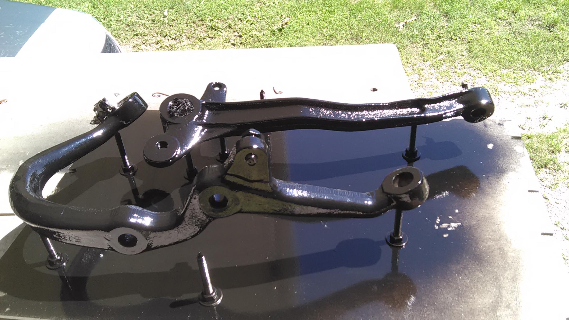

    Fixture plate to hold parts for powder coat oven cure-img_20190820_130158.jpgHere I've applied the 2nd coat of powder to the side I missed, electrostatic attraction has limited success.
    Fixture plate to hold parts for powder coat oven cure-img_20190820_145202.jpgThis was after the 3rd coating, as the second one, I thought it had cooled enough, and I left imprints in the surface, along with little hairs from the hot pad I was using. Also DO NOT USE WAX PAPER, it got stuck to the part. So I applied a very thick coat of powder, and I used Teflon plumber tape where it touches the plate, this worked well.
    Lesson learned, let things cool down to where you can handle them with bare hands.
    I also need to get some high temp tape and silicon plugs to mask off holes and such.
