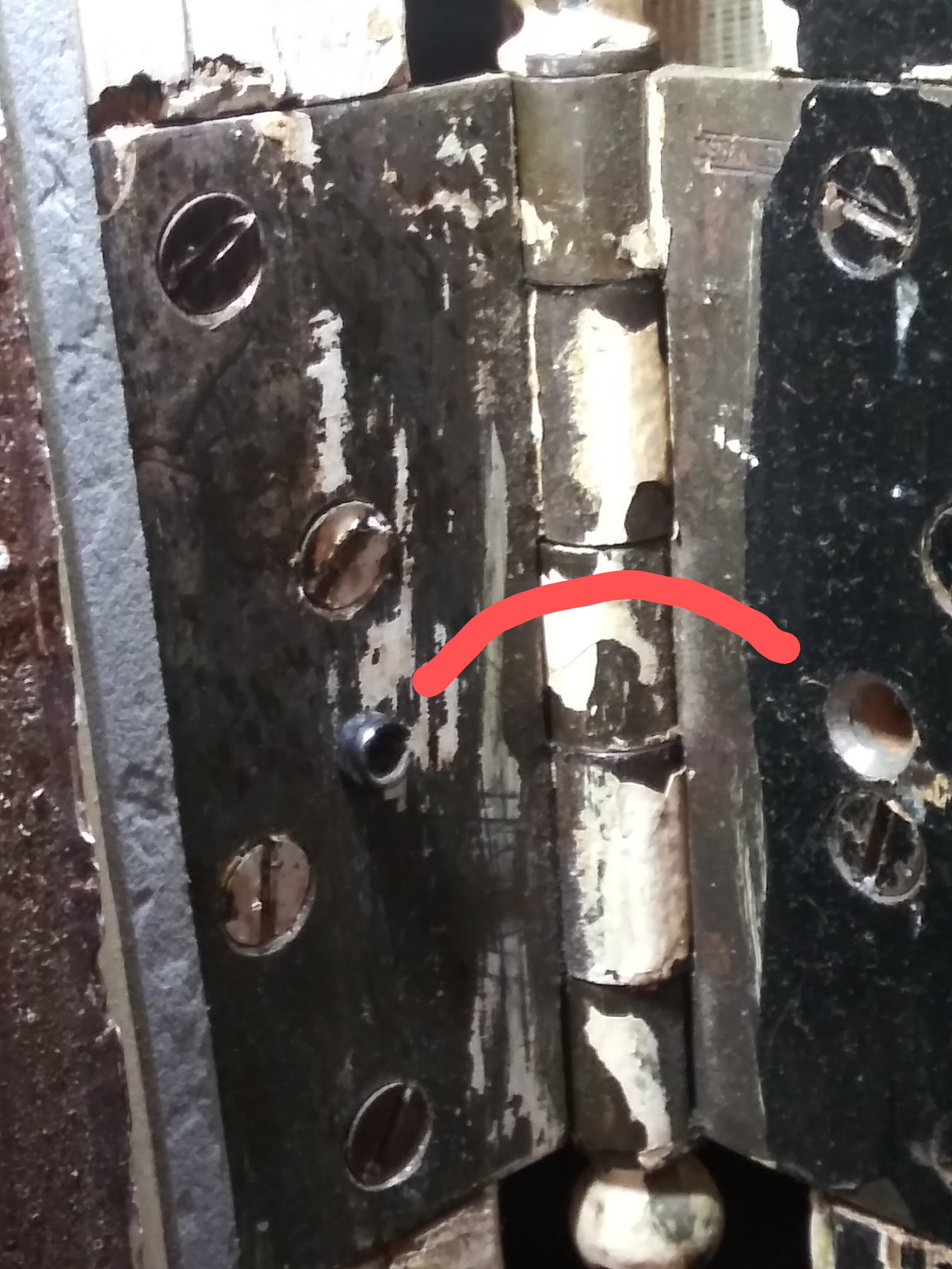

    Short screws are common here, in kits of new hardware. I replace with longer, to fully penetrate casing; exterior doors longer yet into the framing.
    Exterior and basement doors also get pinned; pressing a spring pin into the fixed side, a clearance hole on the other. With a double cylinder deadbolt, door becomes difficult to get out; even with hinge pins removed.
    Last edited by Toolmaker51; Feb 13, 2022 at 11:54 AM. Reason: added pic by addled user

    That's good practice. Cuz it's what the installers do!
    I have installed literally near a thousand doors. One long screw each on the hinges is usually enough. But you will have to increase the size of the countersink on the hinges for this to work perfectly. On your hinges I think you got away with it. But conventional hinges you have to do the counter bore to accommodate the number 10 screws. I don't use number 8's not enough meat on the shanks.
