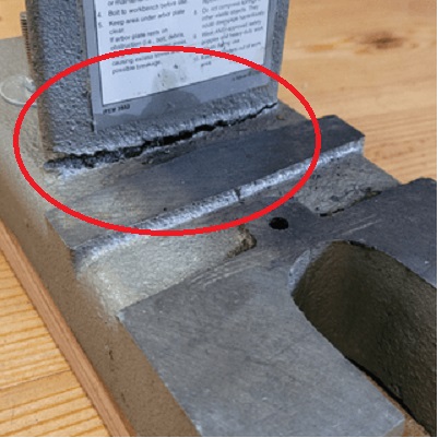

    Also, a caution for others. When you mentioned the press I immediately looked at Harbor Freight because there is one in a nearby town and I have been thinking of getting a press for the same reasons as you. I usually go to the 1-star reviews for a quick look at potential problems. Its fairly easy to discern failures due to user abuse or the product. However, this review is not so definitive. Did the user use an extension bar and put excessive force on a 1 ton press or was there a flaw in the Chinese casting? Buyer beware.
    Central Machinery 1 ton press:
    Mine is not actually from Horror Fright, I used the title "Harbor Freight STYLE". There are no HF stores here in Spain. I have just had a look on the HF site and judging by the photo there the casting looks to be of lower quality, but it is hard to tell from a photo though. There is no ridge around the back side like there is on mine so it starts weaker by design.
    The photo that you show is really bad, surely that has to have been due to overloading as you surmise. Maybe there was a shrinkage crack in the casting to start with?. I followed your example and read some of the 1 star comments. I noticed that one said that the operating arm bent, that would only happen if the user put a pipe over it. Other comments are true horrors.
