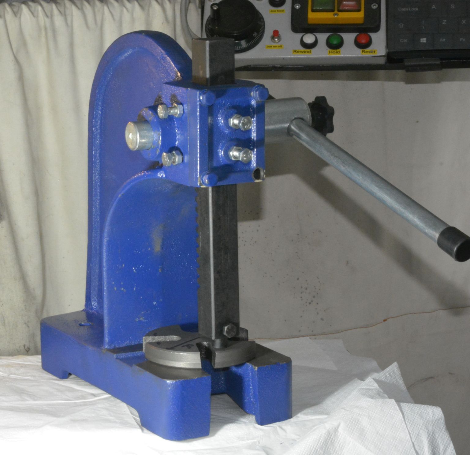

    I recently got this cheapo chinese Arbour Press
    Fixing a Harbor Freight style Arbour Press.-arbourpress-11.jpg Click on thumbnails for full size pix.
    I tend to look at these cheap tools as a kit of parts delivered assembled to ensure that you receive all the parts for subsequent fixing and proper assembly. In this case I was not disappointed, there were a few things to fix before use.
    I prepared a PDF file describing the problems and the fixes.
    Arbour Press faults and fixes
    Update:
    This morning I made the steel press plate. It is larger and I have made it square to give the maximum possible support to the workpiece. I ignored the width of the slots in the original plate and made them to suit what I expect to be most used. I wanted to clear shafts of 10 mm, 12 mm, 15 mm, 17 mm, 20 mm and 25 mm. So I cut slots of 11, 16, 21 and 26 mm each with the minimum necessary length to match the widths.
    The following photos show the new plate, firstly just the plate and secondly the plate with the original for comparison.
    Fixing a Harbor Freight style Arbour Press.-arbourpress-21.jpg Fixing a Harbor Freight style Arbour Press.-arbourpress-22.jpg
    The PDF has been updated to include the new plate.

    'Parts kit, indeed.' No gibs fitted into recesses? Well, it's two-fold. 1.] Gibs add greater expense, compared to when patterns were made. 2.] Missed at assembly?
    The remainder would go Python-esque "I have these two.....(ahem, three sir)".
    The recess may be lightening cuts, reducing consumption of iron into casting, saving .02 fen coinage. Any rate, none of those are proper features to leave out of an arbor press, just like too small press plate for the throat depth, thrust clamp on gear shaft & unfinished bolt ends.
    The only positive, working end is fitted to retain replaceable tools. Even really great arbor presses lack that.
    I like adding a stop clamp also. 2 dowels spread across 3 rack teeth, in a square holed 'bushing', and a vertical set screw/ jam nut for increments.

    Yes, but how many people buy one of these and have no idea there is a better way for them to function.? They just run in the screws a little more as they wear completely oblivious of real problem.

    Welcome back, Tony. Very nice write up. What do you think about a piece of Teflon instead of steel for the gib? I would probably throw the plate away and just use 2 pieces of steel with a v-notch in each piece.
    Teflon, brass, bronze etc. would all work in place of the steel. Teflon would not need any grease, although the rear part on which the rack teeth slide would still need greasing but I suspect that many users would not grease anywhere.
    Teflon could be adjusted to be a bit of a tighter fit but teflon flows or creeps and I suspect that over time it would flow away in the region of the screw pressure and hence loosen that initial tighter fit. Maybe a thinner piece of teflon backed up with a steel plate would work well. On a practical side, my scrap box had a few pieces of steel plate but no teflon.

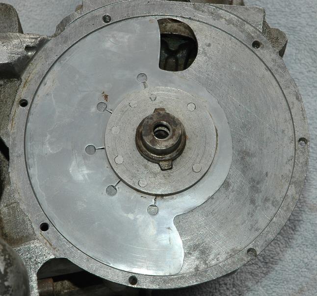

    I have a funny story about that. Back in the 1960s I built a rotary disc inlet valve 2 stroke engine. I had just heard about this wonder material "TEFLON" and I thought that it would be the ideal material for the valve because of its low friction. I realised that it might grow due to centrifugal effects at high RPM so I inserted what amounted to a small knife in the lower part of the housing to trim the teflon to the size that it wanted to be. It worked too well. The teflon grew and the knife trimmed it, then the teflon grew and the knife trimmed it, then the teflon grew and the knife trimmed it.......................
    I then replaced the teflon with thin steel, hard chromed. That worked well. Here is a pic of the steel version, I have none of the teflon.
