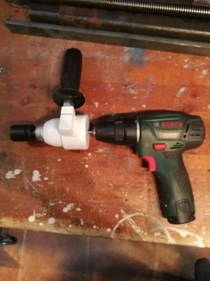

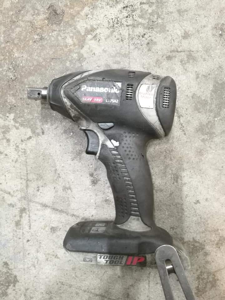

    I was little bored..
    "Fixed" my broken impact driver.
    Fixed: Broken impact driver = handy attachment-fb_img_1585742988584.jpg
    Fixed: Broken impact driver = handy attachment-fb_img_1585742995157.jpg
    Made a casing from suitable sized pipe and sheet metal.
    Little slow with that small drill that runs max 400 rpm,
    but it works.
    With a bigger corded drill, it performs like it originally did.
